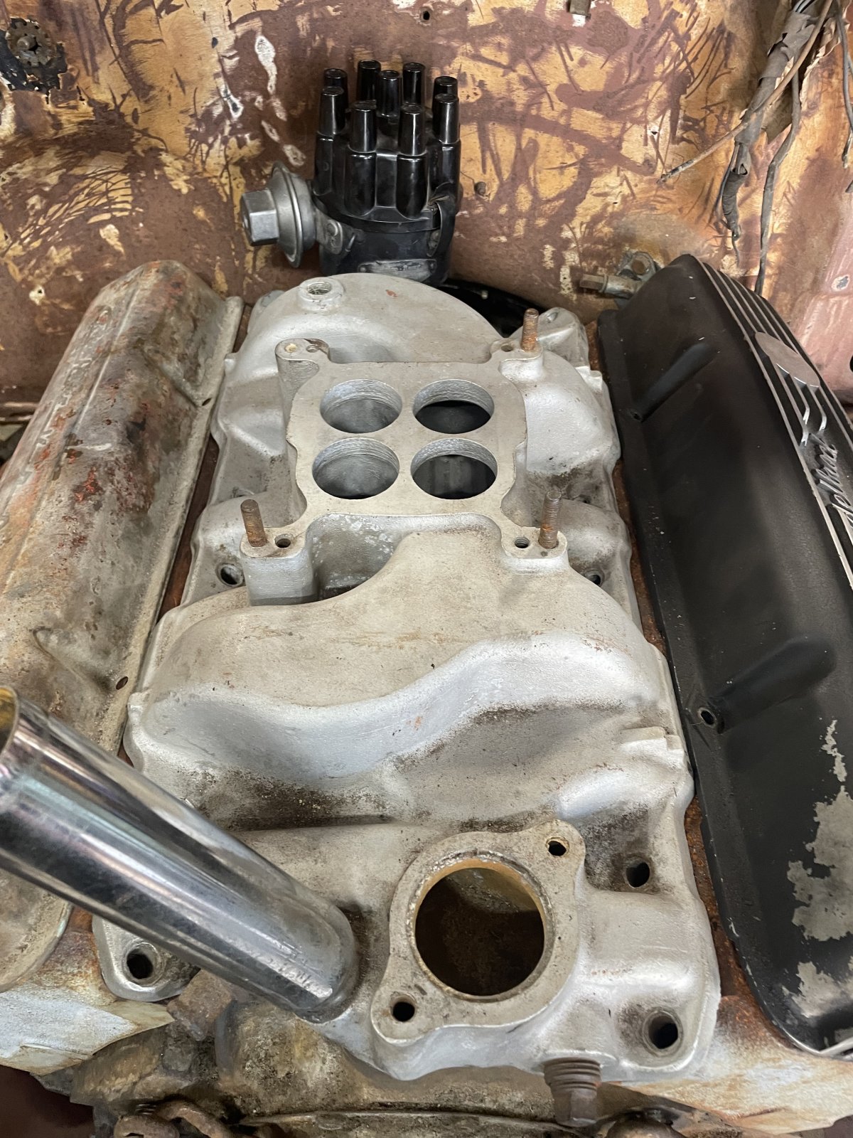

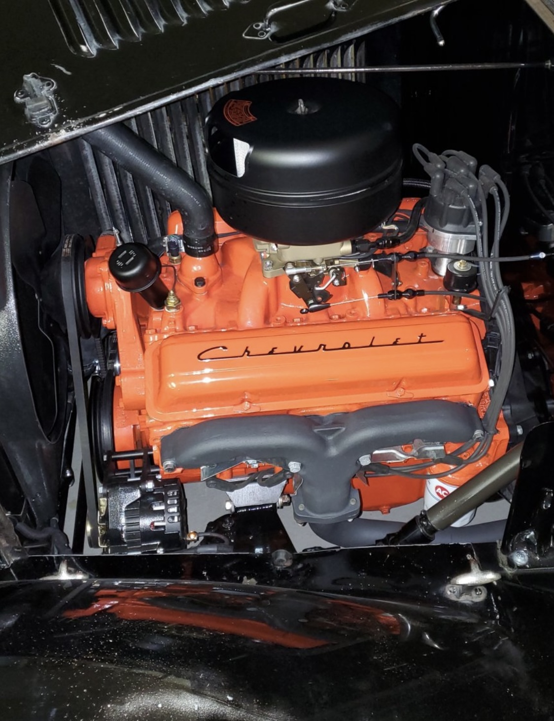

    Note, appears to be a 4 barrel under a 2 barrel air cleaner?
  6. ekimneirbo
    Joined: Apr 29, 2017
    Posts: 5,146
    ekimneirbo
    from Brooks Ky
    I think that looks nice. I never would have known, much less noticed it was for a 2 barrel. IF I noticed anything it would have been the oil filter and maybe valve cover bolts..........but most likely I would have just thought they did a nice job making it look close to original and wondered what was really hiding inside.
    "Close enuff for goverment work"......:)
  7. Johnny Gee
    Joined: Dec 3, 2009
    Posts: 14,035
    Johnny Gee
    from Downey, Ca
    I respect when it’s done well. There are a few bolt on’s I don’t care for. But it’s done with thought. Like color chooses so things don’t jump out at you. A little black on the distributor housing would have been nice.

    Oh No, is that billet.............aarrrgggg:rolleyes:Jus kiddin, I still think it looks good overall.:p

  10. Moriarity
    Joined: Apr 11, 2001
    Posts: 35,968
    Moriarity
    SUPER MODERATOR

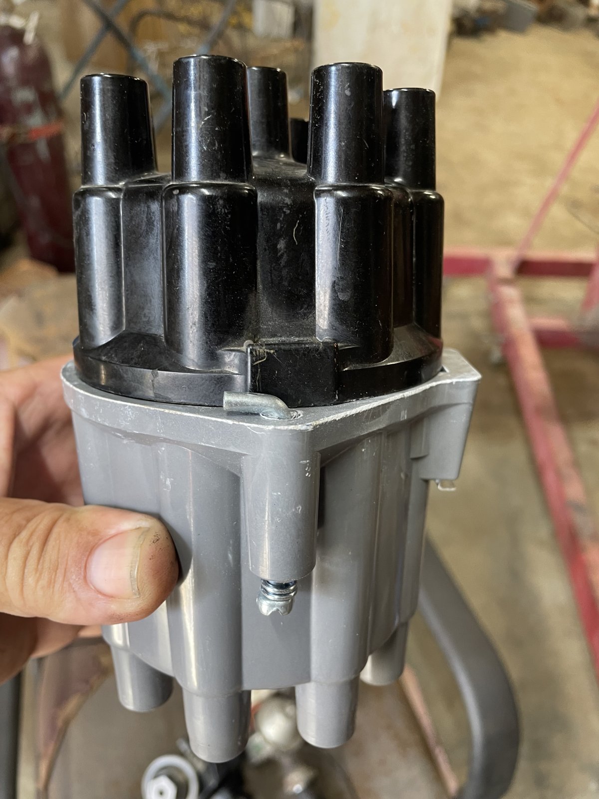

    billet dist is electronic and the so called carb is EFI..... I can see a modern coolant temp sensor on the far side of the intake....
  11. Bandit Billy
    Joined: Sep 16, 2014
    Posts: 15,112
    Bandit Billy
    And the tell tale fuel inlet in the left rear of the EFI. :cool:
    chryslerfan55 and Moriarity like this.

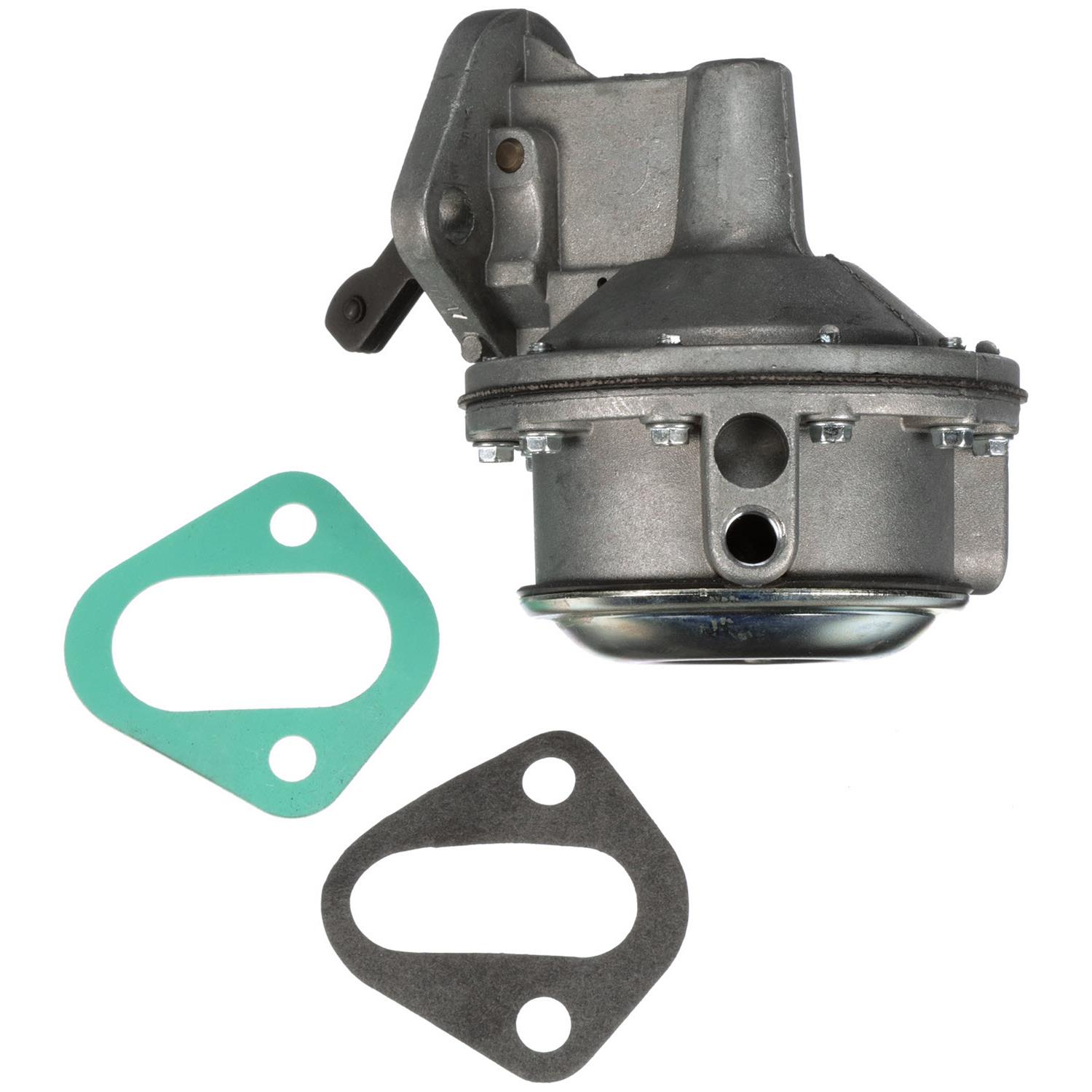

  17. I'm hoping we can revisit the fuel pump info for a moment... Stumbling on to this information resolved a mystery I wasn't even aware I had with the Edelbrock pump on my '56 (currently blown apart). I did some light research on fuel pumps on SummitRacing last night and even found review information that said fitment was tight on tri-five chevs for a couple pumps. I know some of the available new fuel pump choices have clockable lower housings to maybe give choices to inlet/outlet placement... but I'm wondering what other tri-five owners are generally doing to address the tight fit scenarios. Are a number of you defaulting to a certain brand & part number for a mechanical fuel pump because it eases/lessens some of the fitment issues? Are there new/modern mechanical pumps available that have the same/similiar design dimensions of the original tri-five pumps?
    Thank you in advance,
    Gotta56forme/Scott
    anthony myrick likes this.
  18. have you looked into the gm vette pump 40083?
  19. thank you for that reference. I wasn't aware of that pump, but some brief searching I did doesn't show it available nor a price. Since it's labelled a 'corvette' part is it affordable? (if you know)
  20. NOS ones are pricey.
    Summit lists one. Has a bad review. But sounds like the guy ordered the wrong pump.
    that part number came from one of the tri 5 Chevy forums.
    I’ve never used one

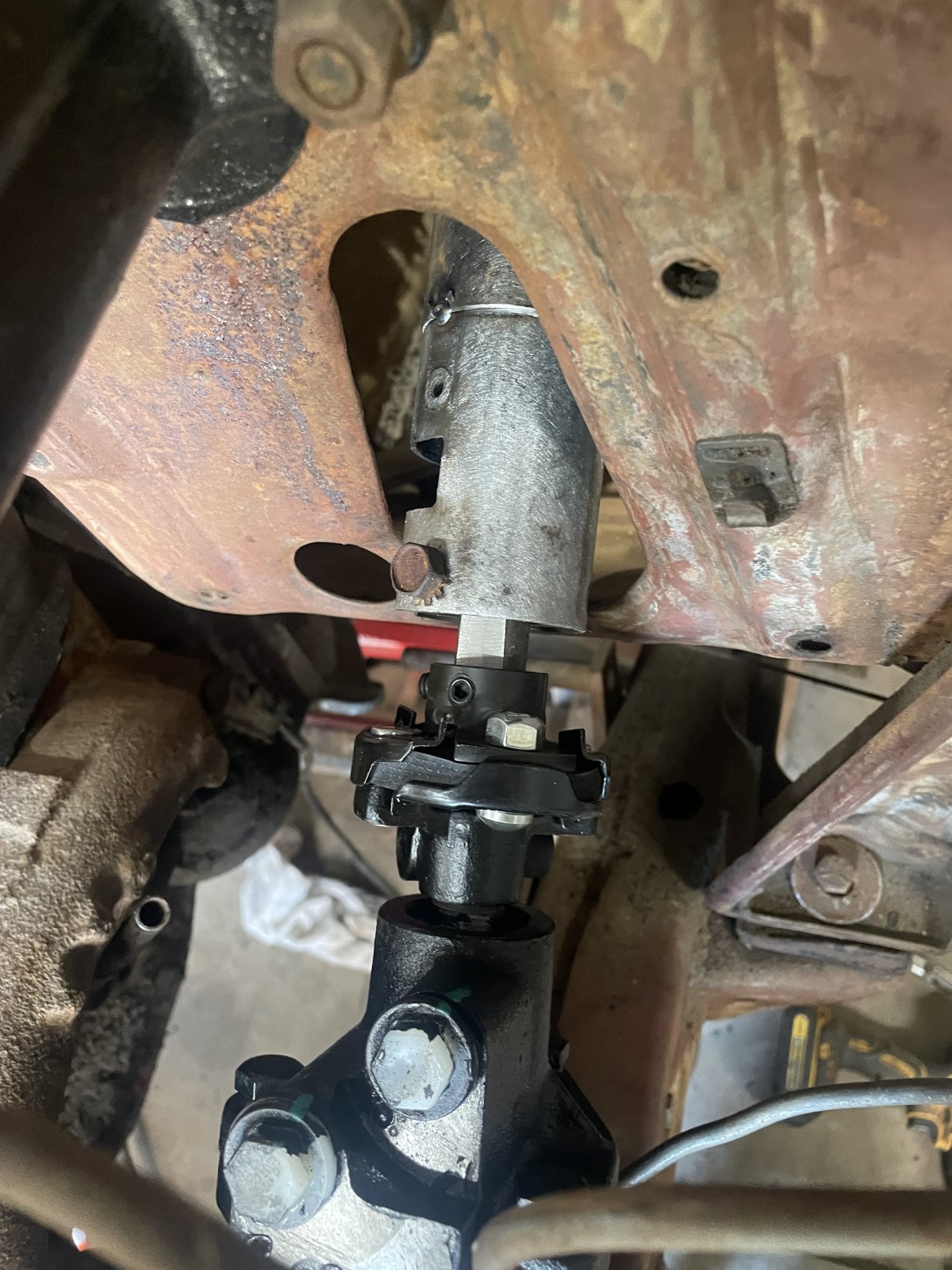

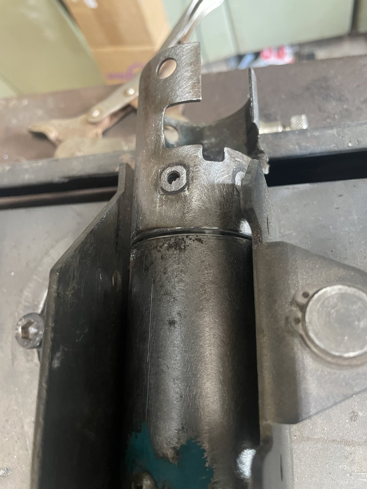

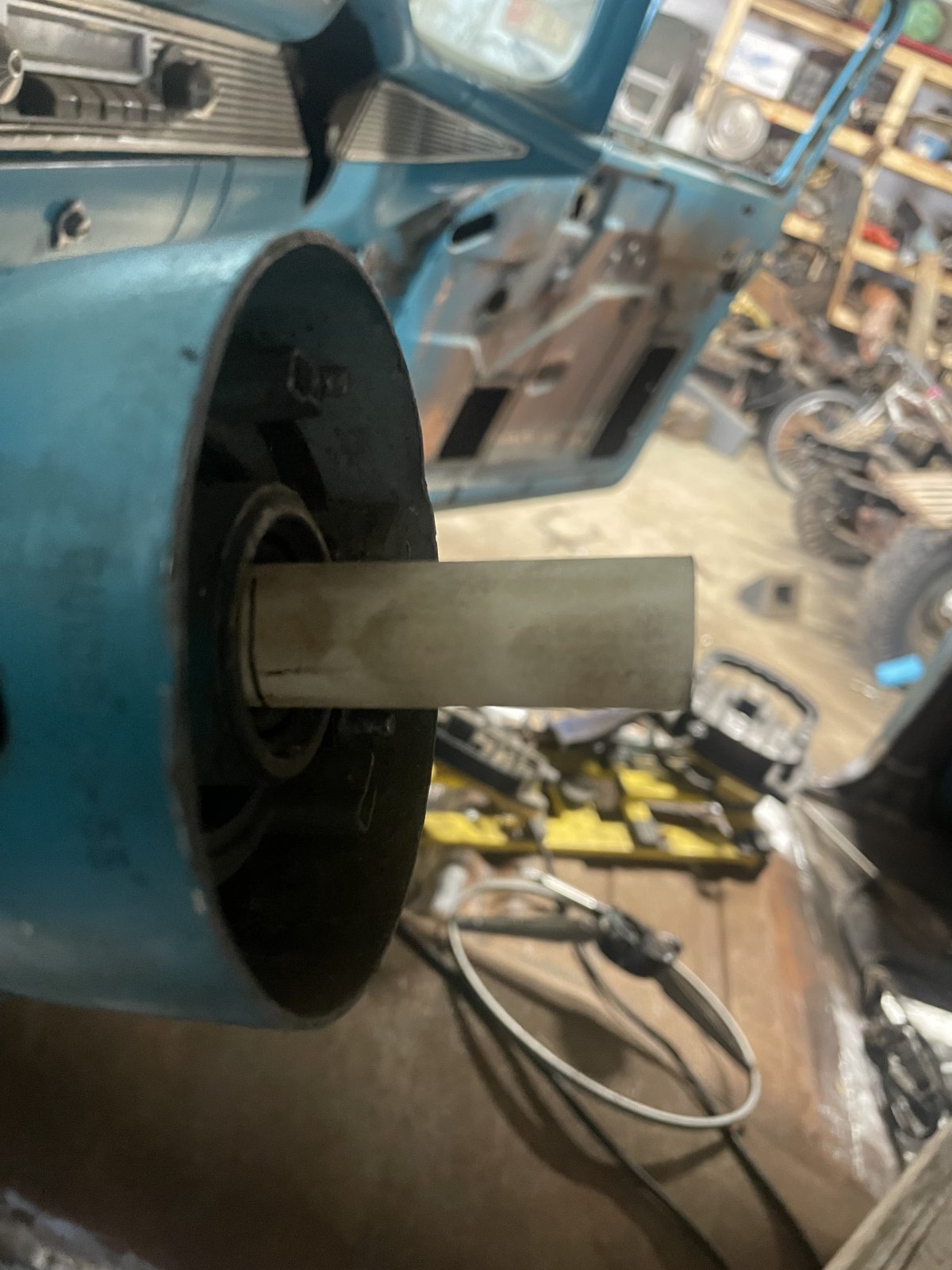

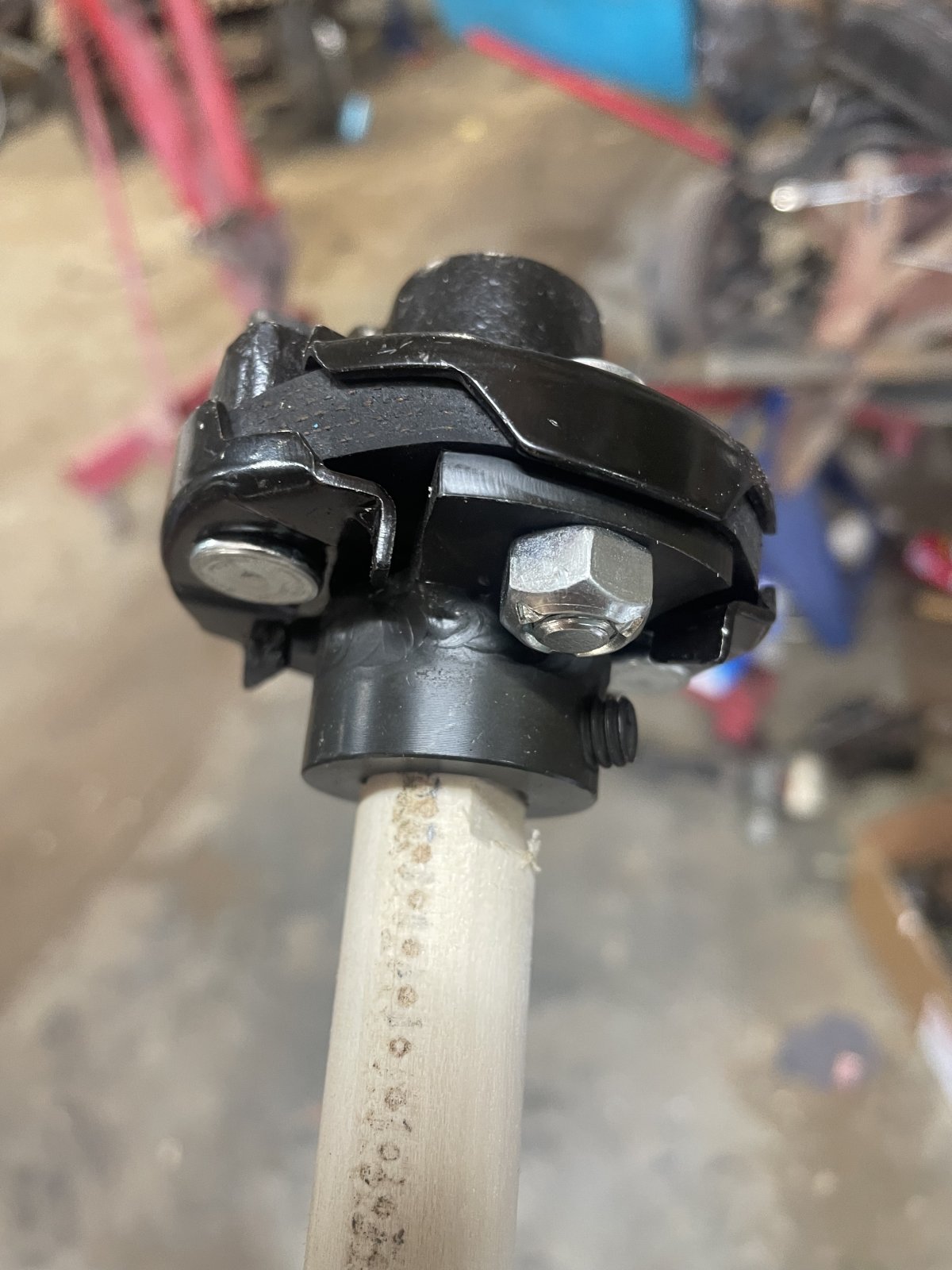

  21. Steering column cut.

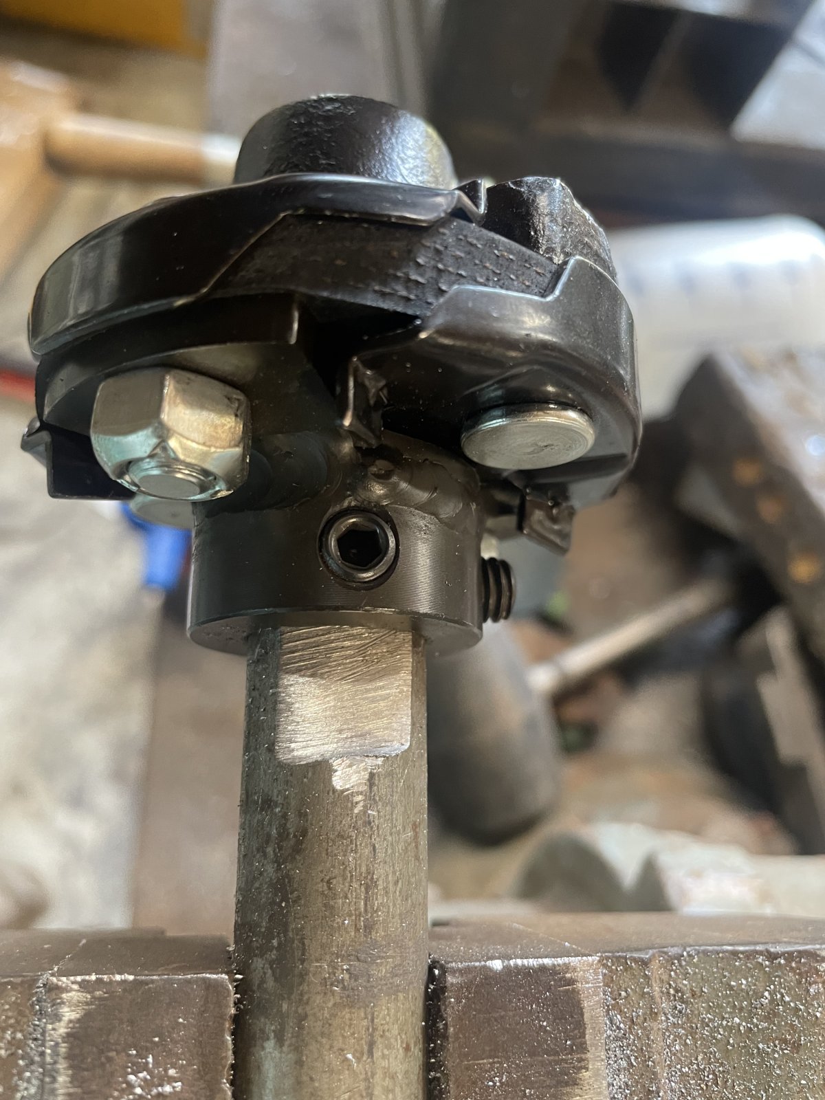

    Before cutting, I measured the distance from the dash to the end of the column. And measured the amount of shaft that stuck out past the column for the steering wheel. You will use these measurements later. It was determined from measuring from the center of the steering box to the end of the rag joint that 3-3 1/4 needed removed from the column. This was determined from comparing the same measurement on the old box with the column attached.
    the column was measured and reference lines made to clock the tube correctly. Then squared up in a chop saw and cut
    Clamped and squared the pieces in the chop saw, aligned reference marks and tack welded.
    Then used a 3/4 dowel to figure out the shaft cut
    Installed the rag joint (install the bolt. It affects how it fits) fit the dowel and column. Used reference measurements to place the column back to its original length/placement with the dash.
    Used the measurements from the original set up to cut the dowel to length
    removed the dowel, used it to cut the original shaft to length. Then placed the shaft in a vice and “milled” the double D
    reinstalled the shaft, column and steering wheel. Looks good so far
    the next trick will be modifying the column shifter.

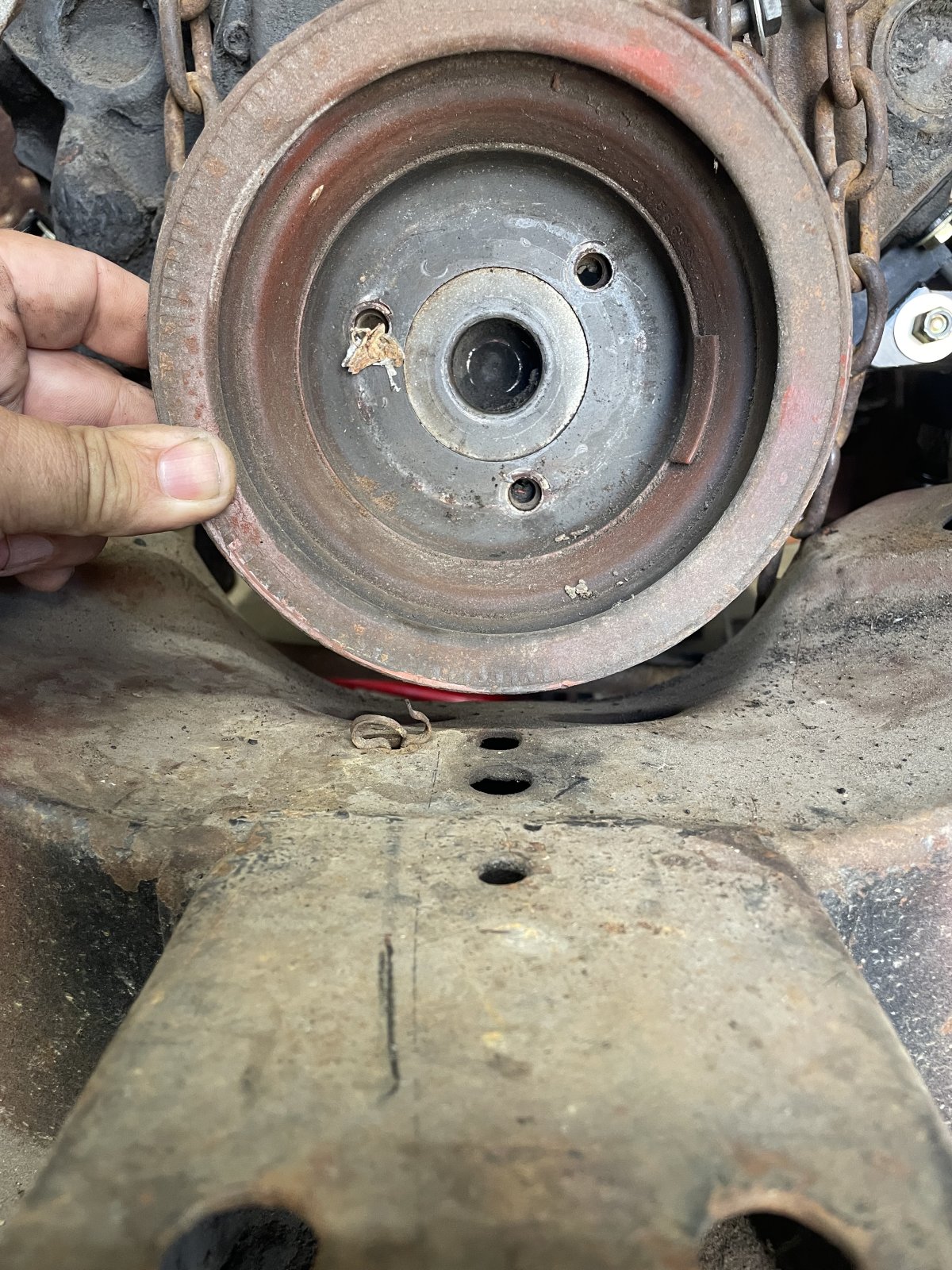

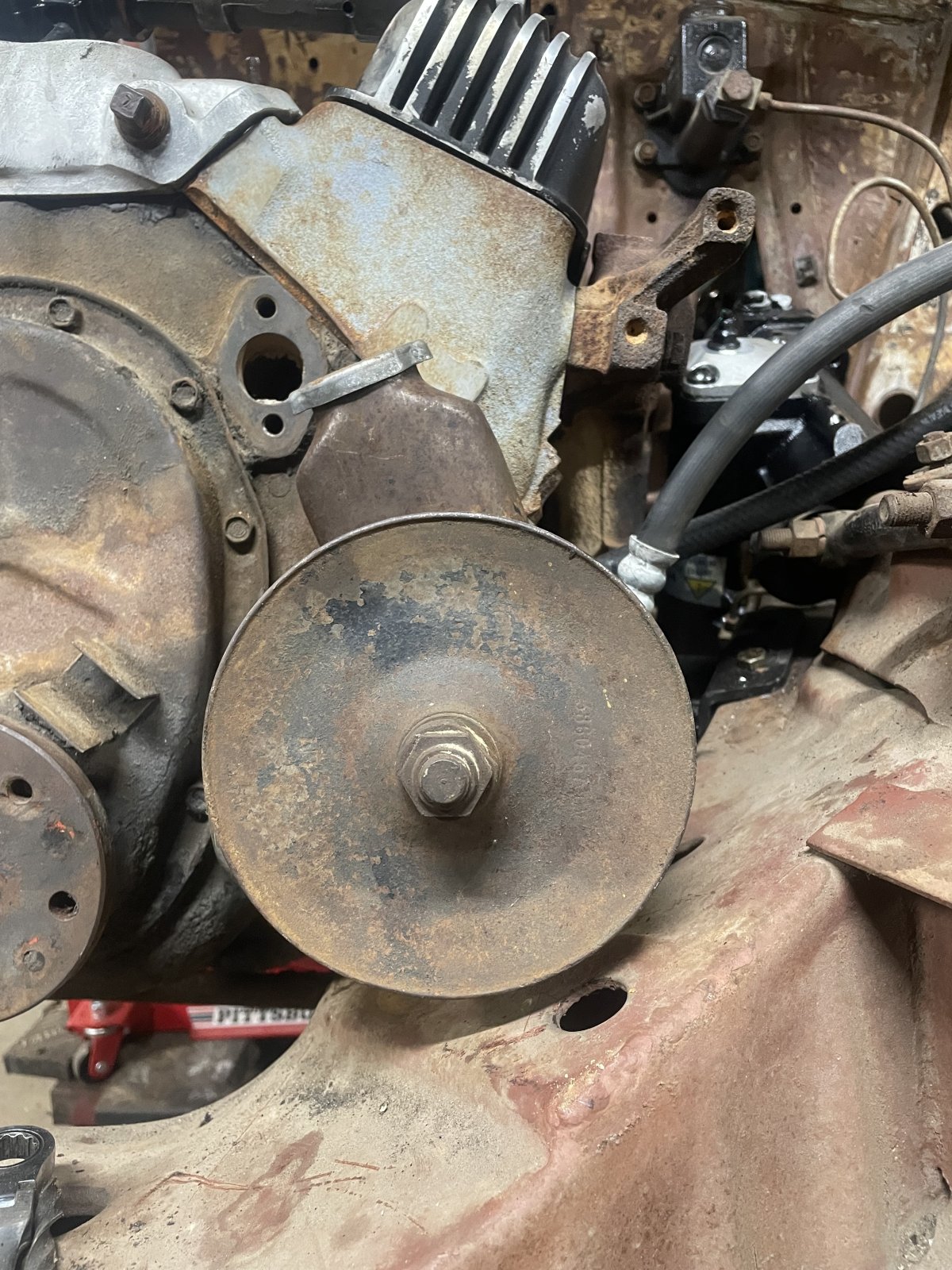

  23. Playing with some old parts I have
    Short pump PS bracket. Mid 60s.
    Hits the frame.
    I’d like to use the 63 alternator bracket that uses the rams horn manifolds.
    which brackets you guys using?
    I might possibly be able to raise this on up some.
    Okie Pete and warhorseracing like this.
  24. Moriarity
    Posts: 35,968
    Moriarity
    SUPER MODERATOR
    you may have to customize the PS brackets. 56 chevs that had PS had pumps mounted to the back of the generator.
    do ya need ps? I heard somewhere earlier today, good ball joints and skinny bias ply tires LOL

    A left side custom front mount used to be avaliable for the saginaw style pump, It doubled as a motor mount. I don't know if it's still avaliable. Try checking the Tri-Five vendor's.
    anthony myrick and lumpy 63 like this.

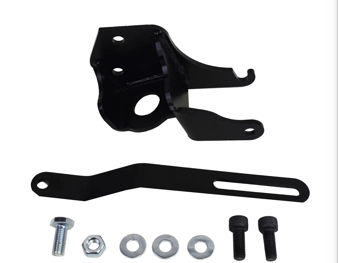

    I was looking at these and similar.
    probably need to mount an alt and go from there.
