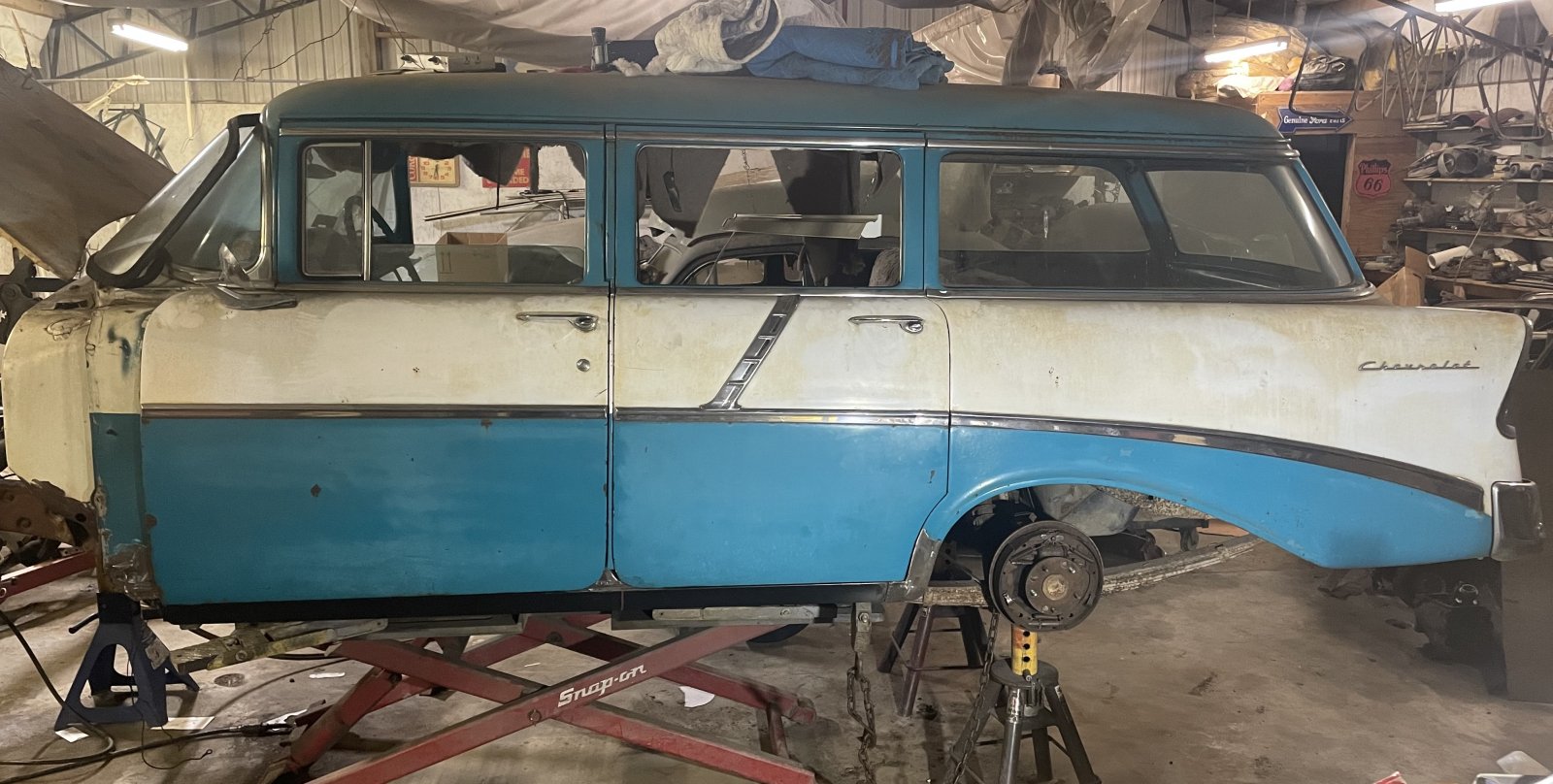

Customs Finally starting on the wife’s 56

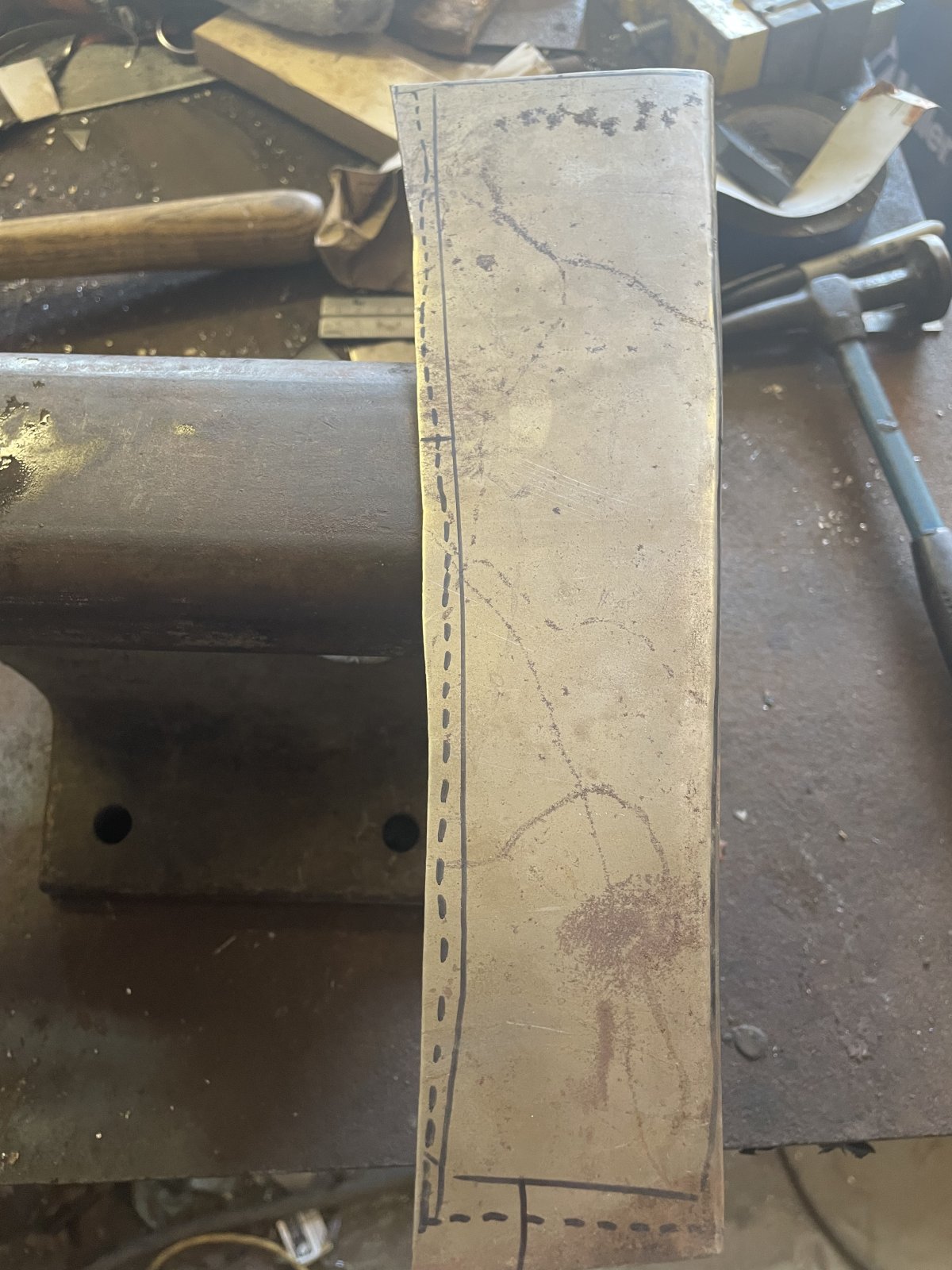

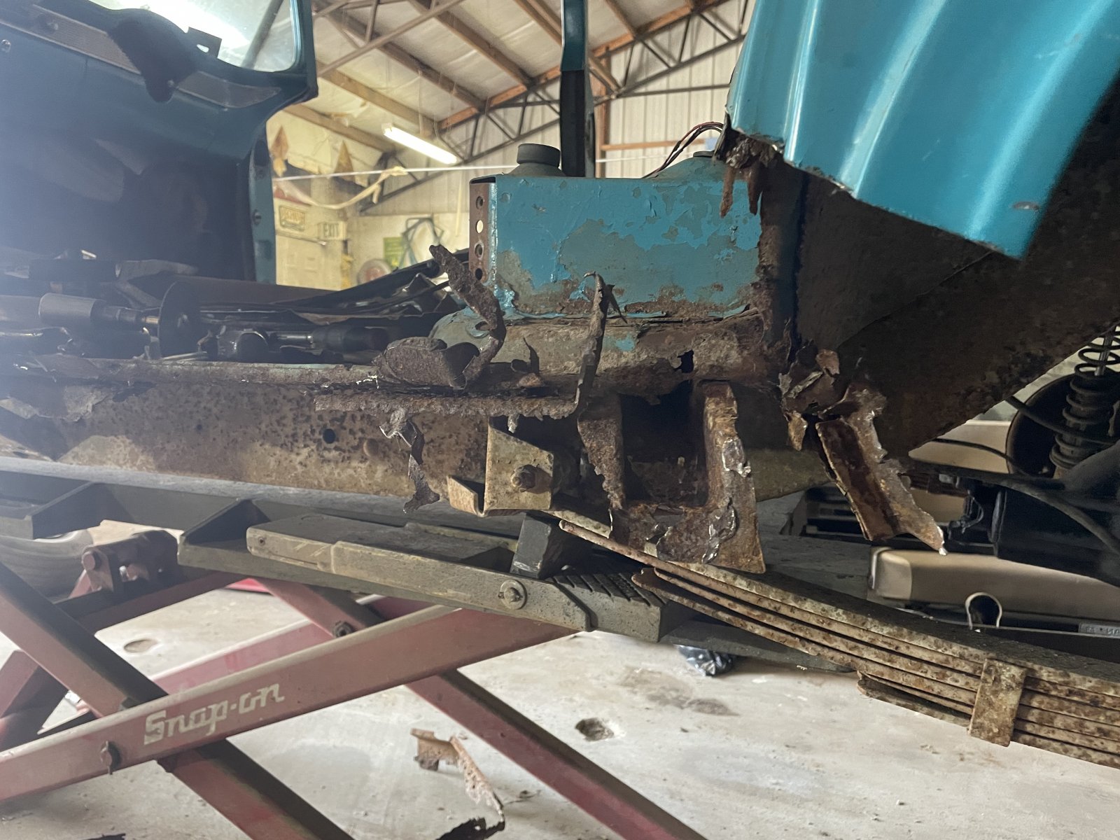

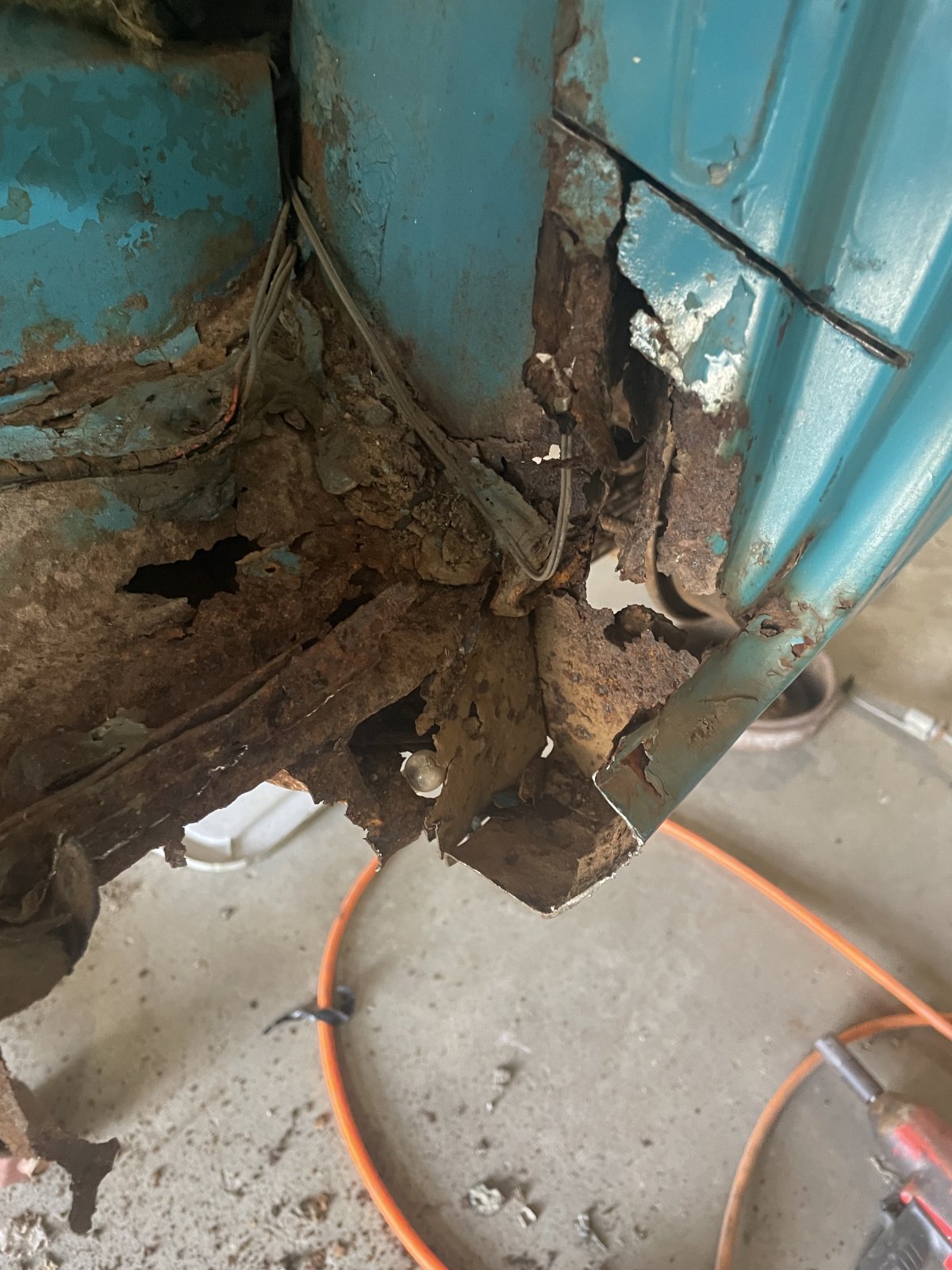

  5. Working on the dog leg
    Pattern from the better side
    transferred over and the flange bent with a hammer due to the curve.
    Shrinker stretcher used to work the contour.
    Hammered in the lower detail.
    Checked with a contour gauge from the other side
    used the pattern to lay out the detail in the jamb. Clamped to my bench and hammered the detail with a chisel body hammer struck with a rubber mallet.
    test fitting. I’ll get that gap to tighten up before welding.
    Then on to the next part of it

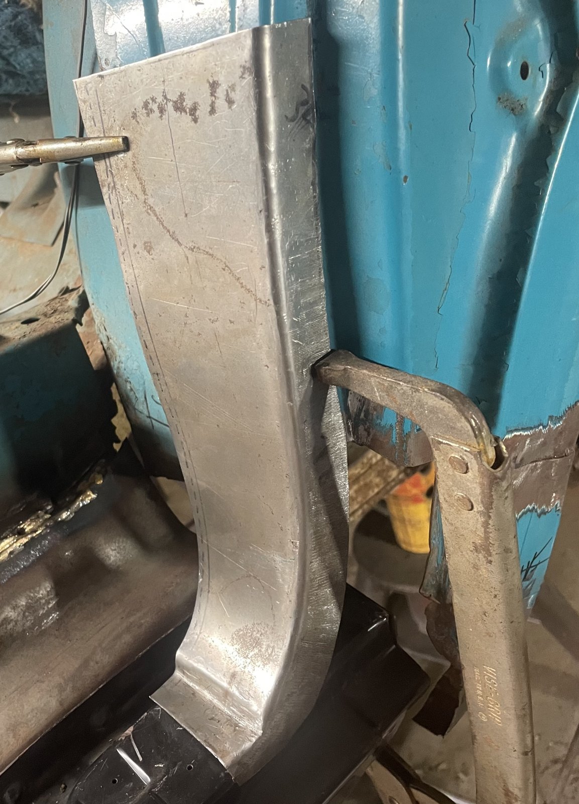

  6. Started on the rest of the dog leg.
    taped to the car. It’s just tacked together. Will remove and weld. ( Ran out of argon)
    It’s a little crude at this point but will work out once hammered.
    It’s easier to hammer and dolly off the car. I’ll wait and weld after I make the inner wheelhouse pieces and use this as a guide.

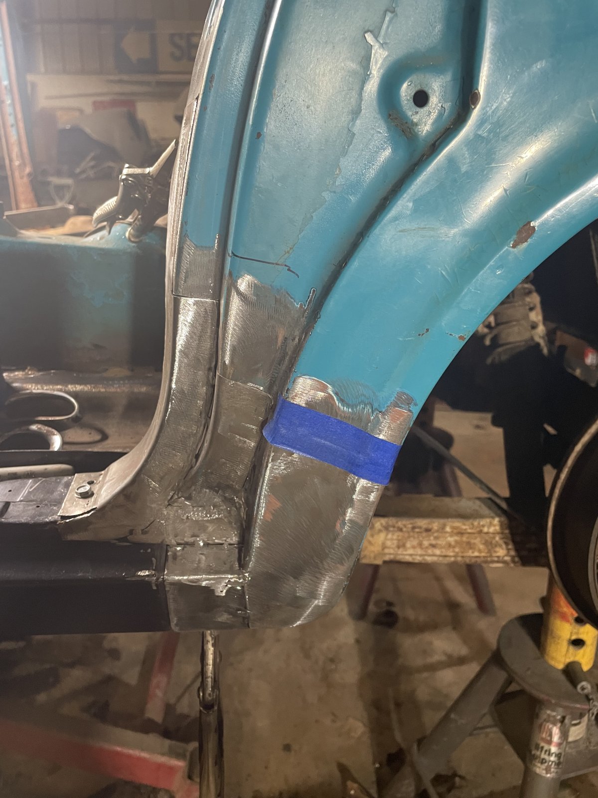

  14. I stepped this part down like I did for a reason.
    One is I don’t like straight across cuts. I guess that’s from my collision experience.
    second is i dodged adding some more work by only replacing what’s needed and avoiding adding complications to the shapes. I kept the pieces a size that works with my shrinker/stretcher. It’s depth is about 1-1.25 inches.

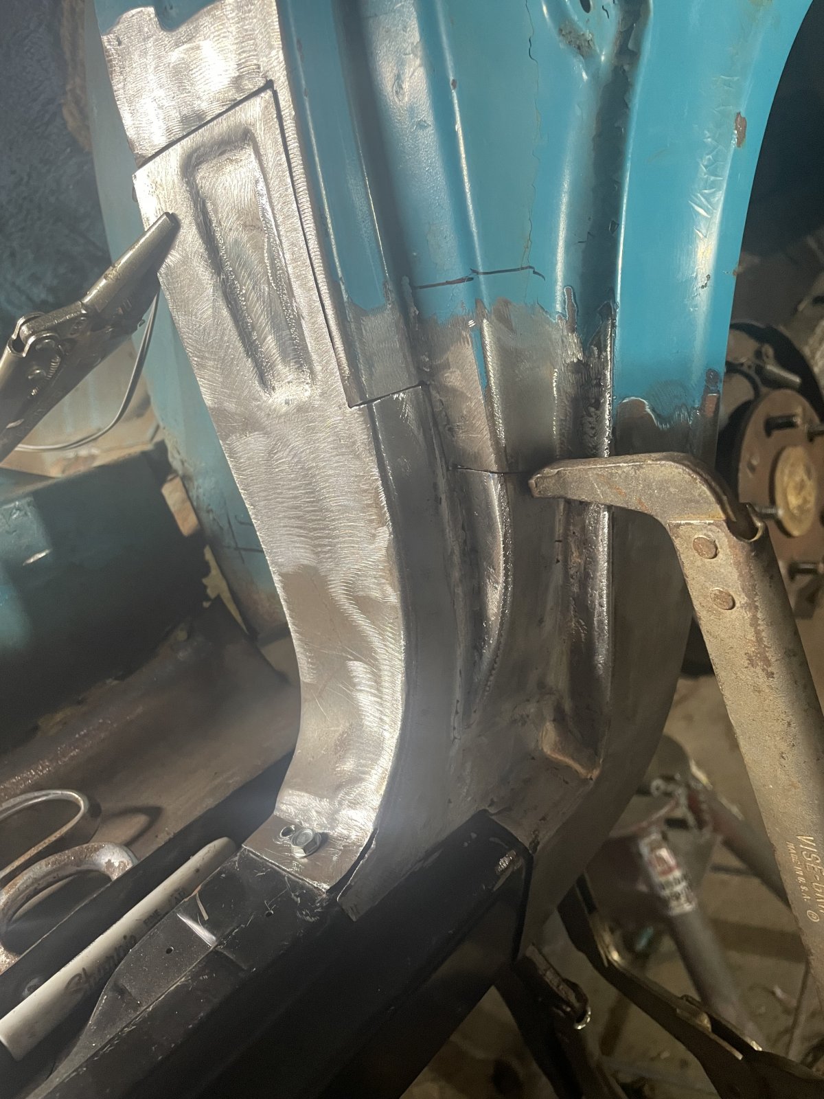

  15. When making shapes like this, you sometimes have to build in manageable steps.
    I like to weld in a radius and from the back side. Cuts down on finish work on the other side.
    The small inside radius is made by hand using pliers. Matches the OE shape and easier to weld. 905CFFCD-71FD-490E-A133-78FF4103B64B.jpeg
  16. Inner dog leg gettin close
    4238B156-2F08-4710-B828-BC83254C40B5.jpeg 181CAF14-0D66-4234-AECD-D02BC6479872.jpeg
    VANDENPLAS, Stogy, Okie Pete and 7 others like this.
  17. Got the inner wheel house roughed out.
    Little more hammer/dolly work, some trimming and it’ll be ready to go. It’s just tacked together. Checking the overall fit.
    That’s a long way from where it started
    264CC39F-EAF4-4D79-8E4F-74A9F780B03F.jpeg 0051AAF5-661C-460B-8D17-0F81F2B4802A.jpeg

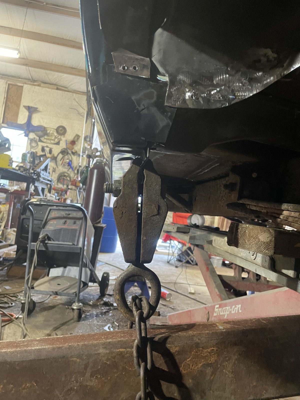

  18. Sometimes a gap tightens up during welding.
    It’s nice having some frame equipment around when that happens.
    The rocker gap tightened up on the rear door.
    The weight of the bar was enough to open it up.
    I’ll weld it with a tad extra and see how it goes.
