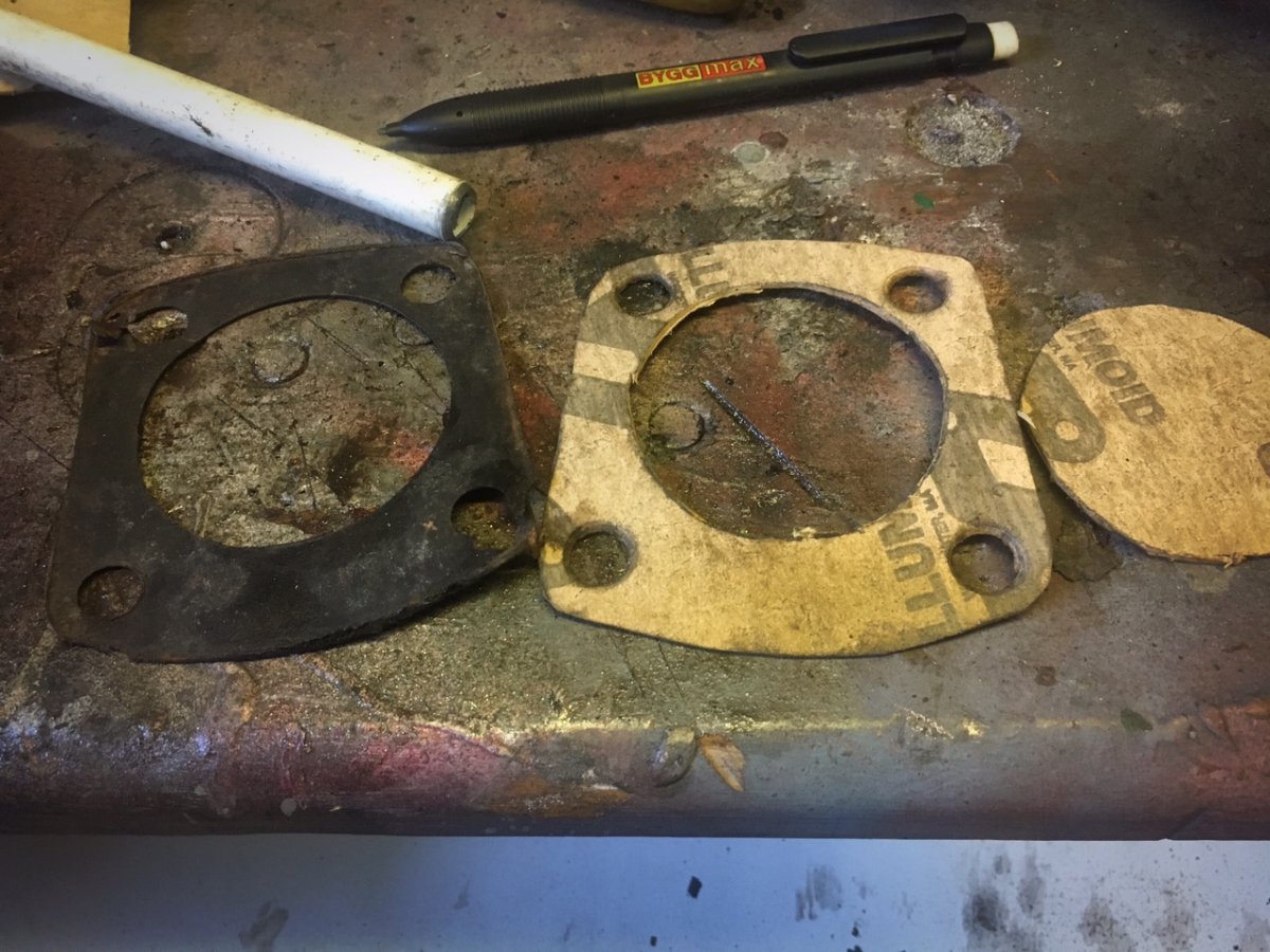

    I had to construct new gaskets for the waterpump and cooling water neck at the head.
    Luckily i got a big hunk of ”Vellumoid” from work the other year when the boss where clearing out old stuff. [emoji1417]
    I grinded the end of a thin steel pipe, so i could punch the bolt holes in my new gaskets.

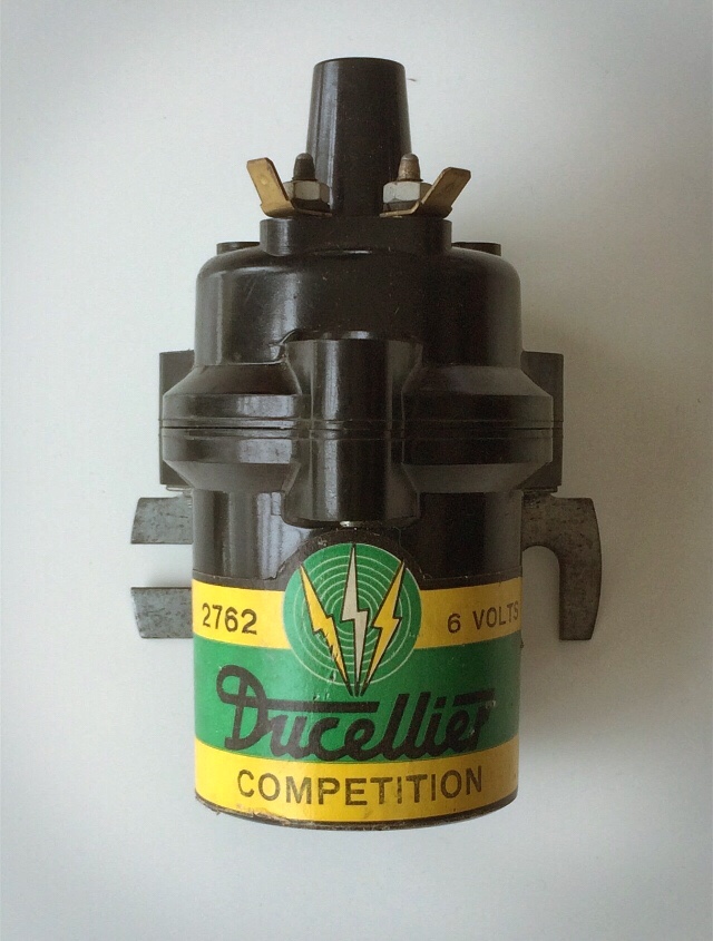

    It turned there was no spark, and the coil where to blame.
    Luckily i had a identical coil in my garage since i converted my Fleetline -49 to 12 volts, so i switched, and voila!
    Both of these are ugly, blue Bosch coils and i have bought a n.o.s Ducelier Comp coil from a guy online, he had this on a shelf since the 60’s.
    That one is the one i’ll put on the car as soon as it arrives my mail box.
