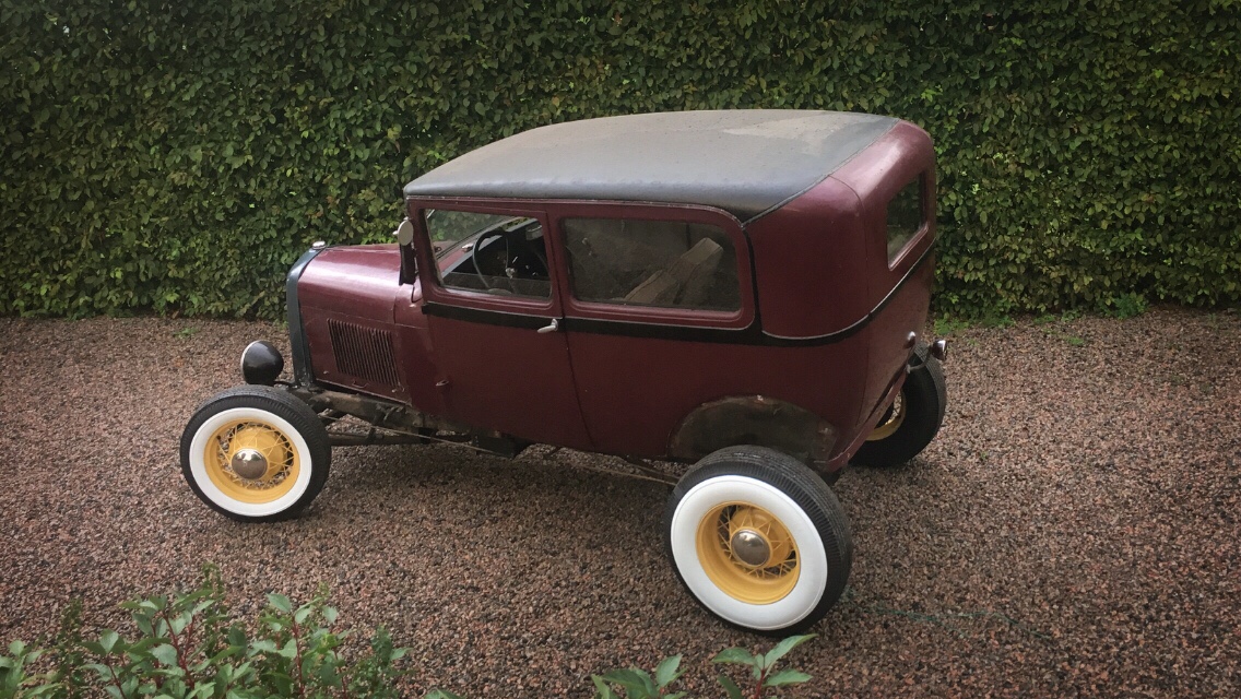

  1. Looking great Sid,
    How wide did they make the rear wheels? They look awesome. Thanks, another thing to add to my list!

    This is reversed eye springs front and rear with a heap of leaves removed. You can go dropped axle with mechanical brakes, believe you need 32 stub axles and brake components. 20190901_164849.jpg

    I suppose i’ll give the reversed eyes a try to begin with, even if its said to just lower about an inch or so.

    That stance is perfect, i’ll try the reversed eye as soon as i have my A p*** the last car inspection!
