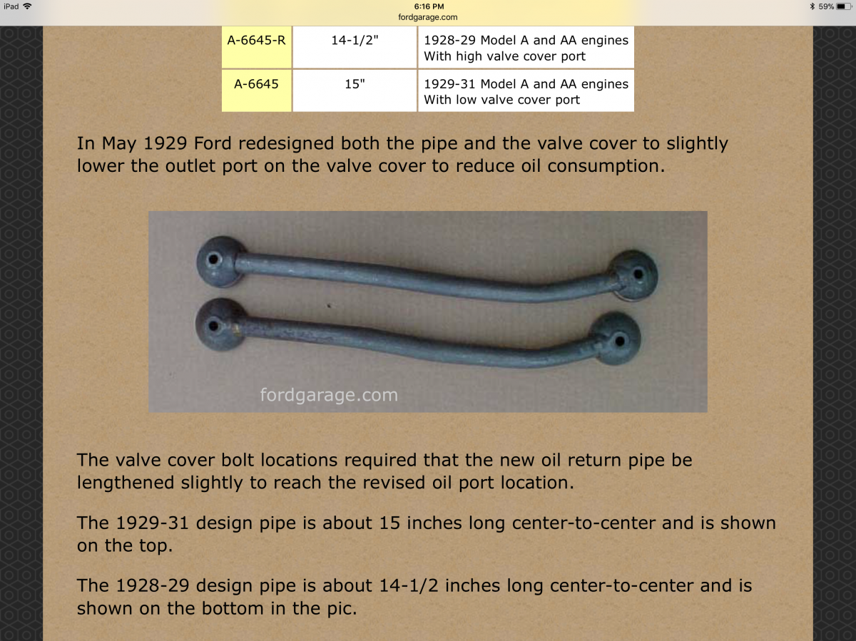

    I also found out that the original oil pipe was too short to fit the new valve cover, guess i’ll have to cut and longer...

  2. That side plate may be like the Riley. It is slightly longer and uses a 30-31 oil tube.
    Sid E. Burns likes this.

    Thanks man!
    I solved it with a hose, clamps and the angle grinder for now.
