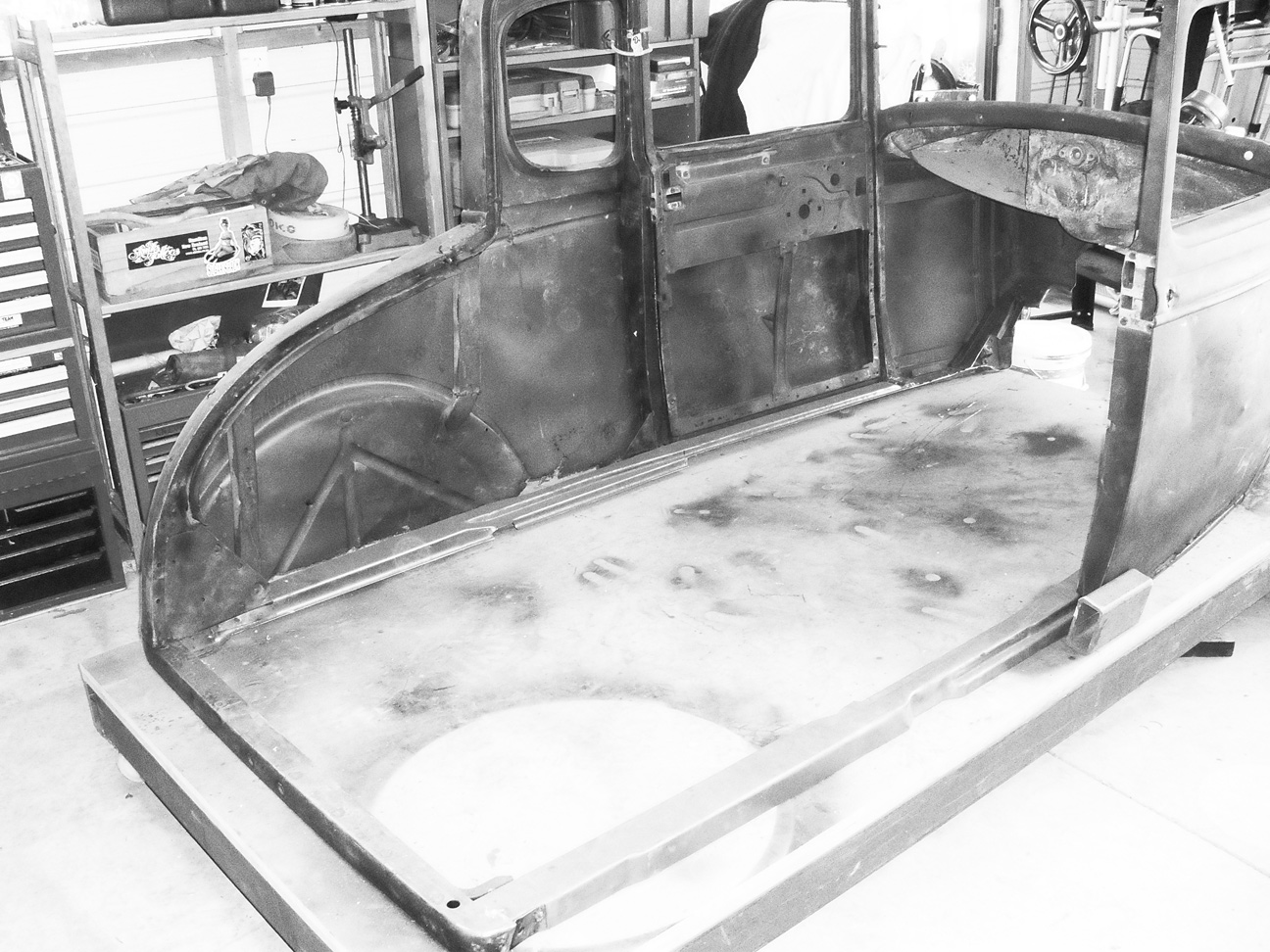

Finaly got to weld again after being paralysed.

    That pen does work, but requires you to roll the little wheel with
    your thumb to feed wire.
    I would let the wire 'freeze' in the puddle by backing off your
    torch slightly, slide your hand back to regrip wire. Now just get back
    in the puddle to free wire. Sounds awkward, but I have been doing
    for years.

    I am wondering if some sort of track mounted to your chair would work. You could have it adjustable for postion and even angle. Then you could weld on different areas without having to re-set your track on the project, just wheel up, lock the wheels and go!! Not sure if I am explaining it good enough, but I'm sure you'll come up with something.

    pretty cool. they used to make tig wire feeders for production stuff. keep your eye on the auction site. one should pop up. or maybe you can just use a mig to supply your wire. just dont ground it

  24. Could you put the tig wire inside a piece of 1/4" brake line and let the wire slide down though, rest the tube between your thumb and index finger on top controlling it with your indexfinger. You could probably rig something on your shoulder to rest the other end of the tube. Just an idea but might work , Rob.
