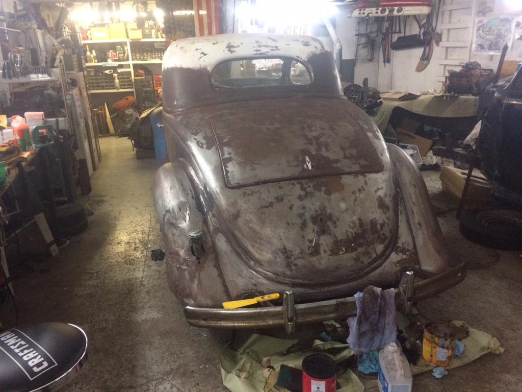

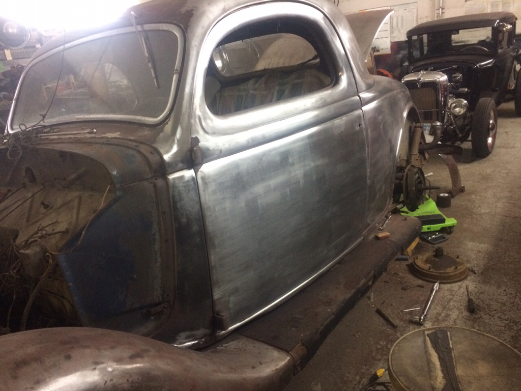

    Update! So it’s been a long strange trip. Had a rough winter last year, but finally started working on the 35. [​IMG]
    Slowly stripping the old paint off. [​IMG]
    No bondo in this old girl, all leaded. A few issues here and there but a pretty solid body. [​IMG]

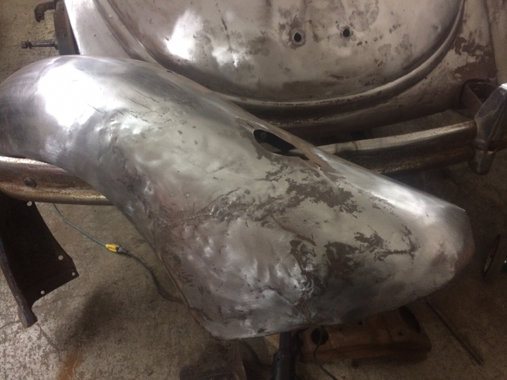

    Of course I found worse after tank was removed. Inner rear panel looked like Frankenstein with all the welds in it. Here’s the fender. [​IMG]

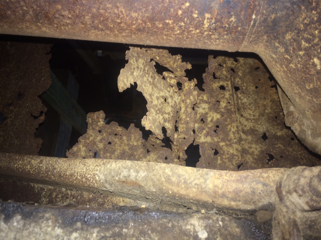

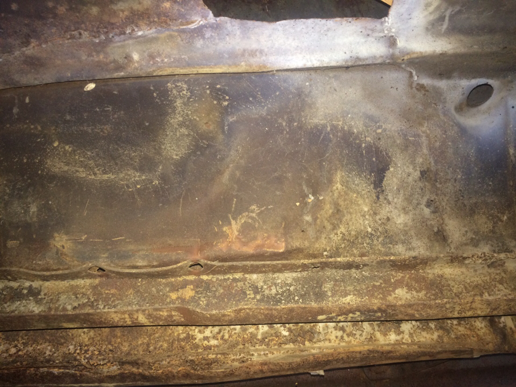

    The outer skin of the body is pretty good, a few spots of rust, but overall nice. The underside however![​IMG]
    Inner panel will need replacing,
    Rear cross member pretty tweaked, The holes you see are for the bottom of the spare tire mount. These are supposed to go through the crossmember.
    And the rear floor is Swiss cheese.

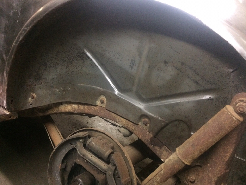

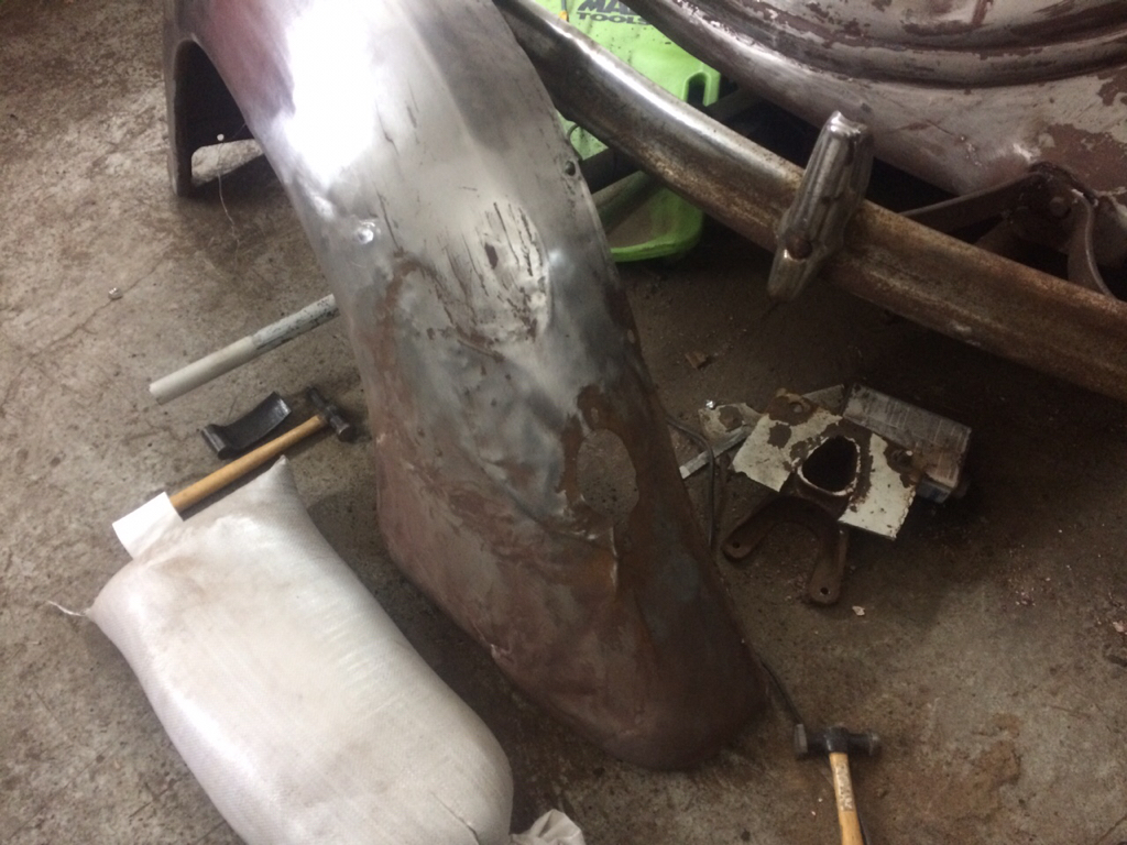

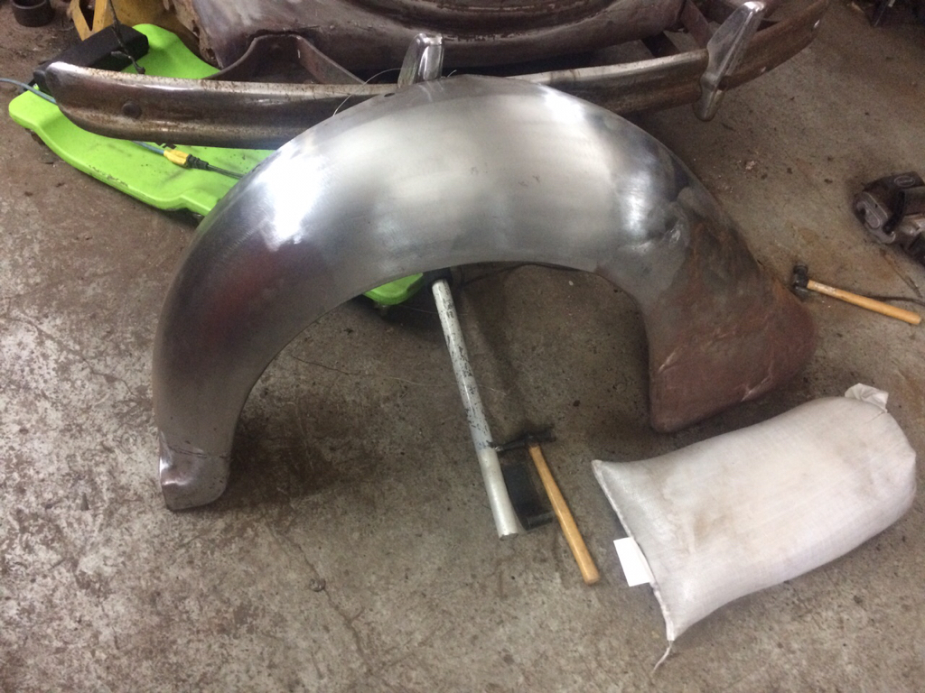

    Worked on the drivers side fender today, now I’m no body man by any means. Straitened it out a bit thanks to my Christmas gift from my son, Eastwood dead blow panel hammers and leather beater bag. [​IMG]
    The inner fender well is in surprisingly good shape. [​IMG]

    Looking better there bud! With some hammer and dolly work, you should be able to get that fender straightened right back out. You’ve got the benefit of no underlying support structure that would restrict you from getting a dolly on the backside. I know you said you’re no body man and I certainly don’t claim to be, but I’ve had some pretty good experience with help from some very talented people over the years. With that, I’ve got a couple tips for you if you’re interested (you may already know these techniques from your experience with your dad).
    I recommend using the ‘off dolly’ method as much as you can. This is where the dolly is placed on the underside of the panel and pressure is applied to the low spot. Using a FLAT faced body hammer, gentle but firm/precise hits are made to the surrounding high spots ( off the dolly). When you hear the ‘ping’ of the dolly, stop and move; a ping represents stretch and a stretch will potentially need shrinking. The idea is that you bring the low spot up using pressure from behind while gently moving the high spots down. I always find it good to check the location of my dolly with my hammer...very slight taps (it’s like just touching the hammer to the metal) will give you the sound difference to confirm your dolly placement.
    If you have substantially low areas that you’re not able to raise with ‘off dolly’, then move your dolly to the top side of the metal, and using a ROUND face body hammer, knock the low areas up using the ‘on dolly’ method (hitting the low area directly below where you’ve held the dolly). Again, when you hear the ping, you’ve raised the metal and have contacted the dolly...keep moving.
    My general rule is FLAT hammer for outside, ROUND hammer for inside. Always choose the dolly that most closely matches the contour and remember ‘ping’ means stretch.
    Also, it may give you better support to remount the fender and do the hammer and dolly work on the car. Ergonomically it may be challenging, but the fender will be less likely to move on you in a fixed position versus on a stand.
    There is a great book that describes all these techniques. It’s in reproduction now and should be readily available. I’ve posted a photo below.
    Finally, I would recommend investing in a shrinking disc. It’s a stainless disc that attaches to a angle grinder that targets high spots in metal. The spinning of the discs injects heat to ONLY the high spots, and when quenched the metal shrinks back to its original position. It’s sorcery man!
