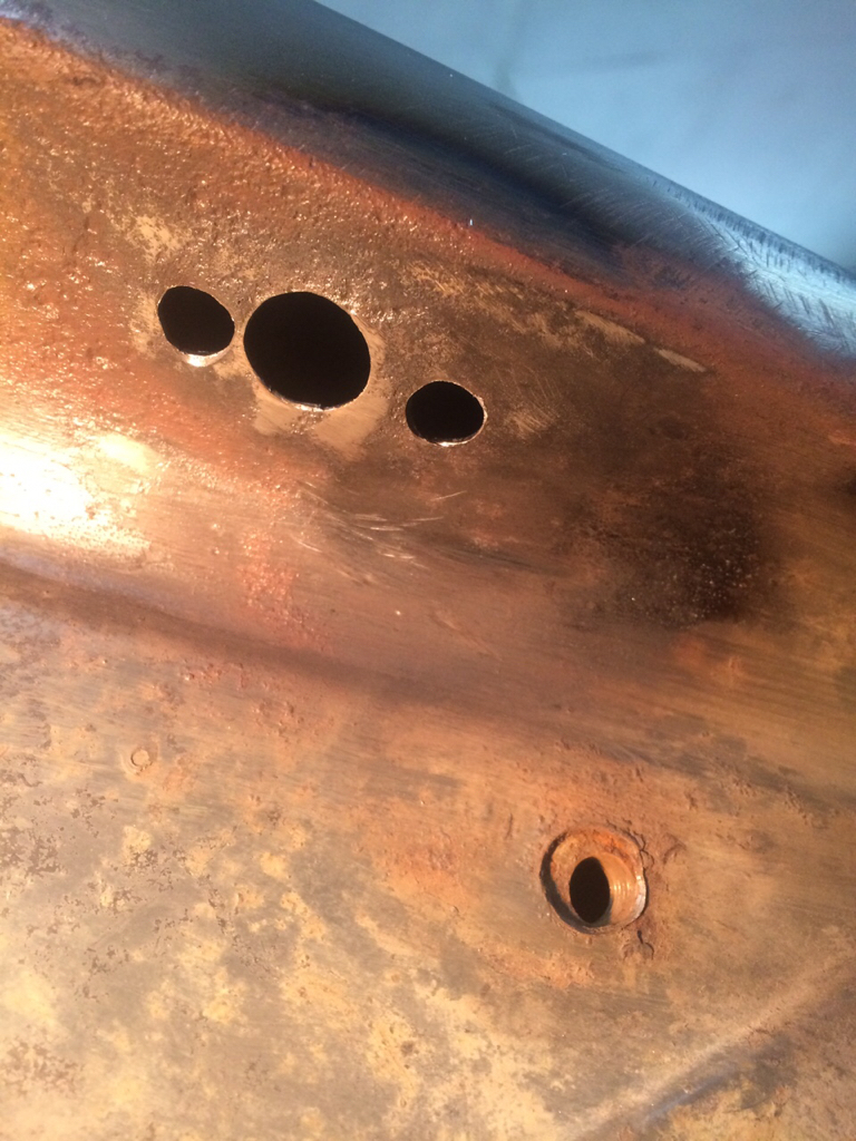

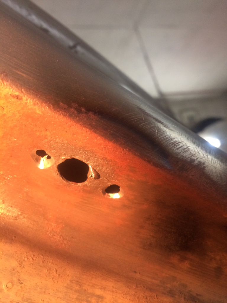

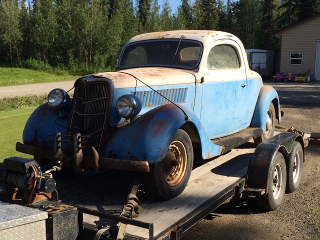

    Decided to put the fender back on today. But first couple of the blind nuts needed attention.[​IMG]
    So I drilled out the spot welds, opened the holes up a little bit, and decided to install some new 5/16 x 24 nuts available from most suppliers. [​IMG][​IMG][​IMG]
    I made a jig to hold them in place while I welded.[​IMG][​IMG]
    A little smoothing and good as new [​IMG]
    Now I can remount the fender.[​IMG]

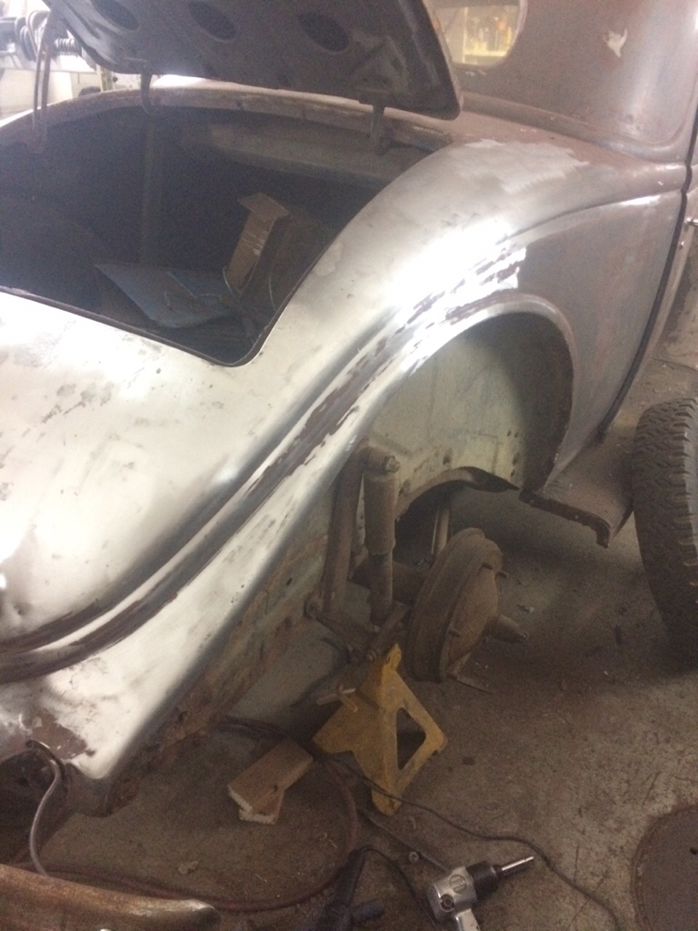

    So on to the right rear fender while I’m waiting for a miracle to fix the left rear :)
    It didn’t look that bad, still something wasn’t quite right, it came off a lot easier than I expected. [​IMG]
    But when I turned it over I found out why it seemed a bit different than the left.[​IMG]
    It looks to me like somebody used a sedan fender and grafted it on to the existing coupe fender.
    This is evidenced by the leaded seam the entire front portion of the fender.
    Still they did a good job and it cleaned up pretty well.

    Looking good Ralph! A shrinking disc will work some magic on those high spots. Also, I made myself some slapping files out of some old files I had laying around. I find they’re helpful as well for really fine high spots; the pattern in the file can help shrink the high spots. I’m always amazed at how much you can ‘move’ metal.

    Okay, I metal bumped till my arm fell off! Wow you use muscles you never use.
    Got tired of it and went to clean up the right rear fender and quarter a bit.
    Sent from my iPhone using The H.A.M.B. mobile app[​IMG][​IMG][​IMG]
  15. Ralph Moore
    Joined: May 1, 2007
    Posts: 663
    Ralph Moore

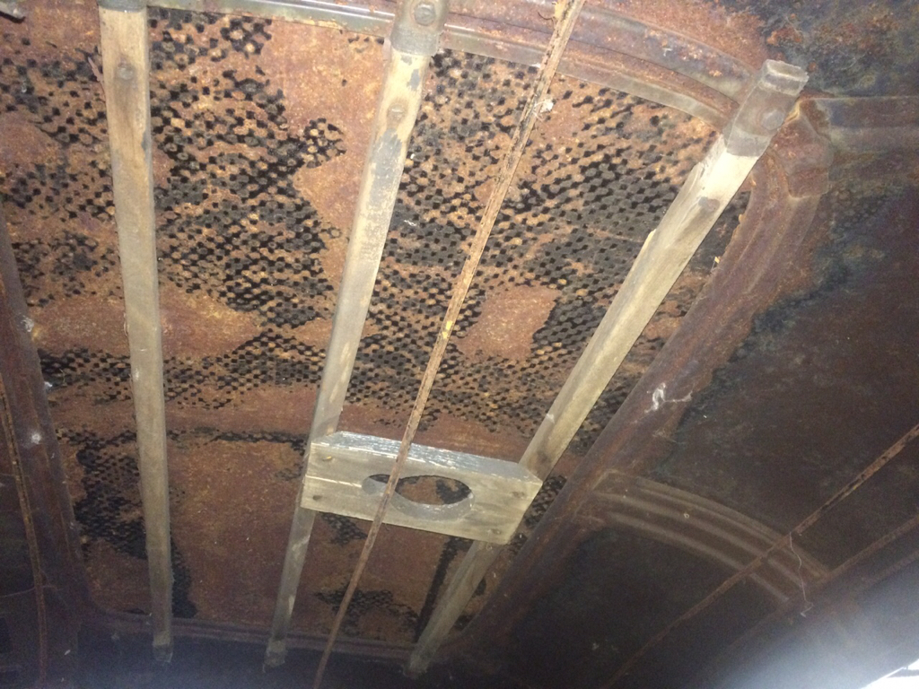

    Working on the roof and rear window area today, quite a bit of surface rust on the replacement roof panel they used. All done in lead back in the day.
    I’m going to have to tweak it a bit as it’s not quite perfect. [​IMG][​IMG][​IMG]

    Looking very nice! Someone did a nice job leading that panel in. From the inside can you tell if they removed any of the original insert structure?
  17. Ralph Moore
    Joined: May 1, 2007
    Posts: 663
    Ralph Moore
    dana barlow likes this.
  18. 50DropTop
    Joined: May 6, 2004
    Posts: 212
    50DropTop
    If it was just leaded in, removal would be pretty easy. A little heat from a torch and the lead could be easily removed with a wire brush. My concern would be if the inner lip which holds the weather stripping in was removed when the roof was added. I believe this lip sat slightly higher than the crown of the roof where it meets the weatherstripping channel. If I get some time tonight, I'll take a photo and show you what I mean. Of course, all of this doesn't matter if you intend on keeping the roof filled.

    No plans to remove the roof panel. I’m going to leave all the 1950’s mods on this car, the only external things I’m really changing other than the paint( and dents), is the wheels, going back to 16”wires, and headlight lenses. I’m taking out the sealed beams and putting original style lenses on with halogen bulbs.

    It would make sense to leave the wooden strips in place because the original type headliner would be tacked to the strips.
