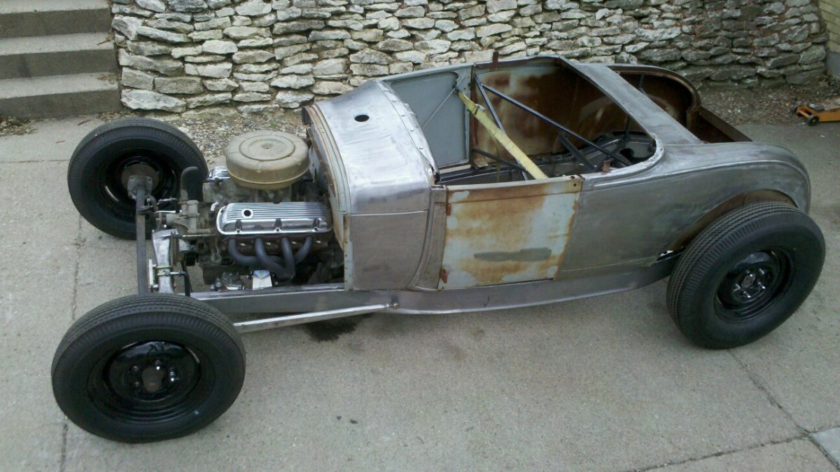

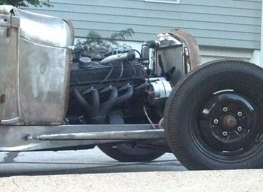

    Curious, is that a stock A frame and is body bolted as-factory?
    Seems with all your clearance reversing the firewall wasn't needed...heck, a SBC doesn't leave that much room!

    Pete, it's late & I don't feel like typing a bunch. I found this list of tips on Welders Series. He has built a ton of cars and ch***is and manufactures high quality parts including the style of mounts you are using
    Points to consider (in no particular order):
    . Many factors affect the location of the motor in a street rod ch***is. Plan ahead.
    . The frame should be at ride height and rake when mounting the motor/trans.
    . Get Inline Empire Driveline tech sheet re driveline angles. (http://www.iedls.com/ptsetup.html)
    . Carb does not have to be level, but try to be close.
    . Pinion angle (up at the front) should be the same as the crank/trans angle (down at the rear) and the u-joint angle should be 3 degrees or less.
    . Crank c/l does not have to be in line with the pinion when viewed from above.
    . Crank/transmission line does not have to parallel with the frame c/l when viewed from above. e.g. The transmission is in the center of the frame (located because of the stock x-member p***age) and the front of the motor is offset to one side (usually the p***enger) for clearance. The 3 degree u-joint angle is the determining factor, as above. (Per Inland Empire Driveline/Armando)
    . Have motor/trans to know the clearances required.
    . Have the rad mounted. It often can be moved, but sometimes must be in a specific location (and sometimes on an angle).
    . Know what fan will be used so clearance can be planned.
    . Have the body mounted.
    . Have the firewall or be prepared to custom make it.
    . The floor might have to be modified for trans clearance.
    . Headers & steering will want the same space. Consider this when positioning the motor.
    . Rubber OEM mounts absorb more engine vibrations than urethane 4-bar bushings. The urethane 4-link bushing mounts usually look more “high-tech. Use the mounts that suit the style of your project rather than worrying about the amount of vibration transfer. It won’t be that much different.
    . Plan hood clearance.
    . Have the water pump installed so clearance can be planned.

    It hard to say because you need to more parts to the puzzle. This is when you can box yourself into a corner and create more issues.
    I feel the steering box and shaft column need to be addressed first and tacked in place for proper alignment . As @redo32 and Steve said headers like the same place as the steering box. You didn’t say what box your using so I will guess at a Vega . With a Vega box it will go forward right where you motor mount is. This placement for the box is for a few reasons to clear the short oil filter in the front of the engine. The motor mount will be on top of the box with engine mounts like @RICH B . They are super easy to make and inexpensive rubber donut mounts. I also see the header dumps Back and remember you need to get a steering shaft thru .
    I have put a number of 302s in the early fords and these are the issues I have faced.

    How is it too far forward when there is room for a normal water pump, a normal mechanical fan and a fan spacer in the front?

    Stock '30 frame.

    Like the others have said, You're getting your steps out of order.
    Before you try to set that engine in, you need to mock up the front suspension, put the radiator on, check your hood and grill shell fitment, mock up the steering, then put all of the engine accessories on the front of the engine; then that will tell you where to place the engine. Also, if you're going to box those frame rails, you should be doing it before you try to build the motor mounts.
    If you place the engine too high, your fan will hit the top radiator hose. If you place the engine too low, your fan will hit the bottom radiator hose. If you place the engine too close to the radiator, your fan will hit the radiator. If you place the engine too far back, the fan wont pull air through the radiator.

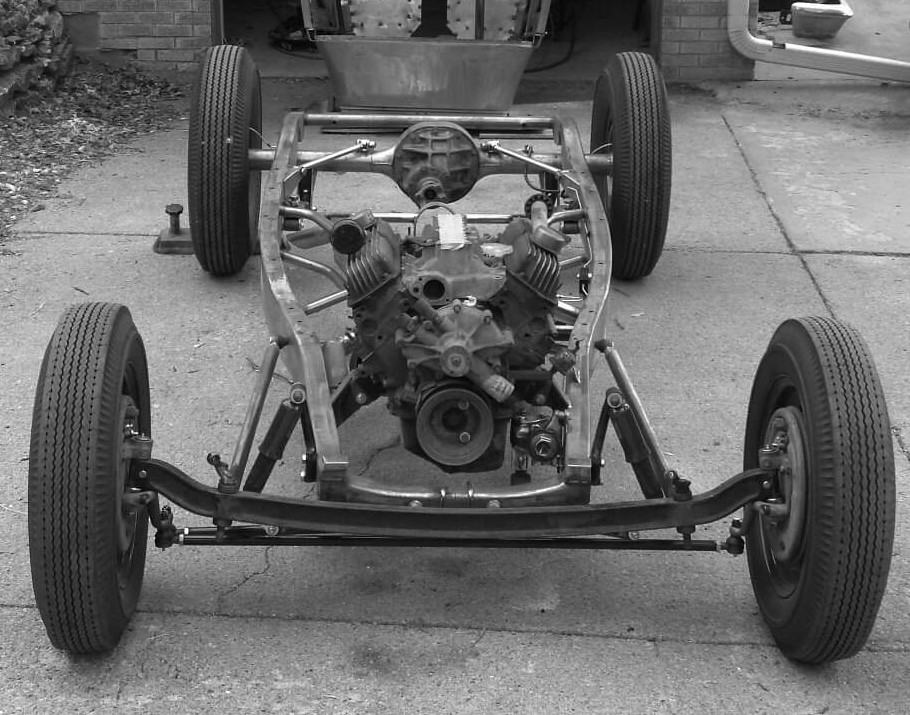

    You can learn from my mistakes. I built a 1935 Ford PU in the early late 90's-early 2000s and put a 302 SBF in it, which I sold it about 15 years ago. When I built it, I set the engine too low so my answer was to use a electric fan. I should have re-built my motor mounts and raised the engine up. I also used a MII front suspension, so clearing the steering was easier.

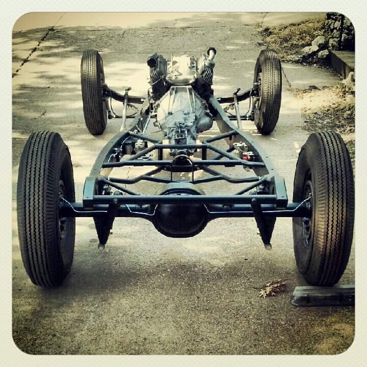

    I tried to have as many components as possible in place before final engine/trans placement.
    The SBF was a tight fit. Had to flatten the firewall and mount the radiator over the front axle. (spring behind arrangement). Lots of planning, measuring, research to make it all happen.
    Vega box is located just forward of the driver's side engine mount. Steering column and u-joints/shaft all had to get packaged in, as well.

    I have been building cars my entire life. I taught Auto Shop for 20 years as well. I'm not a newbie. I'm an oldie . .that hasn't built a Model A.
    I promise you I do not need to mock up anything on the front of the engine. I restore Mustangs professionally. I have built so many SBfs, I know exactly how much room the front needs depending on what I am using. Not an issue. Drop that one guys. The radiator is going to sit in the original location. I will not be using a full hood, but the distance will be stock, not an issue. Steering I am working on now. I asked a question about placement of the Vega for something to bounce around. Instead **** heads like badshifter have to try and start something rather than answer the question. if he has no answer, then stay away. I have answered every question posed to me, that was reasonable. I have considered many thoughts and thanked people for their input. But people that just want to start something piss the hell out of me. Don't need them. I appreciate your mistakes, thanks

    Malcom, thanks for the Vega info. Did you see my firewall is reversed ?Do you have some detailed build pics of yours? I'd love to see more.
  15. Malcolm
    Joined: Feb 9, 2006
    Posts: 8,189
    Malcolm
    from Nebraska
    Some of these may or may not be helpful.

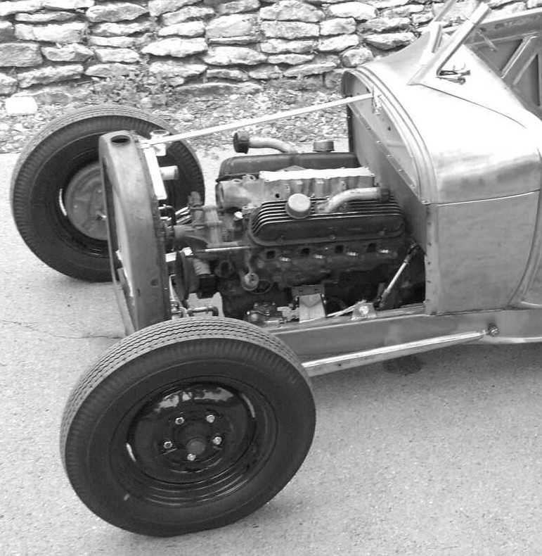

    As a packaging exercise, using a 29 body on a deuce frame as an example is a red herring. The OP has a 30 body an an original frame.
  18. PetesPonies
    Joined: Nov 6, 2007
    Posts: 402
    PetesPonies
    from Maryland
    Original frame yes. Original cowl yes. Original body?? Not so fast :)
  19. Malcolm
    Joined: Feb 9, 2006
    Posts: 8,189
    Malcolm
    from Nebraska
    I know... Just trying to help with some sort of visual reference.

    Have you thought of using a early Mustang steering box @PetesPonies and being a mustang guy it would be in your wheel house. They mount under the framerail and were very popular in the early 70s and on.
    I usually put the motor as close to the firewall as I can as nothing good looking about empty space . Then if you have extra space in the front you can always add a Paxton supercharger . Plus with the extra room up front you can use a standard waterpump instead of a Motorsport short one . It is great to see a 289 302 in a early ford and great little motor..

    Just funn'in ye about too far forward so get an FE!!
    I was jus say'in....in an early cl***ic Mustang the engine is placed where you can SEE a good bit of the bell housing between the engine and firewall...giving the impression that the engine could be slide back about 6 inches more to look right. Since you have a reversed firewall this will NOT be one of your problems. (although.....it may be an issue if you ever need to drop the ****** and bell to replace the clutch or something.) You could always have removable panels inside on the floor to access the bolts and linkage.
    Just thinking out loud.

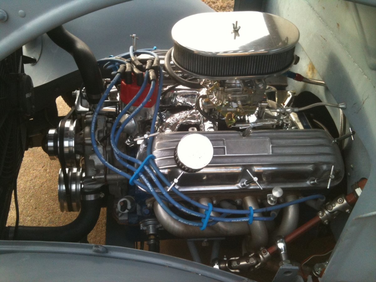

    This is a TCI Frame , comes with the motor mount location pre-determined
    Cooling needs to take place at the upper area of the Radiator , so electric fan or Shroud needs to be used

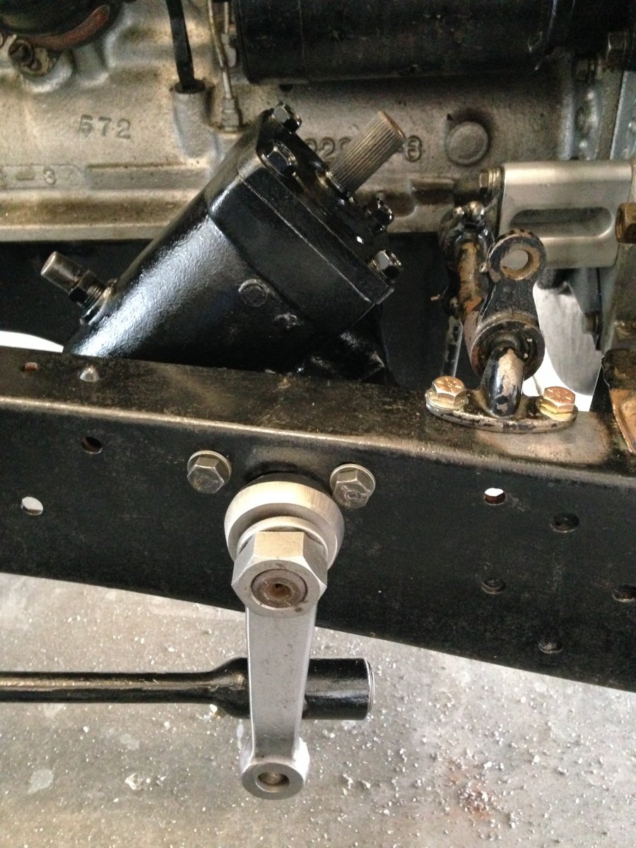

    IMG_0823.JPG Ah yes the incredibly rare F1 steering box only exported to Japan after the war!
    (Aka Toyota 4x4 manual box.) works great with a triangular flange welded to it like an F1 box. Mine is in a 34 frame and it clears a Desoto hemi. With a sbf you will have tons of room.

    ^its adjustable, has no slop and is recirculating ball design. Steers with one finger when parked.
