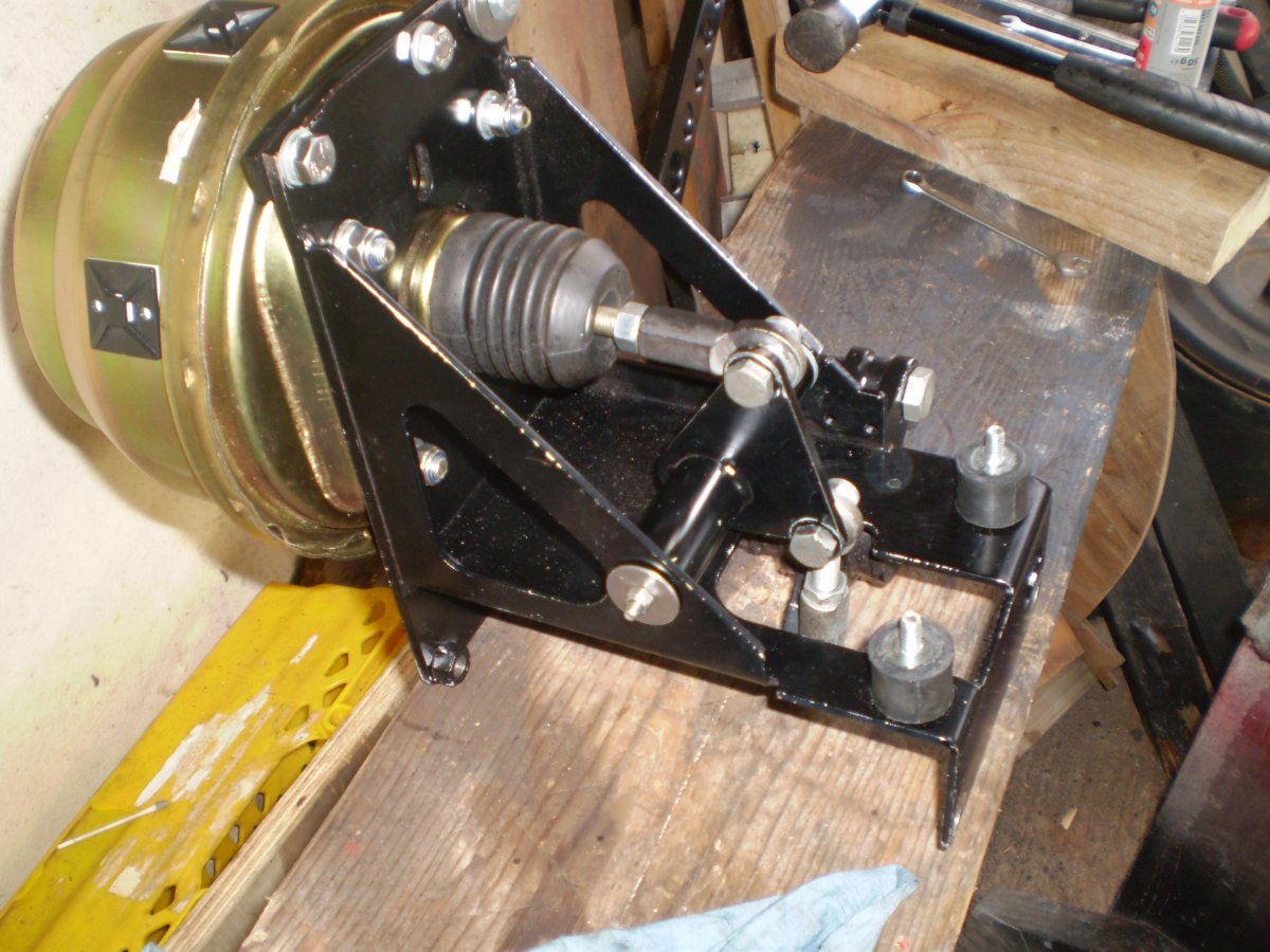

    fitted the new wheel bearings and reshimmed them.another issue surfaced.the pivot in the underdashbrake ***embly has play in it its a new ***embly and I expected better.there were two issues here.ita a 7/16 bolt.the holes where it ran through the bracket were too big and the nylon bushings on the shaft were a little loose.allso the bolt was threaded where it ran through the bracket.on one side.we reworked the pivot using a longer m12 bolt.turned down to give a nice fit in the nylon bushes.at this the bolt was slightly too big for the holes in the bracket.a small rub of a round file opened these holes up for a snug fit.cut the bolt to correct length plus a few thou.drilled and tapped the end of the bolt m5.locktighted a m5 stud in thereand used a bodywasher and locknut to hold the pivot ***embly together..the hex end of the bolt has a tab to stop the bolt spinning.we machined the head of the bolt to fit snug against the tab.im very happy with how it turned out,a much better job than it was when new pivot spins freely now with no play.thanks to mick at ducafe/medaza. brake assembly 004.JPG

    fitted the pedal ***embly.next move is to reroute the brake lines to the front calipers.ive a feeling that a junction is holding some air.the plan is to remount it in a vertical position so it will bleed itself.

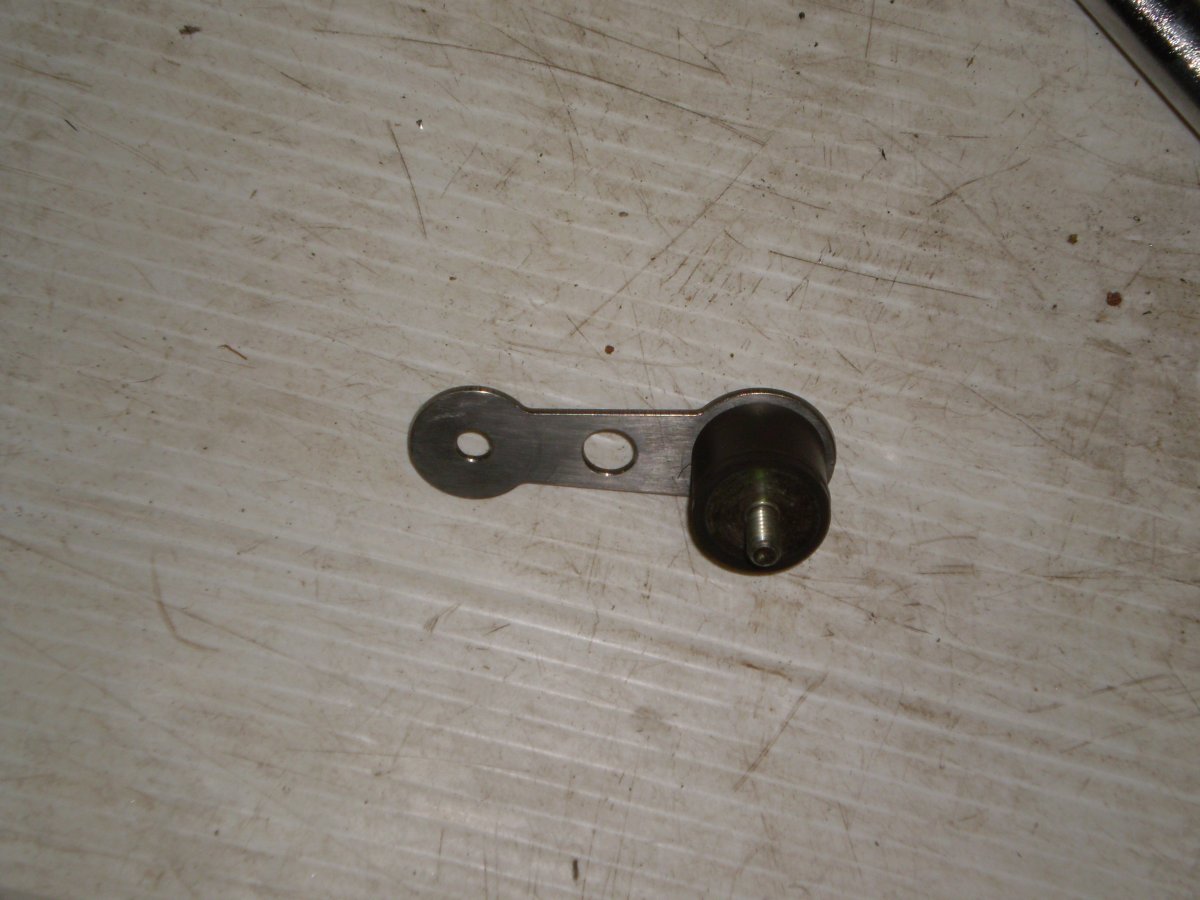

    made some progress today made a tab to hold the fitting drilled and riveted it to the crossmember.had to strip a fair bit out to drill the holes.was going to tap for stainless screws but in the end riveted it on.dry ran everything on the p*** side looks like it will work.finish this side off tomorrow .

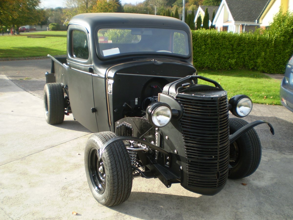

    p***enger side completed

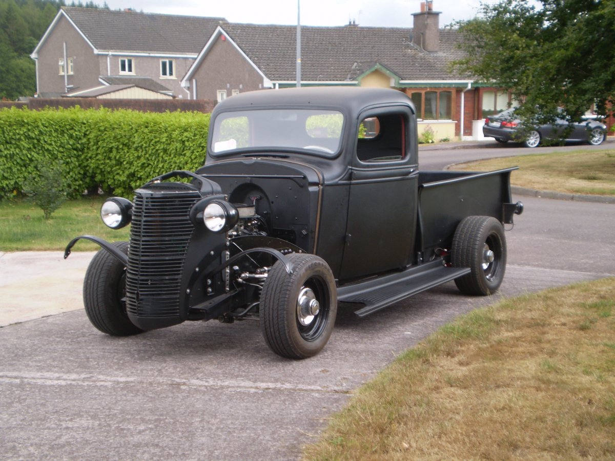

  11. I haven't been on here much lately.
    Good to see it coming together !
    Looks great in the driveway!
    nunattax likes this.

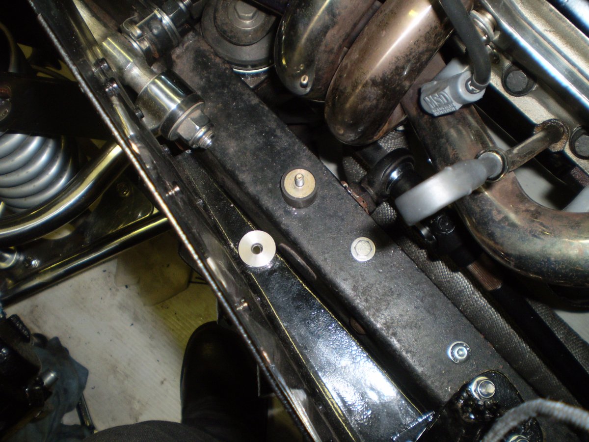

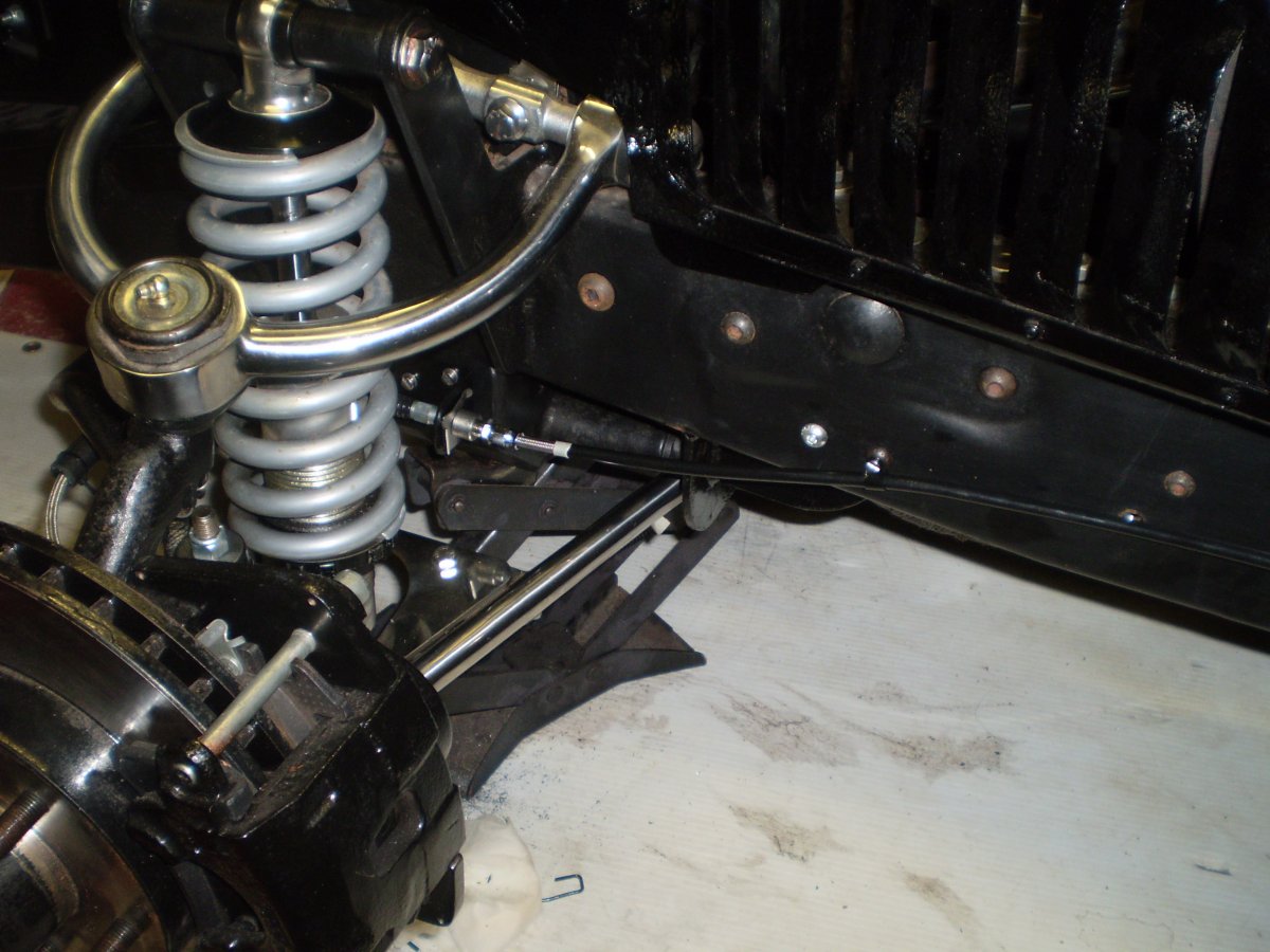

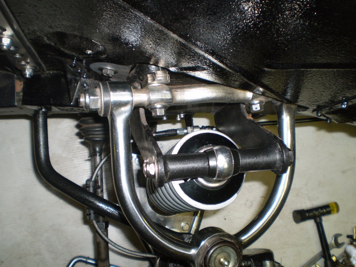

    front brake line second attempt 004.JPG finally got around to the drivers side front brake line..ran it down the A pillar and along the outside of the frame.away from the exhaust heat this time . i used domed allen bolts to plug any holes in the frame..where I needed a clip to tidy the brake hose I drilled the centre of the allen head and tapped for m4 stainless screws..i like stainless everything especially where its out of sight and out of mind.i like the black nylon coated Goodrich hose.disappears against a dark blackground.from my local Harley dealer.ive given the hose a dry run ,its ready to go except for final ***embly. front brake line second attempt 002.JPG front brake line second attempt 003.JPG
    once I get a proper brake pedal it will be time to replace the fenders and running board I cant wait.

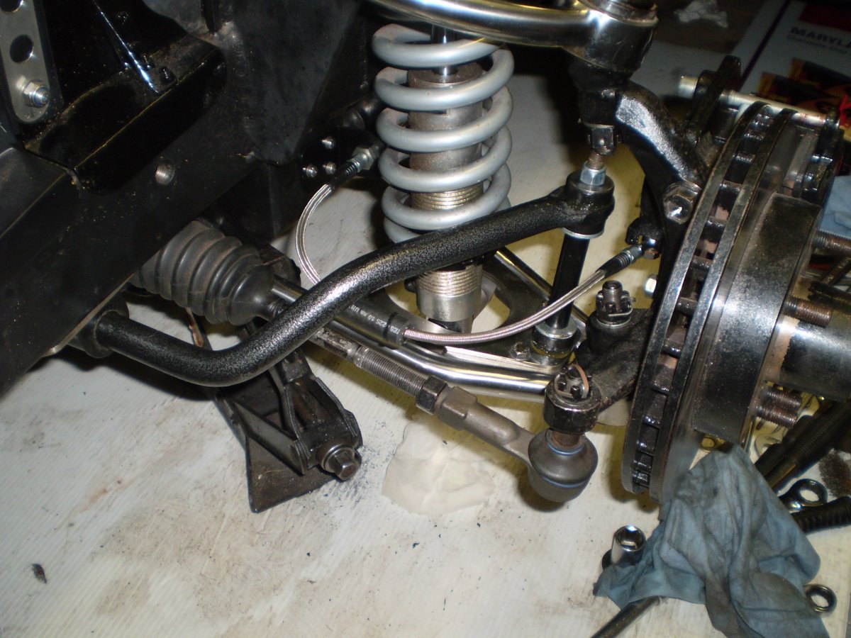

    it was a dry day today.pushed the truck out of the garage and bled the calipers again.two small air bubbles found.after doing the rounds a few times.we decided to replace as much of the Goodrich hose as we could with hard line.copper /nickel alloy KUNIFER ALLOY.Ican get a 25 ft roll local and hopefully all the fittings I need.if at first you don't succeed and all that.
    in the second photo you can see a jacking point I bolted on in front of the rear wheel to jack the ch***is with the running boards on.(high tensile bolts) works a treat

    pushed the truck out to redo the front brake lines.made great progress til it pissed down on us.got the front lines finished and bled.lines look the same as the black flex hose we lined the copper nickel hardline with a tough plastic pipe to protect against stone damage.followed the same route as before down the A pillars,happy to make progress on the brake lines at last.another day should finish it omitted the hydraulic brake switch and will use a mechanical switch instead.then its fenders on time.
    the copper /nickel lines were easy to cut flare and bend.
