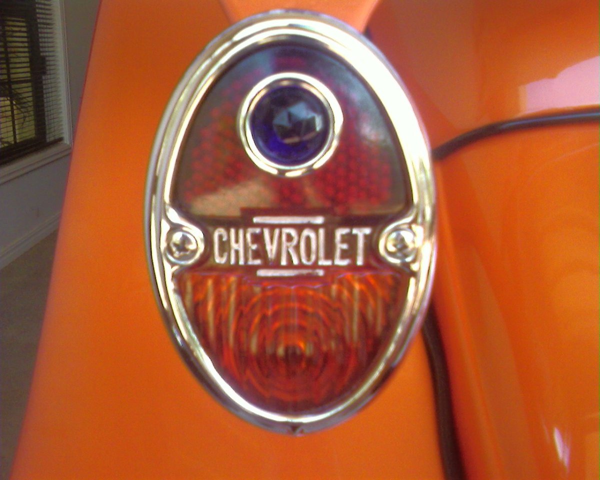

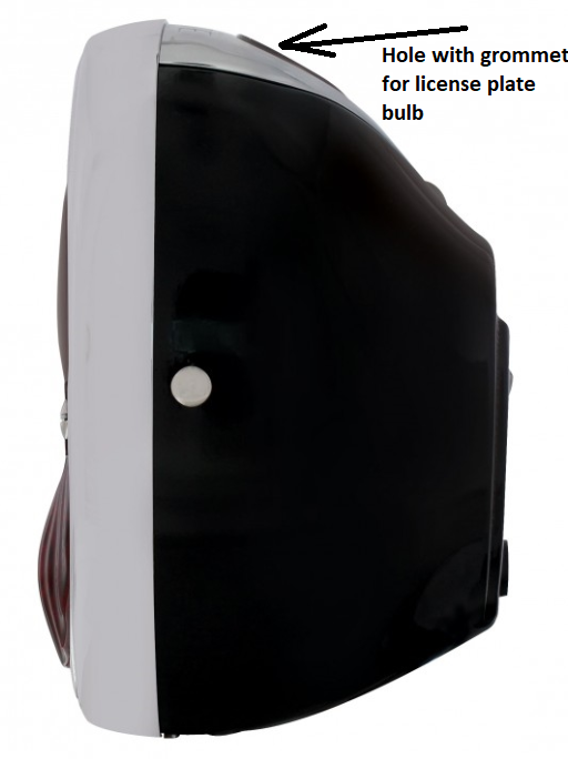

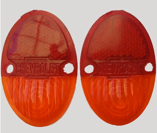

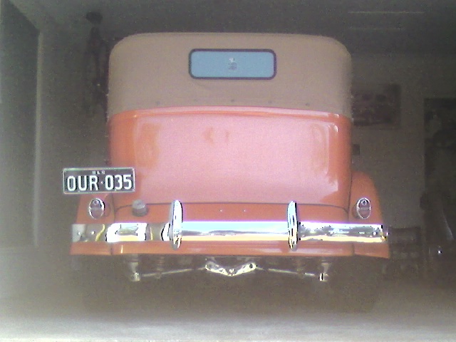

    Love the way the truck has come together however I don't know what your legal requirements are over there. This is how I did my tail lamps on my 35 Chebby that look similar to yours. I could have used OEM glass lenses however some drivers aren't that smart here and wouldn't know what a flashing tail lamp signifies. :rolleyes:
    I had a nearby business make new lenses from my glass originals with red tops and amber bottoms. I use dual filament bulbs (Stop & tail lamp) on top and single filament bulbs on the bottom (Signal). I profile cut a thin sheet of S/S to separate top and bottom halves. On the LH side the double bulb also illuminates the license plate above, the bulb seats on a hollow OEM grommet at the top. If you elect to not use a LH tail lamp, the RH tail lamp doesn't have the top hole so you could put your plate anywhere that's allowed.

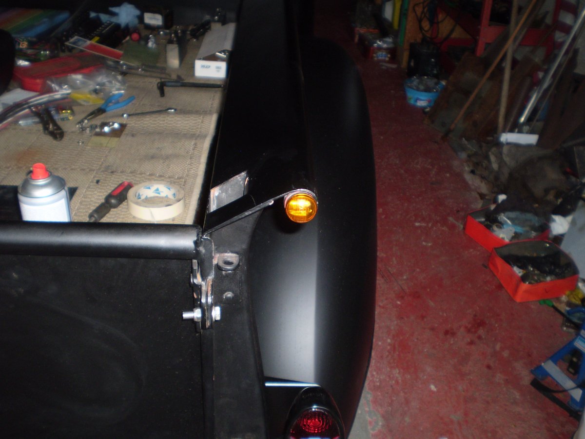

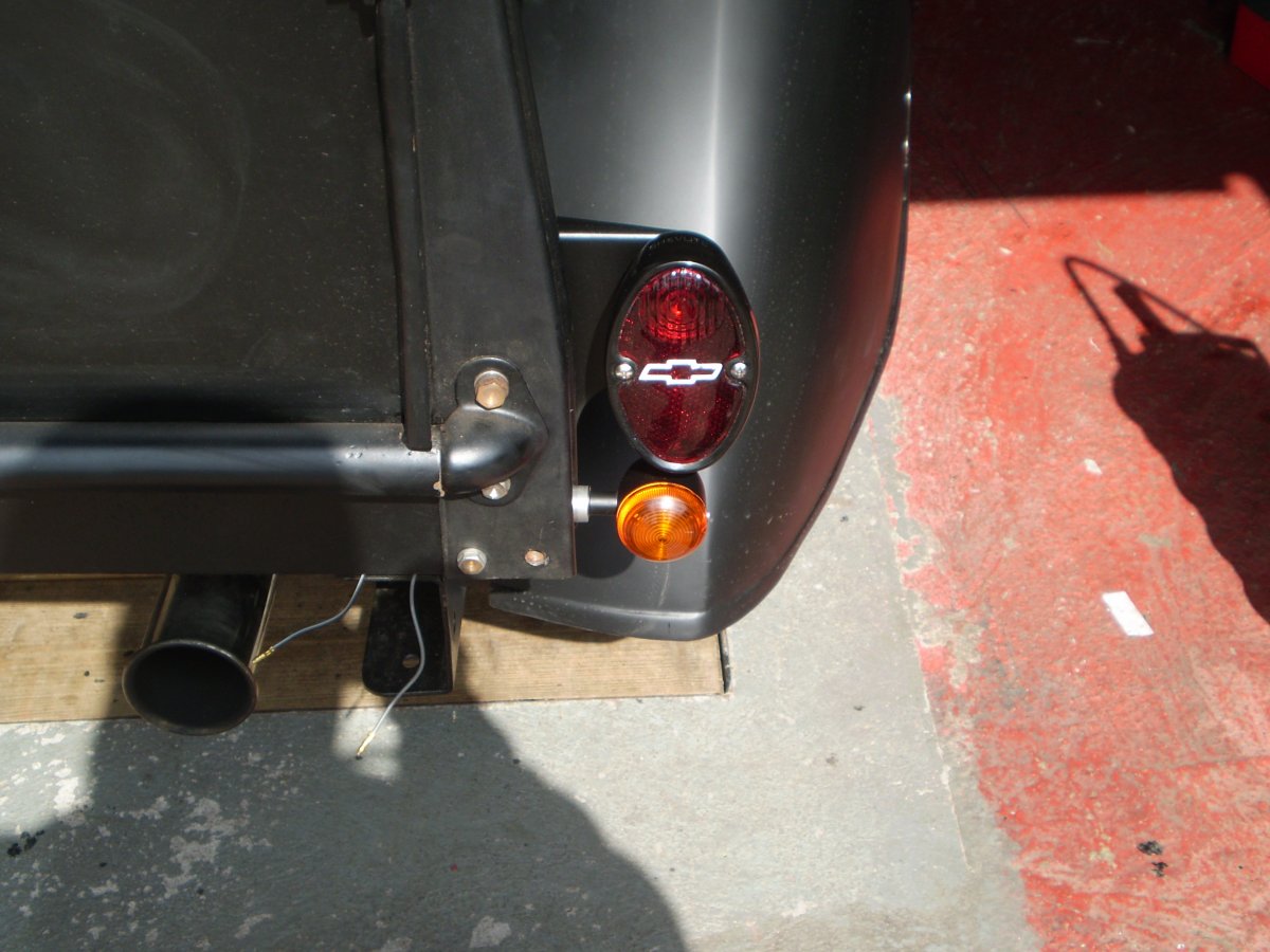

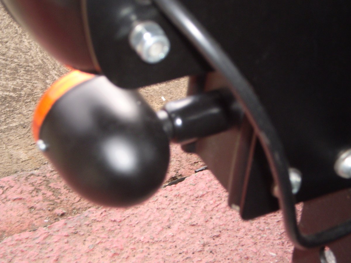

    mounted up the first rear indicator for a look r indicators first 004.JPG r indicators first 003.JPG might space the indicator out a little nearer the centre line of the taillight.plenty of thread left in the bracket.ill offer up the other side for a look.was reluctant to drill the bed sides but no going back now.be safe be seen

    nunattax

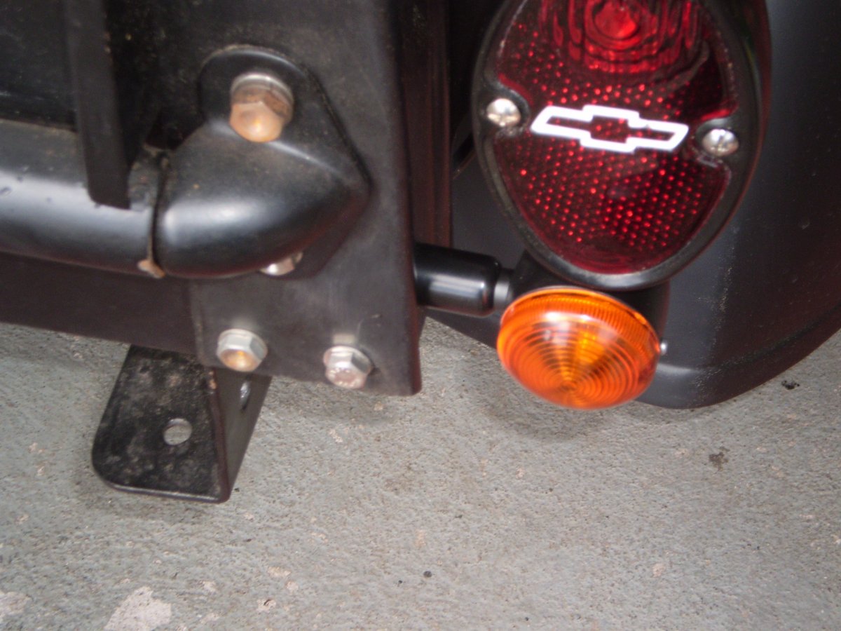

    put a 5/8 spacer in and moved it forward a tad.happy with this position..need some proper spacers to finish.will do the same on the other side. turn signals 2 003.JPG turn signals 2 002.JPG

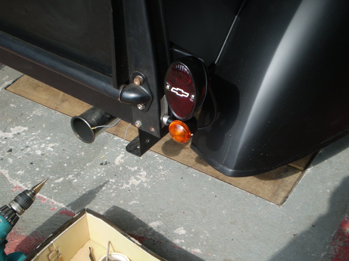

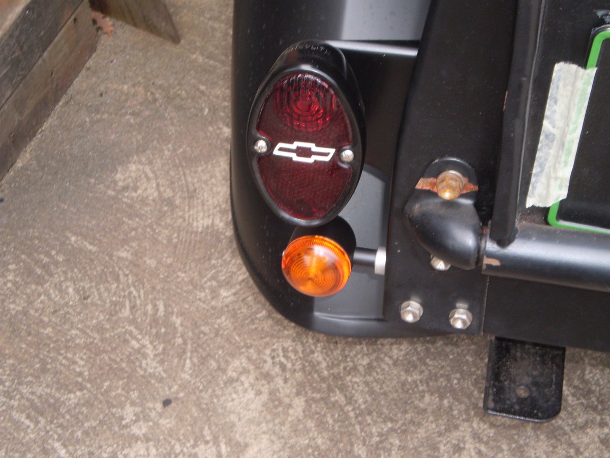

    got my new spacers for the indicators.top job mick,thanx. turnsignal spacers 001.JPG

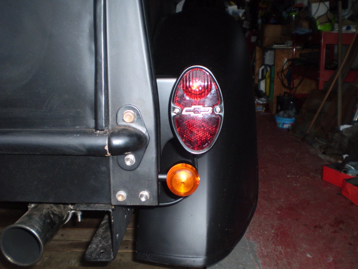

    turnsignals with spacers fitted 001.JPG turnsignals with spacers fitted 002.JPG .finished job fitted
