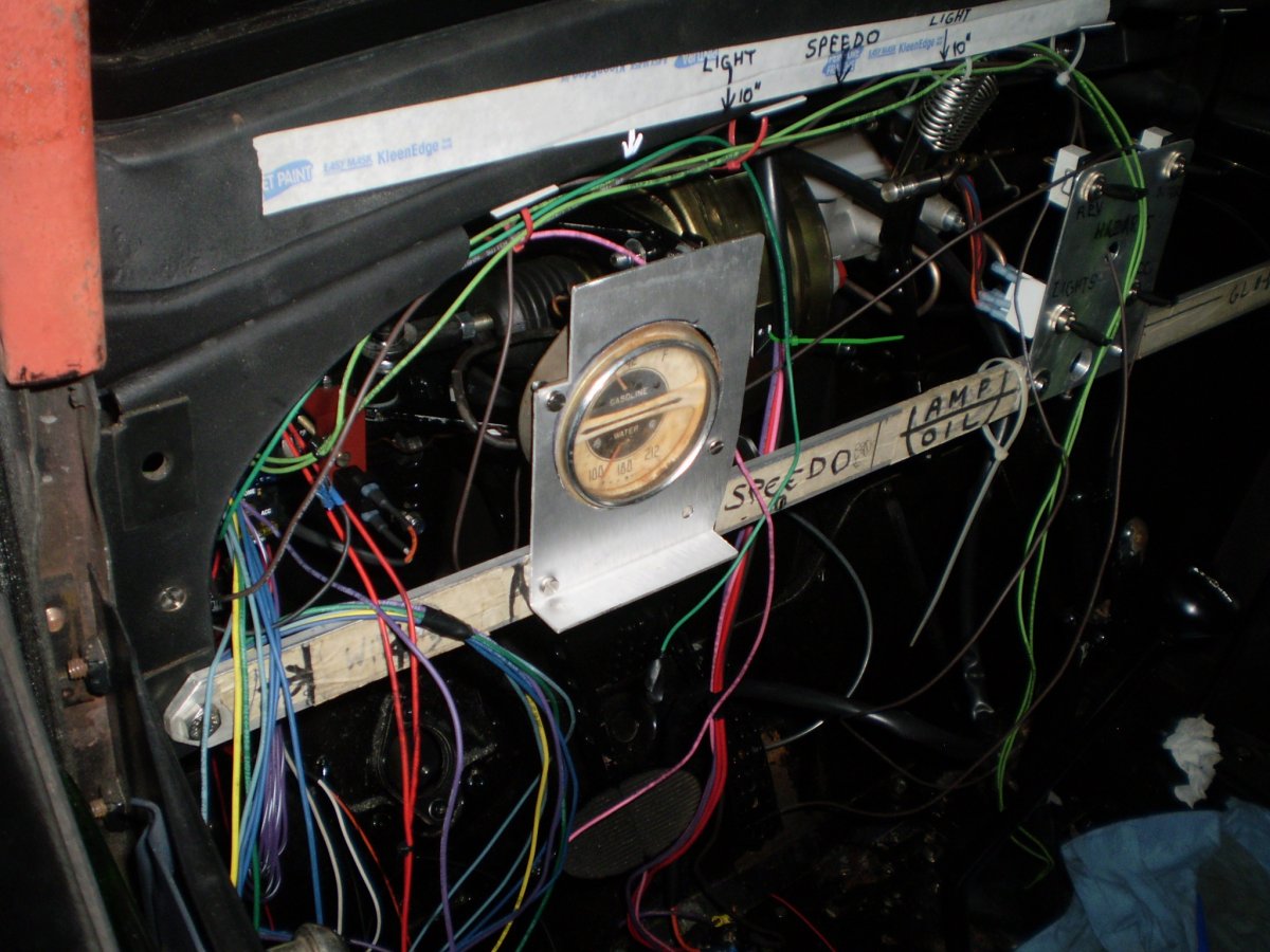

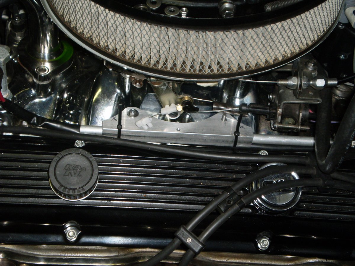

    made a bracket to mount the temp gauge approx. in its position ,leaving my hands free to route the capilliary tube.this is a spare gauge and not the reconditioned one I will be using with the extended tube.looks like theres plenty of room for everything oil gauge mock-up bracket 001.JPG

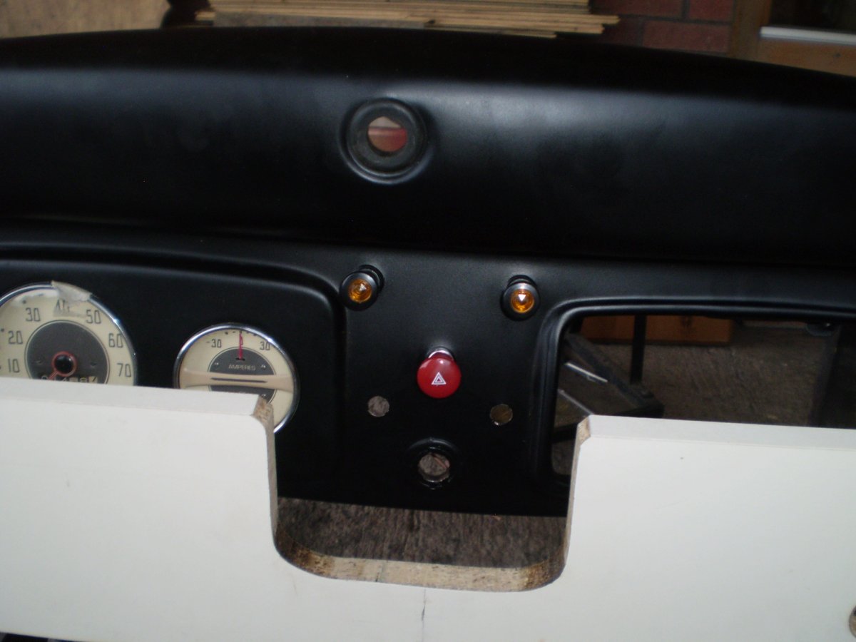

    h started on the dash again.gave the pull switches a trial run.i will be using one of them for a reversing light switch and the other for a rear fog light switch.the hazard switch has an illuminated knob as well.all 3 switches need a separate earth for the knob light to work.the dash has a few earth points .started cleaning the paint off and sanding the metal to remove any rust,coated with petroleum jelly..i used a piece of self adhesive rubber near the dash mounting bolts so I need to earth the dash to the body as well.either side where the dash bolts on I have an earth bolt ready to go.

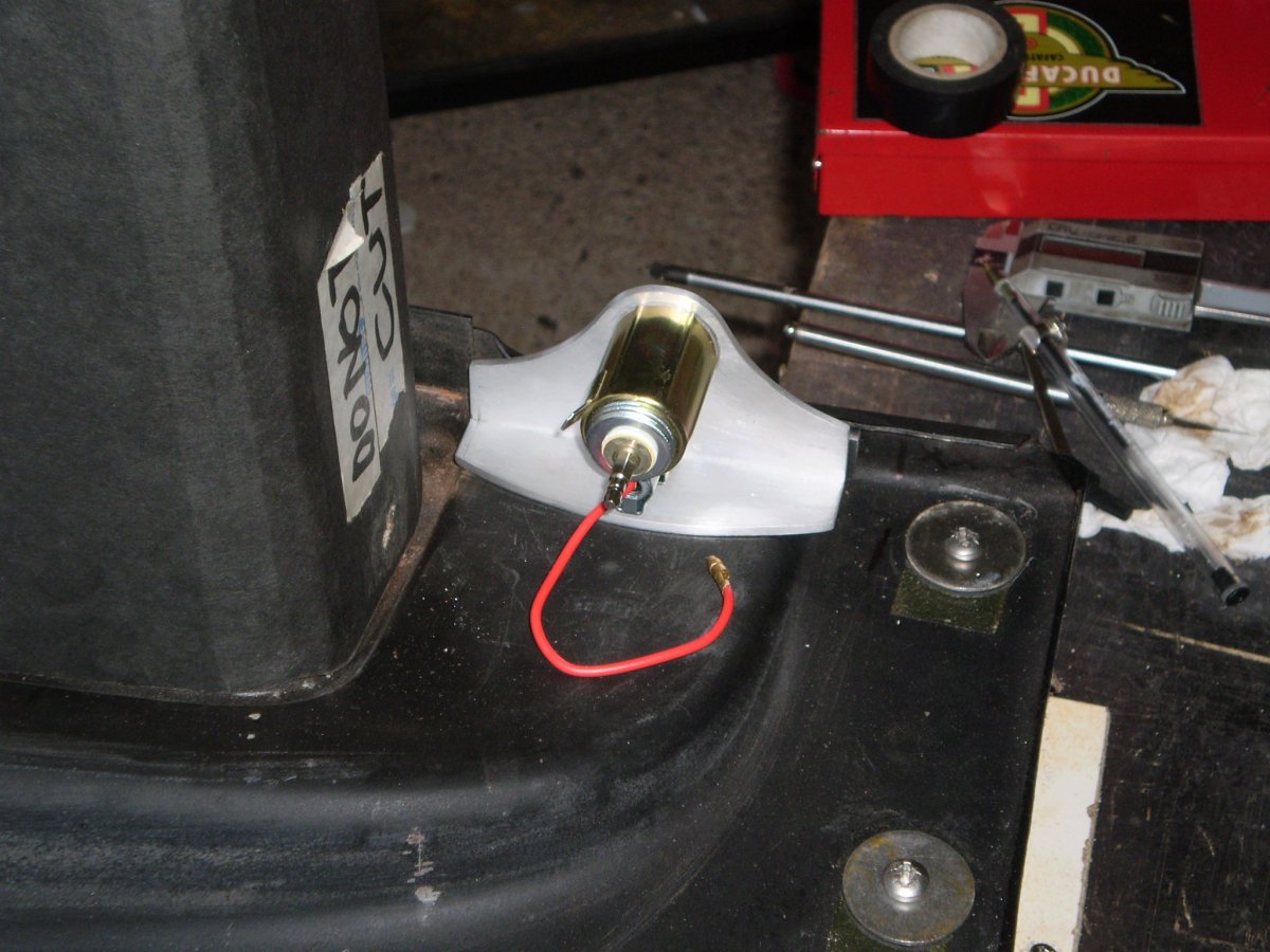

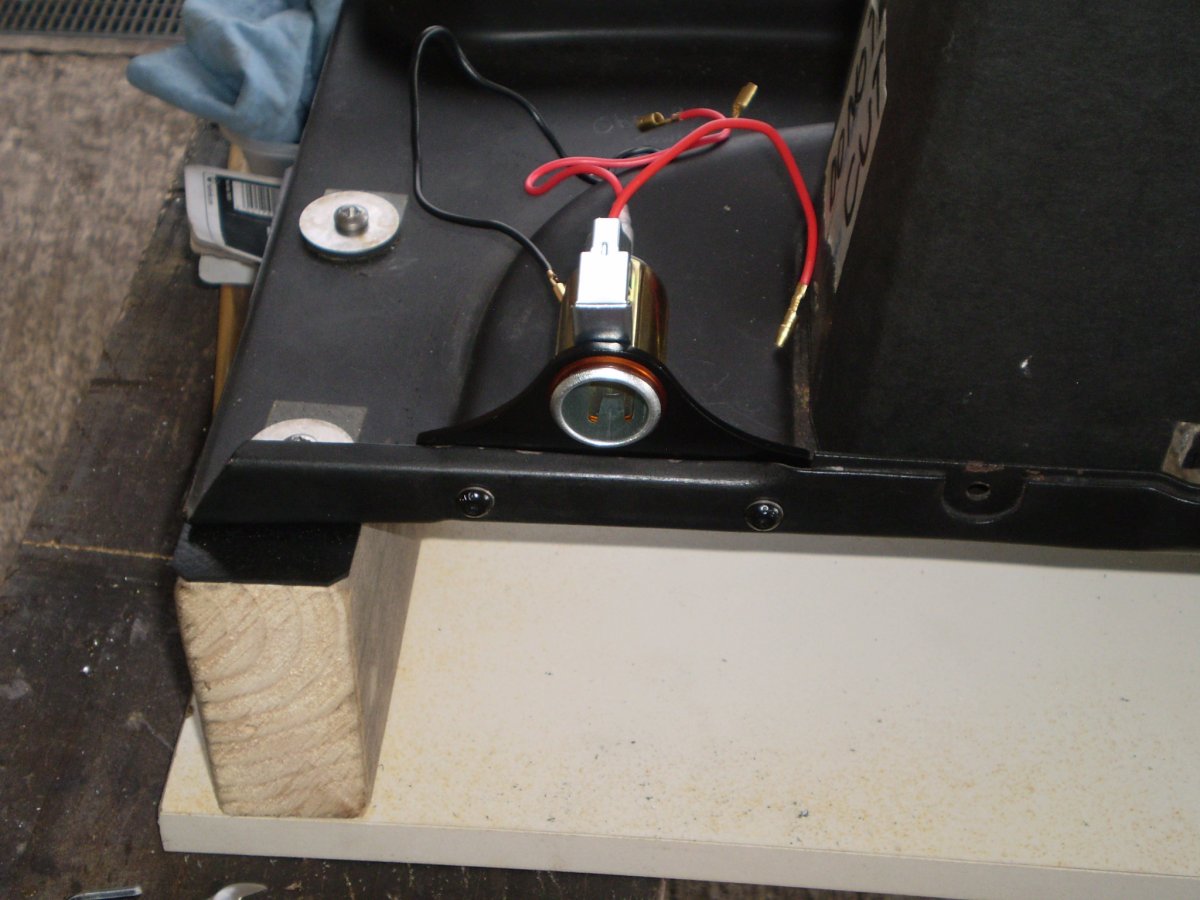

    I wanted a cigarette lighter to power the sat nav.i decided on a discrete one behind the dash on the p***enger side.made up a bracket from some 3mm alloy angle. dash switches and cigarette lighter mount 002.JPG dash switches and cigarette lighter mount 003.JPG dash switches and cigarette lighter mount 004.JPG dash switches and cigarette lighter mount 005.JPG
    because the pull switch were inclined to turn when I was tightening them up I cut two small strips of 3mm alloy and superglued them along side the switches.worked pretty well.dash to be continued tomorrow P.G
    the dash stand is also working out very well.im screwing it to two timber hop-ups I have and its making for a steady work station.the hi-beam light also needs doing the easiest place to mount it is between the two pull switches but id like to mount it in the speedo face.

    cigarette lighter install 001.JPG cigarette lighter install 002.JPG cigarette lighter install 003.JPG cigarette lighter install 004.JPG spent some time at the cigarette lighter today.painted up the pieces ,drilled out the spacer ,found some suitable bolts.bolted it together.the bracket is earthing well but must dis***emble tomor and put some petroleum jelly on the bkt and tidy the wiring up.then do something with the hi-beam lite.

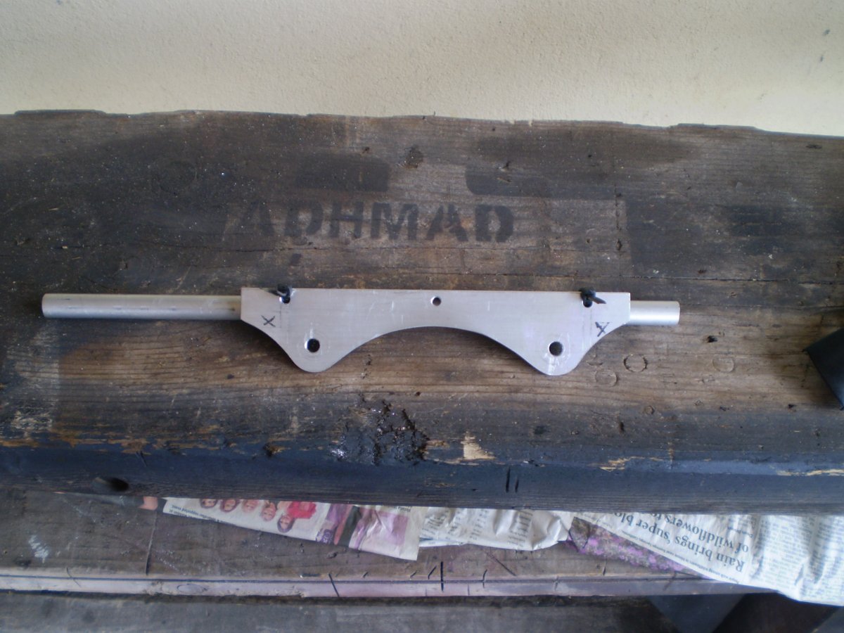

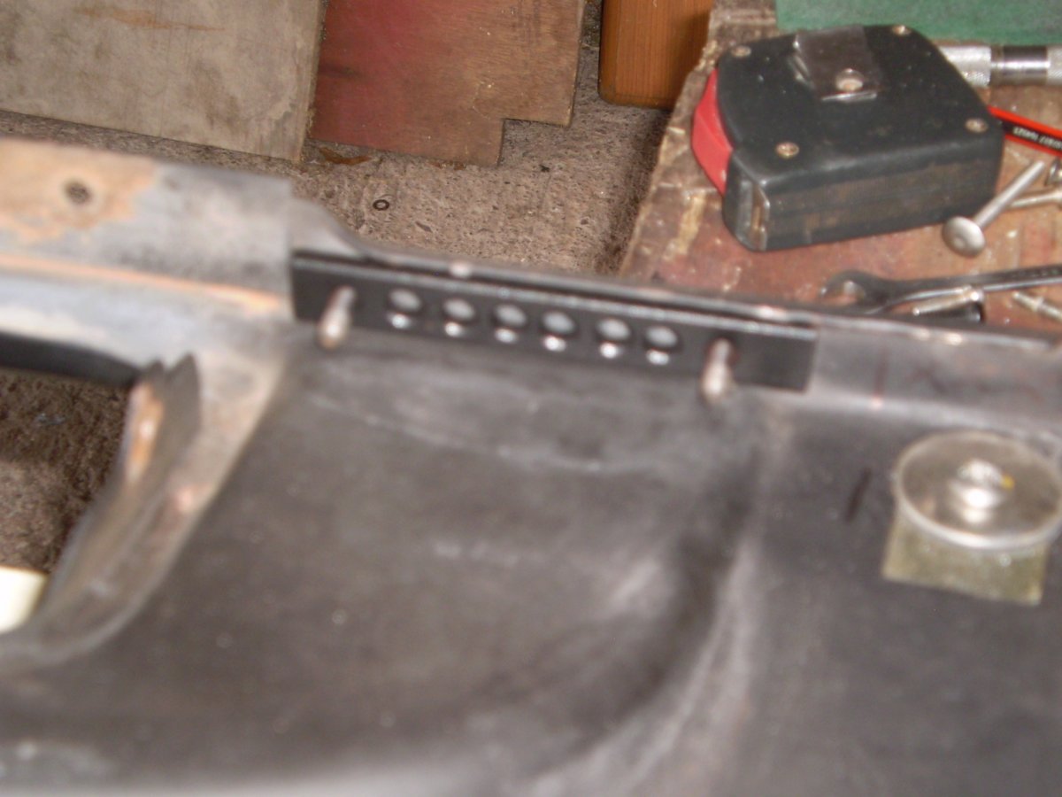

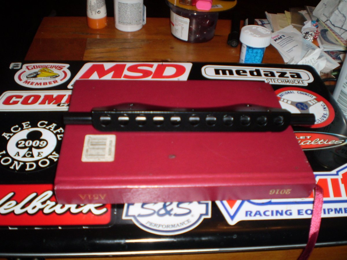

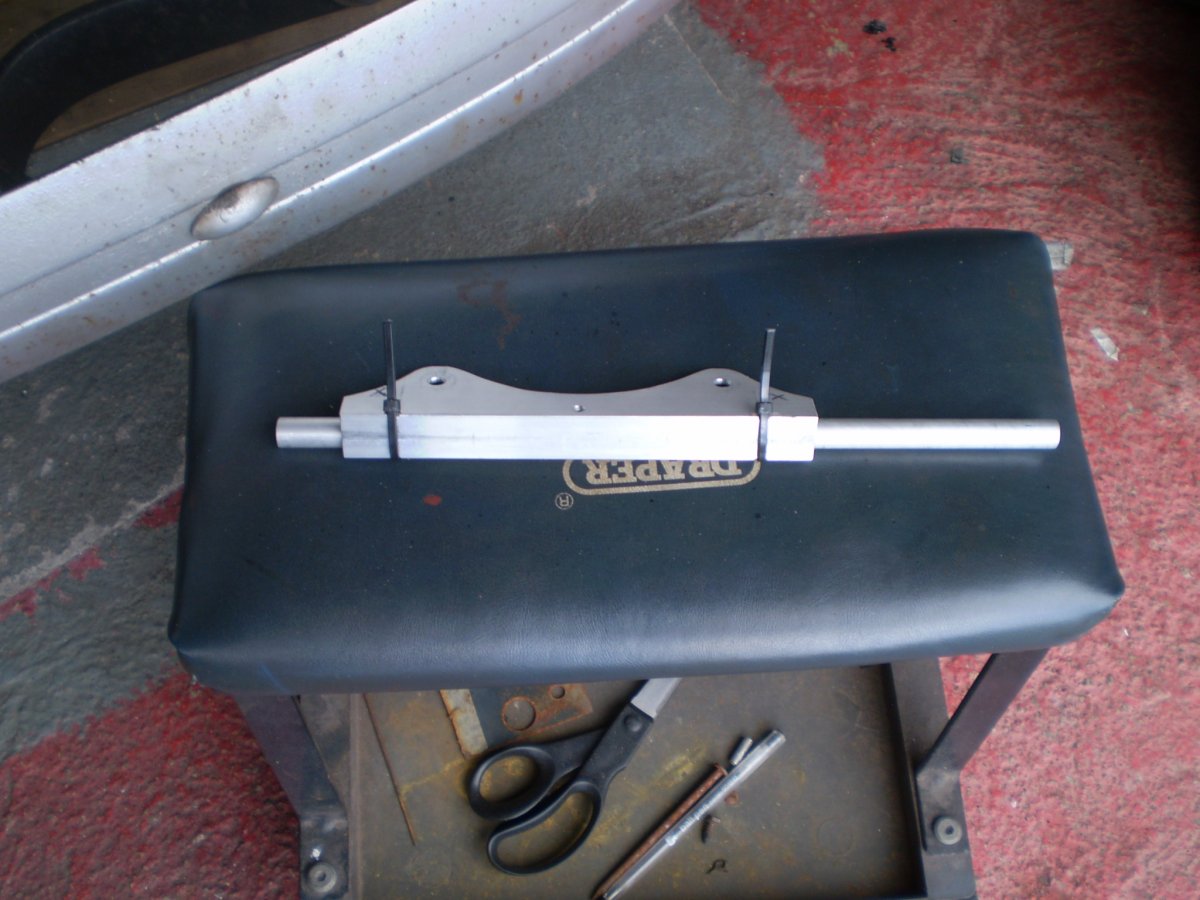

    trying to finish all the small jobs by next weekend,there are quite a few to do.made a bkt to protect the temp probe .had 2 unused 3/8 mounts in the manifold.made 2 pillars to screw into these but drilled the studs and tapped them m5and lock***ed 2 m5 stainless studs in there,mow I could use small nuts to anchor the bkt cause space is tight around the throttle linkage.it l be mon at the earliest before I can get it alloy spot welded togetherand paint it up im considering a strong two-pac adhesive as well.that would guarantee I wont warp the bkt and could well be the way to go.when its sorted ill split the pipe along the length to get the probe in . temp gauge probe bkt 001.JPG temp gauge probe bkt 003.JPG temp gauge probe bkt 005.JPG made my mind up,ill go for the 2-pac and keep going ,finish up the bracket and stik it together on monday

    probe pillars 001.JPG pic of pillars-plenty of Loc***e on the nut

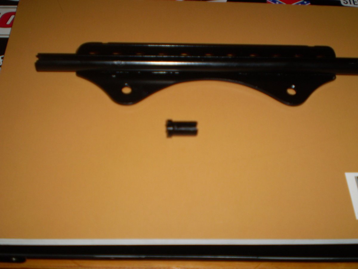

    used araldite to bond the pieces together,but used 2/ m4 screws to hold it together as well .etch primed and shot it with satin black.split the tube down the length.the probe at its narrowest is 2mm approx.split the tube using 2 /1mm discs in the grinder.i will plug the tube either end once the split doesn't line up with the split in the tube the probe will be trapped inside. probe bracket 001.JPG probe bracket 002.JPG .this has been dragging on possibily run the probe this w end .don't want to risk kinking the tube need another pair of hands to finish

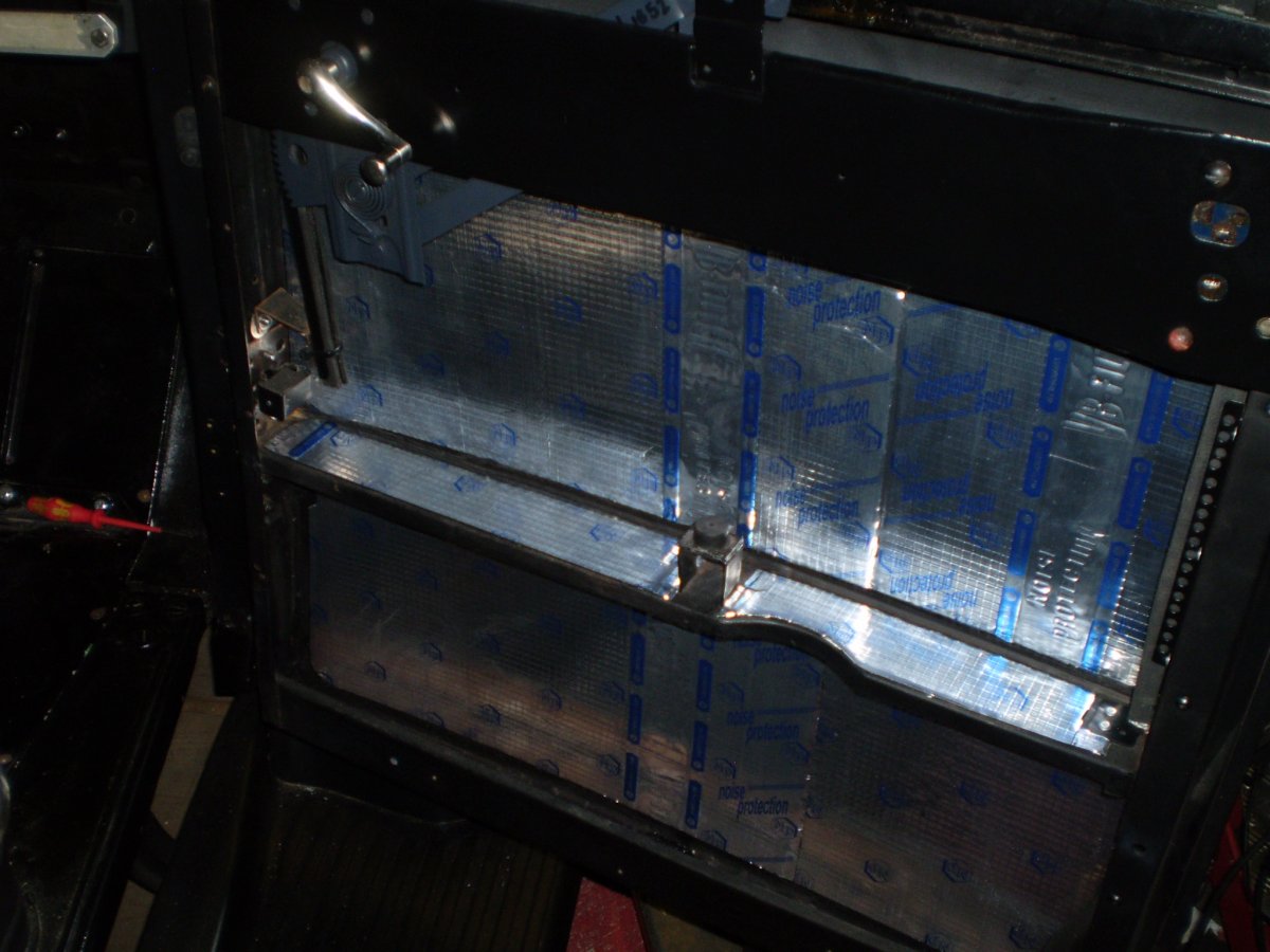

    picked up some sound insulation this weekend and made a start on the p***enger door.rubbed the paint with a fine scotchbrite pad wiped down with panel clean stayed back about 3/8" from the edges cause I had previously seam sealed the corners . purchased a box of 20/ 2mm sheets and the recommended roller.the roof of the cab is the noisiest panel in the cab,i tried out the lighest sheets because of the compound curves in the roof.as it turned out the sheets stuck very well and stretched to the shape very well. the 2mm sheets made a noticeable difference quieter and the extra weight on the door helps the lock shut better .need to finish insulating under dash area before the dash gets bolted back on sound insulation started 001.JPG
