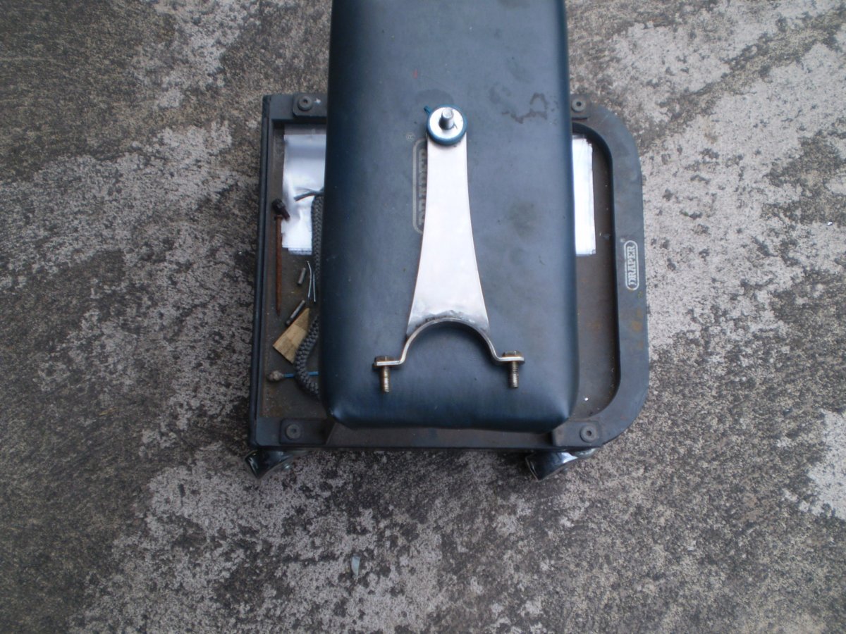

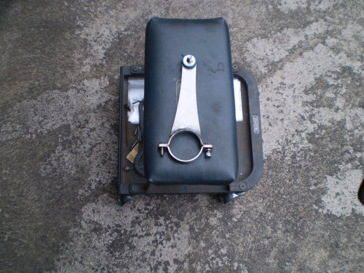

    exhaust brackets 002.JPG exhaust brackets 003.JPG today arranged to meet a welder to finish up 2 brackets for the exhaust.had these lying around unfinished for ages .finished up today.got m8 stainless bolts tacked to the brackets.there was a time id have polished the brackets up but id rather be cruising around.blue mountings are tough rubber from jegs .https://www.jegs.com/i/JEGS/555/309025/10002/-1

    Man you Irish guys have everything, even a creeper for your exhaust hangers, damn!

    there you go
