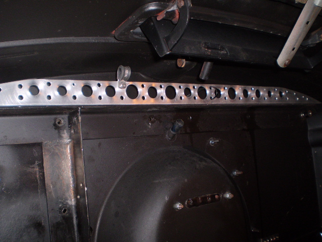

    added a brace to the leading piece of the inner wing to add some strength.i had a cluster of small cracks near the front,there was a lot of welding to fix so I cut a circle out.drilled with a step drill and got a bushing made to suit.stuck that in with a very strong two-pac glue.wasnt sure how to deal with the junction of the inner wing and the rad surround.the plan now is to bolt on a rubber strip either side of the inner wing with a lite stainless plate.this will give a flexible junction.need two more lazer cut but next with square holes so I can use stainless coach bolts.none of this will be seen under the wings

    inner wings with brace 005.JPG trial fitted the wings before I do any more repairs.next week ill be working on the rears as well inner wings with brace 001.JPG

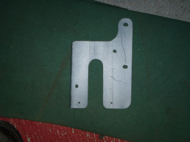

    I would like to do something with the mounting brackets as well.bubba has doing some rough welds on them

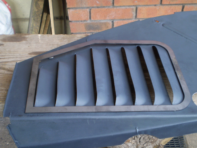

    got a reinforcement cut for around the louvres but its not a great fit ,will inner wings with brace 006.JPG get it right next time .reinforcement wont be seen keeping it on the wheel side of the inner wing

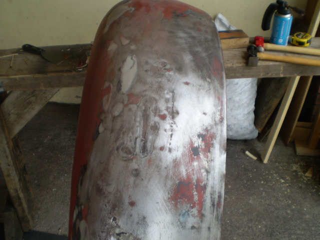

    started on the rear fenders.more of the same really basically solid needs some welding lotsa dents bad repairs plenty fillers.will take time but should turn out fine START REAR FENDERS 002.JPG START REAR FENDERS 003.JPG START REAR FENDERS 001.JPG

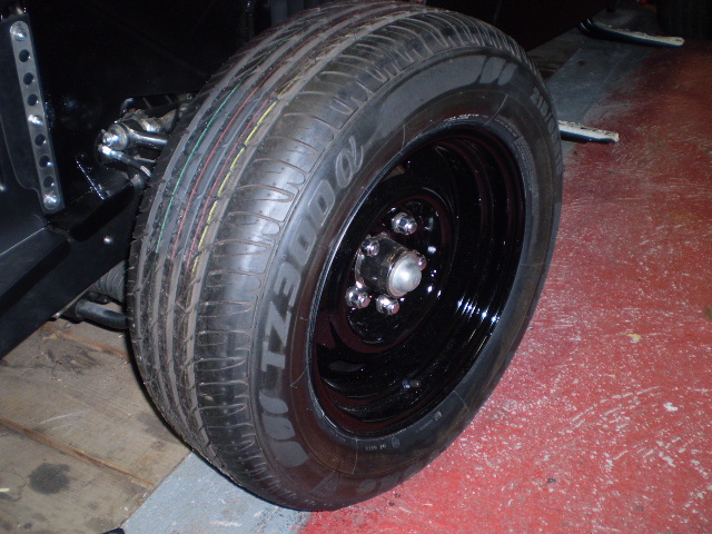

    made a little progress.got two 7inch rims for the front.didnt try to match the rear rim colour,painted them all gloss black inner wings and rims black 001.JPG

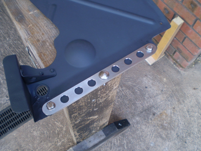

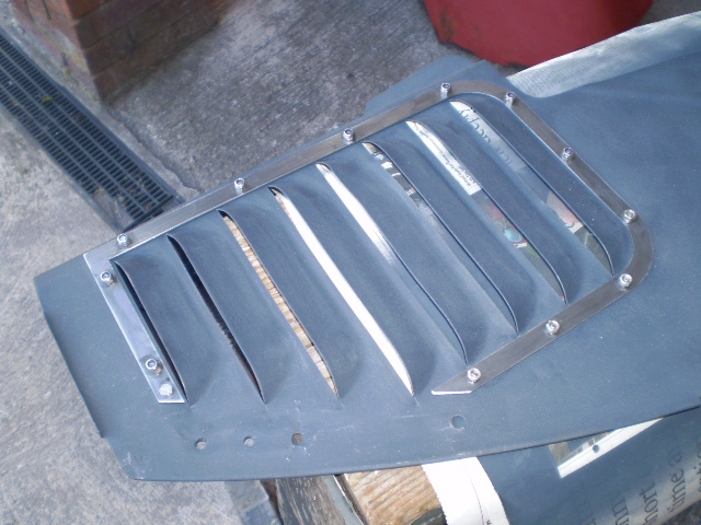

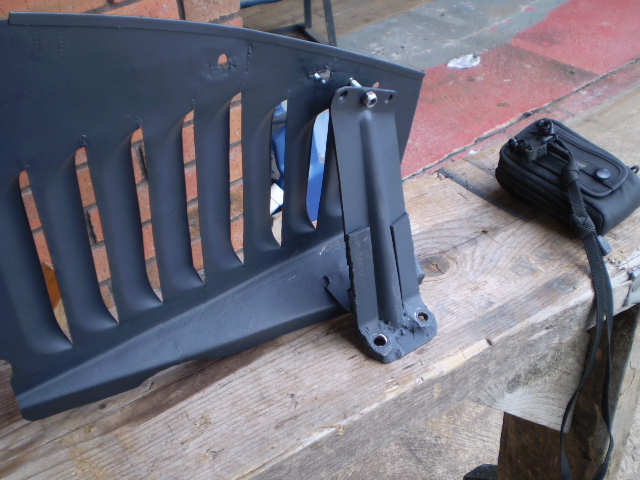

    I have the two inner wings nearly ready for paint on Monday.bolted on a brace around the louvers inner wings and rims black 002.JPG inner wings and rims black 004.JPG 2mm mild steel,will paint the lot black

    ended up using 215/65 x 15 tyres.plain thread pattern does not look out of place. black whee inner wing etc 001.JPG

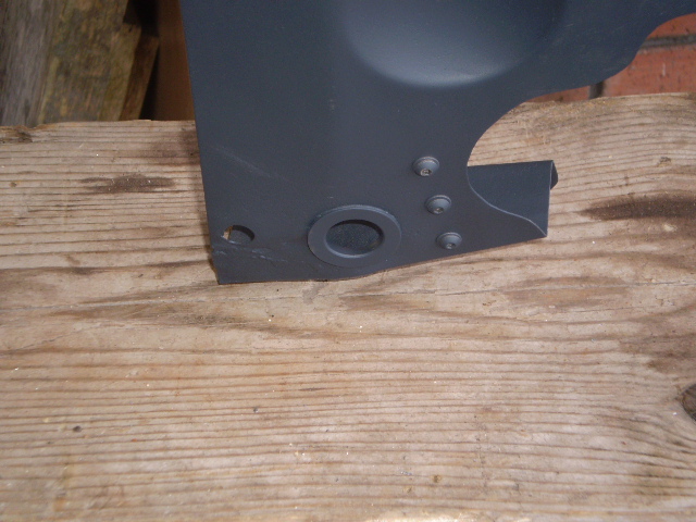

    I got two more stainless strips cut for inside the inner wings.this time with 3 square holes so I can use stainless coach bolts .stuck the coach bolts in with two pac adhesive.painted the inner wings, needs one final coat of gloss black to finish . black whee inner wing etc 002.JPG .used gloss because I thought it would offer better protection against the weather,and will not be seen

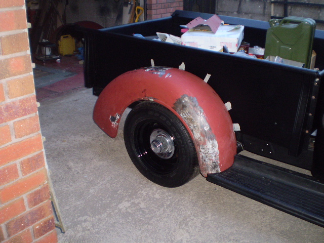

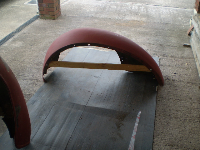

    rear fender trial fit 1 001.JPG rear fender trial fit 1 002.JPG this week im trying to make progress on the rear wings.5 mountings on each fender to the bed.each was cracked or cracking.i reinforced each mounting point with 1.5 mm slotted washer welded to the inside of the fender trial fitted and fitting excellent.bolts lightly nipped up.must get it back to Don to use it as a guide to repair the other fender.talented guy and top welder.

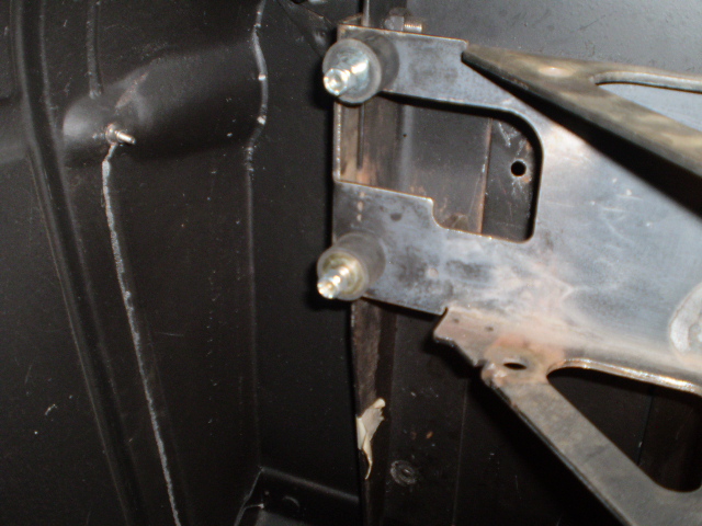

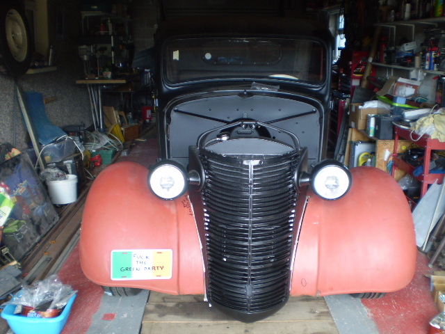

    hood and inner wings trial fitted.could do with a new top hood hinge and some small cracks welded up. rear fender trial fit 1 005.JPG rear fender trial fit 1 006.JPG rear fender trial fit 1 008.JPG also got some shims cut for under the inner wing mounting bracket and two brackets to hold the inner wings steady .next move is to strip the fillers and rust from the rear fender.**** job but someone has to do it

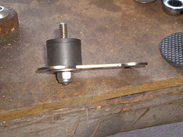

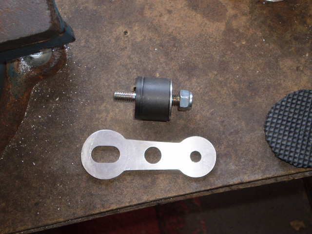

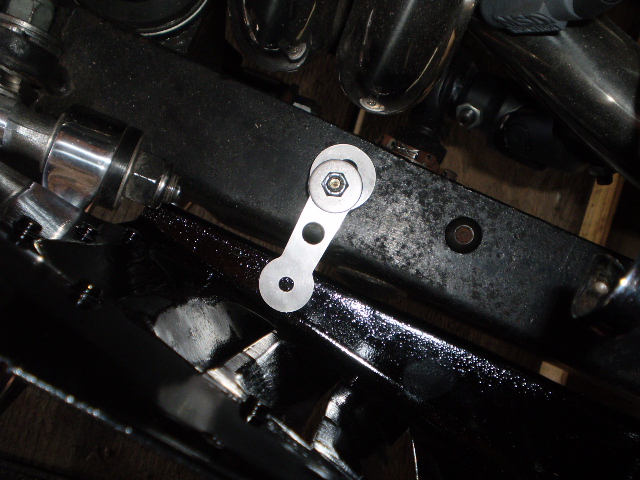

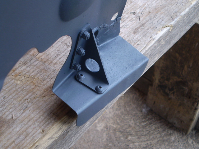

    inner wing bracket ,rubber mounting and slotted washer inner wing brackets 001.JPG .bracket 2mm stainless . inner wing brackets 002.JPG Harley rubber mount inner wing brackets 005.JPG inner wing brackets 006.JPG .slotted washer

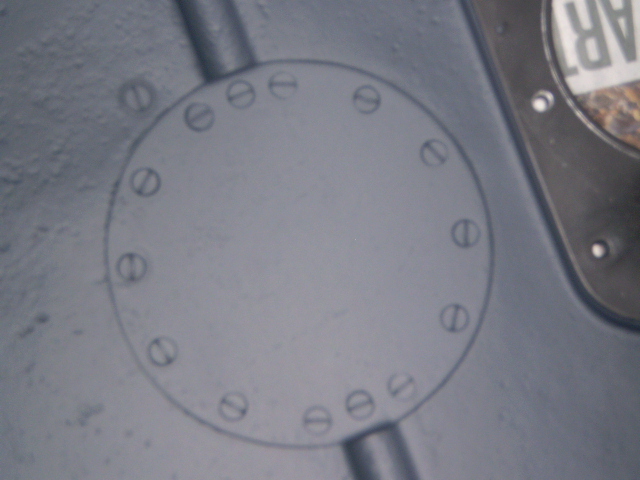

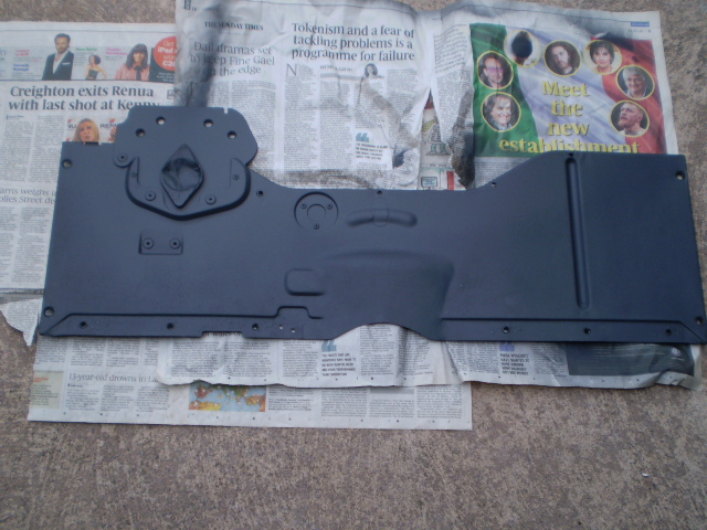

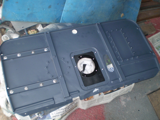

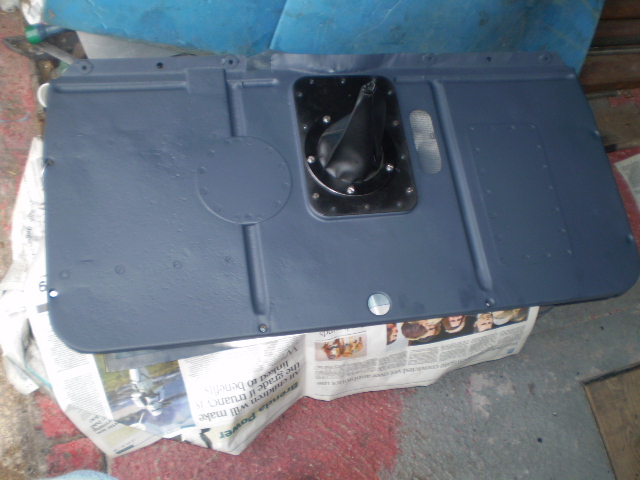

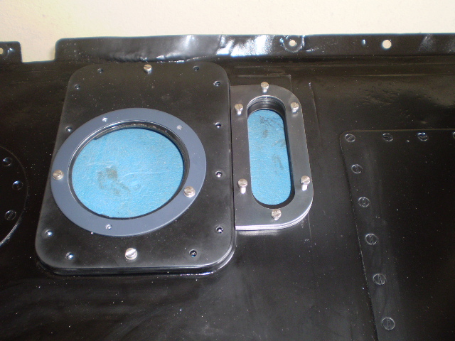

    floor primed 002.JPG floor primed and gear boot 002.JPG floor primed and gear boot 001.JPG not much to report for this week.i had done some work to the floor.it was battered /out of shape and had a couple of cracks needing welding..i used inch x inch box split in half to stiffen up the floor.olso there was a circular hole hacked out of the floor ,right on the rib weakening it considerably.tidied the hole and made a circular cover.also made a cover over the rectangular hole.got the 1/2 x 1 inch u channel welded in riveted the covers on and had it blasted.painted and undersealed.big problem it never dried properly.
    last week I started stripping the mess.scrope it washed it sanded it eventually got it all off and sanded it the best I could.didnt like the rivets so I replaced them with m5 countersunk nuts/bolts stainless.primed with etch primer.its dry nowready for the painter to finish.i had bought a lokarshifter boot.i thought the ring was a little small looking so I got another 2 lazer cut tapped the holes in one m5 and drilled the other to 6mm.bonded one to the underneath of the cover no fiddling there now with nuts and bolts.i used plenty of bolts on the covers to pull the floor straight.
    I really liked the original handbrake.im keeping it and intend to have it working again have a lokar handbrake boot need to get a bracket laser cut to suit so I can fit the lot.

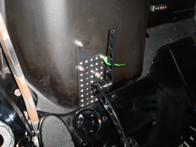

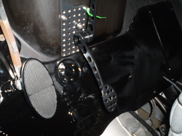

    months ago I drilled the firewall to mount the gas pedal..didn't get the position right first time but I couldn't keep drilling until I got it right ,so I made up an adjustable plate (4mm thick ) for the firewall using the two holes to mount it.got it laser cut this week and tapped the holes to 1/4 unc so I could use somedomed slot head screws that came off the truck. holes are at 12.5mm centre to centre.if I can find a suitable return spring ill use one and amend the bracket.ive also included an adjustable stop .im thinking of changing the s**** sized pedal for a longer one of a similar design adjustable gas pedal mount1 004.JPG if the cab was a little longer positioning the pedal wouldn't be that critical

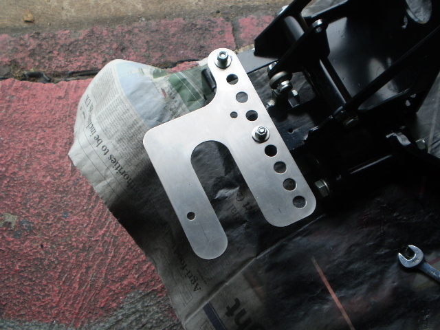

    staying in the cab .took the dash out to mount the fuse box and paint up some bits.fix some potential leaks.i will have to modify the cowl vent lever to keep it working.after deciding where to put the fuse box I designed a plate to hold it.gave it a trial run today.mounted it with two Harley rubber mounts.will get it laser cut in 2mm stainless when the design is finalized. MOUNTING FUSEBOX 004.JPG MOUNTING FUSEBOX 002.JPG MOUNTING FUSEBOX 005.JPG
    I will fine tune this bracket before it gets cut
