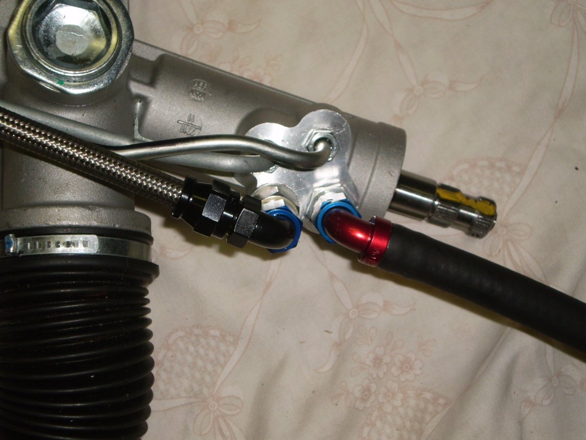

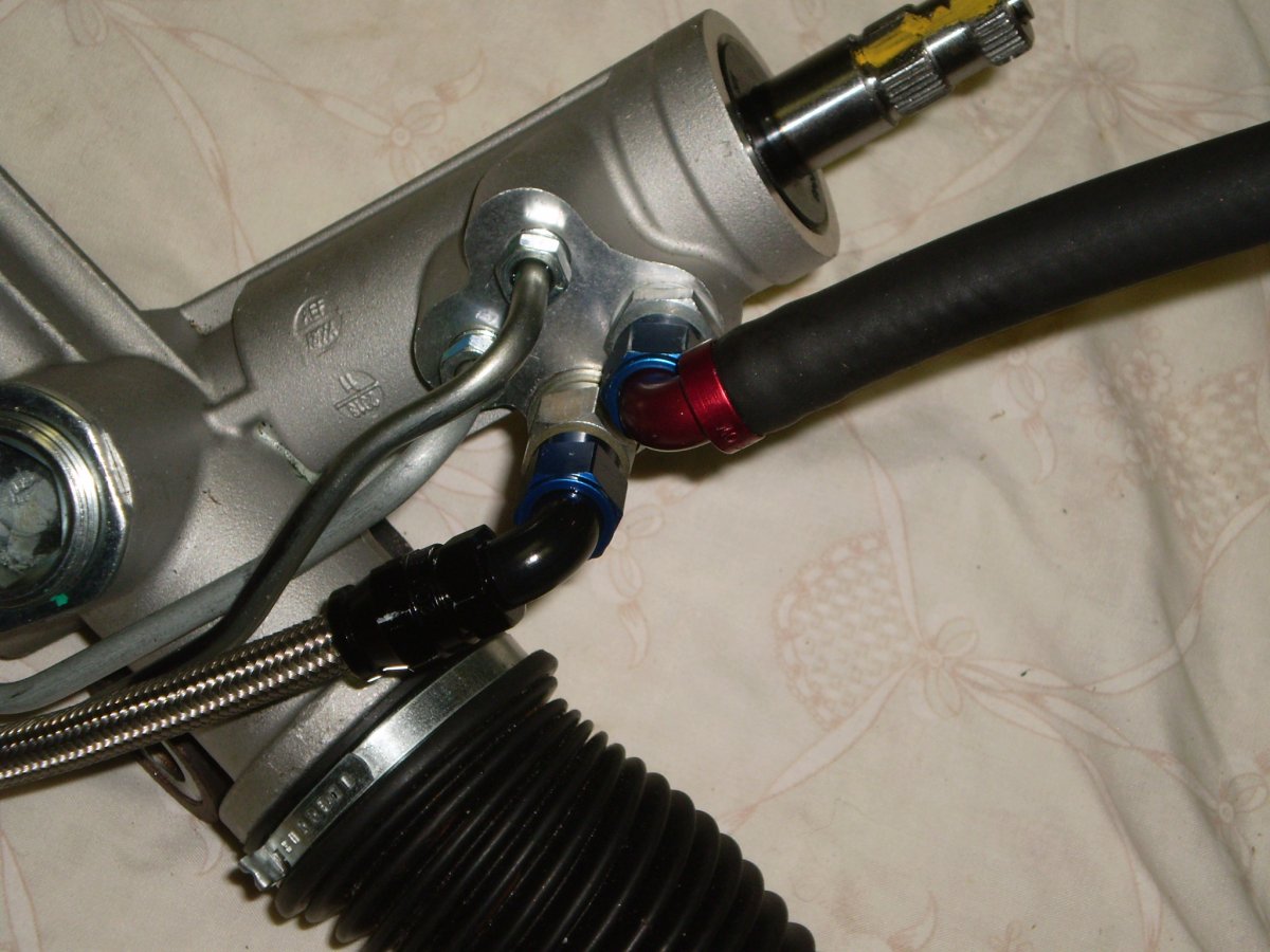

    steering rack with adapters hoses 002.JPG went at the hoses again tonight.first job remove the AN 06 adapter from the pump.inverted flare at the pump.sprayed the threads with brake cleaner and after a thorough clean with cotton buds fitted the adapter with LOCK***E 542.hydraulic sealer,left to cure overnight.removed the rack to fit the adapters.used a dowty washer under the 9/16 adapter after a thorough clean up ,used 542 on the threads and nipped it up using a stubby spanner.went to remove the 5/8 adapter but it didnt want to budge so i left it in situ.consulted last nights notes re routing the hoses.the high pressure 9/16 port hose went to the front looping over the rack to the pump and the 5/8 port low pressure hose went backwards looping to the fitting on the pump.barely nipped the AN fittings while everything cured.leaving it for 24 hours for 100% cure.have a litre of steering fluid on the shelf.will boost the battery tomorrow just in case .

    have a dowty washer under one adapter and a ptfe o-ring under the other .shouldnt make a difference im relying on the 542 to seal the adapters.we will remove the rack tomorrow evening to tighten up the fittings.before reinstalling it.the high pressure port at the pump is accessable from below and above ,while the low pressure return will push on after heating in boiling water the hose clip is easily got to yipee.becaue the braided hose is very abrasive ill slide some 12mm fuel line over to stop it filing away anywhere its in contact with anything

    small test drive revealed a leak where the braided hose went into the black fitting.adapters on the rack are oil tight.and the connections at the pump are good[​IMG] ..its hard to access that fitting hope its not a major stripdown.ill have to get that hose on the bench and inspect.damn it

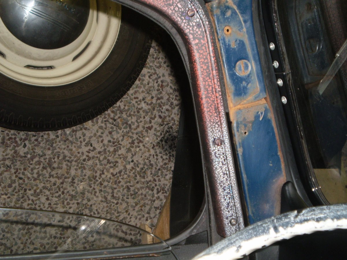

    change is as good as a rest so i did a little painting .should have been a quick job but i got carried away inside the trim was never painted,so i rubbed it down with a scotchbrite pad filed any sharp edges off and tweeked it into better shape. door trim painted 001.JPG door trim painted 004.JPG .the trim that goes above the door is well pitted and the top of the door panel is too so i did something sympathic.i had to redden the screws on the trim to get them out and save them.that gave me the idea to save the discoloured paint around the screws.not 100 %there yet will have to add more black to it and do something similar to the other side and the top of the door cards either the windows were broken for a long time or they were left open.when i got the 38 there was no door gl***.maybe they were donated to another project .

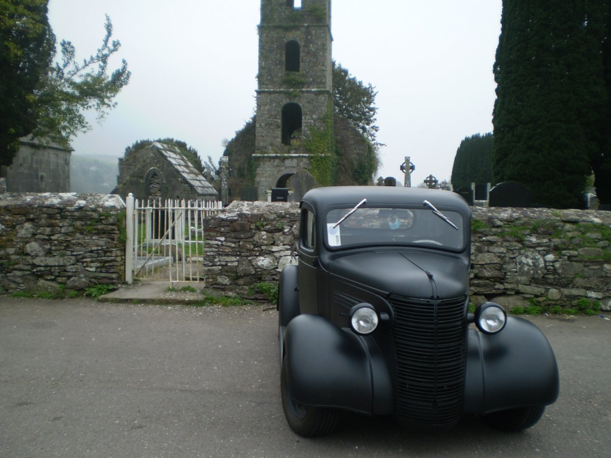

    small spin today inniscara 003.JPG [/ATTACH] inniscara 005.JPG inniscara 002.JPG inniscara 007.JPG .the plaque reads Hugh Mc Guire chief of Fermanagh,killed by english forces,1st march 1600 ,the bravest and best horseman.
