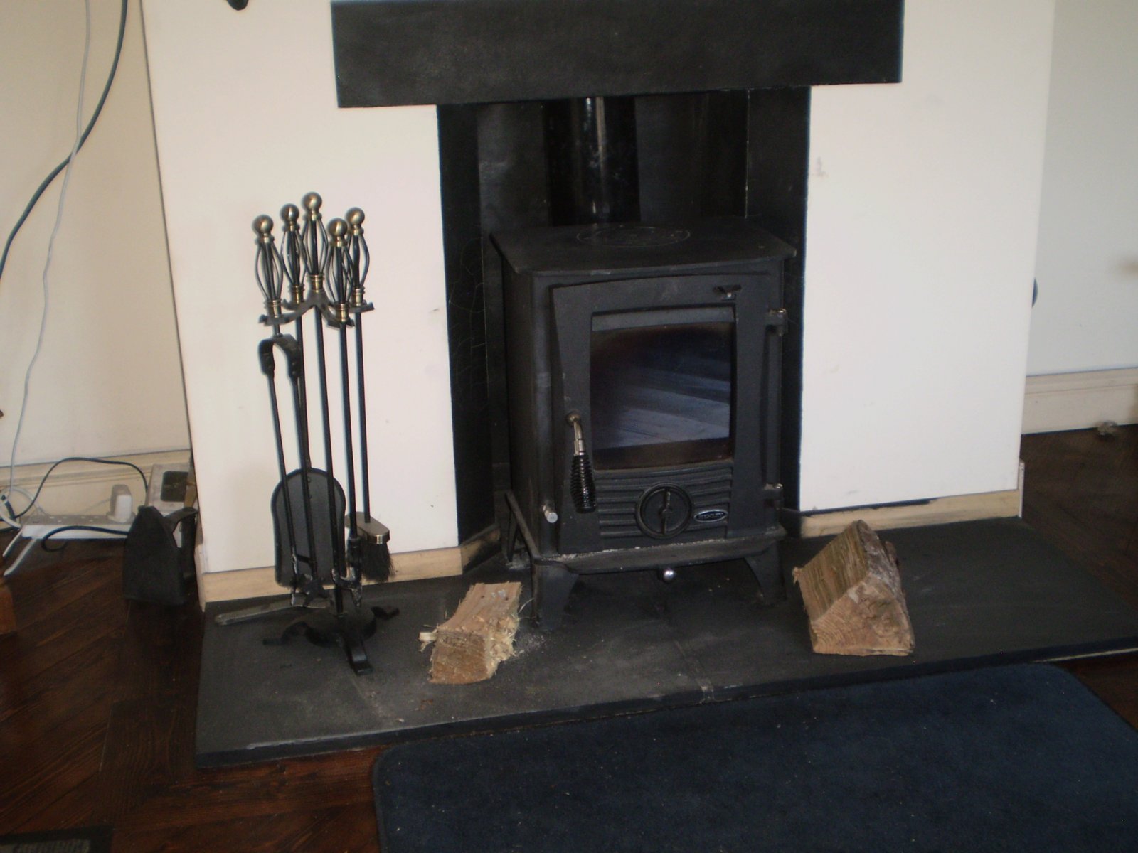

    the flue behind the stove looks crooked its an optical illusion.it slants back but goes straight up c.
