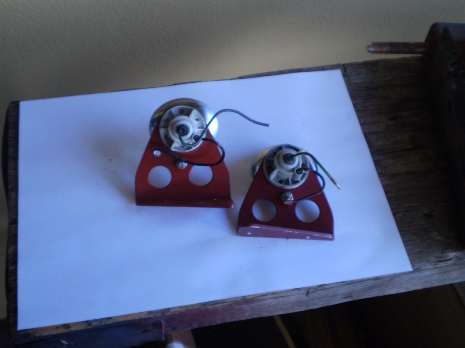

  12. nunattax
    Joined: Jan 10, 2011
    Posts: 3,389

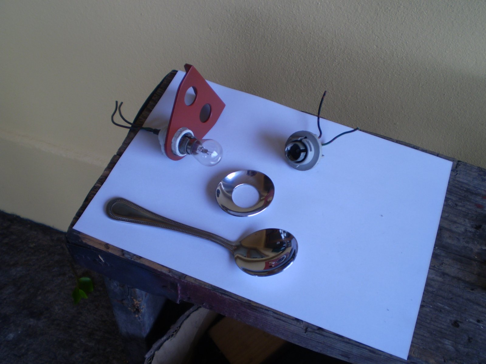

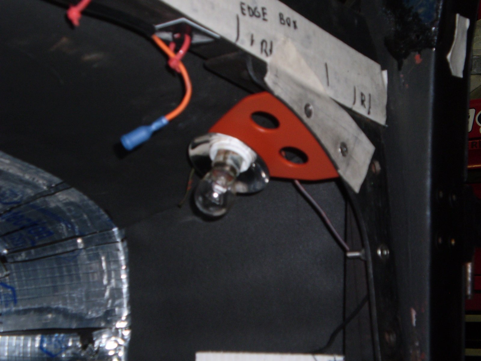

    nunattax
    upload_2022-9-15_19-31-18.jpeg heres a picture of the first light ***embly fitted.mounted with countersunk m5 stainless screws.tapped the bracket.reflecter is a new stainless soup s**** drilled and slid over the fitting held in place with araldite.if the earth was another inch longer i could earth it to the earth bolt on the dash bracket.ill tap the bracket instead and earth it there

  13. nunattax
    Posts: 3,389
    nunattax

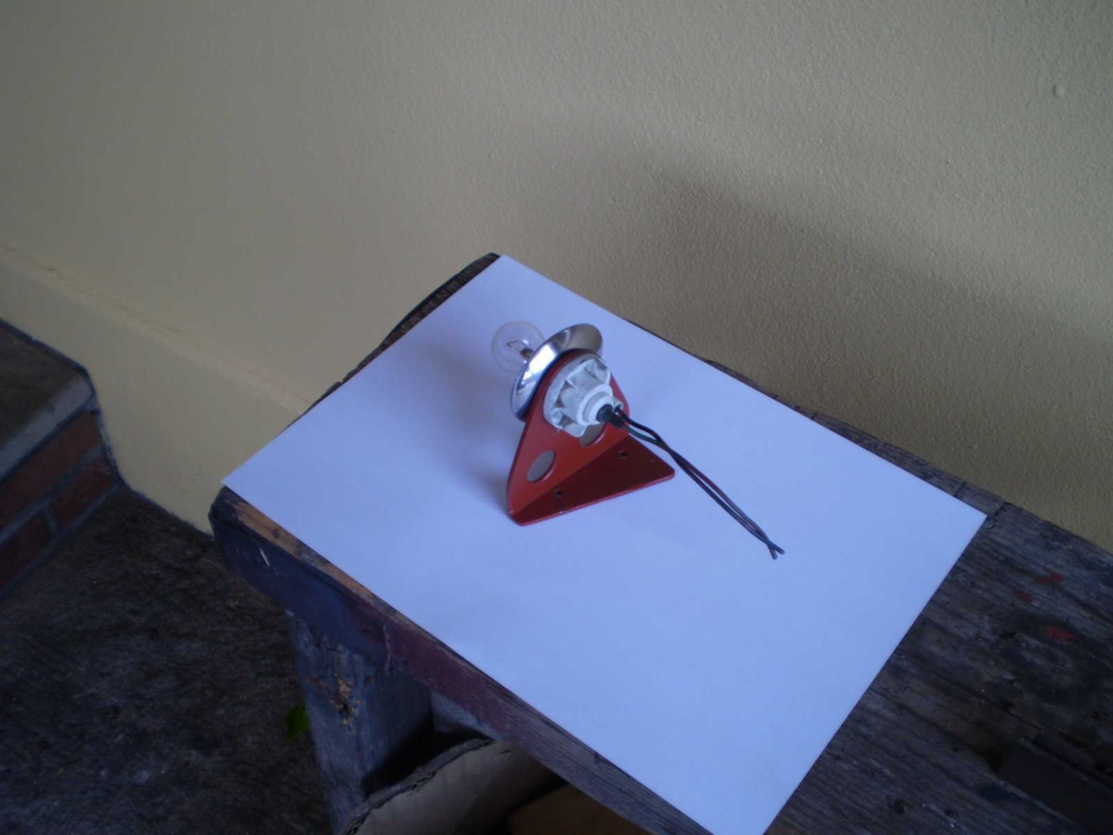

    ATTACH=full]5513192[/ATTACH] upload_2022-9-15_19-43-19.jpeg dis***embled .i like traditional with a few modern convienences discreet ones .

  14. nunattax
    Posts: 3,389
    nunattax
    upload_2022-9-15_19-48-38.jpeg .i really like these light fittings sturdy good quality and easy to mount .this one power in and earth.also have stop tail units i fitted to the stock 38 taillights.

  17. nunattax
    Posts: 3,389
    nunattax
    thanx bud,i was thinking of aluminum foil but the s****s a maintainance free job.sprayed the fitting with wd40 and silicone grease on the contacts for long life.

  24. nunattax
    Posts: 3,389
    nunattax
    upload_2022-9-17_9-37-54.jpeg VERSACHEM #44-2C unit no44209 .product recommendation.i have used this. sets in 4 mins and sticks hard, strong bond.thought i had lost the name of the product but found the wrapper on the workbench.b getting another on monday.was using araldite instead.dont like it its brittle when set only good for small things low stress bits

  25. nunattax
    Posts: 3,389
    nunattax
    upload_2022-9-17_18-28-8.jpeg and then there were 2.i need another s**** for the middle.no bracket needed the holes in the wiring trunking are the correct size.just stick it in with some araldite

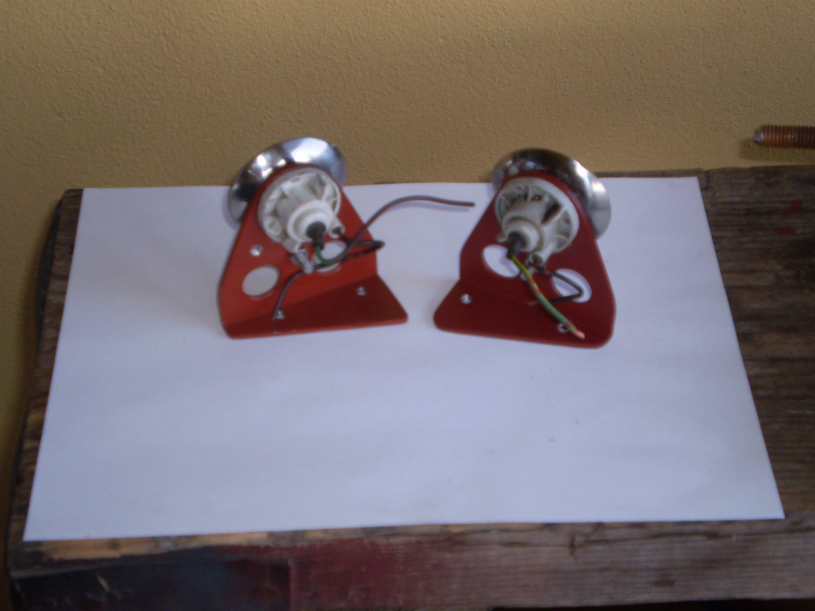

    upload_2022-9-17_18-32-58.jpeg .short 2 eyelets for the earths monday all going well.steve should be back monday to bleed the brakes with me.getting more done since it cooled down than i did all year ha

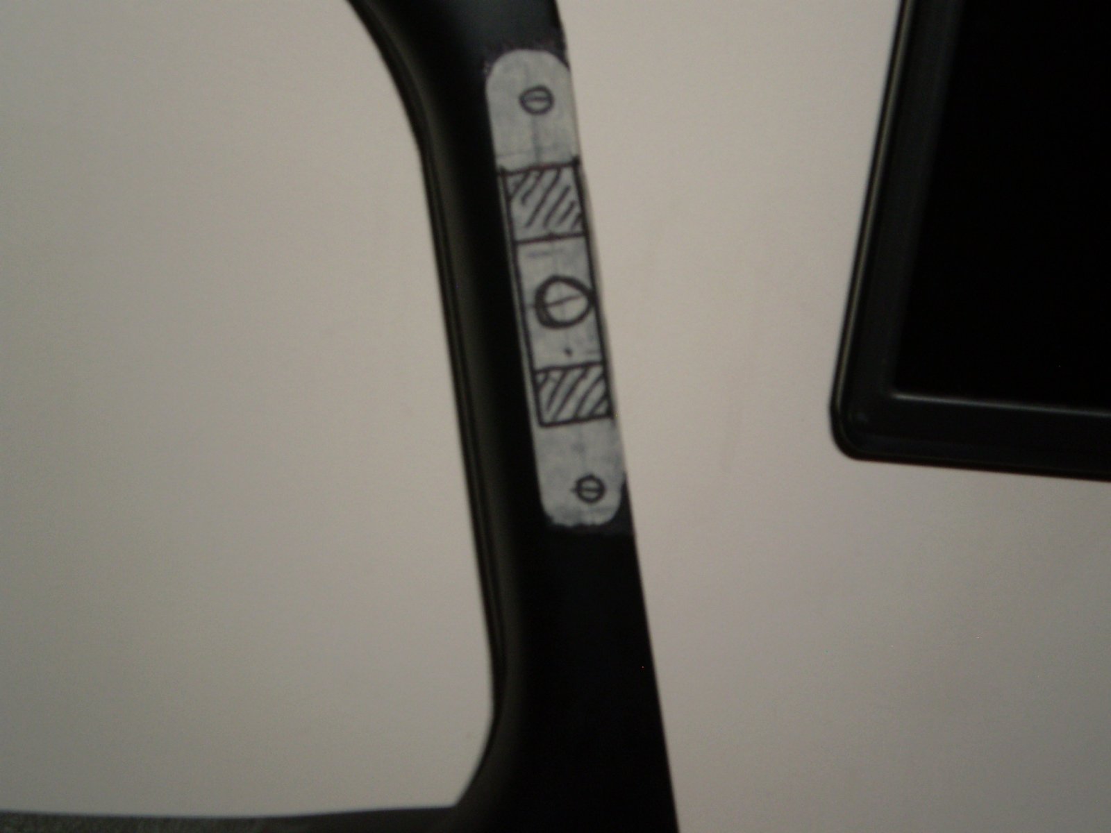

    nunattax
    upload_2022-10-3_0-26-18.jpeg stuck some masking tape on the door frame.what im thinking is a plate bonded to the door 3mm thick drilled and tapped where needed.with 2 m4 mounting bolts.looks like there are 3 folds of metal on this spot so should get a good thread cut. versachem says the epoxy sets into a metal like substance that can be tapped etc.sounds the job.
    then another plate the same dimensions with 2 spacers welded to.(shaded areas)the bushing in the middle can pivot and theres a 1/4 " tensile bolt for the pin..bottom bushing drilled and tapped so no external nut needed.straight 12mm mirror arm with locknuts from the motorcycle mirrors..bushing welded to the mirror arm tapped 1/4 unc to take the jim carter supplied 5" mirror head in black . i think it will work
