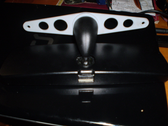

    first attempt at mirror mounting bkt..mirror is 03 vw golf non reflective black bkt 3mm mild steel View attachment 3271957

    second attempt in primer mirror two 006.JPG mirror two 003.JPG .fits this time,used existing threads over the windscreen and made the bracket to suit.will get it in satin black tomorrow

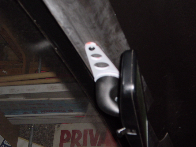

    in satin blak today

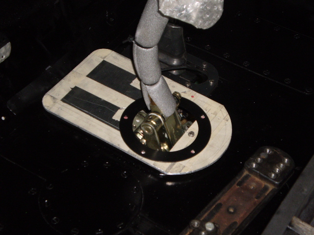

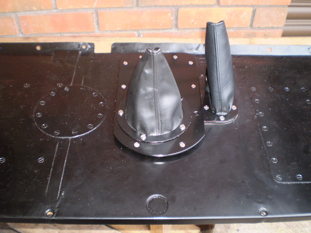

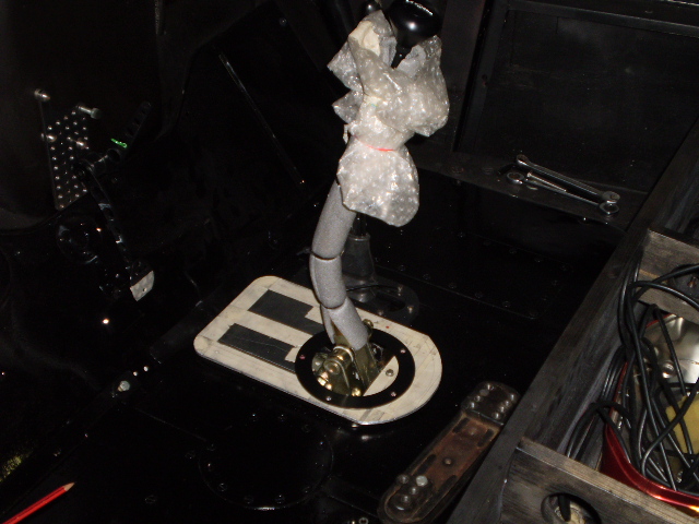

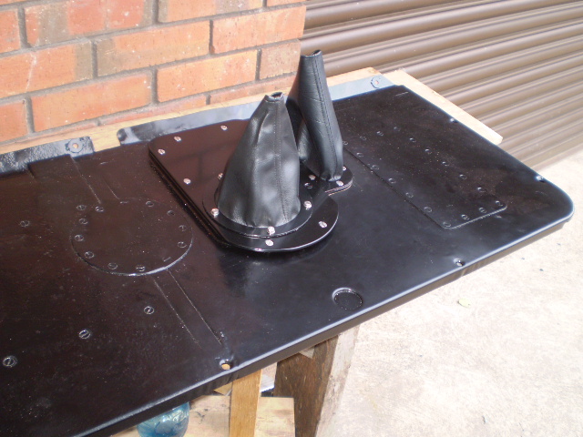

    ive been working on finishing off the shifter.initially I wanted it in the farthest forward position on the trans mount shifter assembly.made a cover for the floor and thought id that finished up.according to lokar I needed a bell crank for this position.bought the bell crank,however when I mounted it ,it hit the crossmember..I needed the lever in the one o clock position but I could only get it in the 11 o clock position.considered moving the pivot forward by 1 1/2 inches and made a bracket to bolt to the tailshaft it worked .then I tried moving the shifter back I position 1 3/4 inch..it still fitted through the opening in the floor.i didn't need the bellcrank now.KISS..so I made a newcover extending it back some.it didn't look far off stock so I went with it..4mm alloy plate I had some in stock. SHIFTER HATCH 001.JPG
    you can see the difference in the covers i will use less screws this time,when its painted black it should disappear.i will run the dyna deck under the overlap at the back of the cover.1/2 inch pipe insulation is great to protect the shifter while working around it
    potential problem left.the pressing in the floor is 8mm high and the cover is 4mm for 12 total.if mytrottle foot is sitting against it I ll have to make the cover again in something thinner.making four covers nothing new there.

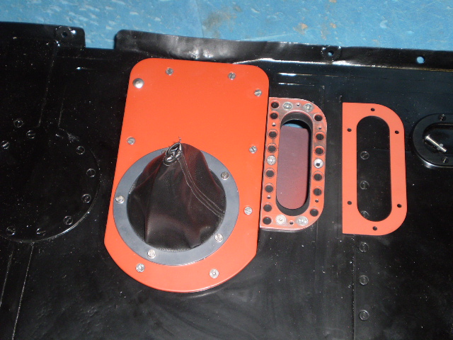

    shifter panel primer 001.JPG shifter panel primer 002.JPG .Cover test fit in primer
  18. nunattax
    Joined: Jan 10, 2011
    Posts: 3,349
    nunattax
    painted the cover.screws will be powder coated black

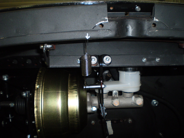

    brakes n washers 001.JPG ive been working on the brake pedal assembly.brake slightly fowled the floor near the end of its stroke.had to fix that. this was due to a bump in the floor.had another small problem. the back of speedo was hitting the brake bracket.the solution is raise the brake pivot and move it closer to the firewall at the same time.
    made a guide to drill the new hole as accurate as I could.guide worked well.
    drilled out the holes .no clearance problems now,3/8 inch clearance for the speedo. the 3, 3/8 holes are close together so made some support washers to get welded on maybe tomorrow

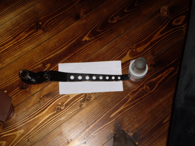

    while I had the brake bracketry apart I decided to drill the brake pedal.drilling keeping the holes a min of 8mm from the edge.hope to finish and paint tomorrow brake pedal holed 002.JPG

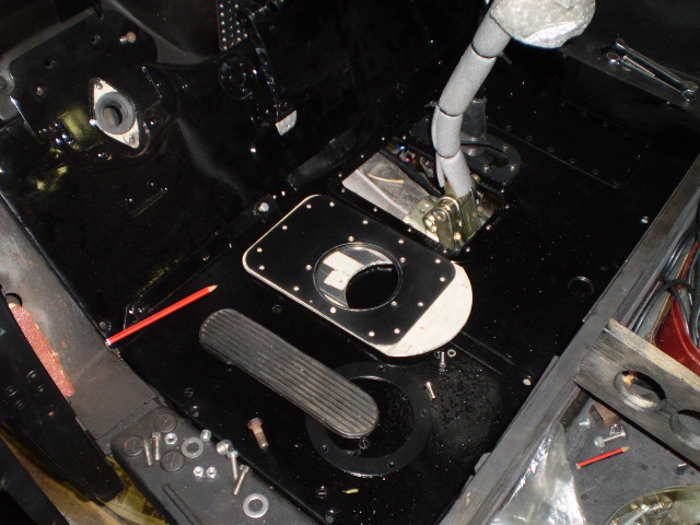

    never liked the way the spoon throttle felt underfoot.in this cab where space is tight it was a small target on the floor.trimmed th spoon a bit and made a new pedal from some 2mm steel I had left over from another job.gave it a trial run it looks much better now any part of my foot will do to push the throttle.moving it to the right is like giving me more legroom.the throttle can go up to 1 1/2 in to the right or 1/2 in to the left on the adjustable mounting brkt or up a good bit.brake pedal has adjustable linkage and can mount left or right of the shaft.should .pedal also adjusts up or down. new pedal 001.JPG drawing gone to be laser cut

    covers were missing in the floor ,I made some from 1.5 mm sheet mounting them with countersunk screws.then stuck 1.5 mm rubber to the floor keeping everything on the level.plan 3mm rubber mats self adhesive.this will almost bring the shifter cover level and keep things comfortable underfoot
