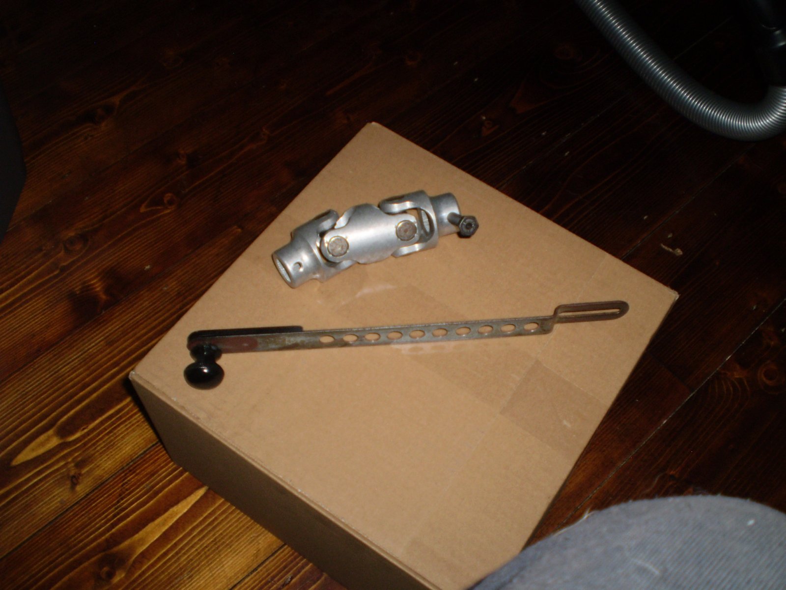

    upload_2023-10-5_18-36-26.jpeg . upload_2023-10-5_18-49-43.jpeg grub screw bolt drilled on lathe.old lock link bar.started drilling this one to lose weight.drilled this using a step drill.its still doing the job.the knob end is quite heavy .and could do with shedding weight.the knob is heavier than it looks,much heavier than it needs to be.plan is to hollow out the knob and machine the heavier end of the link.the knob has casting marks ,irregularities i normally like but will have to go to lose weight

    upload_2023-10-8_17-18-51.jpeg spent a while drilling the old link today.gave the damaged one a trial run.a lot of effort for little reward.made sure i didnt drill the spot welds.will do something similar to the ones in the truck .hopefully the knobs will be back from the machine shop this week

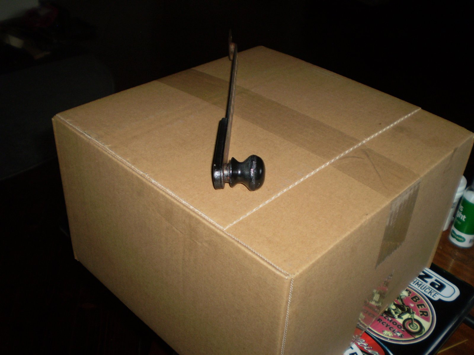

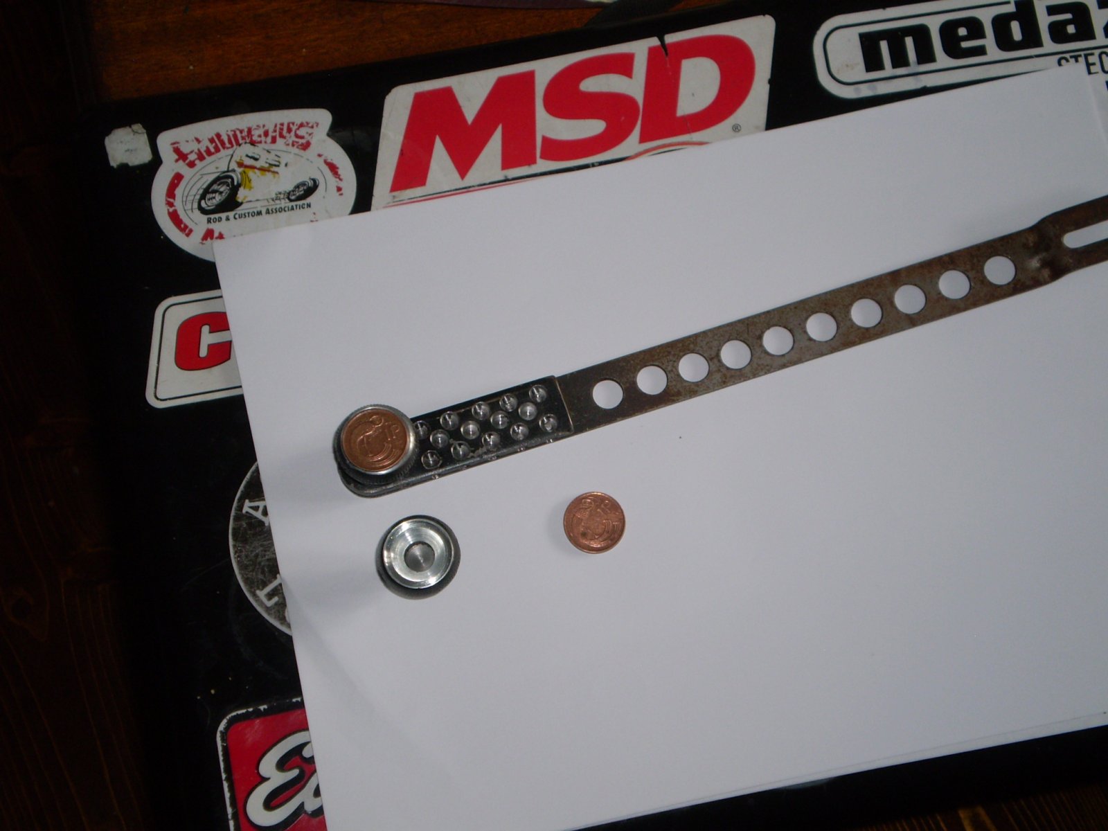

    knobs were machined today and delivered thanks again mick.the threaded insert is splined and pressed in .no excuses now gotta make time to re***emble

    even though we have lost a bit of weight im gonna drill some more holes.mick weighed the knob reckons it lost about 1/3 of its weight post machining.way to go !!

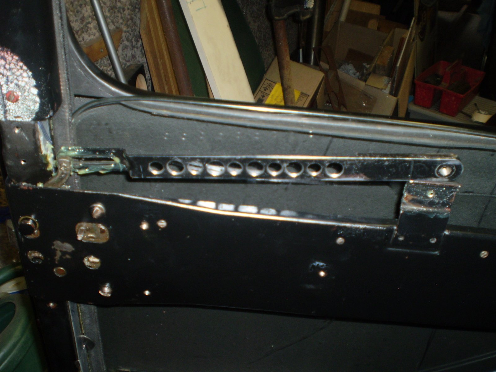

    upload_2023-10-21_16-50-14.jpeg .well drilled the link and knob.greased up everything ,but it was binding when the door card when back on.ive diagnosed the problem .there is wear on the guide on the lockrail.thebottom edge is worn on the guide allowing the link to move off the guide and rub against the door card.plan is to bend up some thin metal and bond it to the guide.then bond a tie wrap to the new metal guide .it just might work.was thinking of sticking the tie wrap to the link but ill stick it to the guide and save theweight on the moving part.

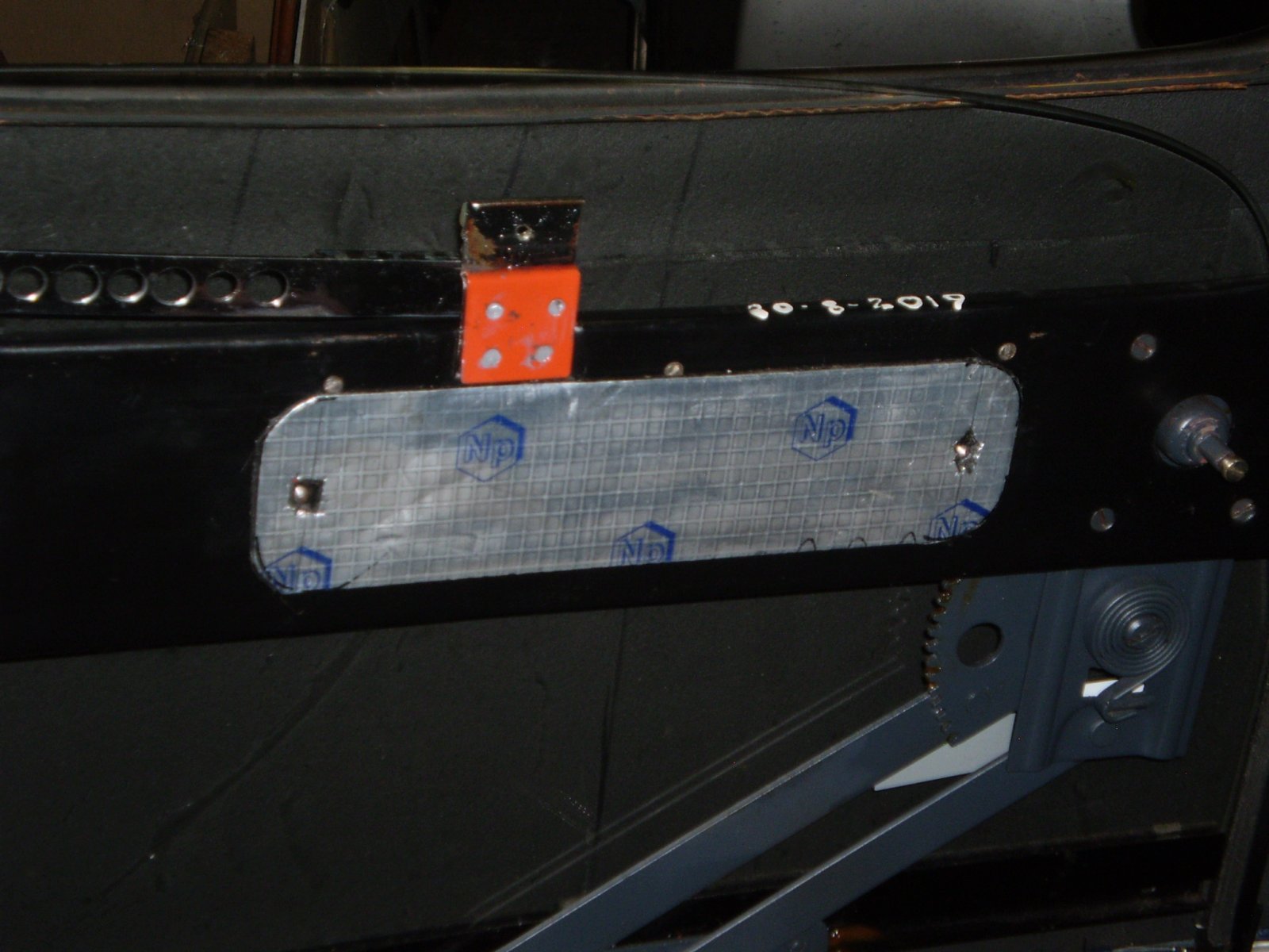

    upload_2023-11-3_17-43-41.jpeg .mission accomplished today. drivers side done .replaced the door panel, all the screws and nipped them up.its working perfectly.as good as if not better than new (a guess ).ended up making the guide from a little 2mm mild steel.didnt use the stainless because the mild steel is easier to bend and cut.its 1 1/2 square with a 1/8 return.drilled some holes on the side to be bonded and let it ooze through.used some 2mm noise insulation to compensate for the 2mm steel.p*** side should be easy now i know the cure
