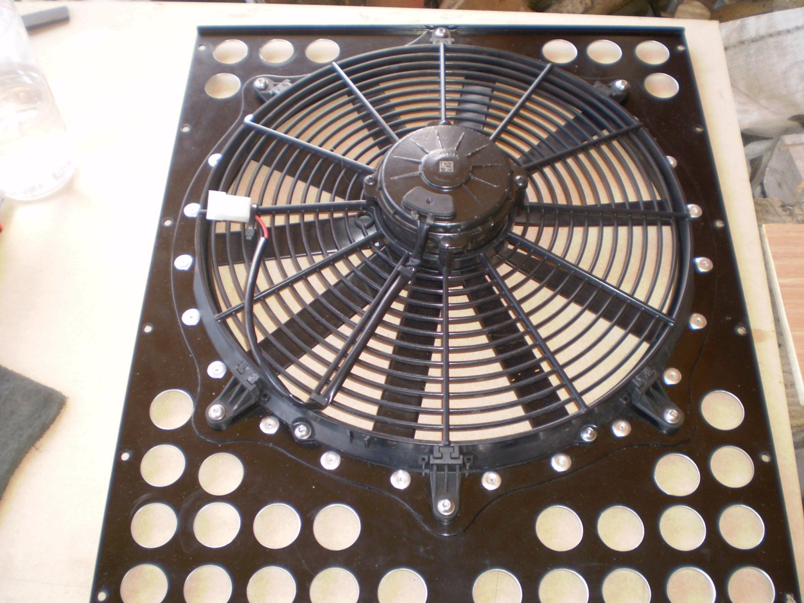

    worked on the fan shroud today.after removing the fan shroud i noticed id loosened some paint from the fins getting it out.its a tight squeeze.after removing the front hood latch catch and the top hose it came away ok.so today i removed the bolts holding the fan and set about replacing them with smaller fasteners.and rivets.i placed some cardboard behind the rad to protect it.havnt got it out yet . there is 6 m5 stainless bolts either side holding the shroud and spacers in place.i used m5 studs on top to locate the shroud until i could get a locknut on .all the bolts fitted in ok.plan is to locktite studs at the bottom as well. then with the nuts loose ill be able to pull it out at top and remove the cardboard.improving the plan as i go.only issue i have now is a 15 mm gap between rad and shroud along the top.three thickness of foam tape should seal this up and steady it up thats the plan ill see whats available.good news is the anode is in very good condition no erosion on it at all. upload_2024-4-20_23-11-58.jpeg .when i made this shroud i tried 2mm but it was light so i added anouther layer of 2mm around the fan.it stiffened it up a lot.maybe next year i will make another similar only folding the edges etc etc now that i know what fits what it will be easier.needs an expansion bottle as well.i ordered a curved vane fan but i got a straight one vender offered $100 dollars cash back so i accepted so not complaining now.kept the fan nearer the top of the rad where the hotter water is.also kept the spal motor above and away from the waterpump pulley

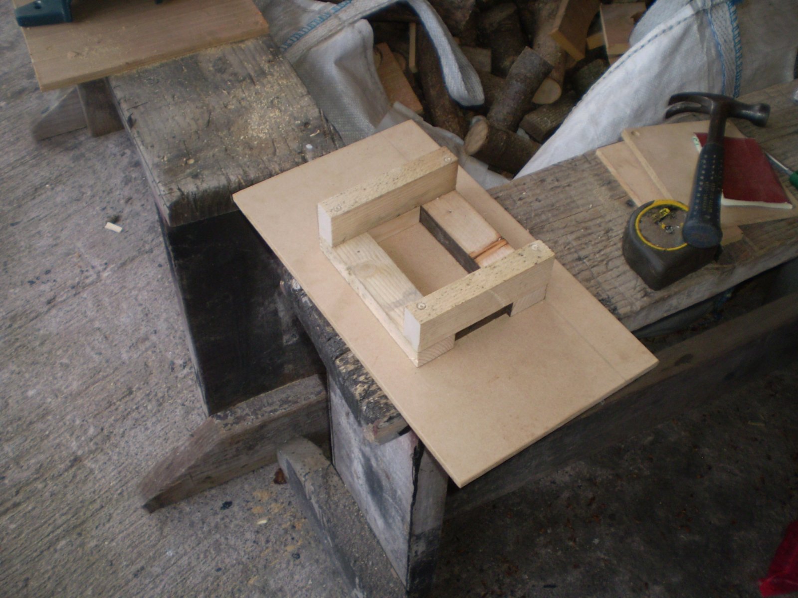

    knocked up a stand to hold the carb while im working on it.it will fit into an oven tray to help keep anything dropped in the tray.just keep the carb on with wood screws and washers. upload_2024-4-21_1-17-39.jpeg

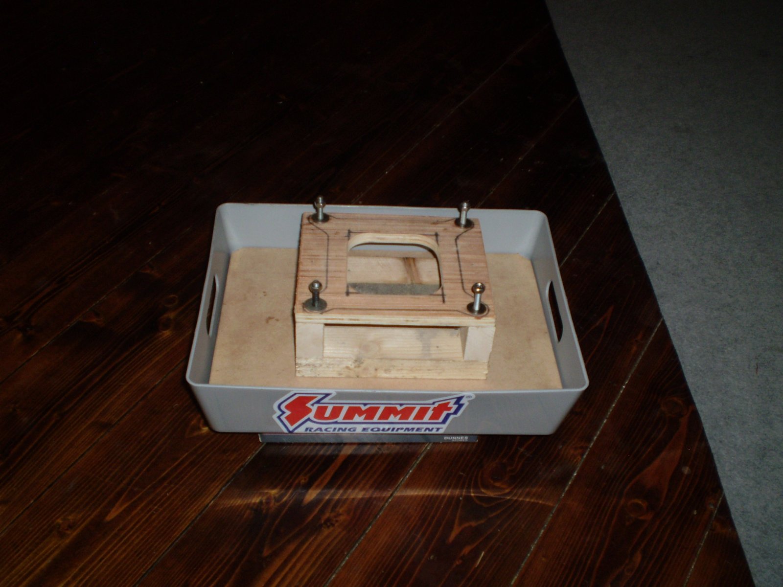

    upload_2024-5-2_22-53-35.jpeg .finished this one off. timber is sitting in the tray.if anything went down under i can retrieve it.

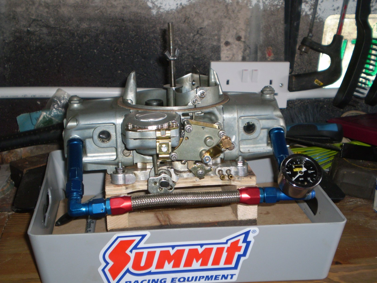

    ok so a holley manual operated ckoke will fit on a demon carb after all with small mods.it went on easy after with the help of master machinest mick.i had been doing a little research on the subject.i read some where it would need to be spaced out by 1/4 inch this proved to be the case.mick measured up with his verniers and said we would try 3/8.after mounting with 3/8 spacers he declared we had 1/8 to spare and machined 1/8 off.they fitted perfect of course they did.there was a choice of 3 brackets to hold the cable and 2 arms one cranked to operate the choke. we used the cranked arm and the curved type bracket to hold the cable it bolted to the top of the vacuum cover.the bracket was high so mick machined the top of the curved cover for a flat mounting surface.everything lined up great.all the screw were the same thread 8-32.(edit) we had 6 in total 3 that came with the kit but they were too short with the spacers ,however the 3 we removed from the electric choke were longer and fitted fine the 3 screws for the kit were cut and used to hold the cable mounting bracket..no waste here.the vacuum unit came off easy but we couldnt tighten 1 screw to replace it.drilling a hole in the bracket allowed clearance for an allen key to pass through.the video i posted earlier was a great help and we looked a few times to be sure to be sure .overall im really happy with how it turned out.now im looking for another diaphram for the vacuum secondaries,.need to find one soon because of the time lag between ordering and the parts arriving .now just need to find the serial numbers so i can order the correct parts
    been busy in the shop as well.fitted up an extra 8ft of worktop and plenty double sockets as well.
    placed an order on amazon for a new gates rad hose gates 20225 will do it.ordered a valve spring compressor and some tools to finish the job.nearly there .tidy down the new bench.should be ready to start rebuilding next week.roll on the summer.
    im not too impressed with the blue /red fittings on the fuel line .but it doesnt leak and its not visible with the air filter back on.the choke when pulled on will raise the idle a little .that will be a real novelty in the colder weather
