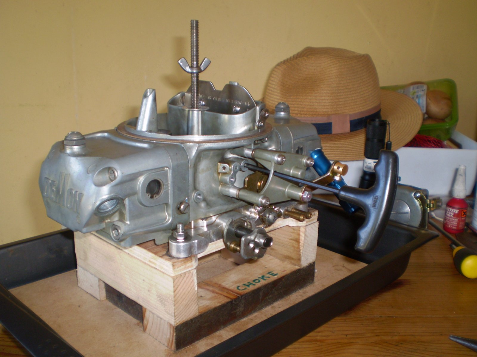

    no cam in just finished this bit up.cam is next.went for c-clip m4 fitted the vacuum shaft perfect nice fit.no small r - clips in town .ordered a selection in stainless from amazon .9 e with 7e shipping 100 pcs in a plastic box .lifetime supply.due this day week 11th june . upload_2024-6-4_18-31-54.jpeg
    small modifications needed drilled choke plate to access the vacuum pod allen screw.used a little longer adjusting screw on the fast idle cam.the screw was runnung out of adjustment and binding the spring before it got where it needed to be .adjustment to the fast idle screw is hard to access with the vacuum pod in place .hopefully when it is set it up that will be that. sin e

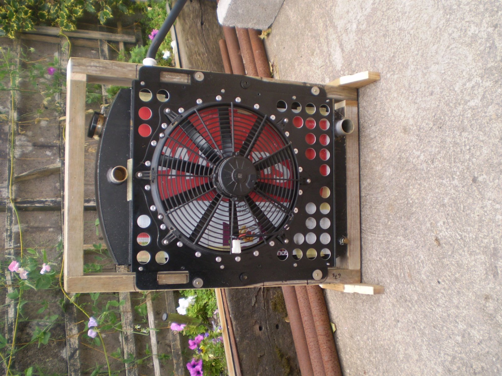

    upload_2024-8-3_17-20-15.jpeg .water pump grill and rad/shroud removed.knocked up a stand to hold the rad.keep it from getting damaged .going in the bed for the time being

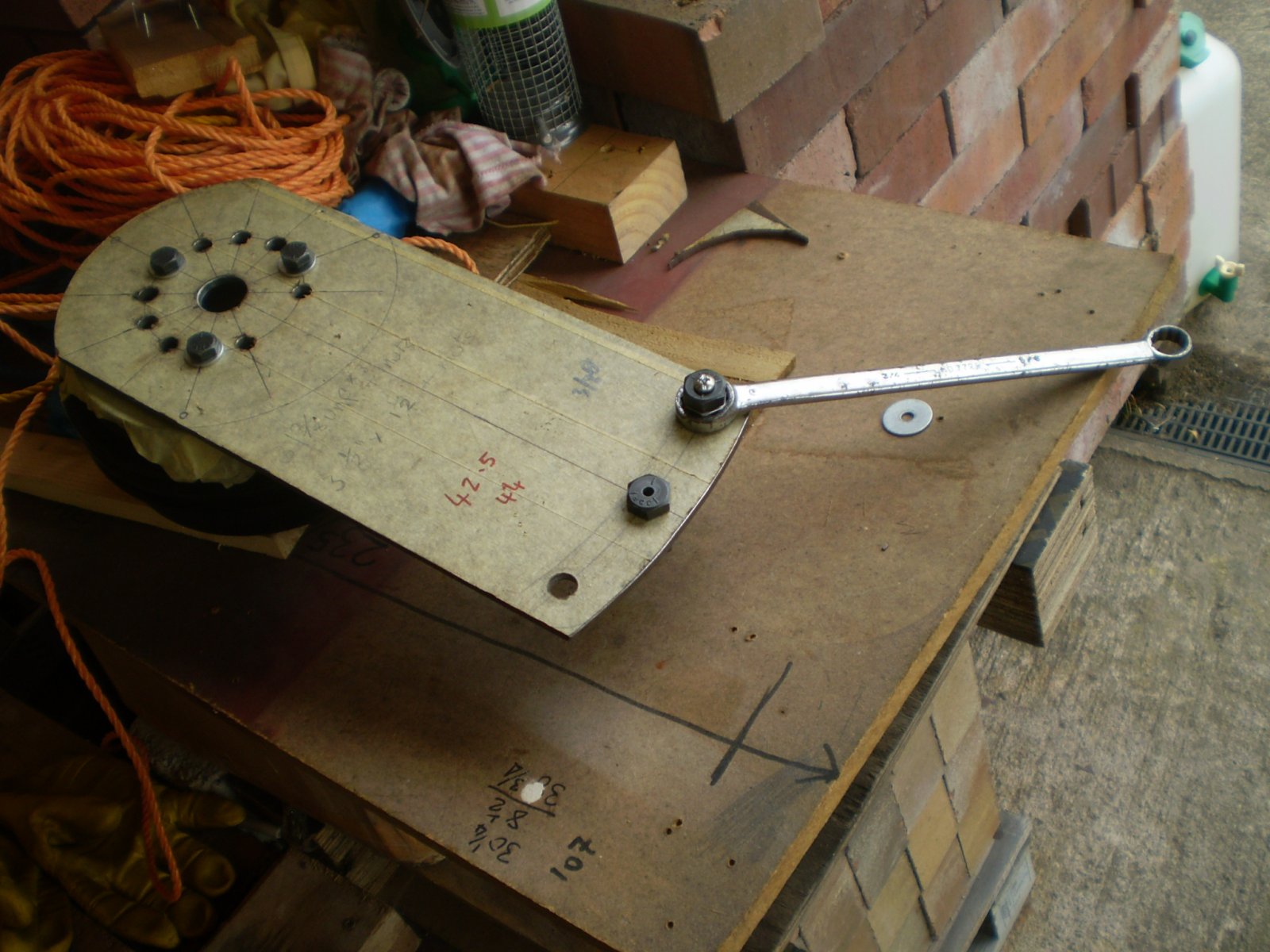

  17. nunattax
    Joined: Jan 10, 2011
    Posts: 3,299
    nunattax

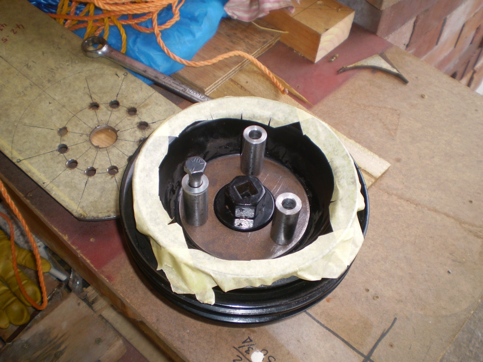

    so the crank nut came off with the impact gun.i dont want to use that to tighten the nut back up.i want to be more precise,so i started working on a tool to lock the pulleys up while i torque the nut up.think its gona work pics to follow as i make progress.visited the scrap metal yard and purchased some 6mm plate for a reasonable price.a little surface rust but its cleaning up nice

  19. nunattax
    Posts: 3,299
    nunattax

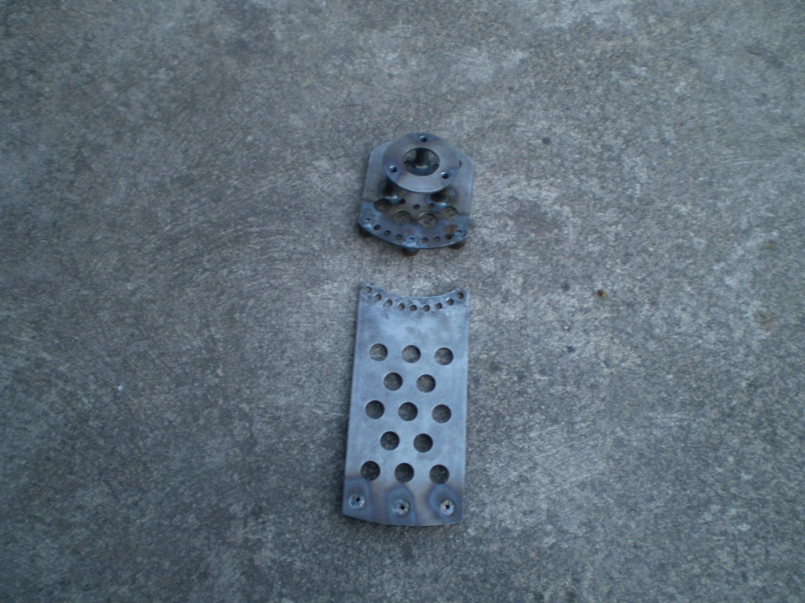

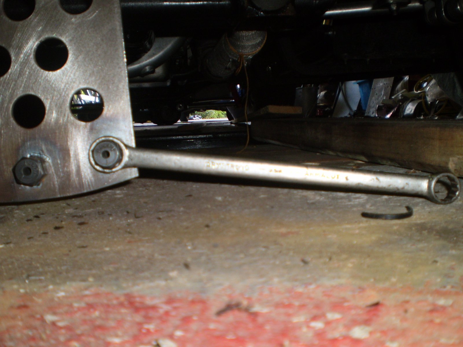

    my crank lockup tool.dics bolts to pulleys /balance spacers welded to disc .plate bolts to spacers.nuts weld to plate.long spanner sits on welded bolts to stop everything rotating.1/2 inch welded bolts through drilled m5 body washer stops bolt falling off during the torqing process.needs welding maybe fine tuning and painting.can use to tighten or loosen crank nut .thanx mick for the spacers P8020009 - Copy.JPG P8020012 - Copy.JPG

  20. nunattax
    Posts: 3,299
    nunattax

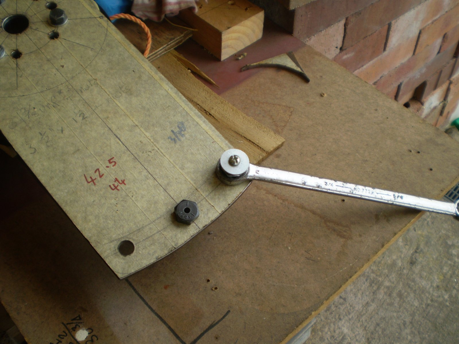

    1 st mockup says it will work with modifications..as it is the plate is trying to run through the anti-roll bar.solution is to bend the plate to clear the roll bar,move the end of the plate 1" farther away from the pulley.or cut the plate insert 1" square box and bolt weld the lot together.let me see.whether i bend the plate or cut it ill loose an inch in height either way,but it will work either way.

  21. nunattax
    Posts: 3,299
    nunattax

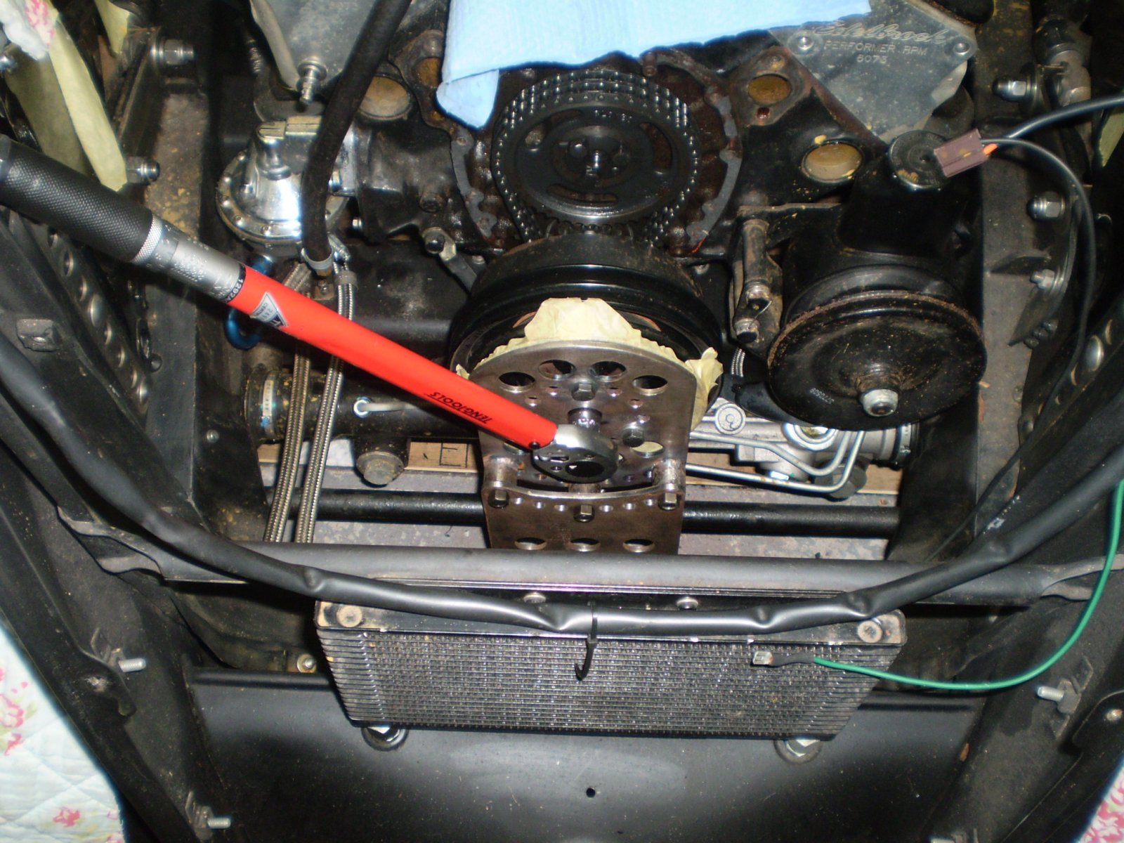

    finally the crank lock up tool is together just need to add paint.thank to my good friend mick for the welding and the spacers.just gave it a trial run everything fits and it works.drilled a 10mm hole to hang it from the rafters on a hook.it could spend a lot of time there.two piece design works well.easier to screw the top half to the pulley then bolt the bottom section later less weight at the one time plus the 1" holes make it easy to hold. upload_2024-8-20_20-57-13.jpeg .

  22. nunattax
    Posts: 3,299
    nunattax
    P8070015 - Copy (3).JPG upload_2024-8-20_21-2-4.jpeg .doubled up on the nuts,theres plenty of hold for the spanner.

    happy to say my crank lockup tool will come in very handy for torqing up the cam sprocket bolts as well
