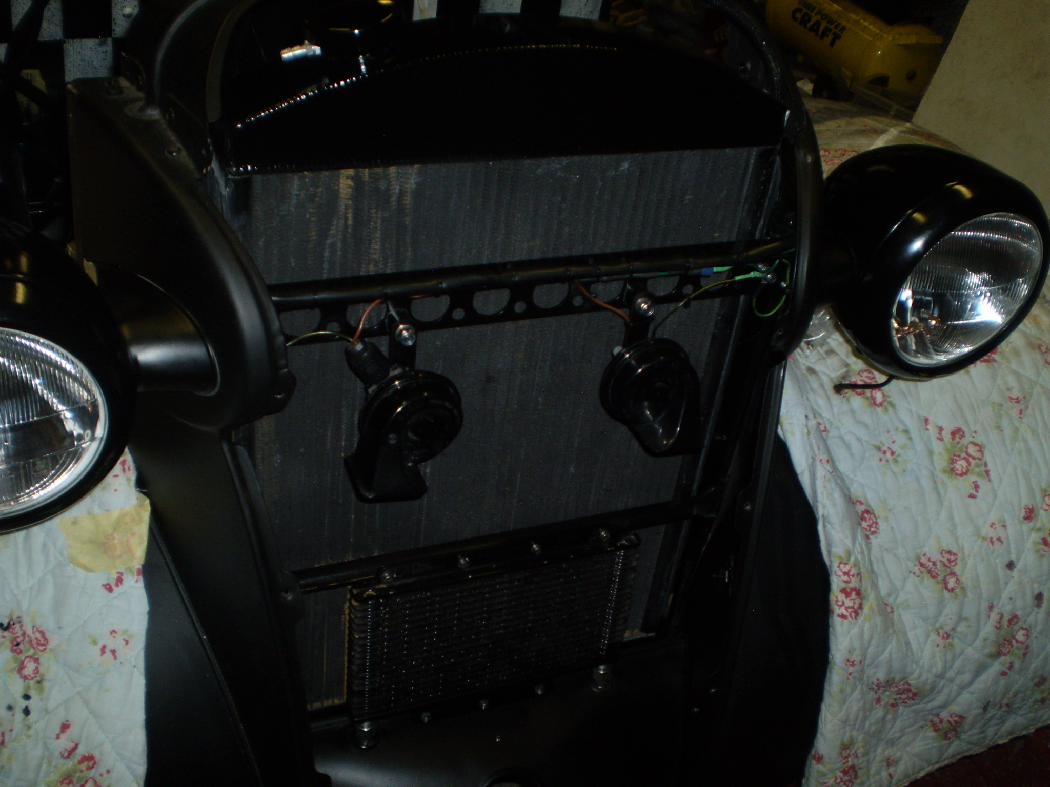

    trying to finish up the front section.new bracket made to hold the horns and to hold the wiring.horn bodies sanded and painted black.ran out of laquer..custom mounts made by mick o.then water in the bathroom floor .it must be fixed where is it coming from.think ive located the leak.we will see tomorrow..daily due a test so it will need to be cleaned out.needs new wiper blade and maybe blow out the air filter.its going great.maybe the rad will go back in this weekend.2 man job not to scratch nothing

    computer fighting me upload_2024-11-21_19-14-59.jpeg .horns are as symetrical as i could get them without buying another pair and attempting to rotating the plastic cover on the body possibly by heating.this pair work and they are loud.
