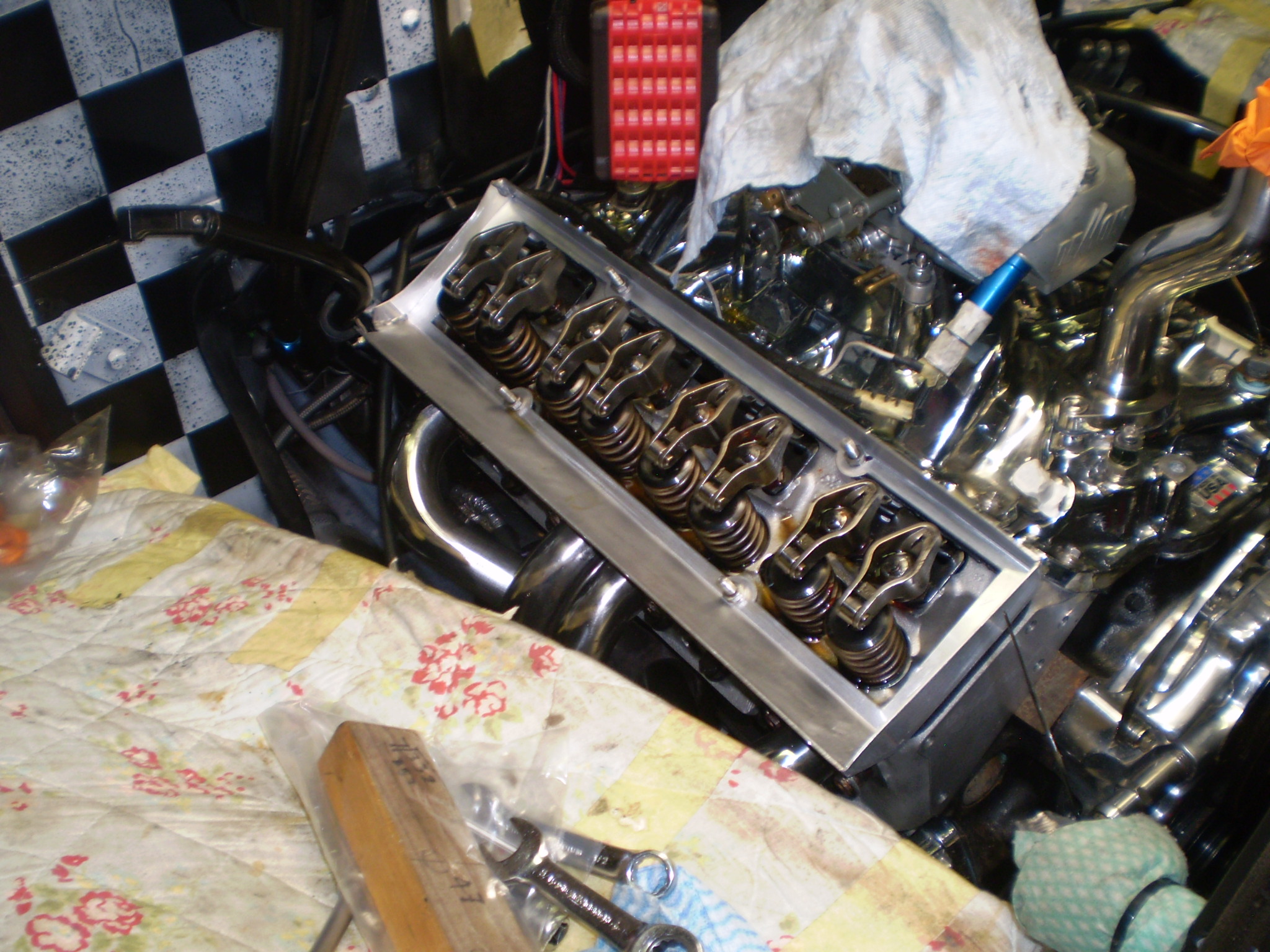

  3. nunattax
    Joined: Jan 10, 2011
    Posts: 3,390
    nunattax
    upload_2025-5-1_23-5-23.jpeg .a pic eric its a battle posting pic s at the moment.tray fits both sides of the motor but i had to clearance it for the trans dipstick.made a mitre box so i could cut the corner off and do a neat job.need to weld the corner up and paint it too finish up.might not need it again thats fine by me .just bag it up and hang it from the ceiling

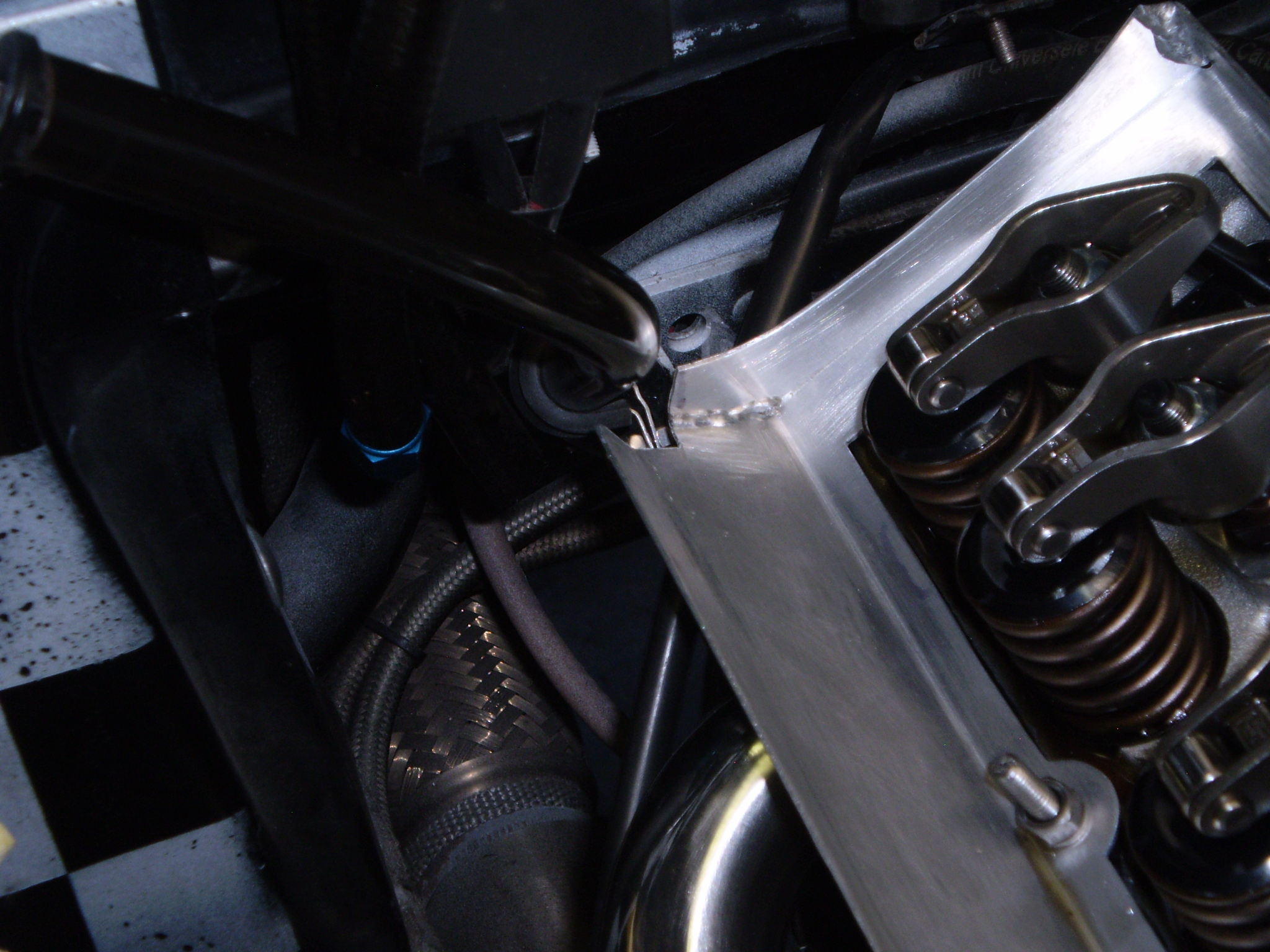

  4. nunattax
    Posts: 3,390
    nunattax
    upload_2025-5-1_23-19-52.jpeg had to notch for clearance .made a mitre box to cut the corner off neatly (not shown).next drop in the dizzy and get the corner of the tray ready for welding.
    with the tray bolted on over the gaskets had no oil leaks running down the heads i declare that a success.
