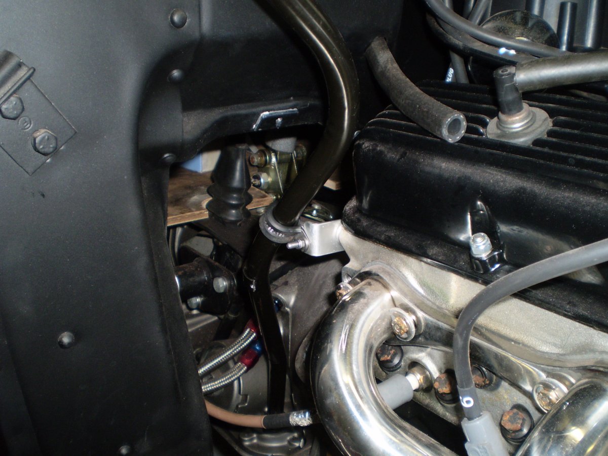

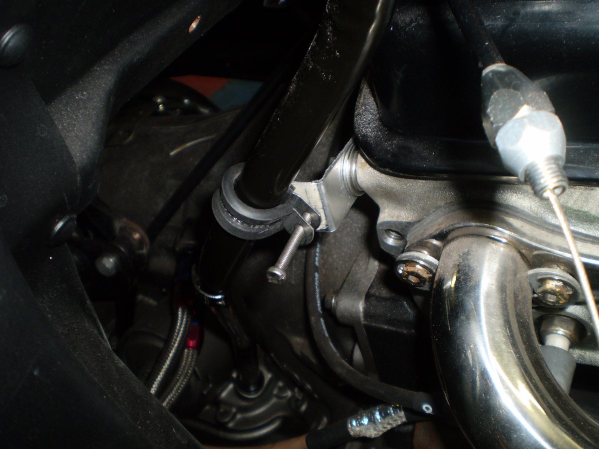

    trans dipstick steady 001.JPG trans dipstick steady 006.JPG [ View attachment 3514965 I was still waiting for the bracket to steady the dipstick,no sign of it the guys busy so I made my own from 25x3mm aluminium.ducafe knocked up two stainless spacers for me,thanks mike.drilled the 3/8 bolts to lockwire them.superglued the spacers to the head to make ***embly easier.another little job done and dusted.
    once I get the dimmer switch in and wired should be able to put down the floor.

    eventhough this bracket will work fine I think ill make another that will mount to the transmission.as luck would have it the top of the dipstick broke off..now I think shorten the tube at the top shorten the dipstick and reattach the top..maybe cut the tube near the clamp and twist it 90 degrees.sleeve it and put it all back together.should end up with a tidy dipstick away from the rocker covers and easy to use filler tube

    tired of waiting for a stainless bkt,I made one from aluminium instead..cut it from 4mm aluminium plate and 1/8 x 1 inch stock on the top..anyway that's the final bracket for the time being.when I paint it black tomorrow I want it to disappear and b forgotten about. trans dipstick bkt 001.JPG

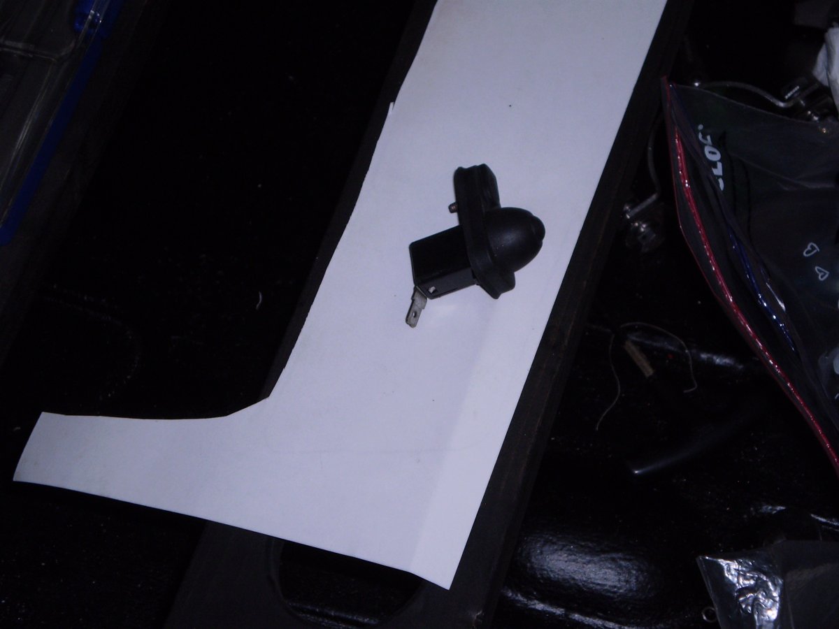

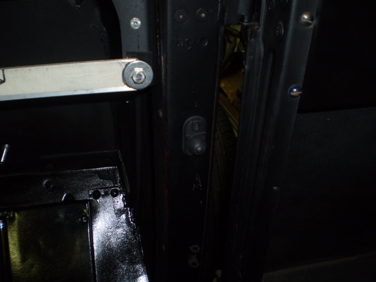

    fitted a switch tonight to the p***enger door.switch came from a Suzuki swift that's been in the family for 15 years.recently went to the crusher.switch is a reliable unit and its got its own rubber cover normally fitted in the b pillar near the cill..drilled and tapped the a pillar and filed out the opening.anyway fitted well a combination ot large clearance between door and a pillar and a recess in the door..switch clips into the opening on the bottom and 1 4mm screw locates it on top door switch 003.JPG door switch 005.JPG door switch 006.JPG [ATTAC
    maybe do the other tomorrow night
