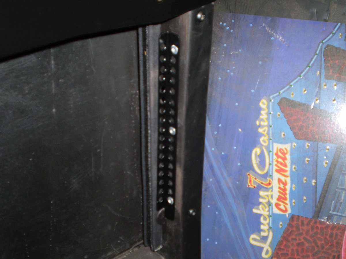

    nunattax

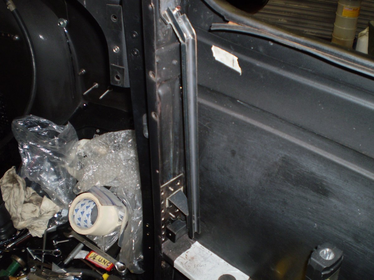

    spent a few hours today trying to install the p***enger side winder mechanism and replacing broken/missing track.going good so far hope it will look like new when its welded up and painted.its a challenge to keep it looking stock even though nobody will be looking at some of this tuff

    window winder plus various 001.JPG replacement window track trial fitted nothing welded just bolted so I can make adjustments if needed untidy floor is a sure sign of loads happening

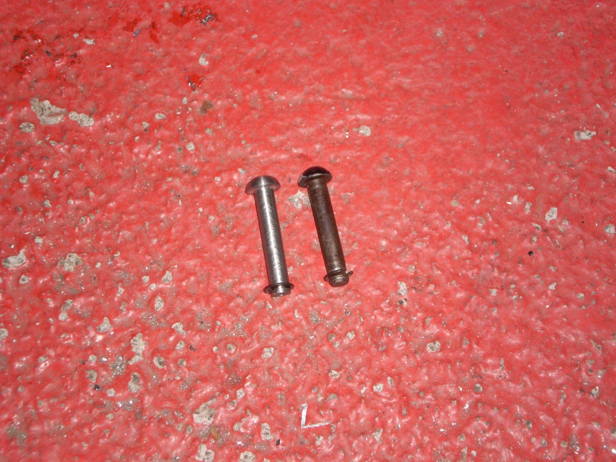

  10. nunattax
    Joined: Jan 10, 2011
    Posts: 3,389
    nunattax

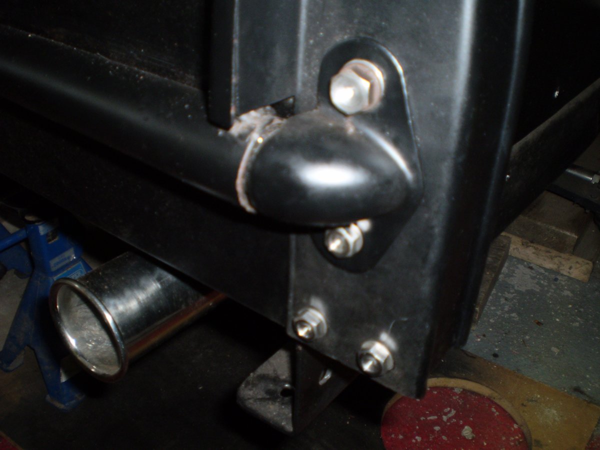

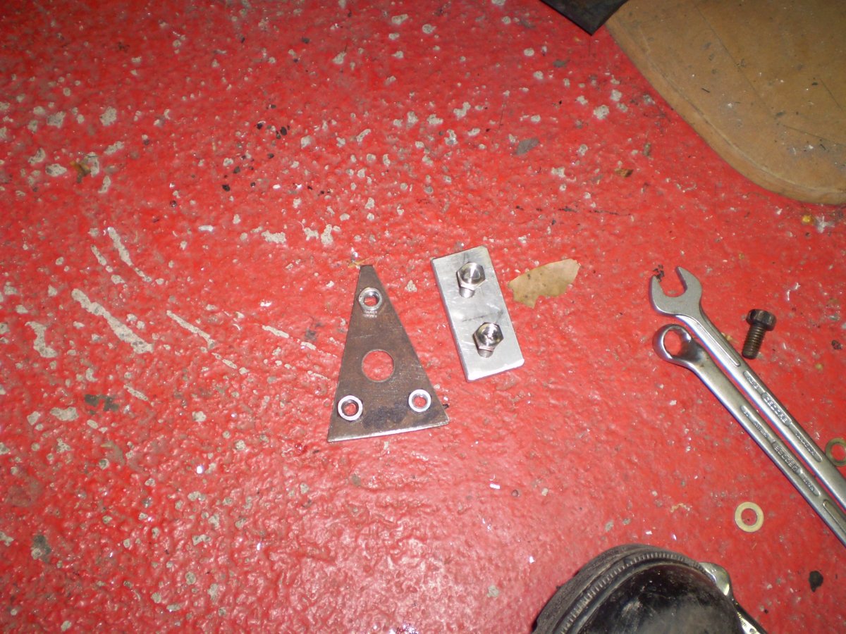

    got the bolts machined to take the m*** produced look away,made some plates to weld nuts to,to make ***embling the bed corners less fiddly,some bolts are stainless so ill powder coat them satin black

    nunattax
    aidan feightery pass door winder assembly 004.JPG not much to report for today up early and in the hot rod shop.got sidetracked with a visiter from Australia..trial fitted the gl*** felts p*** side.broken tab on p*** side so I made one and fitted it.,riveted it on.and painted it.working well so far tech tip bend the felts around a suitable sized pipe for the corners and get nice even bends.gl*** will fit the openings much better.

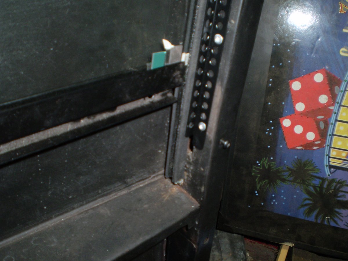

    nunattax
    door tracks pass side 002.JPG door tracks pass side 001.JPG fitted p*** side door gl***had some trouble getting the gl*** in due to a small eror on my part but its in now.just a little tidy up tomorrow and paint a few bits,make a little bkt for the rear of the felts to stop it popping out of the tracks when the gl*** is wound up and were there.

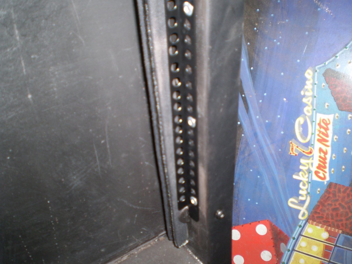

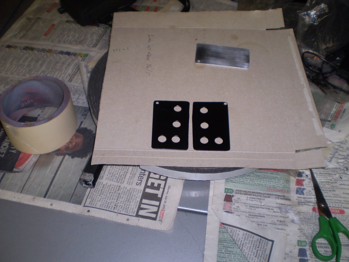

    made up some alloy plates to fill the voids in the a pillar behind where the door straps mount.1.5mm alloy weigh next to nothing.stuck to the back of the a pillar with adhesive window brackets 002.JPG will keep the weather out

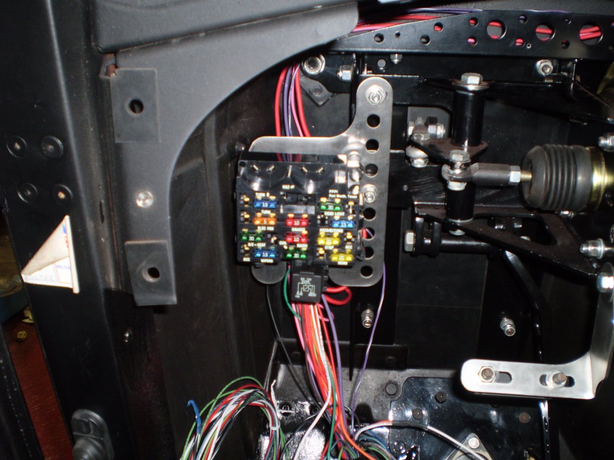

    wiring has commenced wiring started 001.JPG 1 day in starter is turning over and charging circuit complete another 1-2 days in it

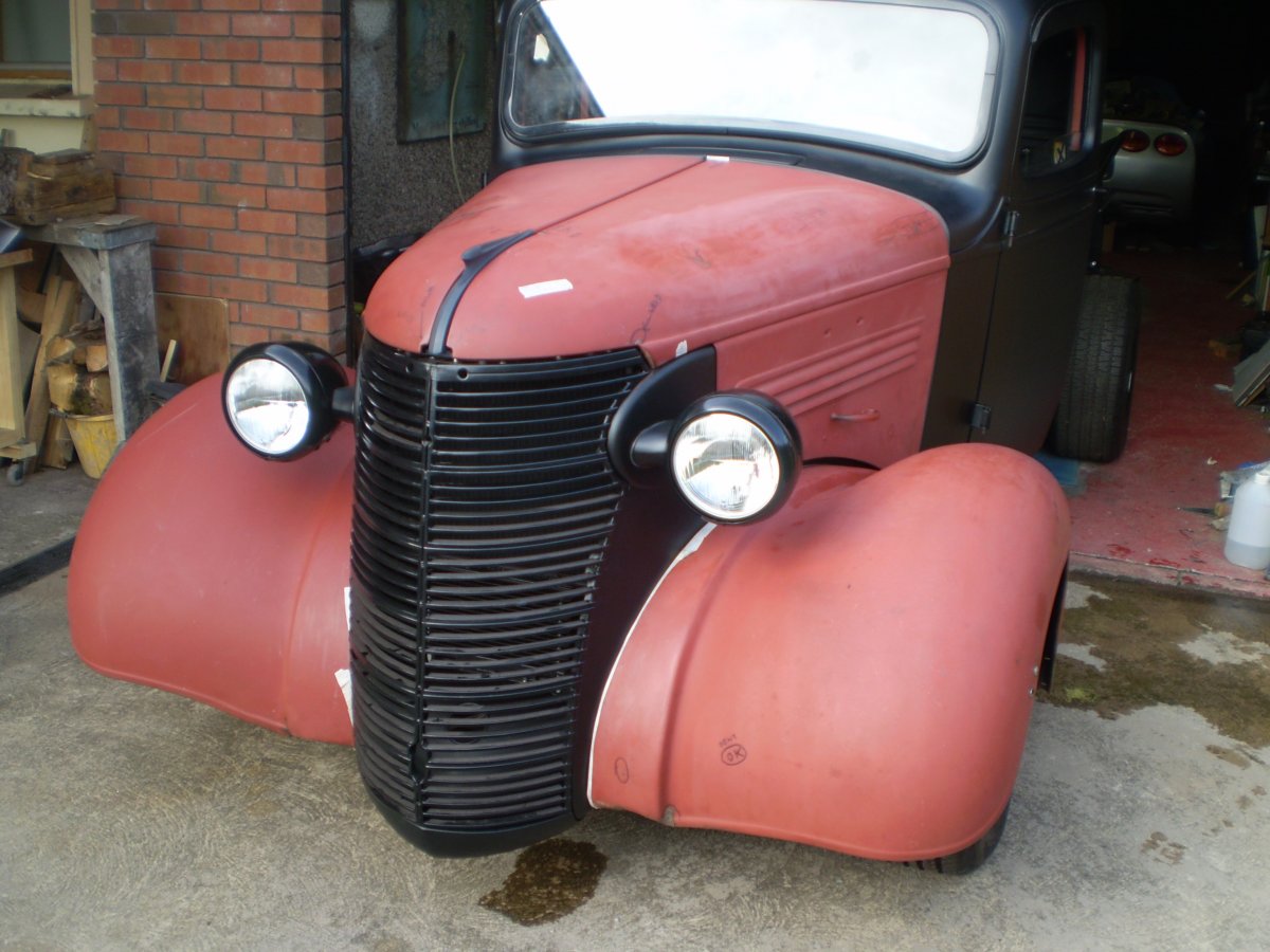

    nunattax
    today trial fitted the inner wings and wings along with the hood.checked for fit...some shimming needed here and there but not too far out.
