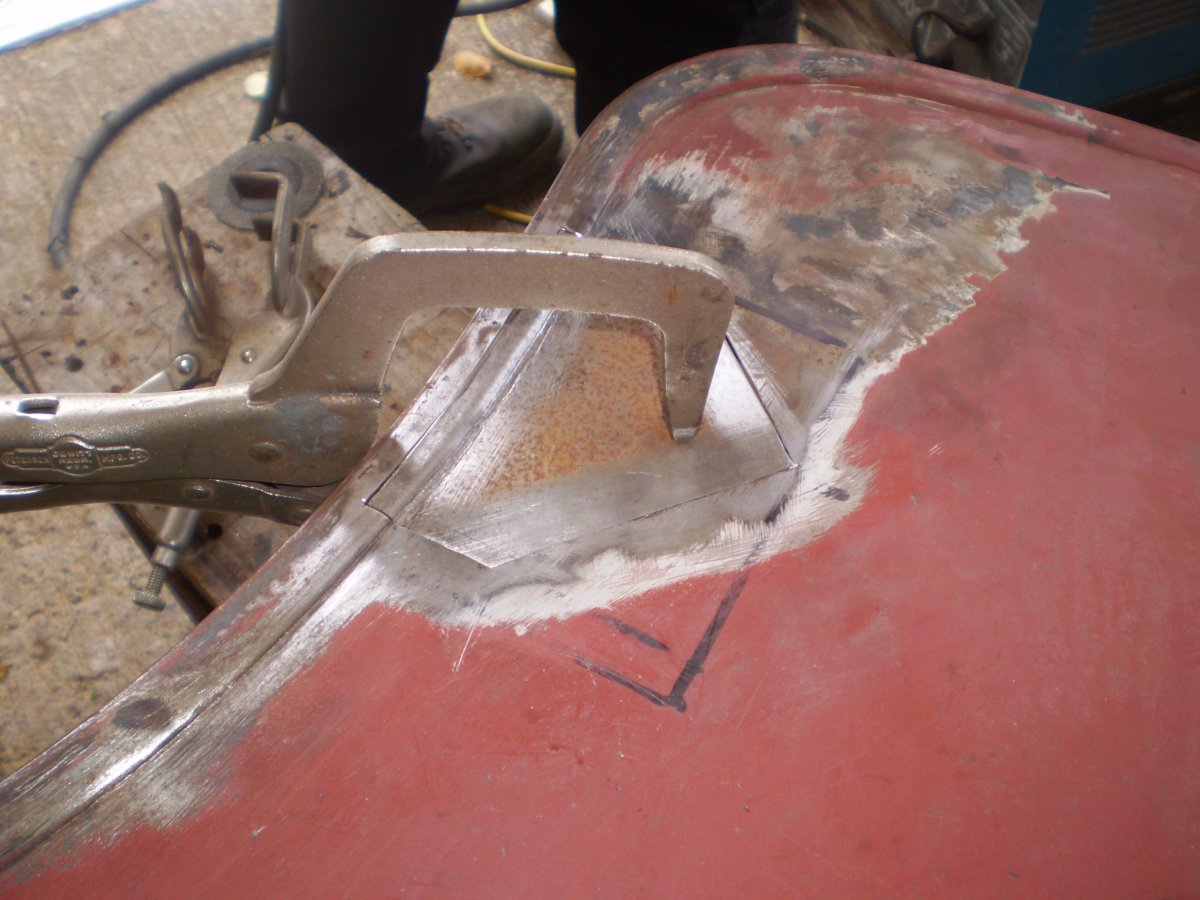

    hood top welded up. and tweaked.re***embled and trial fitted,very happy with the results..better than I had hoped,nice work Ciaran.

    drivers side front fender welded up ,with good results

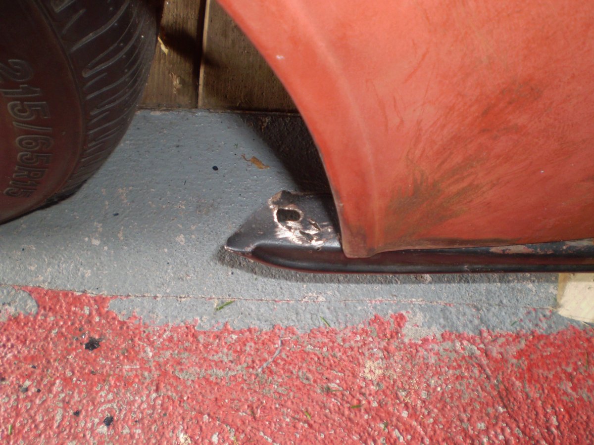

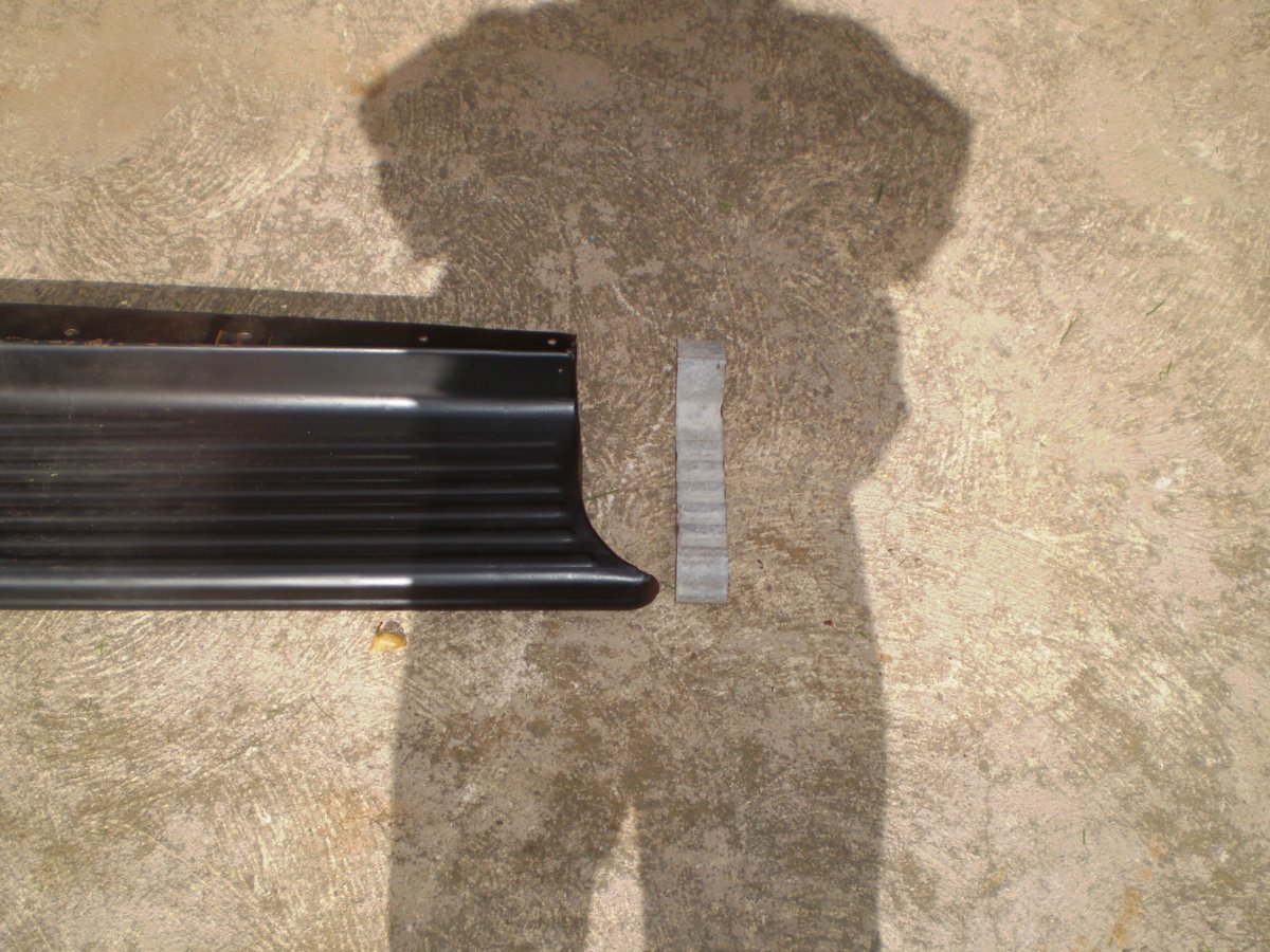

    section running boards 1 002.JPG running board that came with the truck are not the correct ones.they bolt to the rear fenders the bolt holes line up at the front they bolt up to the front fenders ok but need some modification..we took 2in out of the rear of it and welded it back up.it needs to be trimmed at the front as well.fantastic job kieran

    It's weird I ordered some fibergl*** replacement ones(that is didn't end up using) and they were off almost exactly the same amount at the front.

    strange allright.we trimmed 2 inches off the back.at that the ribs stop 7/8 in short of the front fender..i wonder are they from a 3/4 ton model.

    Not sure mine were suppose to be for a 1937 half ton. They were fine at the back but long like that at the front. Maybe yours are from a 3/4 ton.

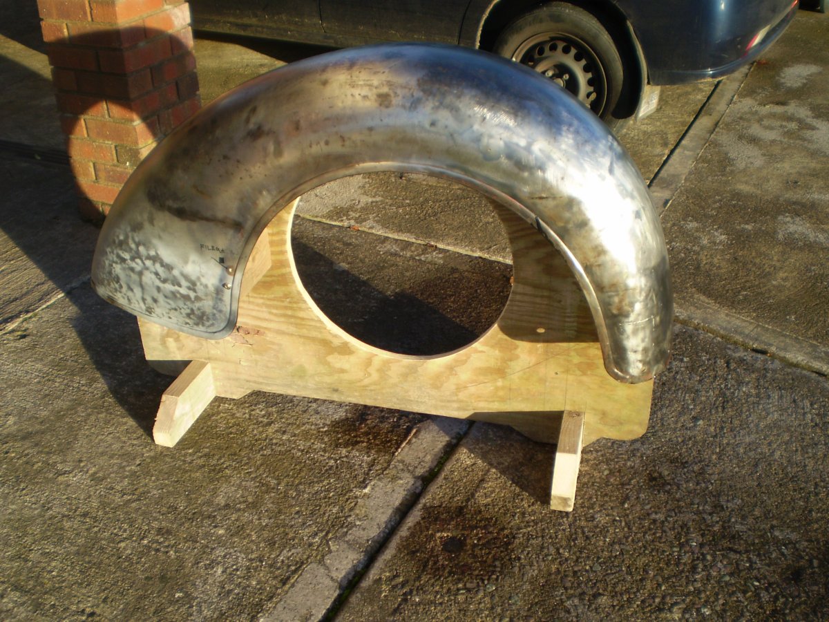

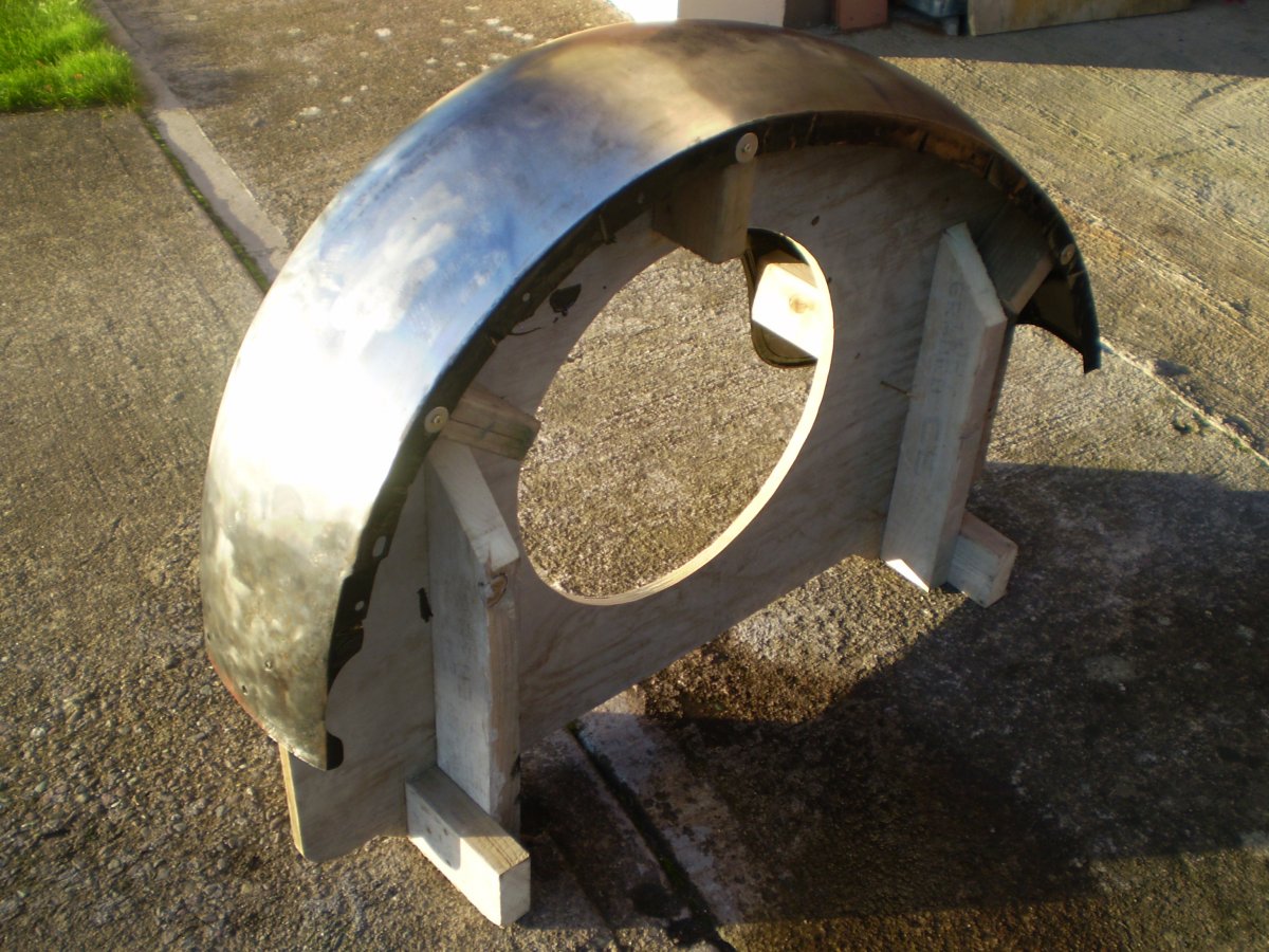

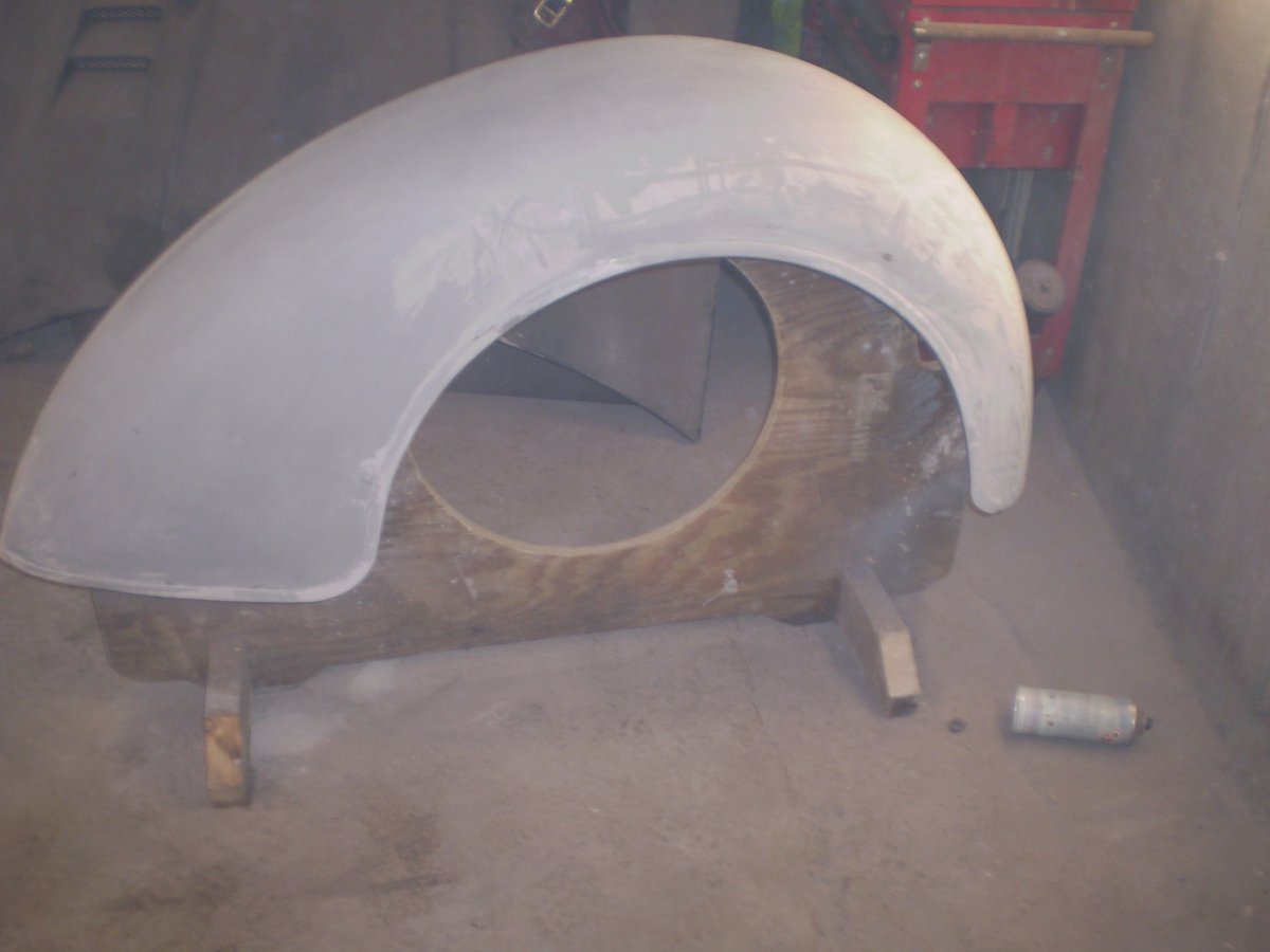

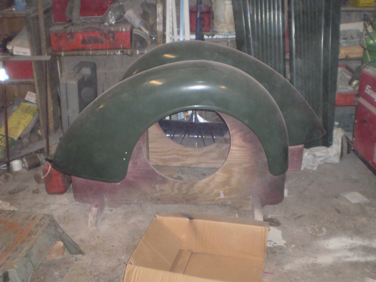

    076.JPG 075.JPG been working on the rear fenders.they have been through the wars.lots of stretched metal and some very thin metal in places had to replace some metal .made a stand to hold the fender while we are filling/sanding itused POR 15 on the underside.great tack to stick to light rust,i have a quart of POR 15 topcoat so ill give the underneath a coat of that as well,before sanding and treating it to a coat or two of underseal. as well..the crest of the fenders were pitted .no amount of sanding would have cured that so I sprayed the pitted area with VHT rust treatment to kill off the rust.a lighr coat of filler hopefully will make it looking like new.
    stands constructed from 3/4 shuttering ply and 4x2.heavy enough for a stable platform while filling and sanding..cut a hole through the ply to allow access to the other side with the dolly.gonna make a second one will be handy when it comes around to spraying them.

    068.JPG 074.JPG 070.JPG should have taken photos of the running boards before we started..no major rust but the front was beat stupid out of shape.as well as that I think they were from a 37 1/2 ton.anyway they didn't fit well.at the back 2 inch was removed and welded back together.bracket underneath was relocated.at the front 62mm was removed and rewelded.bracket relocated and sectioned..the bracket bolted to the frame was modified. dropped down 5/8.not so sure what the front wings were on originally but they fit very well now..phew cuttins stuff up is a big thing when you may not be able to source a replacement easily without breaking the bank..alls well that ends well. big thanks to CM for your help

    Great idea for the stands. Looks like you're off to a good start.

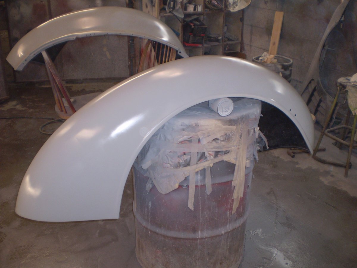

    finally got the front fenders in primer,and some paint on the rears front fenders in primer 004.JPG .there was some damage to the fenders at the creases at the rear of the fenders.it took some time to reclaim them.happy with how the creases turned out ,worth the effort in my opinion.nothing fancy about how the fenders were supported.it was getting late.we had to get the job done.should be well dried by monday

    thanx lads. primer sanded stopped and sanded again.should get some paint on tomorrow

    well today was the first day I felt the back was broken in the painting..sanded the front fenders with 1000 grit.didnt take too long at allim happy with the finish.had to sand out a few flies that dropped in.4 fenders ready for paint and the filler pieces between bed and running boards.hope to paint next week front wings in paint 001.JPG im sanding in the hope of a smooth satin finish not a shiney one

    1000 grit is way smoother than you needed.
    project looks good! go man go!
