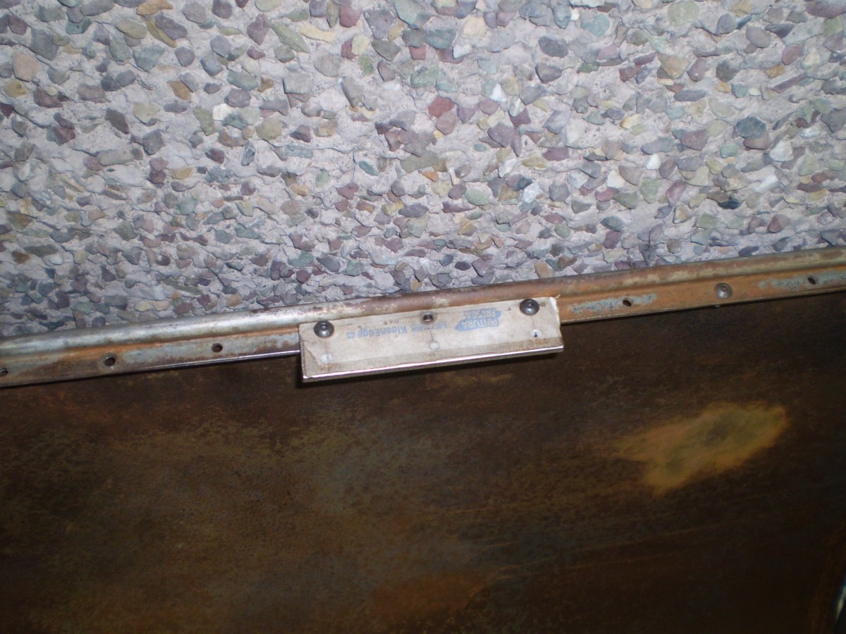

    hood hinge drilling jig 001.JPG hood hinge drilling jig 002.JPG hood hinge drilling jig 003.JPG hood hinge drilling jig 004.JPG weather warmed up a little today .I ventured out to the garage.when the hood was in the open position the hinge was flexing a little so I doubled up on the m5 bolts using a jig
    under the hood has surface rust on it.POR15 should sort that out

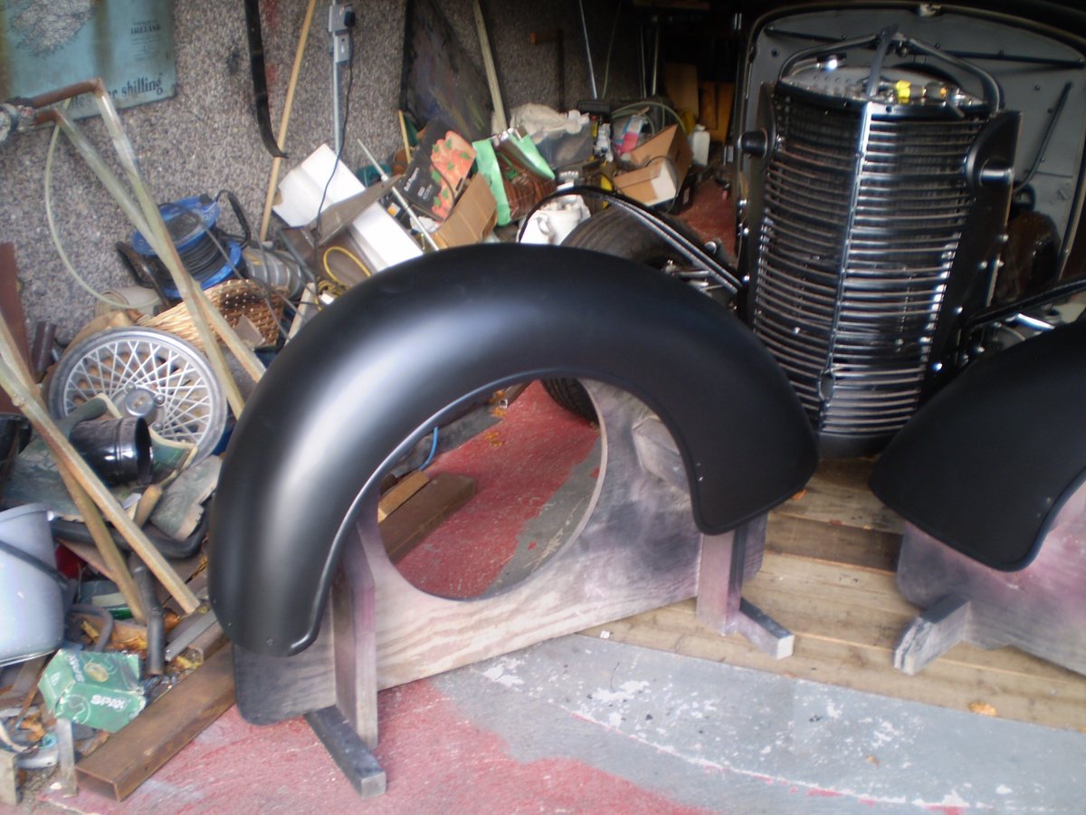

    started bringing the paintwork home today Guinness was for medicinal purposes only fenders home in blackrear 001.JPG fenders home in blackrear 002.JPG fenders home in blackrear 003.JPG

    Those fender stands are cool and very functional! Can you post a picture of them without the fenders on them??? Good progress!

    glad you like them ill try to get that done in the morning for you..ive found them a great help with welding and especially with the filling.i could be sure they held their shape during alterations,saved the back as well..we had them on a bench for a while to work on the arkward bits.

    as promised..i used 3/4 plywood and 4x2 rough.screwed things together with 2 1/2 inch n0 10 chipboard screws,a drop of glue helps too.overall 36in high x 48 long x14in wide.try to keep the plywood in the centreto keep it balanced..i rounded the bottom corners so I could lift 1 end and move it along without the corners dragging in and tearing the corners of the ply.they have been used for 8 weeks and are holding up well.next they will be repurposed to hold a set of 34 ford wings I cut the hole out of the centre to get the dolly through to the other side of the stand. fender stands bare 002.JPG fender stands bare 003.JPG

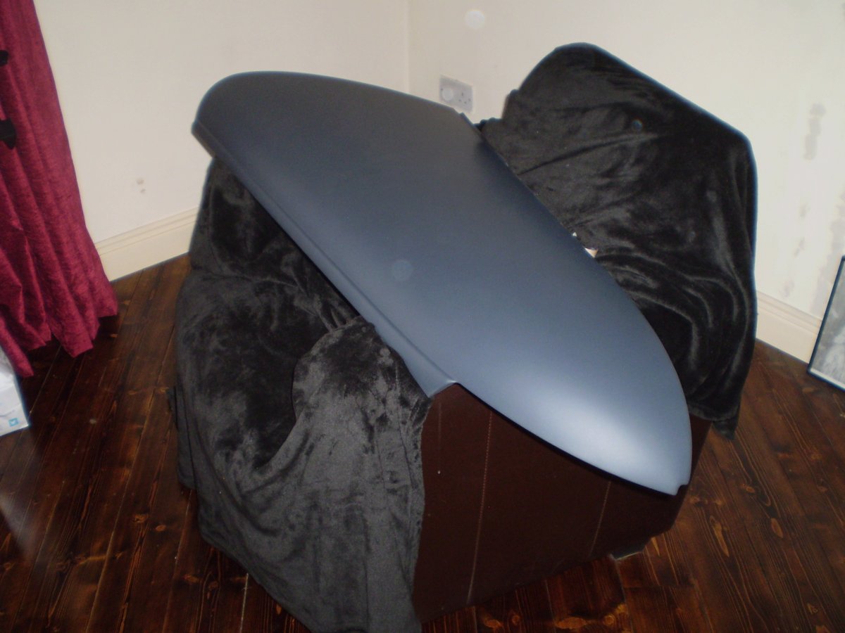

    etched hood sides 003.JPG etched hood sides 004.JPG the hood is the last big thing left to paint.its been too cold to stay sanding for too long at the one time.been coming and going at it.warmed up today I finished the sanding on the first hood side.there was 80 years of surface rust and dirt on there .took quite a while to sand it all offthe louvers and the linkage slows it down.so finished sanding it today and coated it with etch primer to stop it rusting.it looks much better now and I can see it needs a little bit of tweaking as well.theres a good bit of sanding left to do on the other one and another large can of etch primer needed

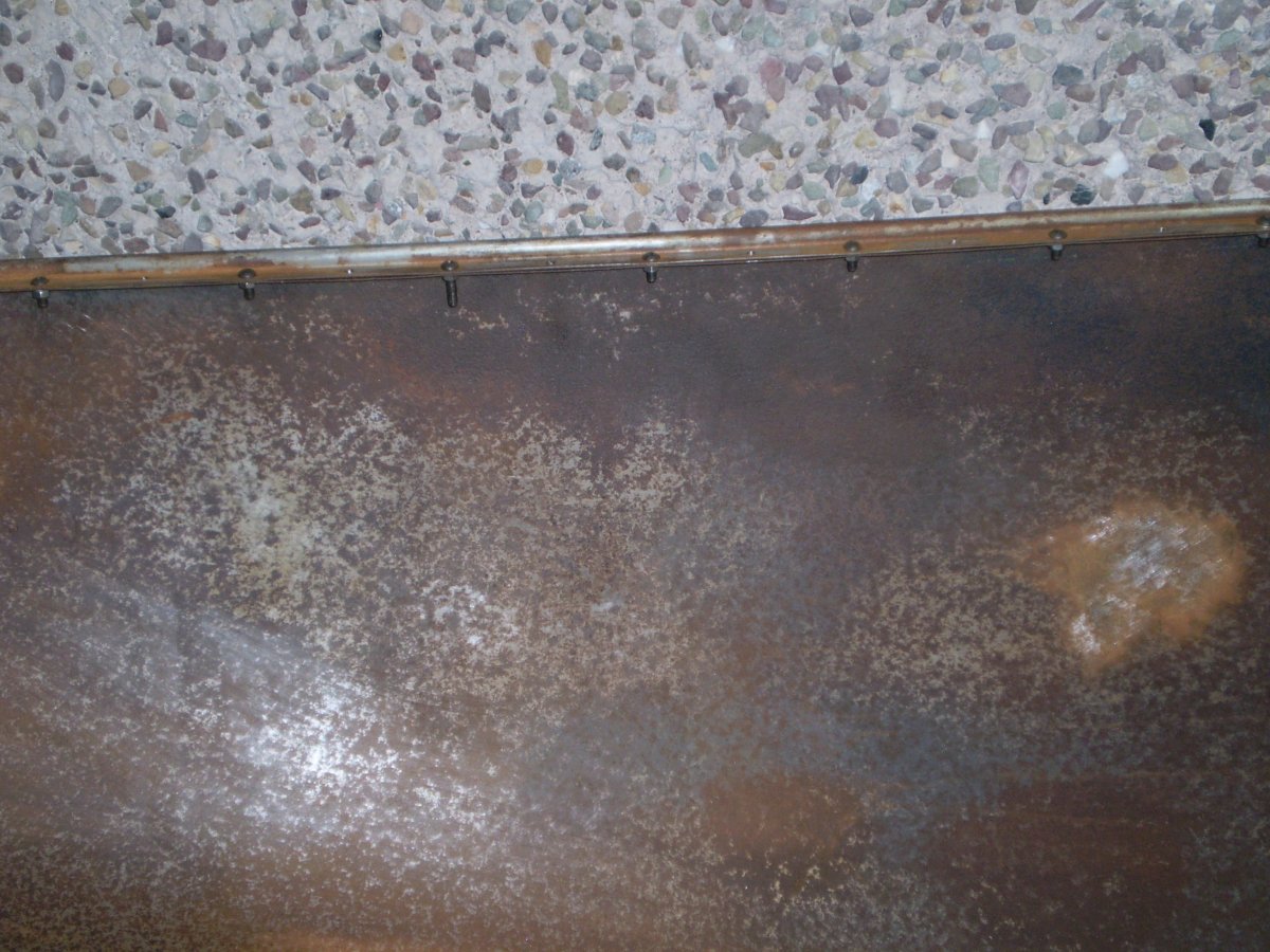

    hood top2in por 001.JPG coated underside of second hood top with por 15.dont ever want to see that surface rust again

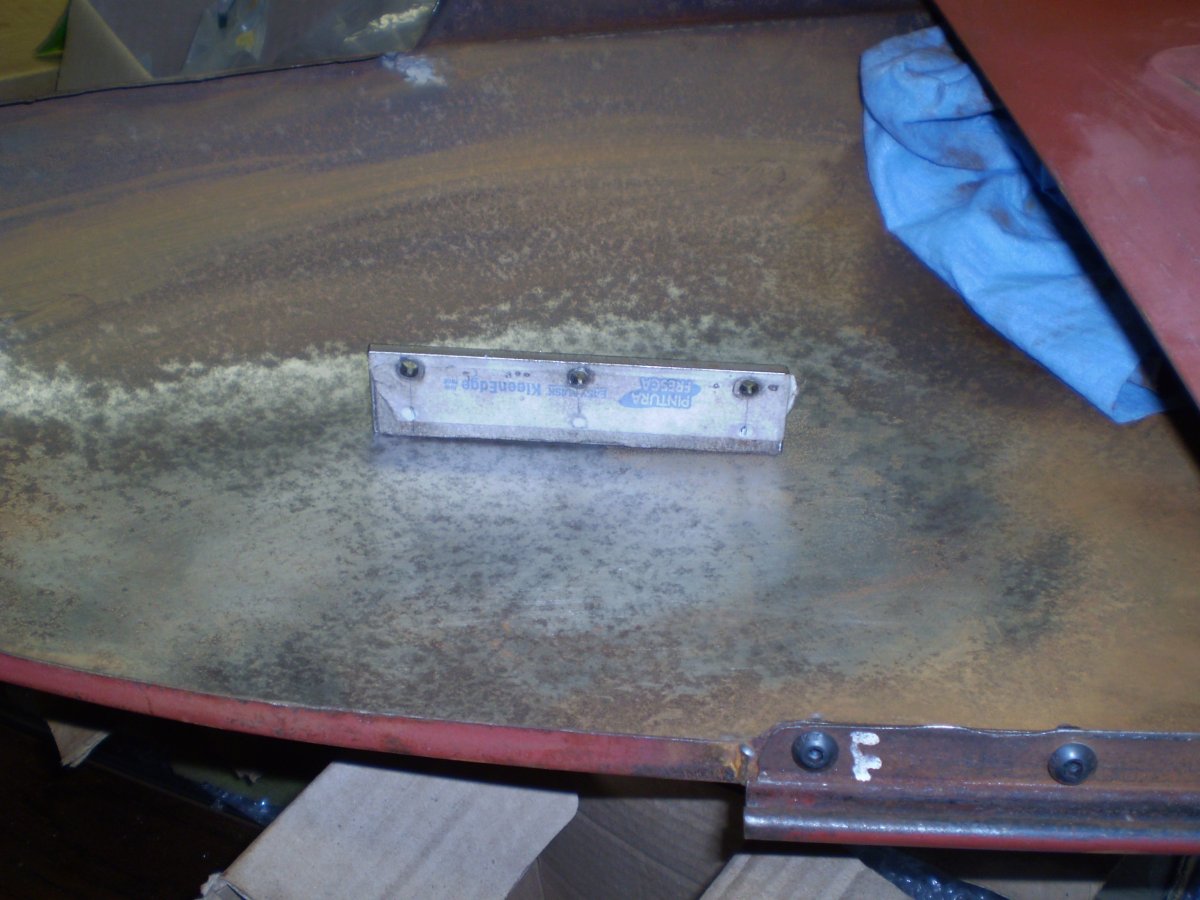

    sun came out it warmed up a bit.rubbed down the underside of hood half 1 and etch primed it.the other should get there tomorrow.primed the hood hinge halfs too hood inside etched 007.JPG
