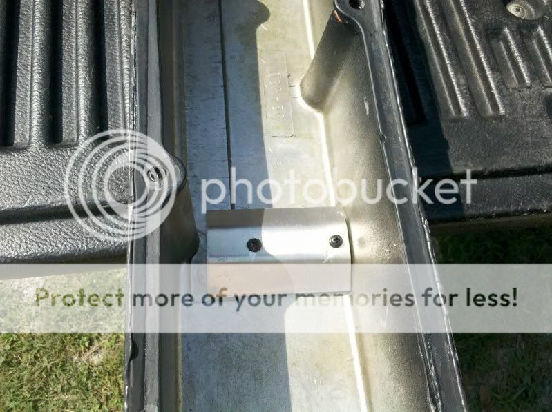

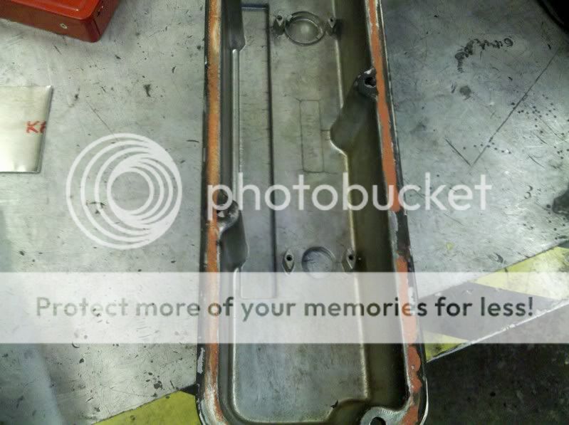

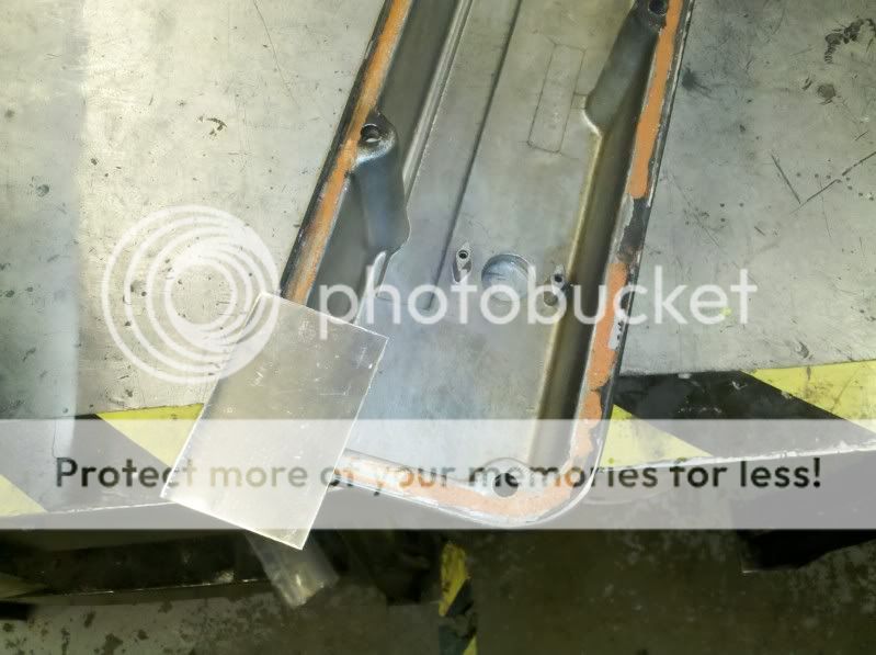

    so heres what I did for my oil issue. I did a bunch of googling, because I was stumped, and I put a thread up here. I was using a quart of oil in 80 miles, but I didnt see it rolling smoke, or a big leak. So I was stumped, so then I got reading about people buying used tall valve covers and running them without baffels. So enough jabbering and heres some pics.
    I figured id make them on my lunch break, if I can do sheetmetal work on an air plane it shouldnt be anything to make a few bends in some aluminum and throw them in. I tapped the post that you see in the first pic. Then I drilled my holes, put some bends in them and lock tight'd the screws. They work, so its back to daily driver status.

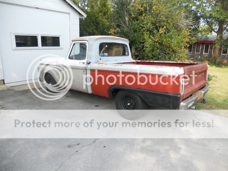

    well this is an up to date build. The next thing will be work on some wiring and start the search for either a g body or jag front clip. Maybe ill pull the cluster out and re do the gauges soonish though.

    Go figure. Nothing like the little things most people don't run into to give you a case of the "WTF"'s. Good catch. I'm sure a few of us will keep this in mind.

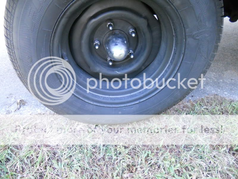

    I also finnaly found some 8 inch wide steel wheels that match the front. So now its rocking some 255/60/15s out back with some 205/65/15s up front. It dropped it down another inch or so by doing that.
  19. shocker998md
    Joined: May 17, 2009
    Posts: 878
    shocker998md
    PICS!!!!!!
    Heres the 8 inch wide wheels
    I put smaller tires on the front, and the truck sits a little bit lower.

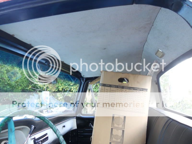

    Heres a picture of the headliner. I bought a 500 dollar parts truck that will be donating alot of its parts.

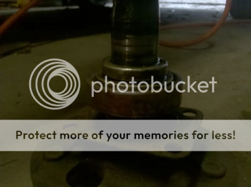

    While I was home the big project was redoing the brakes. It got new drums, shoes, and wheel cylinders. All new rubber hoses and a new master.
    The back right axle seal looked like it was leaking so we went in to replace it. What we found I did not like at all, along with alot of other stuff.
    Starting off with the rear brakes, someone had some 68-72ish drums and backing plates, which isnt a bad thing because they are bigger. Well the shoes where not the big ones, so the drums where all kinds of messed up. Lucky for me I robbed the backing plates off a parts truck and put new brakes on out back. All of the adjuster hardware was missing too. But heres the worst part, someone replaced the right rear wheel bearing, and put a new seal in. But didnt remove the old one, so there where two axle seals in it, the axle was never seated into the center section all the way, and I put 18,000 miles on it this year. Drove from NC to FL, NC to PA, and back and forth to MD alot. I did some pretty good burnouts, a few stop light to stop light runs and luckly nothing came apart.
  24. shocker998md
    Posts: 878
    shocker998md
    the one seal is on the bearing, the other was still in the tube!

    Damn, I've never seen two seals jammed in there before. Looks like someone had a major case of the Dumb ***. The fact that the bearing lasted that long gives meaning to "Built Ford Tough" and I'm glad you caught it before things got worse. Those 8 inch wheels look pretty good on there. Are you going to lower the truck any?
