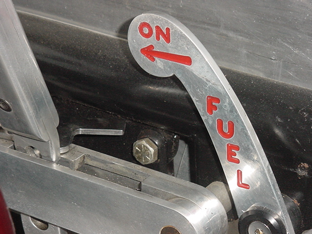

    Thanks Rich, I totally agree about Hot Rodding being about making parts - I've been making parts since I started - I'd like to think I've learned a bit with each one. My dragster was one of the most fun projects because I made so many of the pieces parts - some more obvious than others. Here's the rear end fill cap I made in stainless.
    And here's the shifter and fuel lever - putting in the letters was fun!

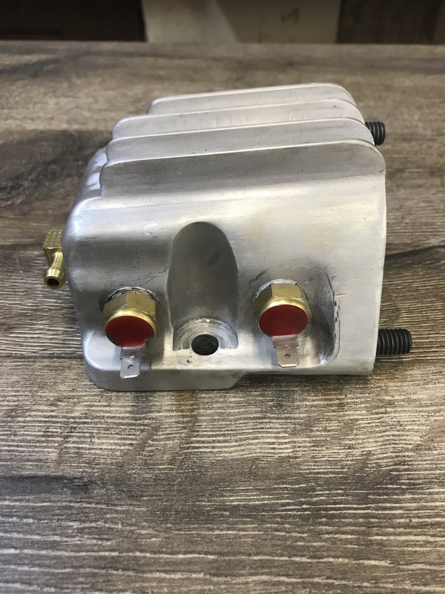

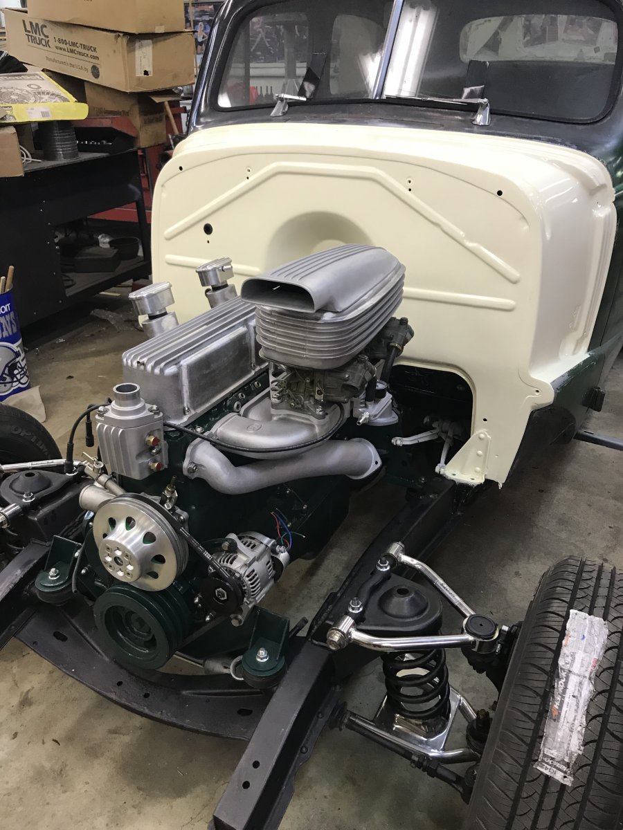

    Couple of things I learned making 'cast' finned aluminum.
    Use a tapered end mill (2 or 3 degrees) to simulate the draft.
    Radius the end of the flutes.
    Round the end of the fins with a router round over bit. I put it in a collet on the Bridgeport.
    I didn't like the thermostat housing on my 292 Chevy 6. Wrong angle, wrong holes in the wrong places. Just plain ugly cast iron.
    This was a 4" cube of aluminum:
    With the sheet metal on, hardly anyone will ever notice, but I know:D
