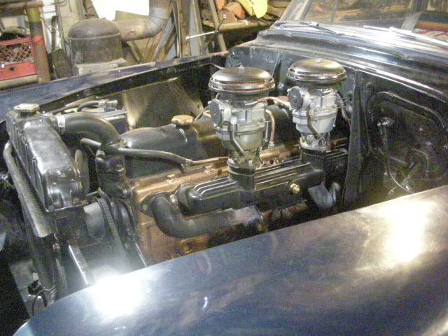

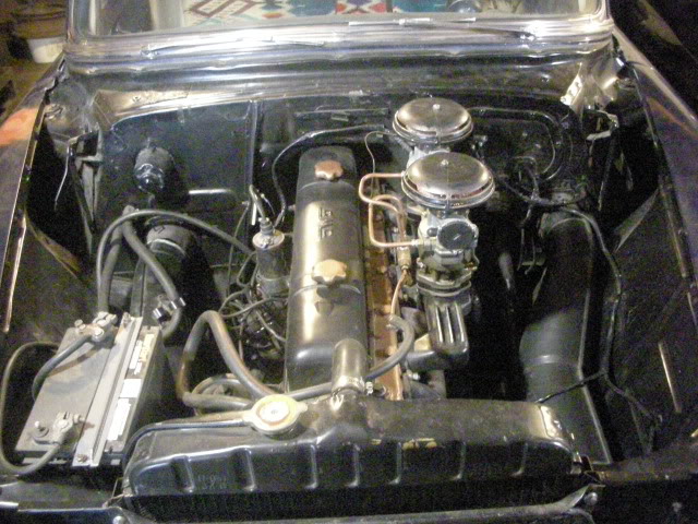

    Happier days. The fire was caused because a brake drum got hot and started the tire on fire

    Interesting that the carbs melted but the intake didn't?
  7. Sorry to see that. I agree, take it all apart and clean and check things, the basic engine should be OK. Might have some warping on the intake or other alum parts like distributor.
    Inked Monkey, the carbs are zinc and melt at a lower temp than aluminum.
