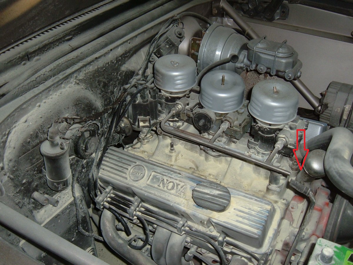

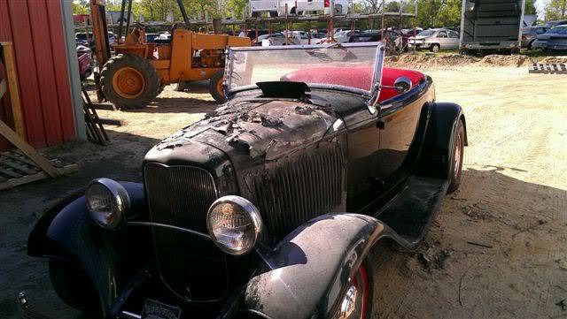

    just a reminder to check your old fuel lines. and to keep 2 fire extinguishers handy. fuel line broke sprayed the coil . first extinguisher did not work . the sec one did . nova motor 001.JPG looks like i will find out how good chrome ins is

    >>>just a reminder to check your old fuel lines>>>
    I don't see any rubber lines in the picture. Did a pressure-side metal line fail? Jack E/NJ
  7. My guess is that this is the culprit
    Automotive Stud and Bandit Billy like this.

    Yep. I can see that little rubber ****** now that you pointed it out. Jack E/NJ

    yes [ but it is just a short piece of hose said the dumb##]

    Yep, no barb or flare on the stainless fuel line going to the carbs. A little pressure, a little vibration and little heat and the hoses will work themselves off. I bubble flare all line ends when joining to rubber to give the clamp something to back up against.

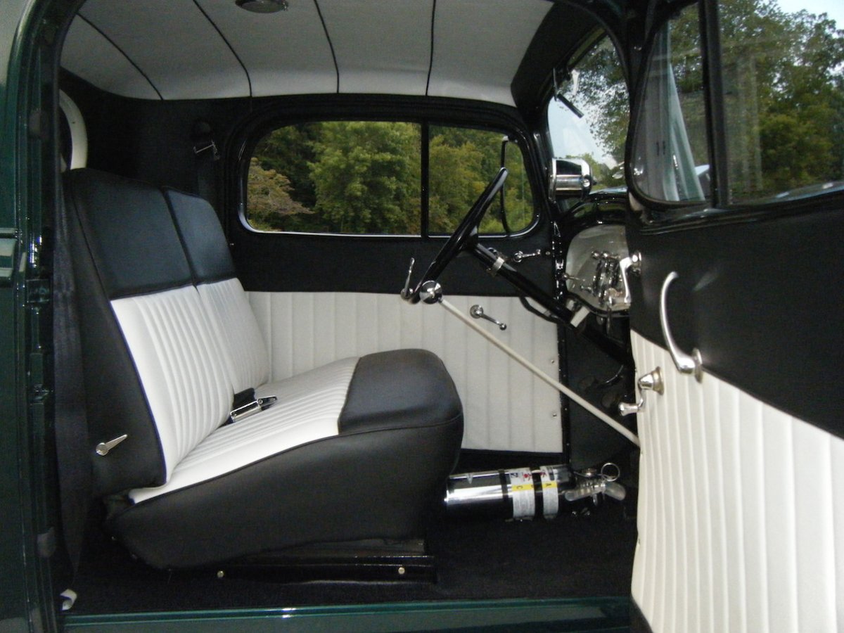

    Wait, there's more. If you mount the extinguisher in the trunk and the battery that you put back there is the source you may be screwed. I like them where I can get to them fast on the way out of the car. Since I have suicide doors it made most sense to mount it on the column and I have practiced opening the door, flipping the bracket, and grabbing the extinguisher on my way out.
    Not a great picture but you get the idea, you can see the handle hanging down from a chrome (of course) halon extinguisher. I am sorry for the OP's mess and I am glad he put it out before serious **** happened but these are good opportunities to take inventory of your own safety and emergency methods.
