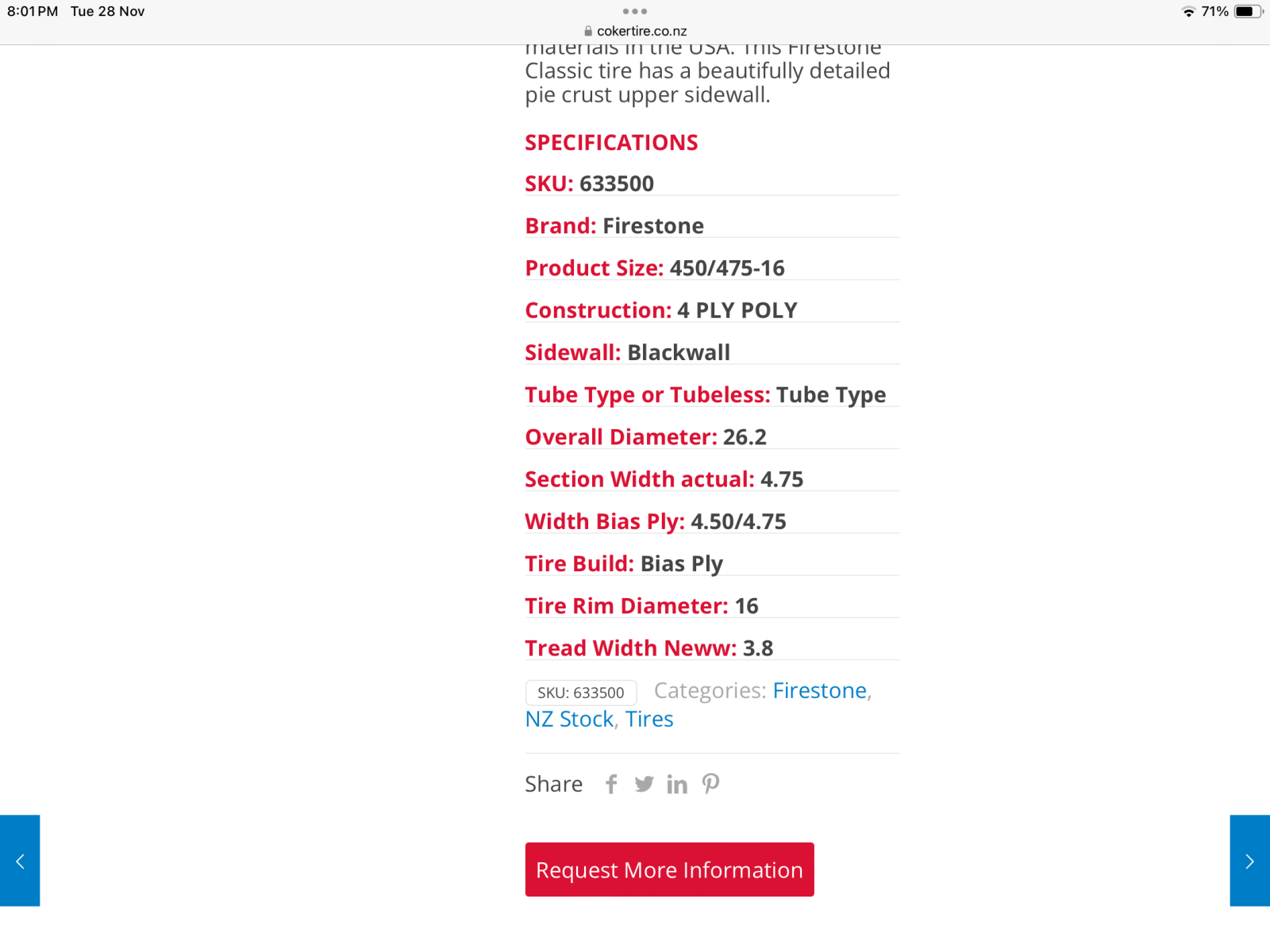

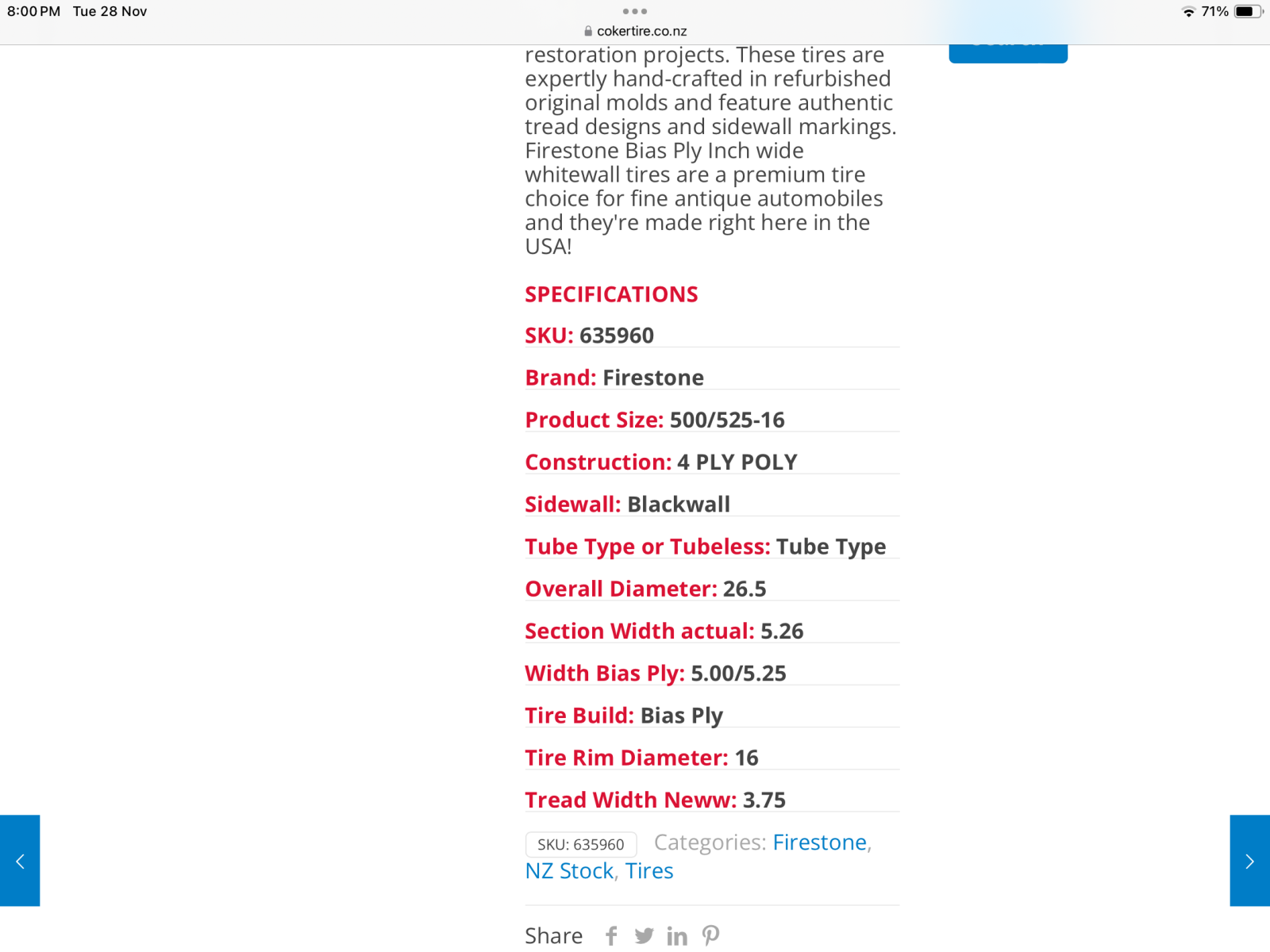

    Not to highjack this thread, but does anyone know why the 450/475’s are about 1/4” taller than the 500/525’s?

  17. clem
    Joined: Dec 20, 2006
    Posts: 4,712
    clem
    according to Coker charts, it is 0.3 inch smaller………..
