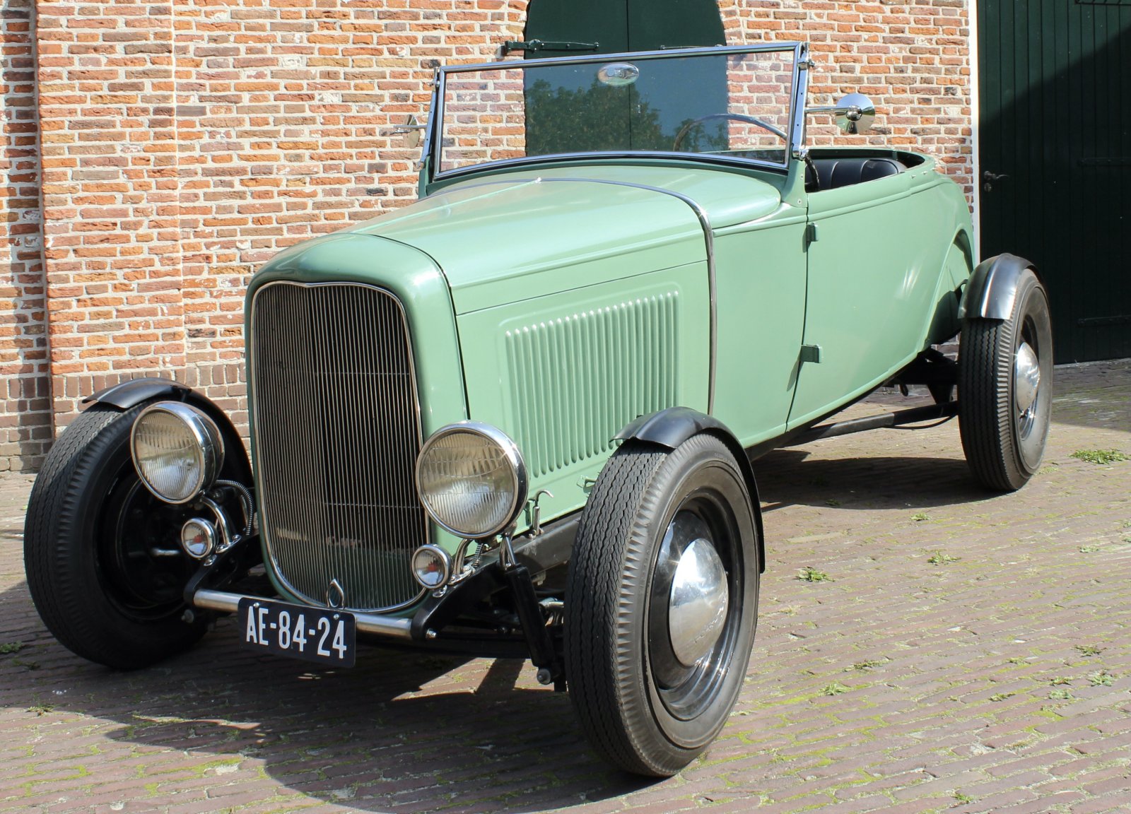

    On my fenderles av8 roadster i have 500/525 x 16 front and 750 x16 rear firestone deluxe champion bias ply tires.
    I had some bounce/ shake in the front a 50 to 55 mph.
    Everything is tight and balanced.
    When playing with tire pressure i found that the lower i go the more shake i got.
    I am now at 32 psi and the shaking is much better.
    I like to inflate a bit more but factory days max 32 psi.
    Will i get in trouble when go higher ? I dont want to risk a blown tire at highway speed.
    Annyone drive them with higher pressure at highway speed ?
