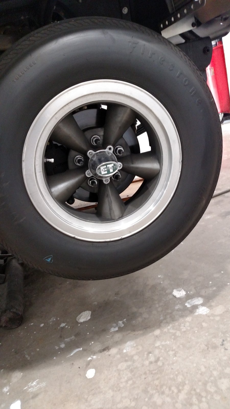

    1. Maryland HAMBers
    IMG_20190726_155413011.jpg 7.75 -15 Firestone. No tubes. No leaks. Had 'em a few years.
    guthriesmith, MO_JUNK and D.Conrad like this.

    OP - Are '40 wheels designed for tubeless tires?

    Yours says "Tubeless".

    Uh, yes, I am aware of that. Please ignore the brake rotor..
