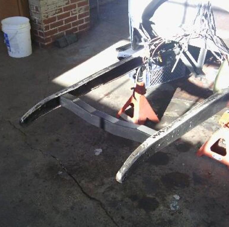

  17. Mark Jenny
    Joined: Oct 23, 2014
    Posts: 821
    Mark Jenny
    This is as far as I have gotten on the front 1421532872884_IMG_20150117_151042_175.jpg
