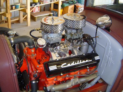

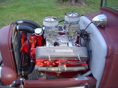

    so how did they fit this motor in this 30 coupe?...caddy or chevy...distributer in the back!! cad mtr.jpg hamb mtr.jpg
  22. mike bowling
    Joined: Jan 1, 2013
    Posts: 3,559
    mike bowling
    same car-Caddy covers are" El Fake-o"- and look at the front crossmember-looks like the radiator got pushed forward ( and it's got a mag which is a smaller diameter).Tight squeeze in an "A" no matter how you put an 8 cyl. in.Give a little, take a little! It is a Caddy-ERROR! Pay attention, Mike!

    I'm gonna go with a stock chevy distributer which is much smaller than the upgrade distributer I now have..I will probably run a coil and give it that "old School " look...when I put on the tri-power, I'm gonna add the oil filler back into the manifold...and run closed valve covers with external breathers...that will help with the look as well...
    But I already welded my xmember into a stock position, so I will probably still have to modify the firewall

  26. nickk
    Joined: Feb 2, 2011
    Posts: 754
    nickk
    That there my friend is definitely a caddy motor, everything matches up, heads, intake, water pump, dizzy, front motor mounts. itd have to be a extremely good cover up

    Yea..agreed its a caddy..but I was saying that caddy or chevy, they both sport a distributor in the back of the block, unlike ford thats in the front...my question is how they squeezed a motor like that in that coupe without cutting into the firewall

    Gotcha, and Im not sure unless they lengthened the frame, check out boling brothers, they have some good examples of tight fits. and y blocks are big too!

    I suspect they moved the front xmember forward. No radiator support rods and the extra space between radiator and fan looks like more than you could expect in a Model A with any V8.
