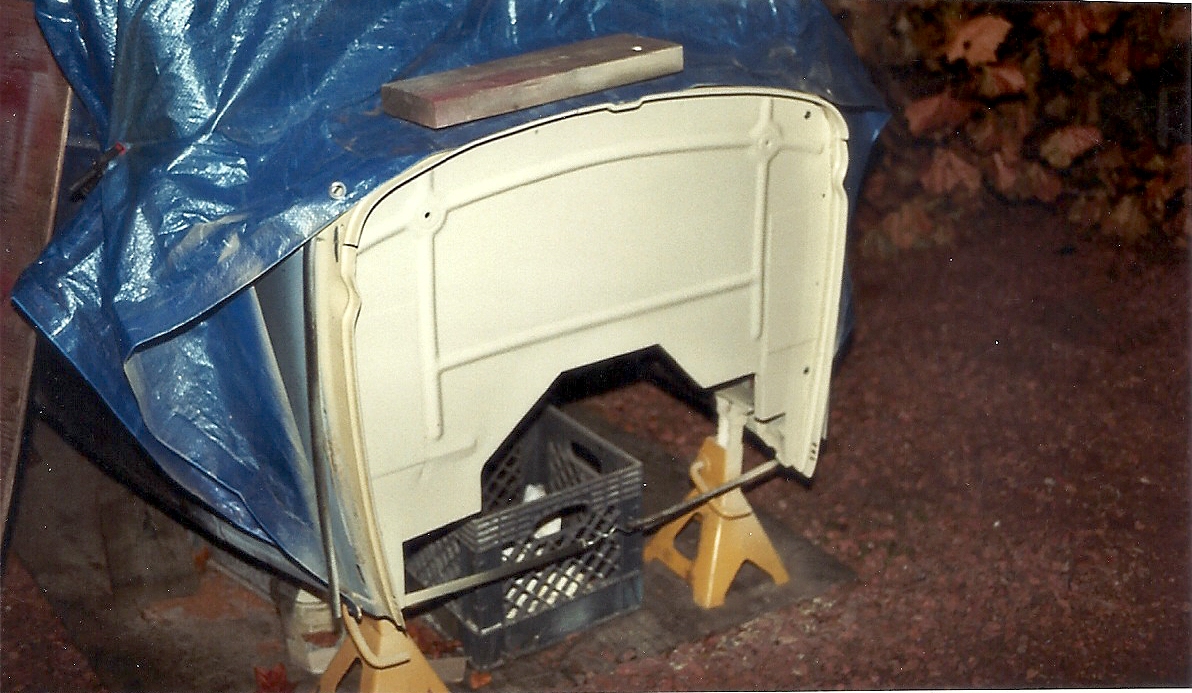

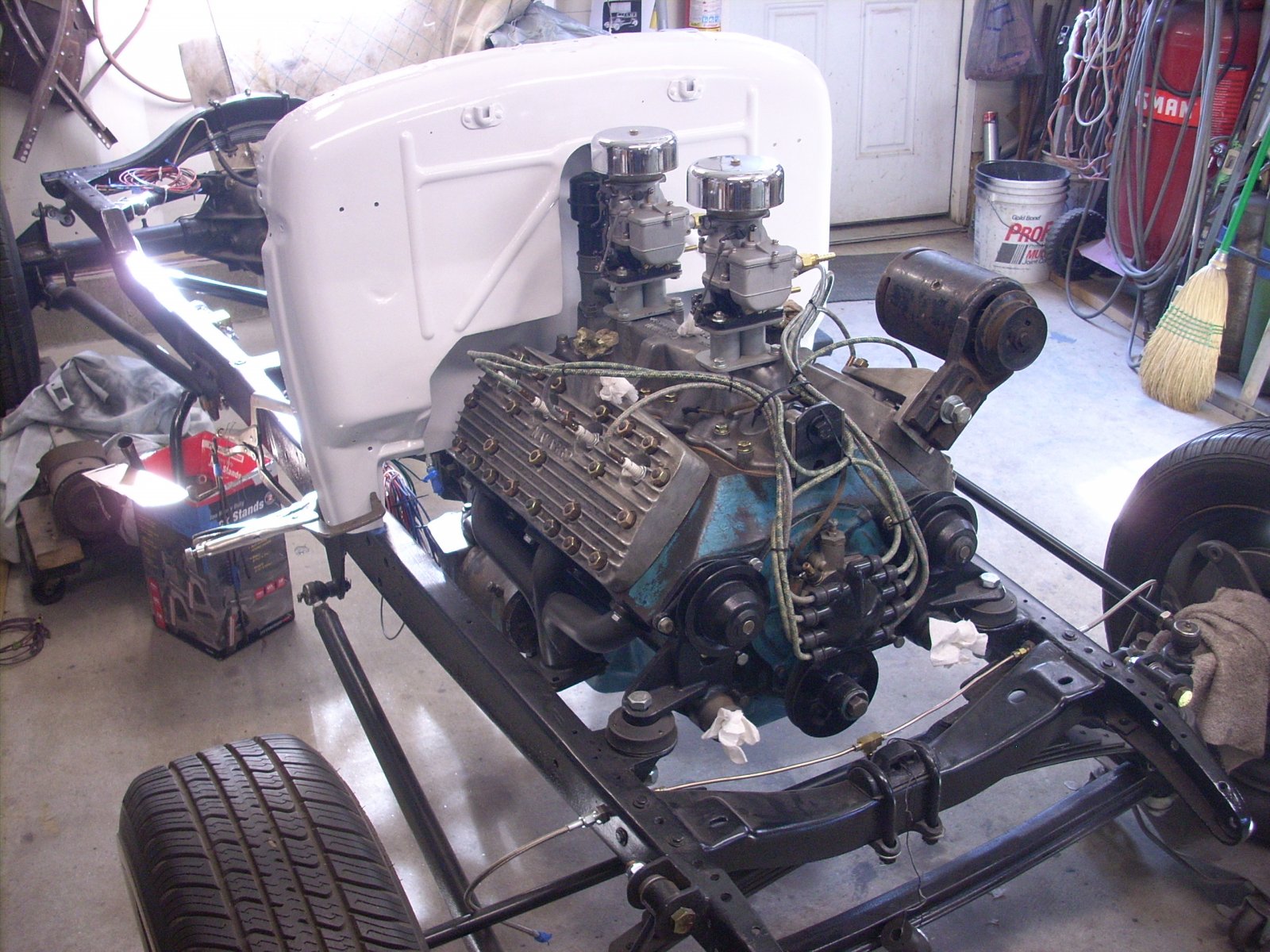

    DSC02287.JPG It sounds like you've settled on a '32, but I'll throw in one more reversed stocker pic just in case. It gains a lot of engine room and we did not cut any section out of it to re-weld in. The only part we cut out was around the bellhousing, and a little t******* for pedals and column.

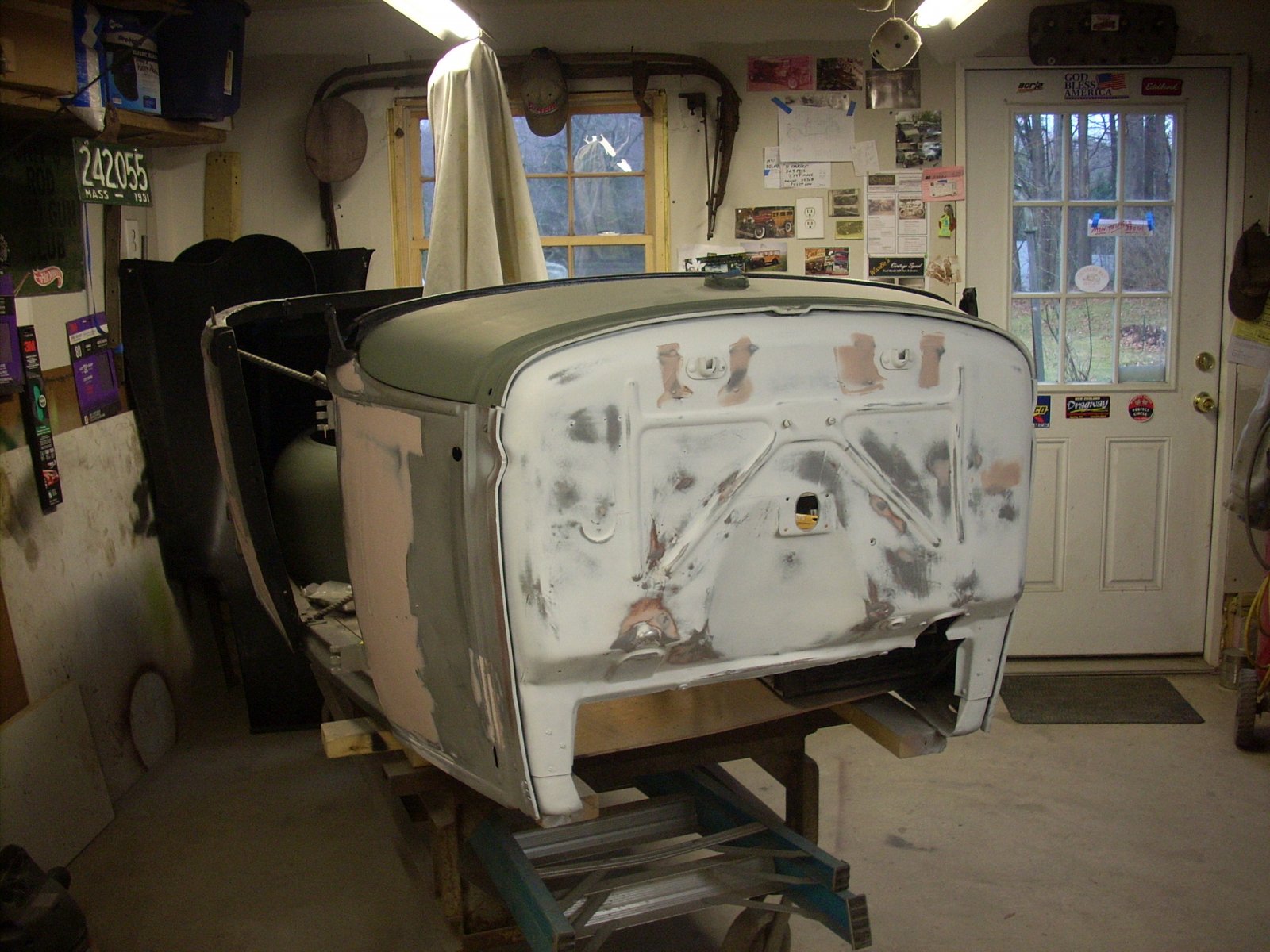

    Ok..gonna get this tread goin again...we have cut out the butchered firewall from my 31 coupe and I'm ready to get back at putting in another firewall. Heres the debate in my head...go with the 32 which I will post pics of, or get a stock 31 and reverse /flip it....any and all suggestions welcome ...heres the car with no firewall... 31 coupe 018.JPG 31 coupe 019.JPG 31 coupe 018.JPG 31 coupe 020.JPG 31 coupe 021.JPG

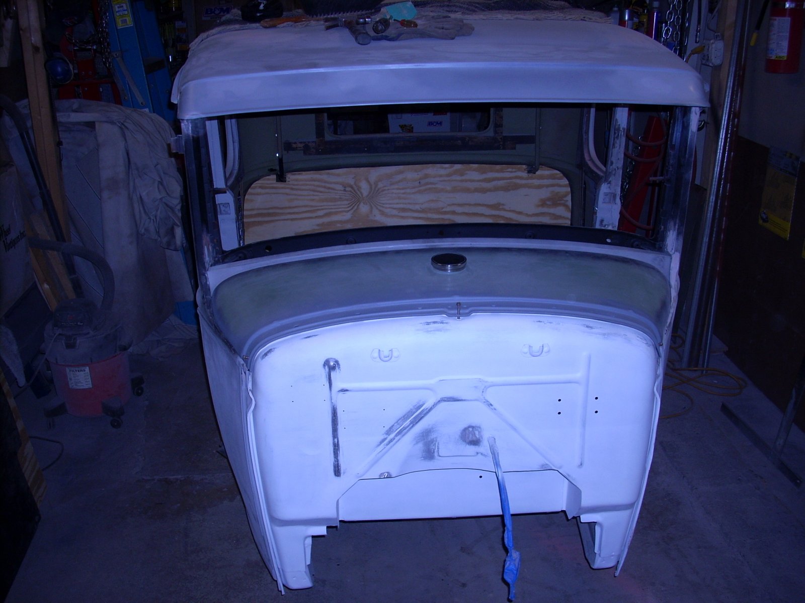

    guess i'm leaning toward the stock firewall flipped....not sure I want to cut on the cowl to fit the 32 firewall

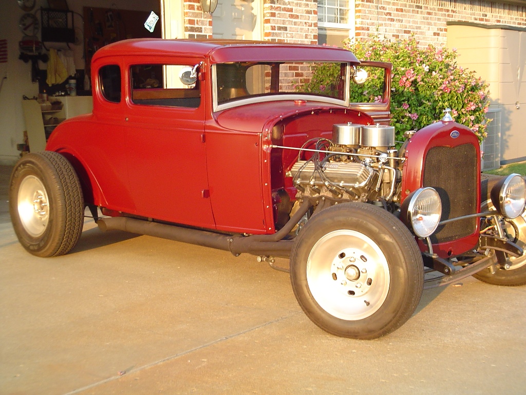

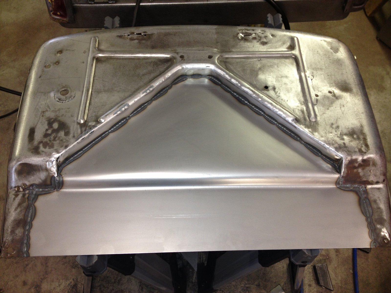

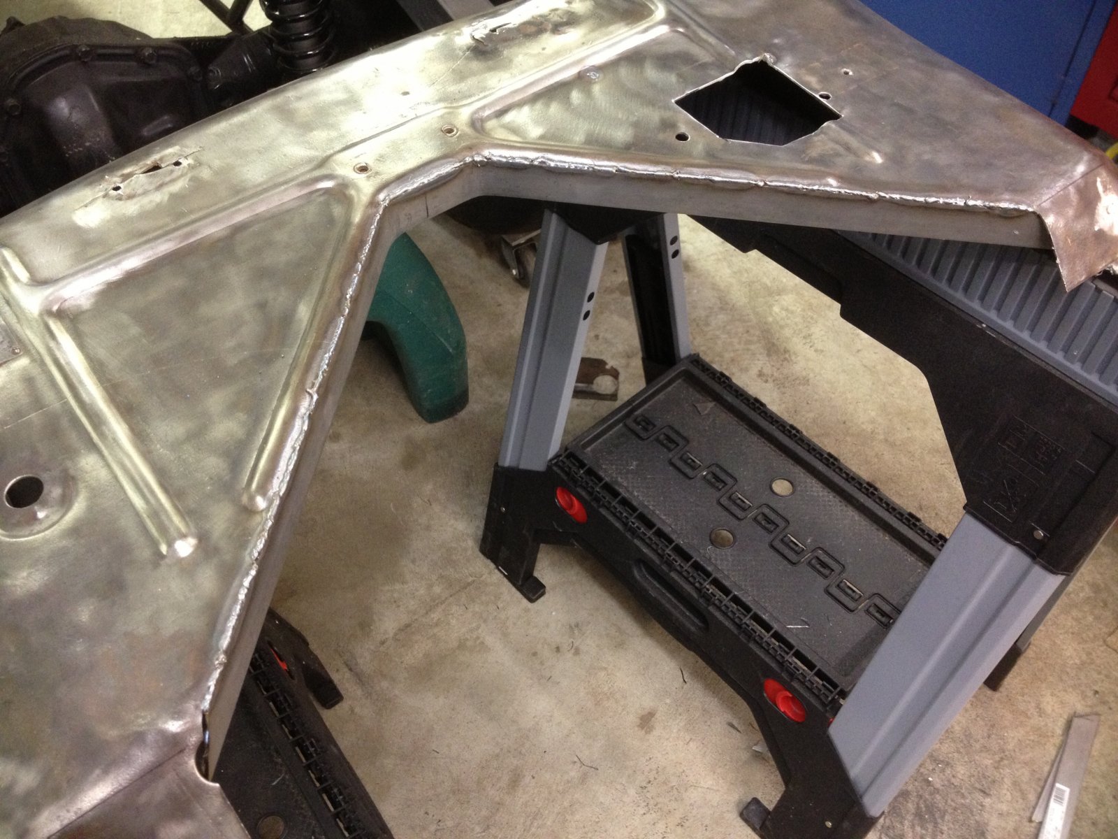

    I've read about flipping stock "A" firewalls around a million times, but still don't understand how that works. Stock, it goes down fairly straight then goes IN at the bottom. Reversing it would make it go OUT at the bottom, no??? I've actually taken them out, flipped them and decided it was easier to go with a recess. That red coupe looks great; no interference with the ******? ( and yes , I like white)

    I used an old differential cover in a stock model A firewall.

    You should be able to get a stock firewall at a swap meet for 50 to 75 bucks in real good shape. Then only take out what you have to so it will work. Most anything's better than that mess you started with! ( and you got rid of the "bowl of spaghetti" wiring too- good move).Do it right once so you can drive the wheels off it after. Good luck with it.

    That turned out cool..looks like my distributor should fit in that relief

    I believe a previous post said a wheel barrel firewall looked like a wheel barrel shoved in the firewall. A wheel barrel worked pretty good for me. I did have to widen it a bit to go around the 330 Hemi in my A coupe. fw5.jpg IMG_3330.jpg

    I just needed a little bit to clear my distributor so I did something similar and made a 1" setback just under the beaded peak. I really like the rounded look of the original and I felt that flipping it or using and aftermarket one with a huge setback section would have really taken away from that area.
