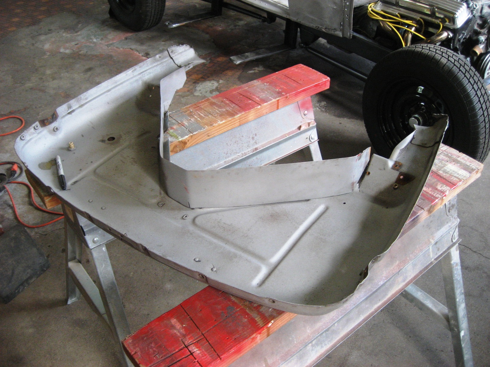

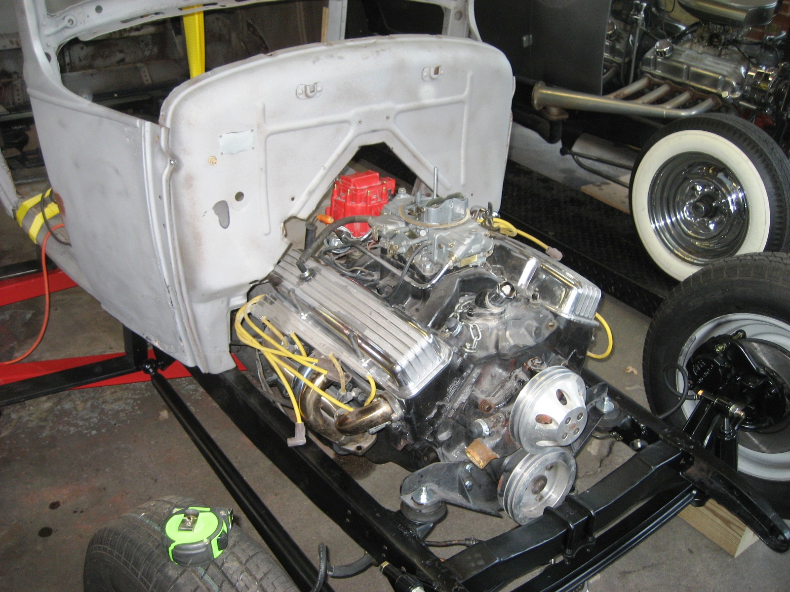

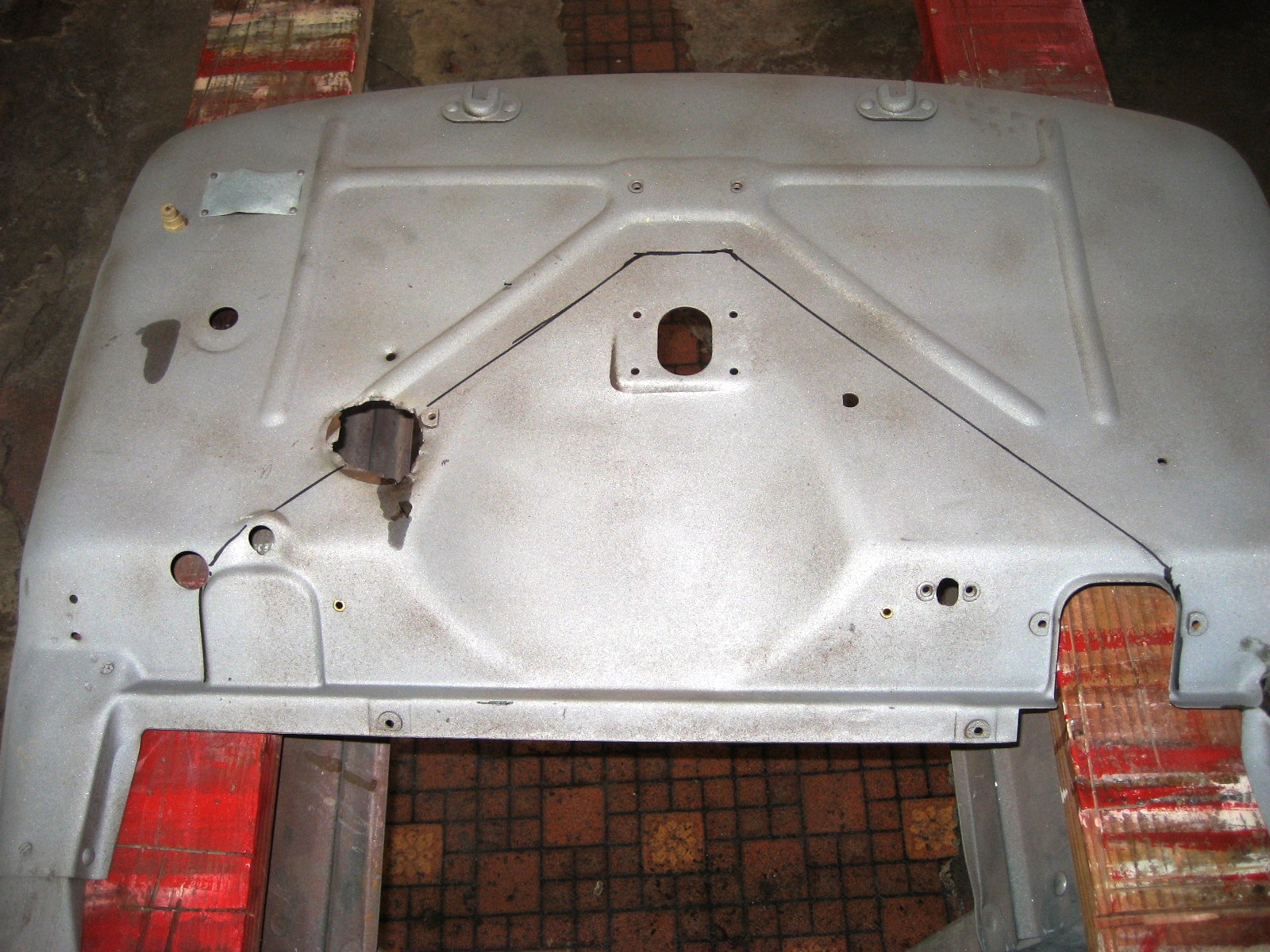

    Well after the back n forth fence sitting about what firewall to use on my 31..I finally made the decision to stick with a stock firewall rather than the 32 I had, an aftermarket, or flipping a stocker. So after a trading my 32 to a fellow HAMBER for a very nice 30/31, and after getting all the body parts blasted, we are on the road to completing all the body work. first starting with the firewall modifications. Heres the progress pics so far..still need to finish, but we have a good start on the cut out and the 4" deep relief band...
