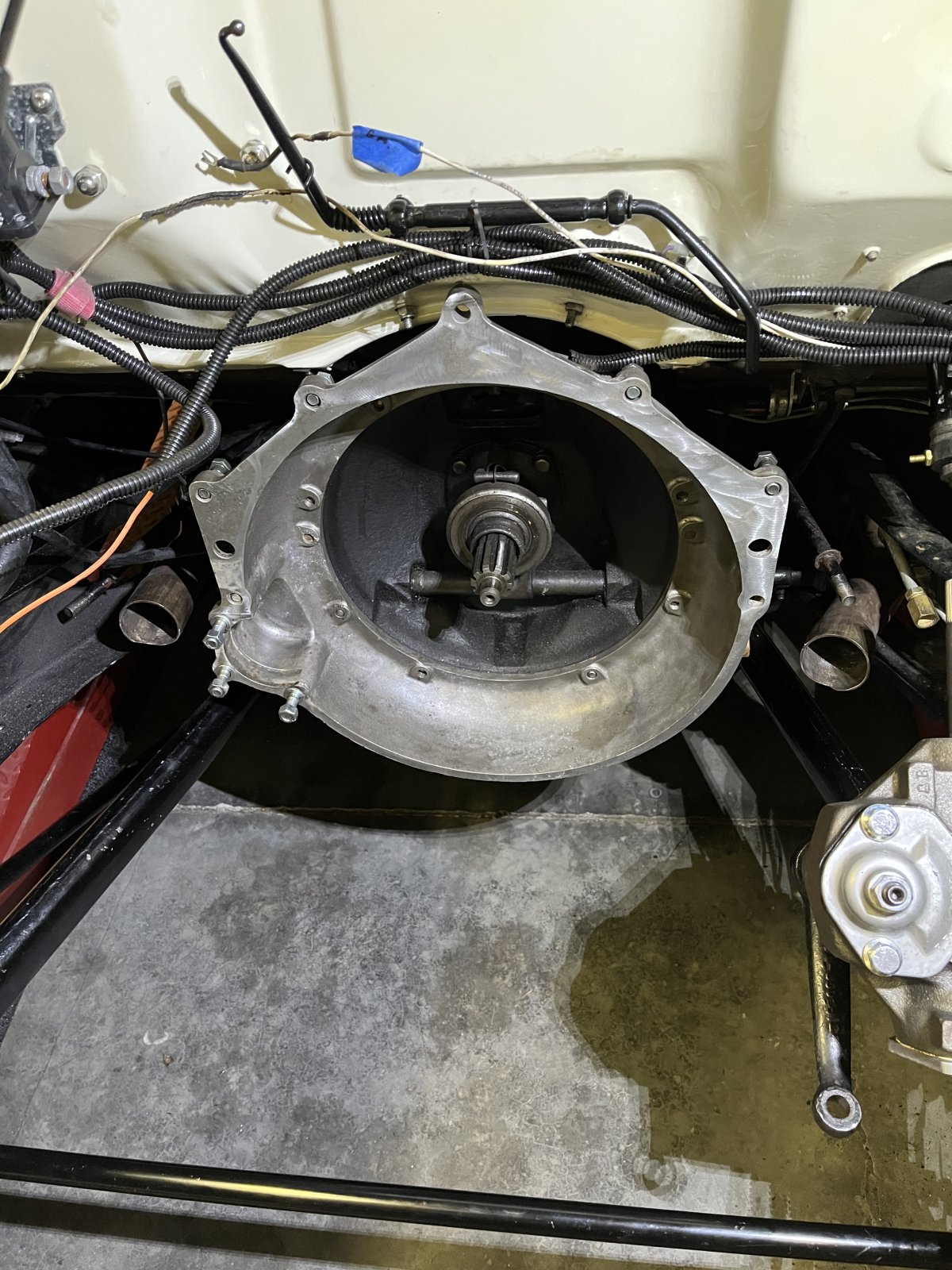

    J.Ukrop submitted a new blog post:
    Firewall Management

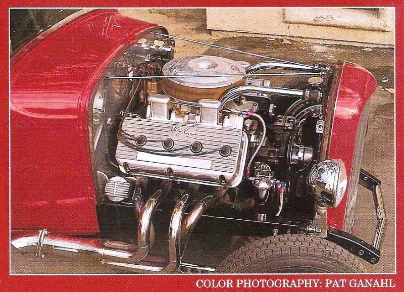

    If you are thinking firewall with a Model A roadster, you need to look up articles on Bill Neuman's roadster. He was editor of Rod & Custom back in the early 60's. That is the firewall to copy.

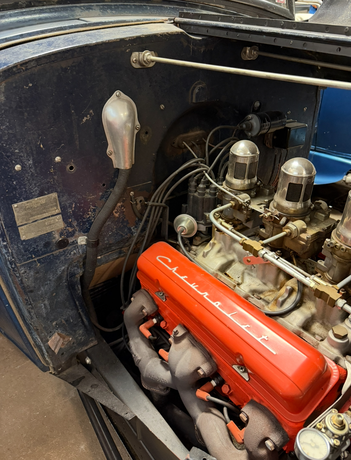

    Joey, just changed mine up. After 10 yrs. of a red firewall, I more or less copied the interior color. Also being old and sometimes lazy, I chose the dark gray hammered look. Not quite traditional, but I’m enjoying the look. Hope All is Good with you, Carp. IMG_4805.jpeg

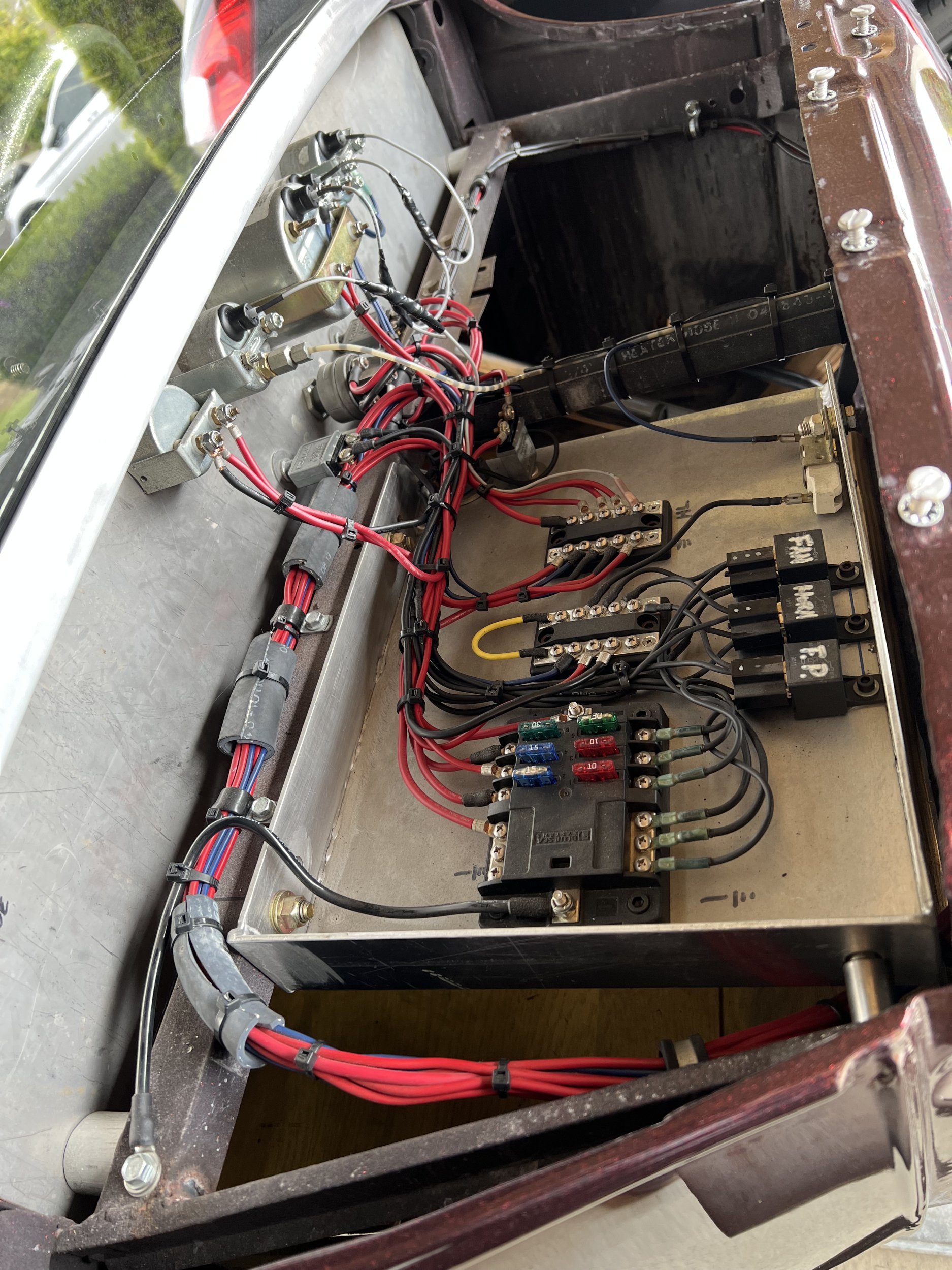

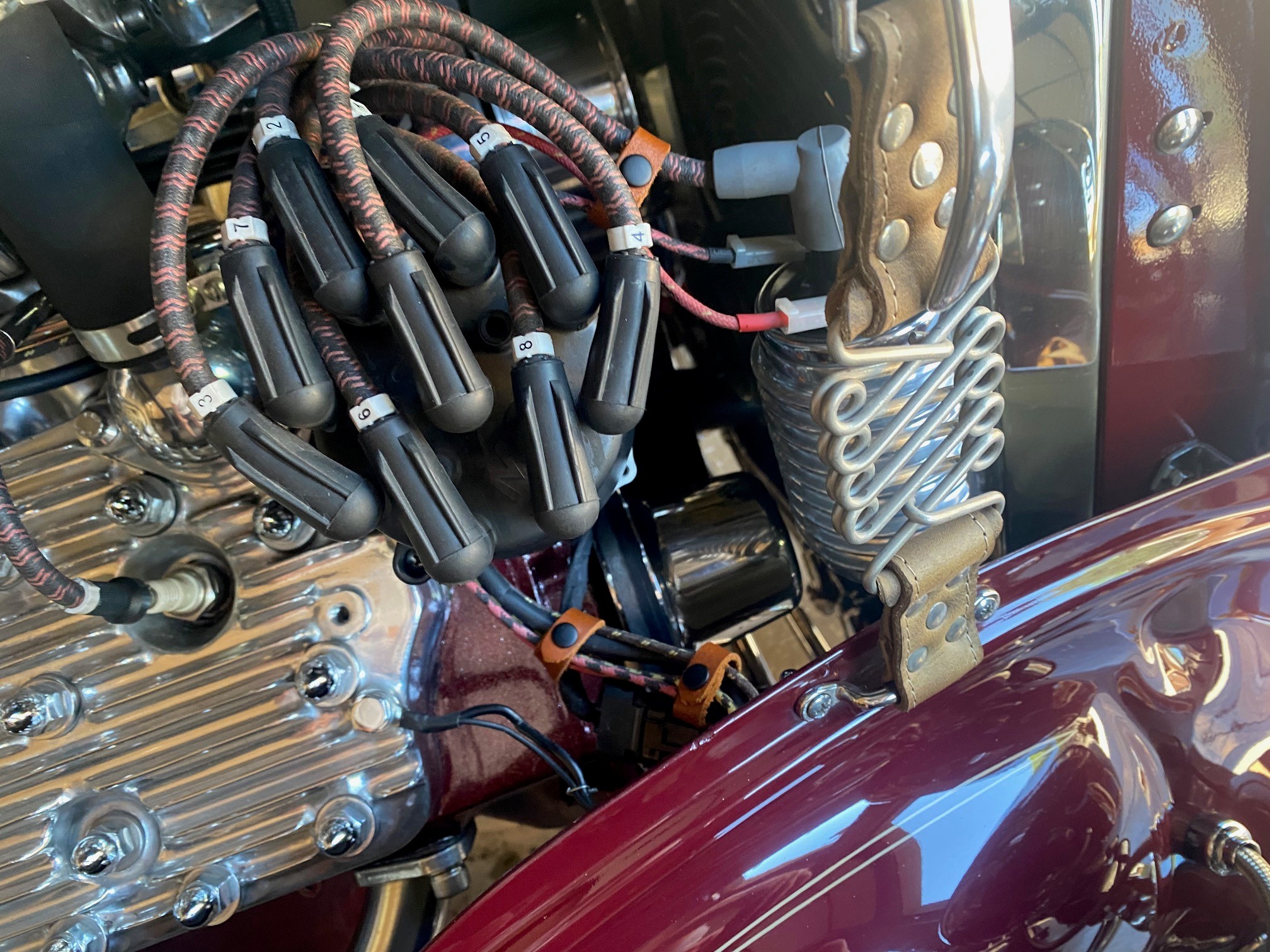

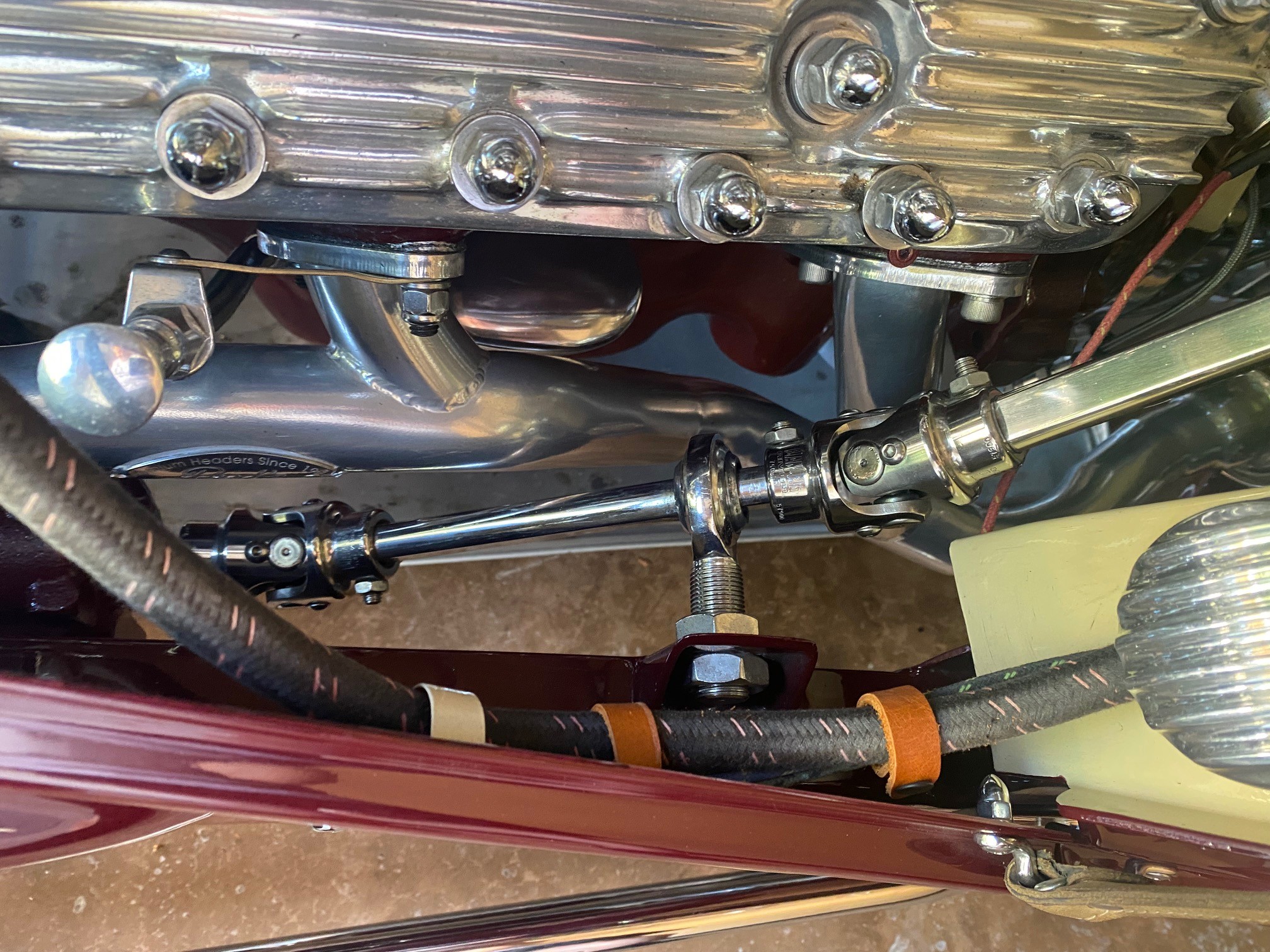

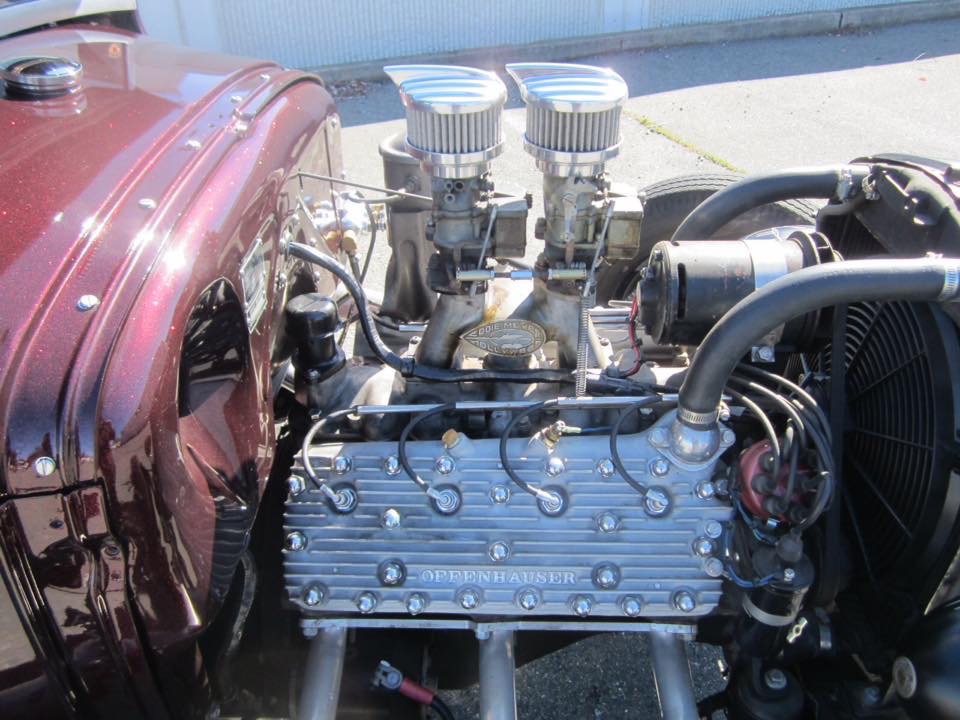

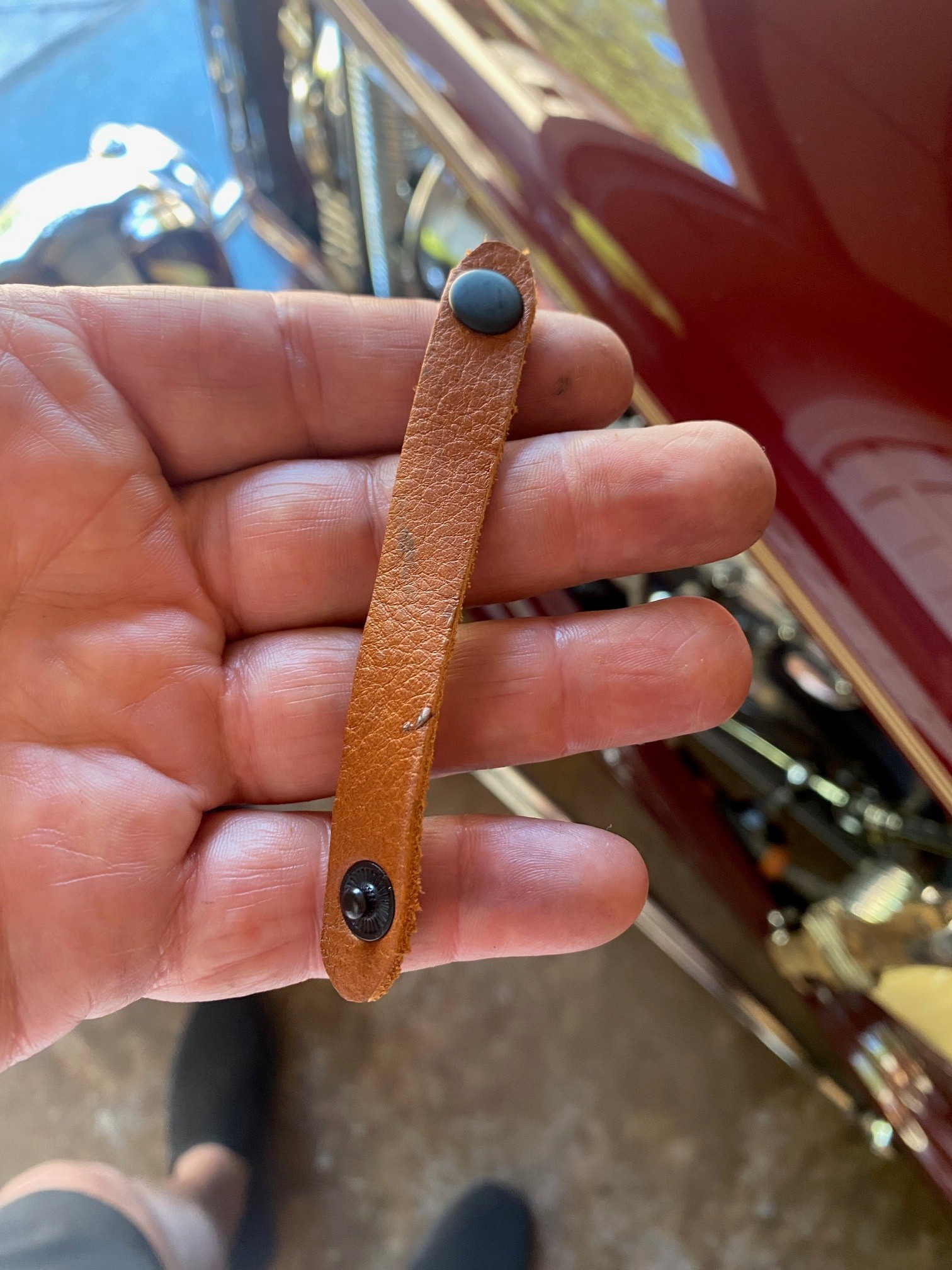

    Yep, I fit that description :cool: A place for everything and everything in its place. On my roadster I welded straps to the inner fenders on both sides to secure my harness behind the body bead line, driver's side is the lights, signals, horn, etc. The other side is the coil, gauges, engine stuff. I used fabric covered wires that are matched to my color-coded fuse panel diagram for ease of service, wire4.jpg
    and they are bundled by these little leather straps with snaps that my daughter made for me. wire1.jpg
    I didn't have to, but I like things neat and orderly...and preferably no wire ties. And plastic covered wires with laser printing on them, while helpful when wiring and repairing, don't look that nice IMO.
    It's a bit **** but I build cars to my liking, and I like them neat and shiny.

    @Bandit Billy I love how you have yours done. Nothing super over done just nice. You go nuts on the polishing and a few other things but it just makes me think of old hotrods that were built after the war and you can tell that guy worked in the air force and it all spilled over to the hot rod.
    I think you have a good amount of restraint with your clever solutions and don’t breach the line of ****ing up a car that’s been finished.
    I see that now and then when a guy just needs to build another hot rod but instead just keeps adding needless **** to the one he’s got.

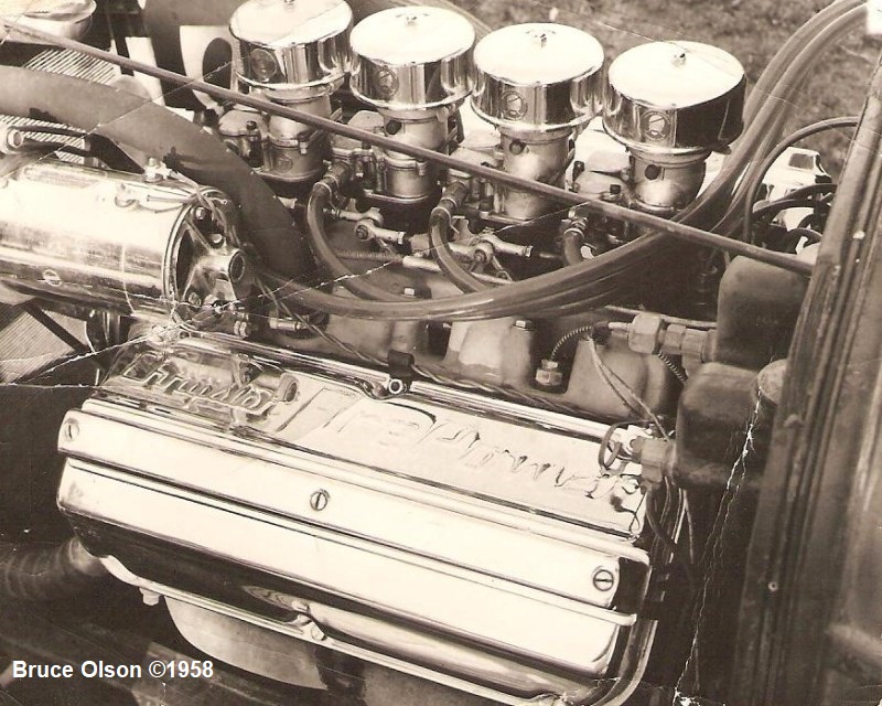

    Here's our '32 5wd Coupe circa 1958 . . . when it had a 1953 Chrysler HEMI (331ci) engine with four (4) Stromberg 97 carburetors and a Cad/LaSalle transmission . . . hence the MOON fuel block and the brake & clutch master cylinders mounted on the firewall:

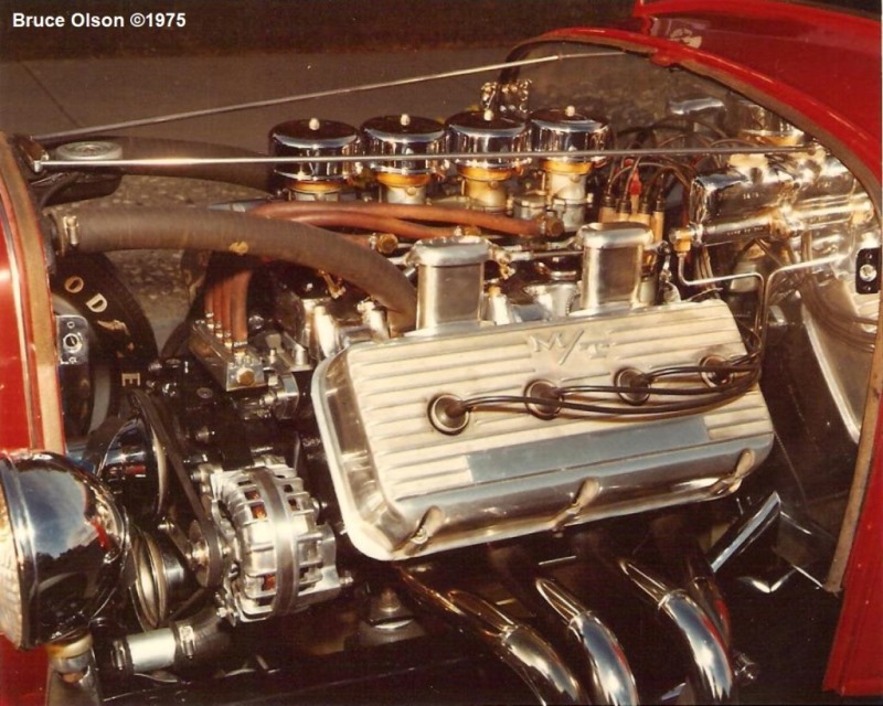

    . . . the firewall stayed that way until 1975 . . . when my father & I installed a 1958 Chrysler HEMI (392ci) engine, 1969 Dodge HEMI (manual shifted) torque-flite transmission, Volkswagen Bus steering unit, and a new polished aluminum firewall:

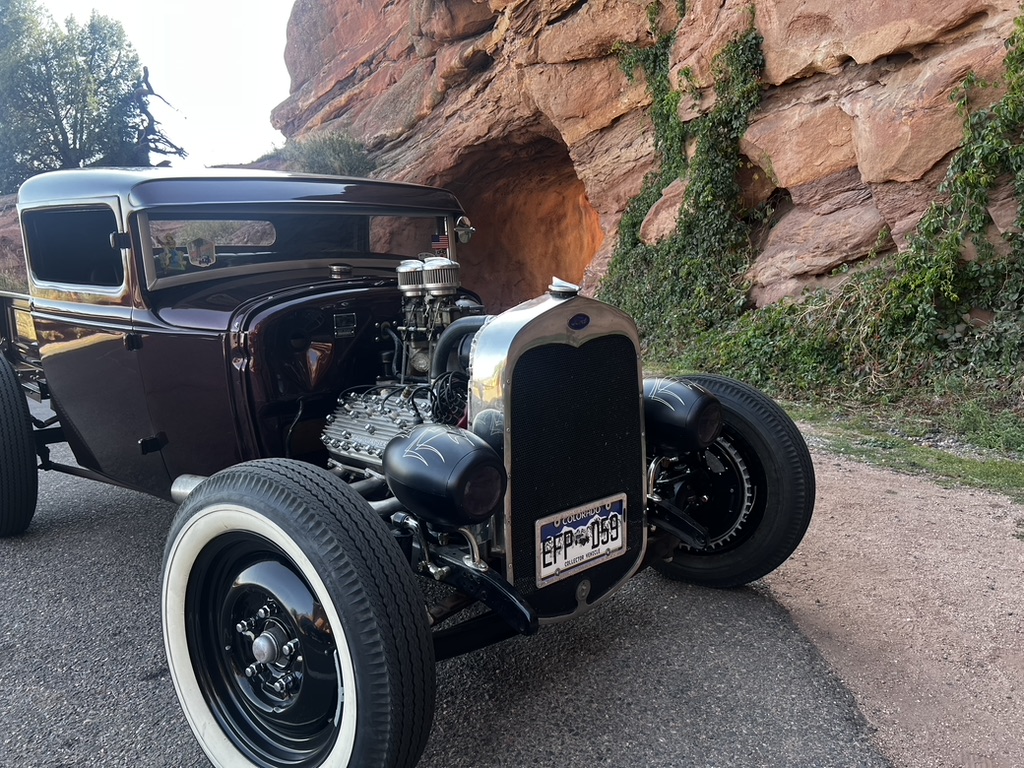

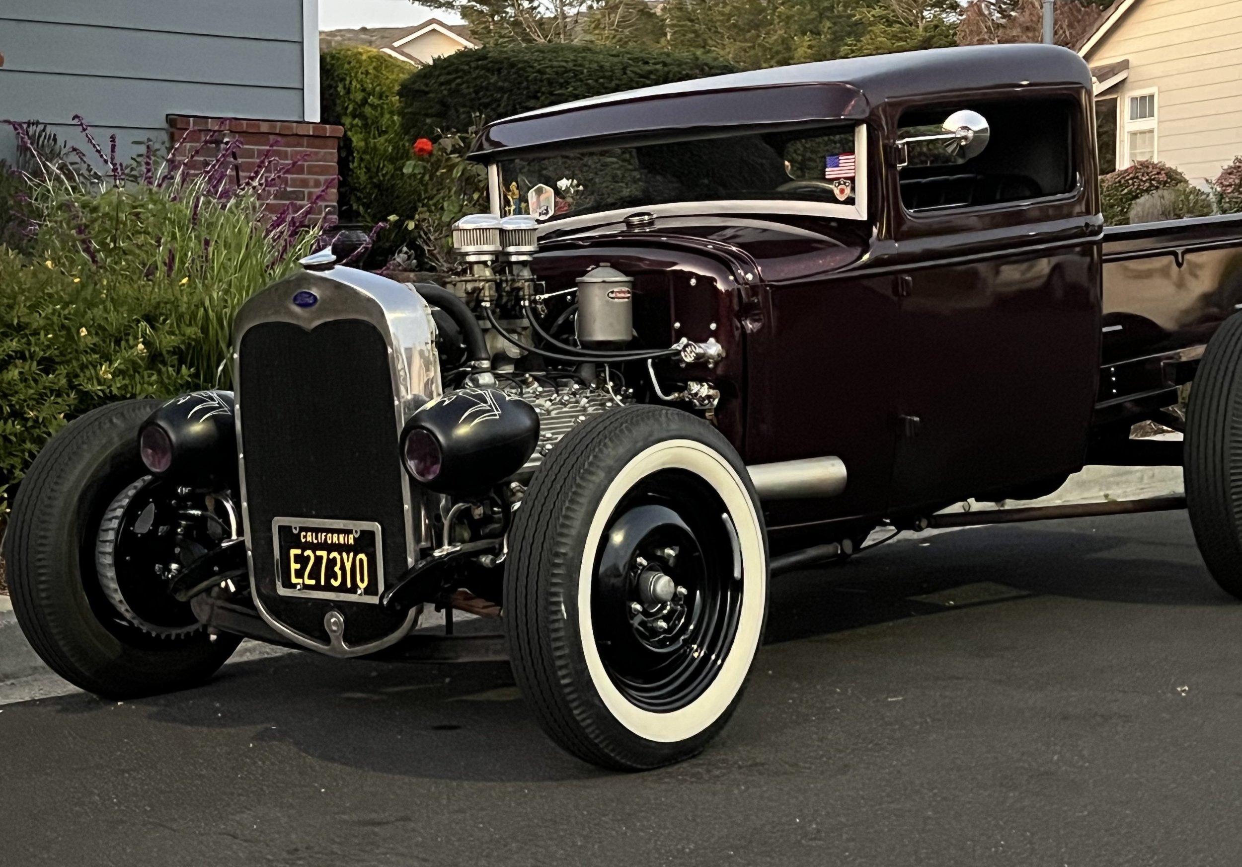

    I like that truck . How much was it chopped ? I see all three hinges still on the door . I like that .
    Im building one now but with a Hemi . Plan is a small chop and channeled

  23. It is chopped 6 and channeled 5. I am short dude and it is cramped, but I still drive it around to buy dog food and drop stuff off at the post office.

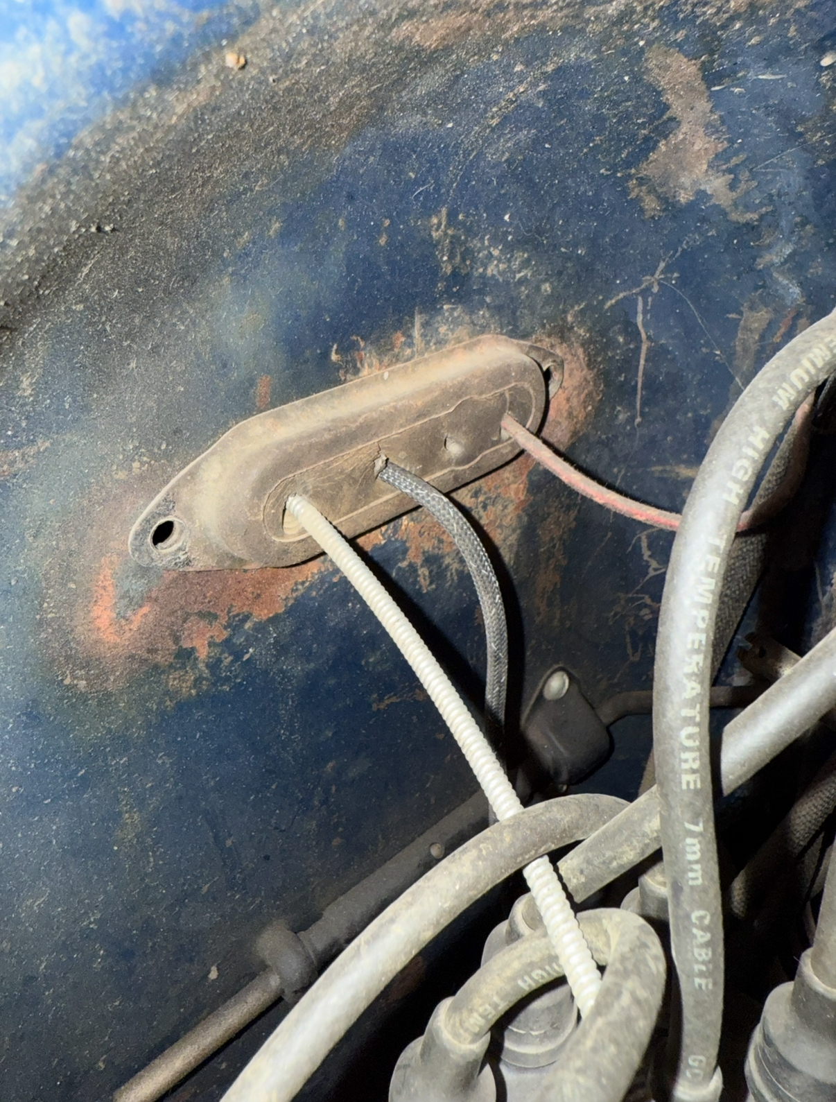

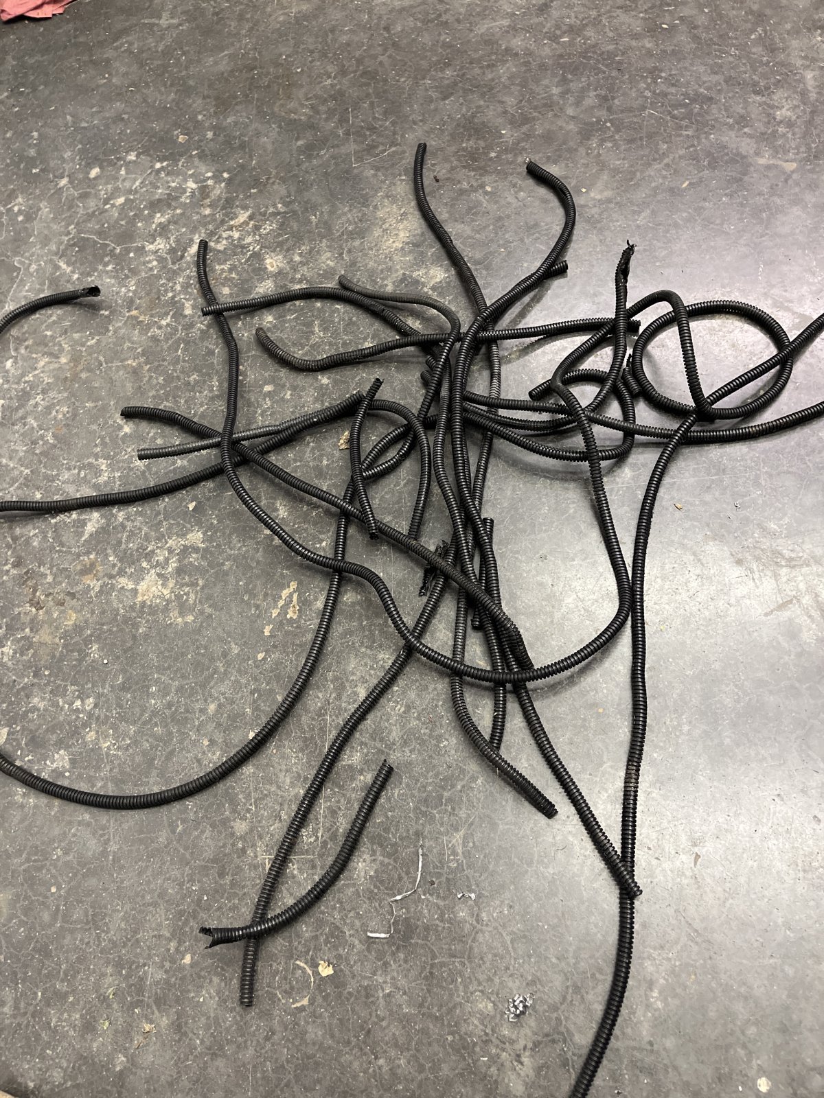

    When I swapped out the blown up flathead in my 40, I was faced with this mess in the engine compartment.
    Each wire had its own plastic loom.

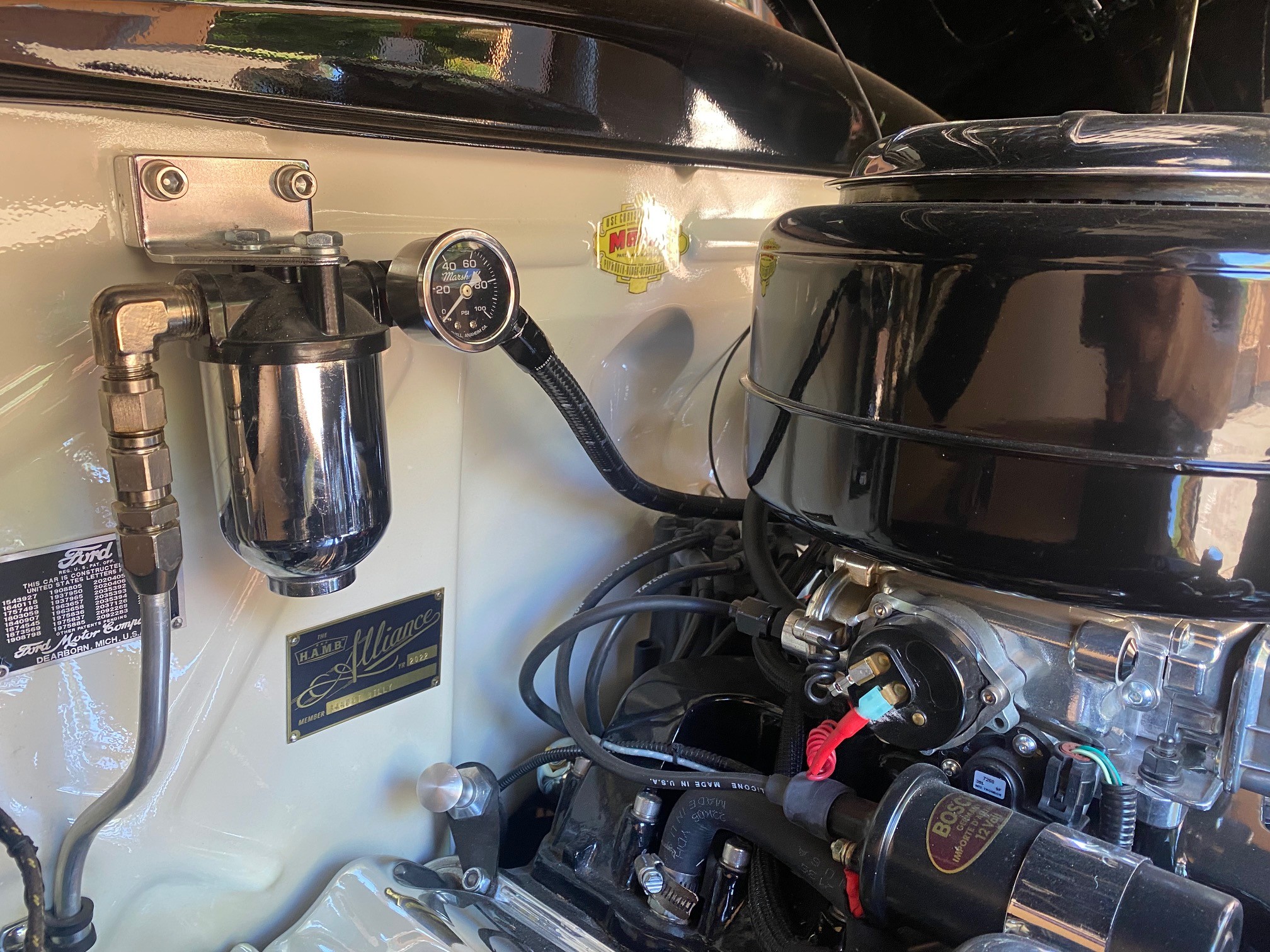

    On my 41 PU I welded up appoximately 112 holes prior to painting. I like a tidy work place.
    The tags are applied with double sided tape, rivets are glued in. I did have to put the brake booster and M/C on the firewall as I ran out of room under the truck. But I kept it as tidy as possible. The wiring is routed through a vintage Cal Custom regulator cover. Again, cloth covered color-coded wiring under the hood and more leather wire straps. firewall2.jpg

    Is there a fitting to go directly from the 90 to the fuel line available?
