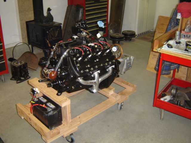

    I built a stand out of 2 x 4's. It worked fine. I'll burn the wood this winter
