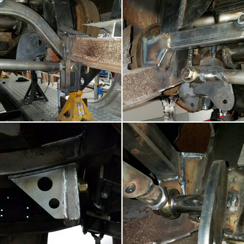

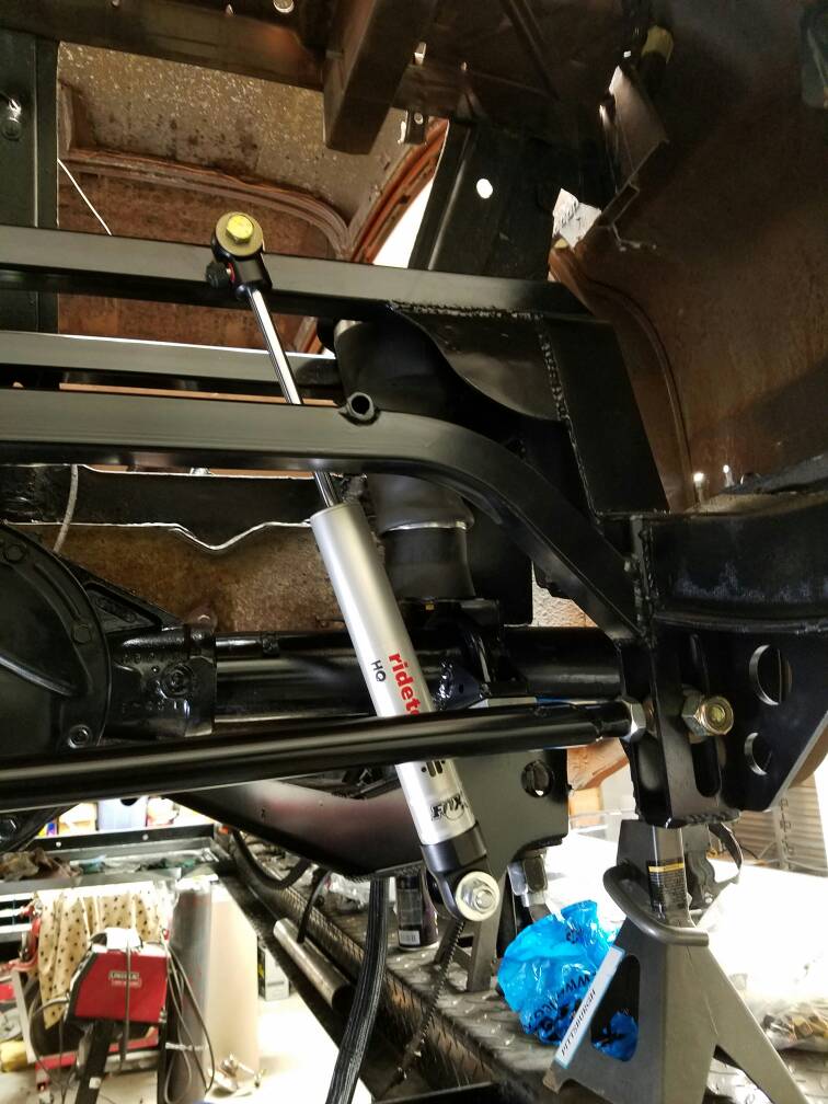

    [​IMG][​IMG][​IMG] Starting to get things tacked in. As you can see I had to move the center drive mount up in the frame to help me get the right angle on the truck arms I still had to run a 1 inch lowering block [​IMG][​IMG] bumpstops modified and bolted in

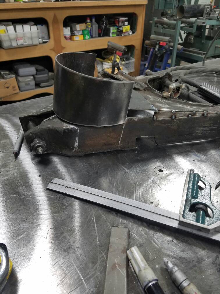

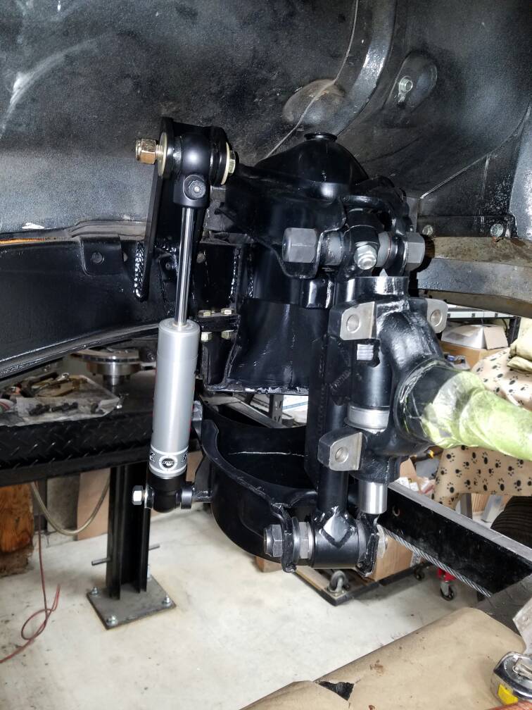

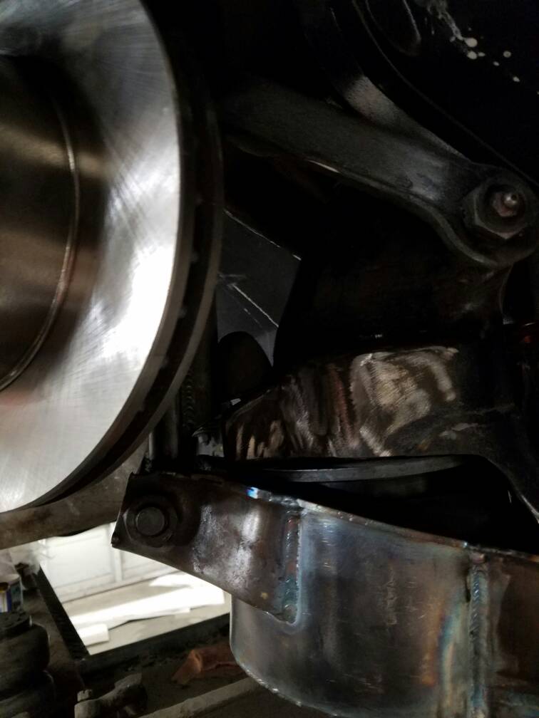

    [​IMG][​IMG] Working on the front dropped uprights disc brakes. Now to cut the pocket and get the bag mounted.

  7. low budget
    Joined: Nov 15, 2006
    Posts: 5,566
    low budget
    from Central Ky

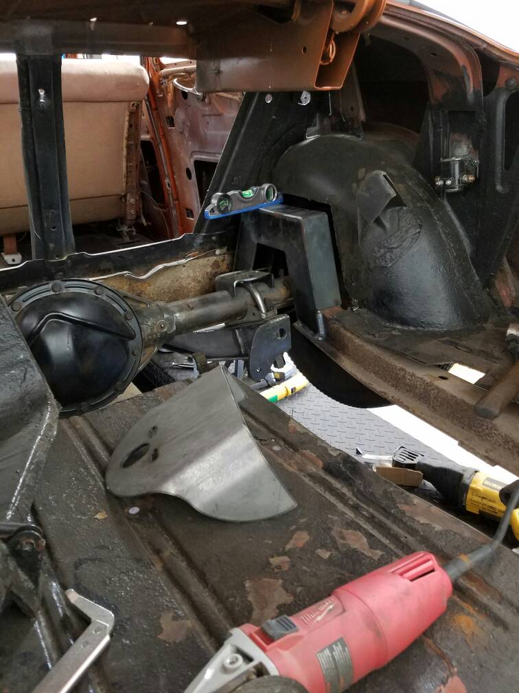

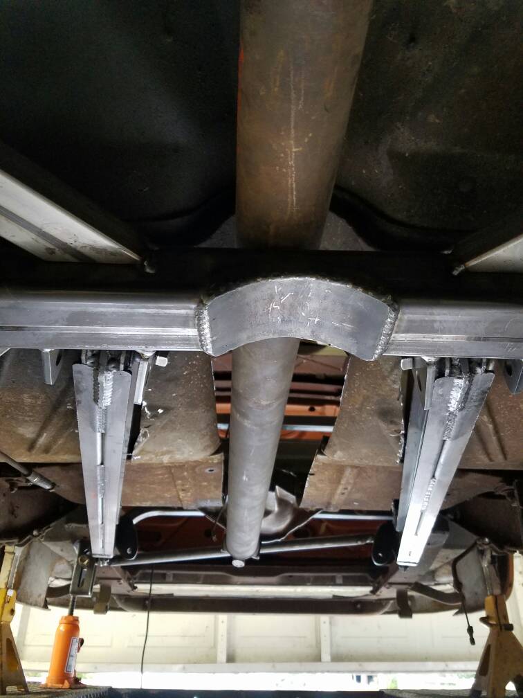

    Wheres the drive shaft gonna sit? Under the indention in cross member or over it? If over, It looks like the indention side should have been facing up, Im asuming your cutting the floor out for the high riding trailing arms to gain just a little more drop? You obviously know more about this than I do, Im just trying to learn something here.
  8. dskustoms
    Joined: Aug 4, 2009
    Posts: 67
    dskustoms
    Yes the driveline clears its above the crossmember . The crossmember is close to the output shaft so it would have to move alot before it interferes it was definitely a concern. I'm using the indention to run the exhaust
    Sent from my SM-G935V using The H.A.M.B. mobile app
  9. dskustoms
    Joined: Aug 4, 2009
    Posts: 67
    dskustoms
    The cuts I made in the floorboard that are the furthest back were unnecessary there are cuts closer to the mounting bracket for the arms that's all that really needed to be cut for the area and of course the tunnel need to be cut. [​IMG][​IMG] Here you can see why I flipped over the crossmember you can see that the mounting tabs for the arms are offset. I set them up as high as I could so that I could get the right angle on the arms at ride height I still had to use a 1inch lowering block to get it with in the recommended angle. It took a few days to get it all figured out but next time will be faster.

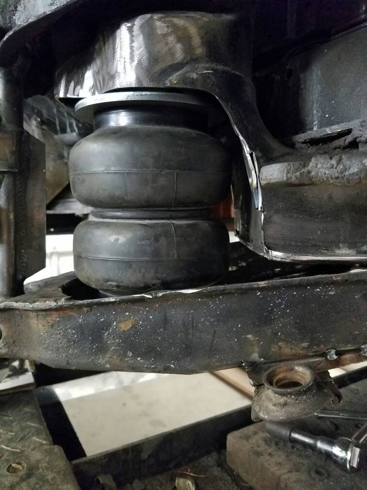

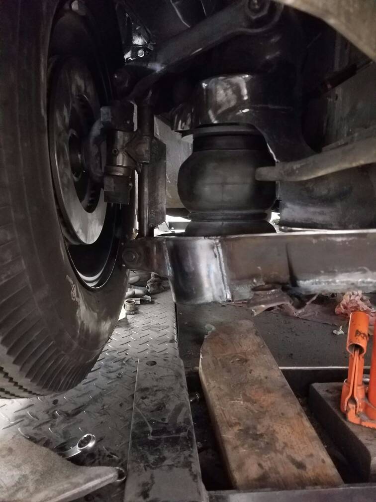

    [​IMG]I have cut out the spring pockets and have my upper mount for the airbag made. Here were looking to see clearances and trying to get the airbag to the recommended height while keeping the vehicle at are desired ride height.

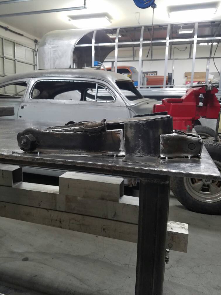

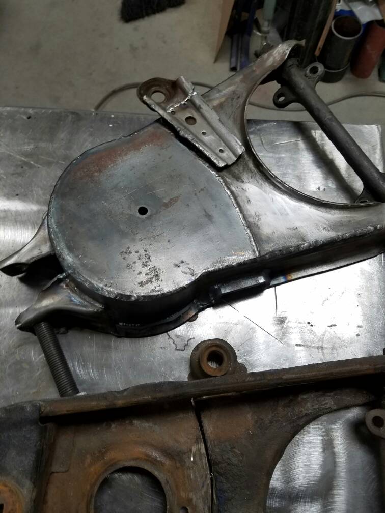

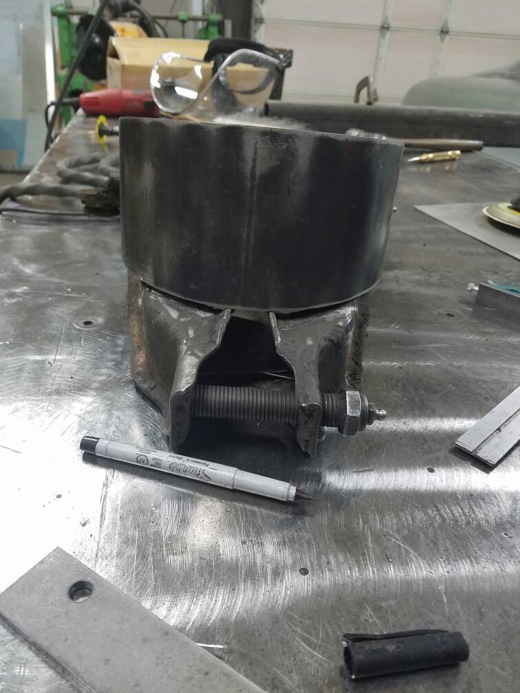

    [​IMG][​IMG][​IMG]The A arm gets welded to the table we used a 7 inch ring we wanted to keep a good clearance around the 6 inch slam bag

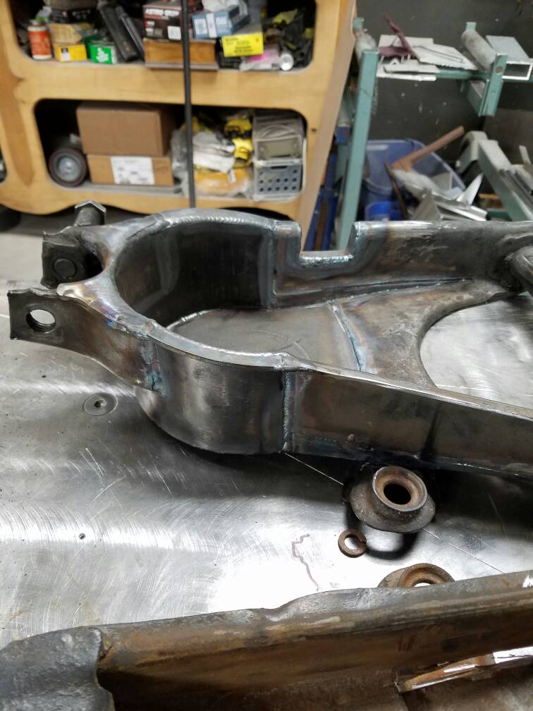

    [​IMG][​IMG][​IMG][​IMG] Here's one all finished up we had to knotch the rear edge of the arm it was hiting the frame mount. Finished off the pocket edge with the flat plate just to clean it up. All the fabrication and welding is done by my friend Chris (mercury_chris on Instagram) he has amazing skills and I'm so lucky to have his time and help on this project.

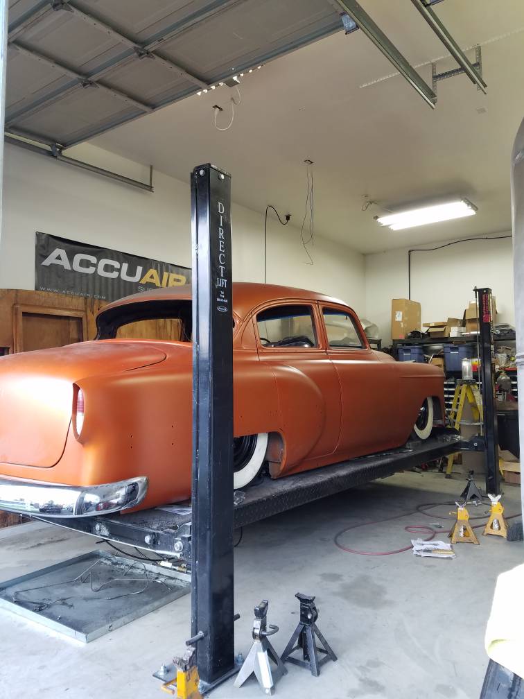

    from FRANCE
    Good stance & nice work!!!
  26. dskustoms
    Joined: Aug 4, 2009
    Posts: 67
    dskustoms
    Got the E Level sensor mounted to the lower A Arms
    Getting the front end wrapped up

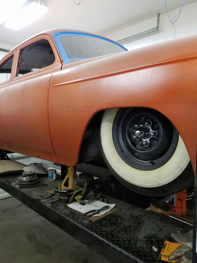

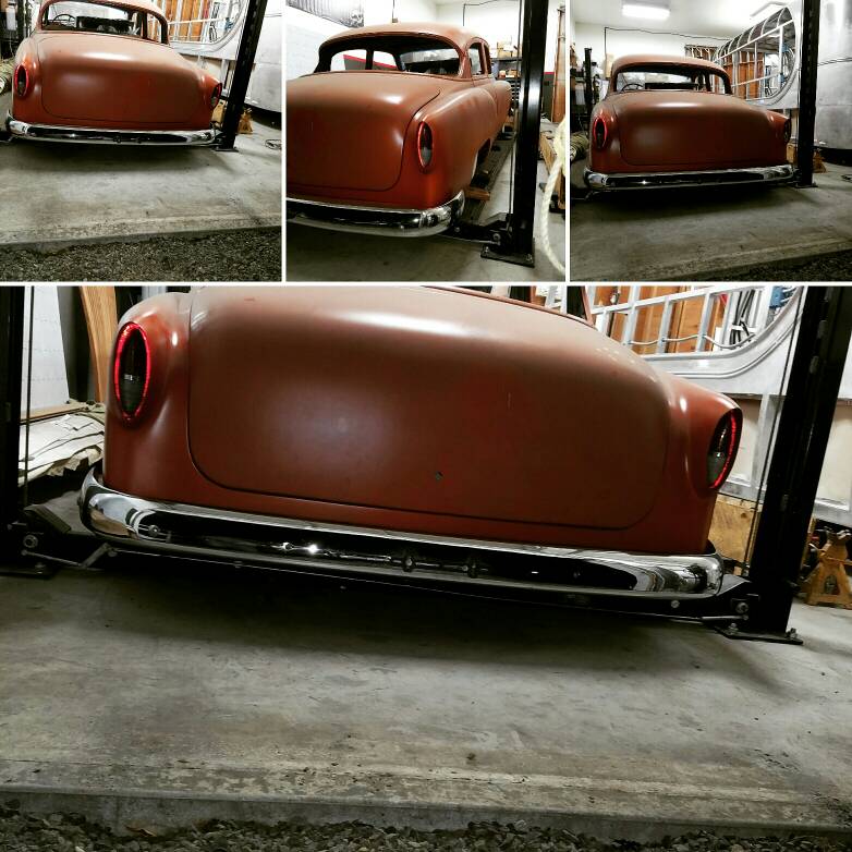

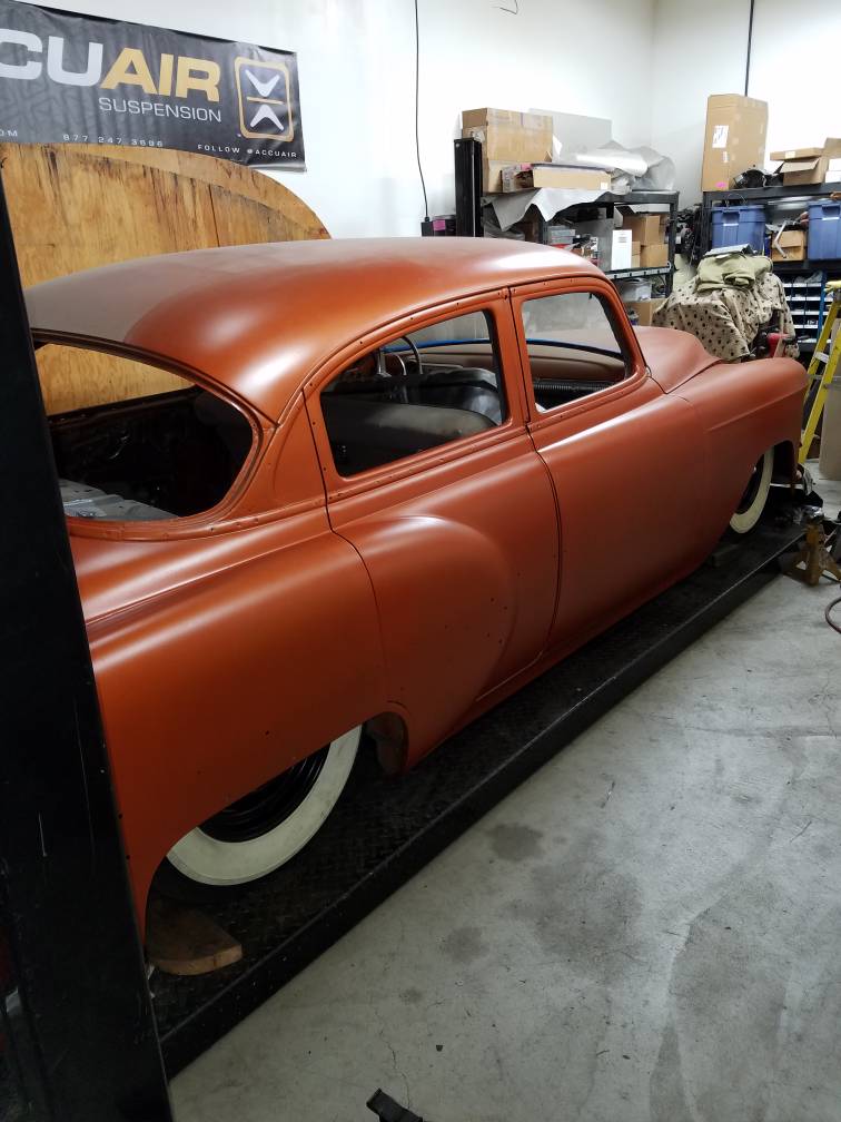

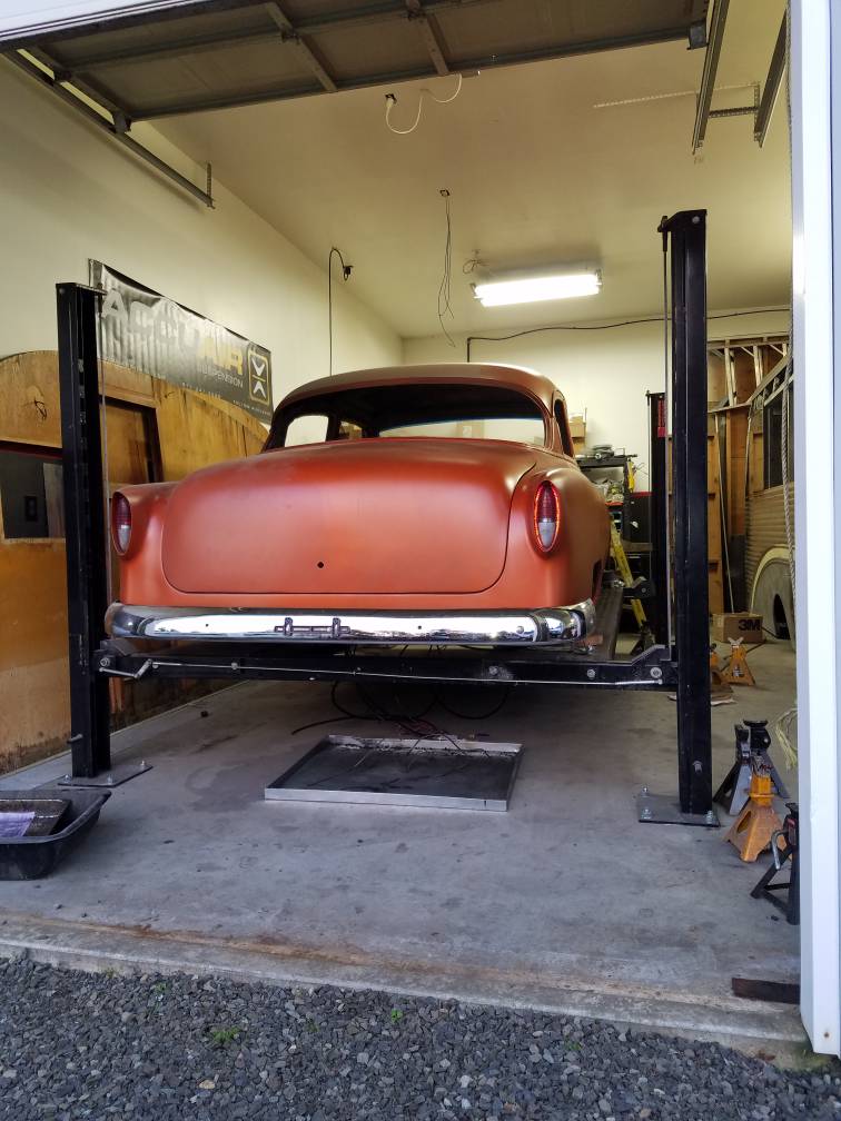

    Finally get to see the car all the way down. So awesome! Got to give my friend mercury_chris a ton of thanks for all of his help and time. [​IMG][​IMG][​IMG][​IMG]
