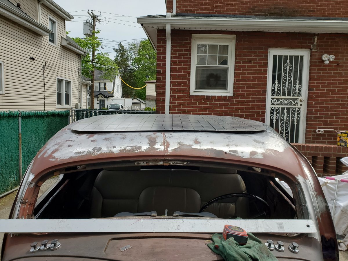

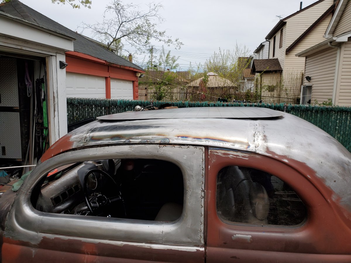

  6. Do it Over
    Joined: Dec 25, 2017
    Posts: 478
    Do it Over
    from NYC, NY
    The panel Walden makes is for the stock opening. When this car was chopped the roof was lengthened by about 4" so his panel won't work. There was an aftermarket panel on the car when I bought it and it was a mile from fitting. Thats why I removed it. As a secondary reason learning metalwork is one of the reasons I bought this project. My goal is to develope and advance my skill set.

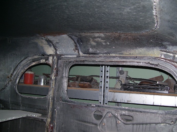

    34inside2_12.JPG I cheated by using a 1st generation Corvair coupe top. My body guy, Jimmy cut it a little oversize, laid it on the top hole with about an inch overlap...used his zippy-wheel to cut down through along the edge of the bottom piece, tack'ing with a tiny tack weld as he went all around the top, slowly. When it was done the weld was a butt weld all the way around the new piece. No warp. Grinding was also slow, using a 1/8th zippy wheel ...came out great!
    Started out with this hopeless piece. [ATTAC[/ATTACH] 34top1.jpg We welded a new header panel and windshield surround and chopped the top before the center piece was fitted.
