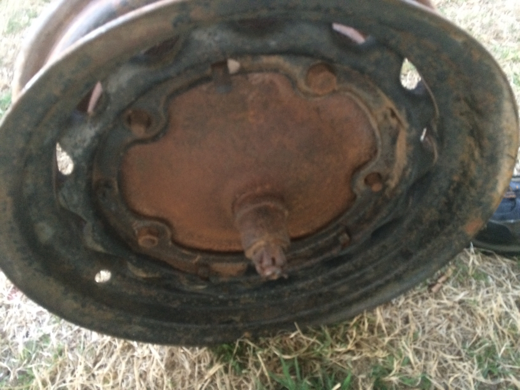

    I just happened to find the perfect rear end today. One of the guys I know sent me a message and said he had a 1939 ford banjo he would give me for a hundred bucks. ImageUploadedByH.A.M.B.1426386401.789992.jpg These things are sweet. I kind of want to grind off the hubcap clips and leave it as is.

    nice project bro. you have countless options on which way to go with your build. a 28-29 sport coupe is neat and not many around, that will be unique. you can modify and brace up the stock ctr crossmember to fit the 3 spd. easy and no money needed {just s**** metal tubing and/or anglebar} OR you can buy the tardel x-member for 450. wide five wheels are cool too. not many people running them anymore=unique again.
  8. If you can remove the clips intact you might be able to pick up a few bucks selling them. Try an ad here and on fordbarn. They always break and I don't think they are reproduced.

    Charlie, thanks for the heads up on the clips. I'm trying to grind the rivets down so I can pop them out, they must be welded in or something. These ****ers are stuck in tight!
