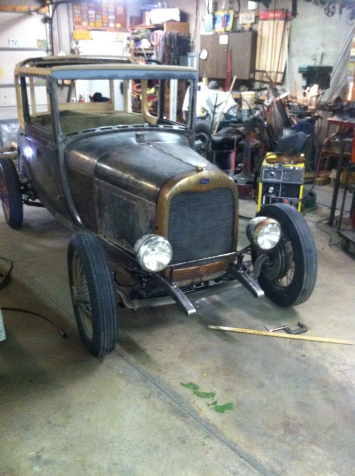

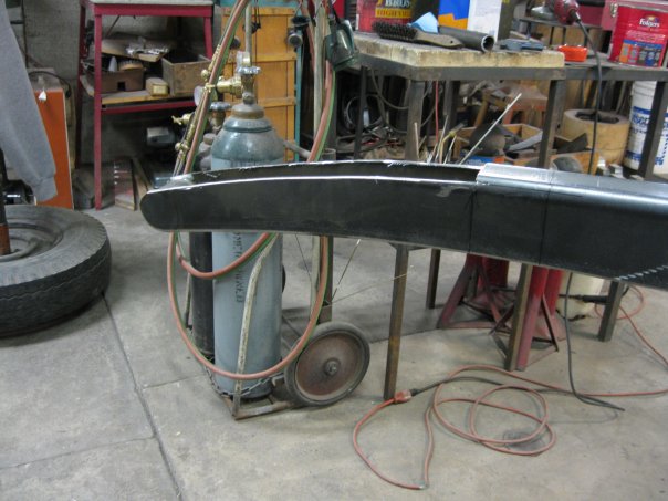

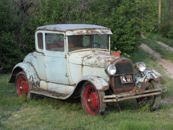

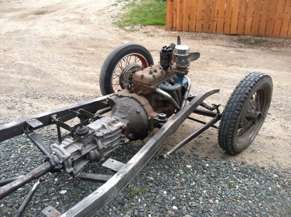

    Back in the '50s a neighbor gave my dad a (I believe) a '39 Chevy sedan. He wasn't able to drive the car so my Grandfather would take Dad for drives and taught him how to maintain the car. One day while at the gas station a gentleman offered to trade the Chevy for a 1929 Model A Special Coupe. The car was in pretty good shape. It had been painted recently with a brush a shade Dad always called garbage truck green. They used left over paint from when they painted the trucks. This must have been '58 or '59. Dad got old enough to drive and he drove the car his first 2 years of high school. When he was a senior he decided he needed a bigger car and bought a '30 chevy 4 door sedan but kept the coupe. It got put into storage for future restoration. Fast forward 20 years and needing more space inside the garage the coupe got moved outside and it sat there for another 25 years. Dad always talked about starting to work on the car but never got to it. After dad p***ed away my brother and I decided to build the car into a hotrod. I started this project in 2008 and took a 3 year break while I built my step son an OT '68 Chevy truck. I am back on it and am making good progress.

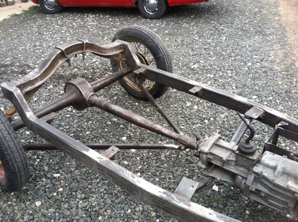

    My plans are to run a hopped up A engine. I have a T-5 behind the motor and am using a torque tube adapter that the HAMB's own Crazy Daddy O built. I am using Speedway juice brakes, split wishbone, 4" drop front axle with a reverse eye spring. There is a 6" Z in the frame my brother and I built. Coupe jungle.jpg Coupe beginning.jpg

    Good lookin car and a nice shop also. Have fun and keep them pics comin.....Tim

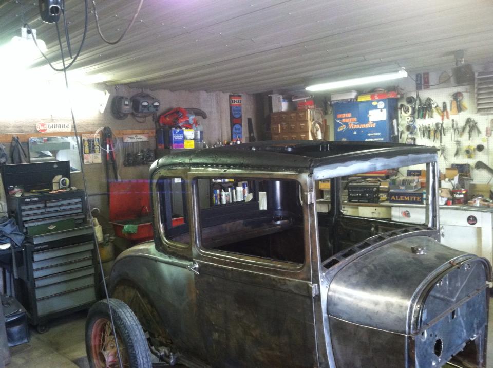

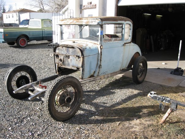

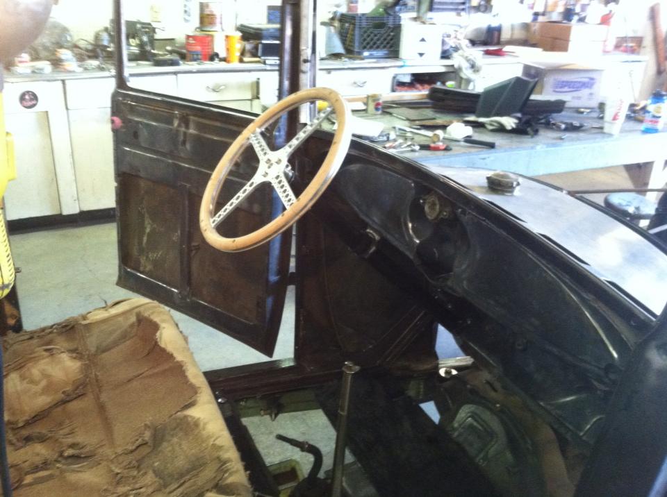

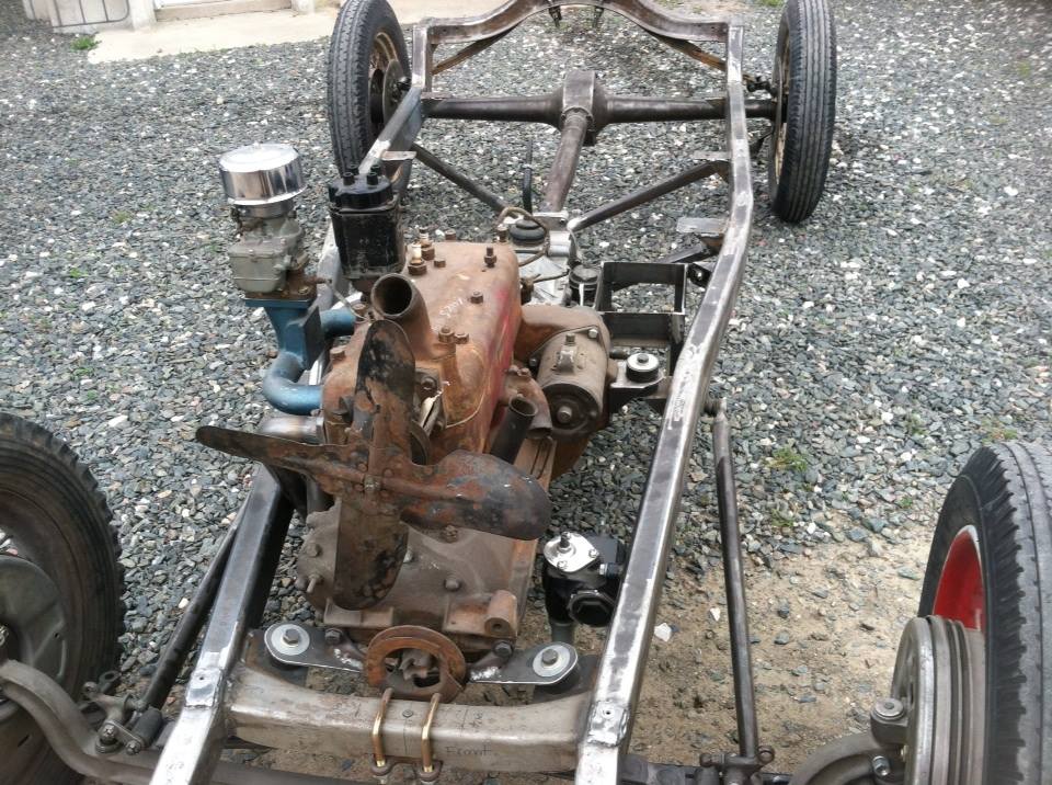

    Some of these are out of order and I apologize for some of the ****py phone pictures.
    Hard to believe that going on 8 years of off and on work is summed up in a handful of pictures.

    That's a nice starting point! Looks solid.
    Dosent look like it sat out for that long.
    What is the plan with the mill?
    There is a great thread, getting my banger rod to so highway speed, there is a nice post about what needs to be done to have sufficient power to cruise at highway speed with a T5.
    Not that you need to got that fast, but there was some damn good advise too, about bangers.
    I like it a lot, so fare! And there is just something about 19 inch wire wheels I like, over the 16 inch V8 wire wheels.
    And I most confess there I something about the look from a Banger with a lion's head, VW (bug) 009 distributer and two SU on homemade manifolds. [emoji12]
    Keep at it, lad. [emoji4]

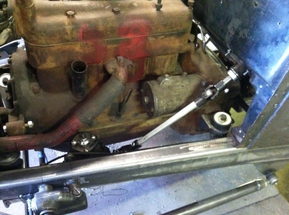

    The plan for the motor is to start with bearing inserts and a counterbalanced crank. Cut down flywheel and a V8 clutch. High compression head to run with Vintage single Down draft intake and Red's Header. I have a Mallory Distributor I plan on running also. I plan on running a stock engine until I can afford to have one built. I want to get this on the road this summer and work out the bugs and blow it all apart for paint and upholstery next winter.

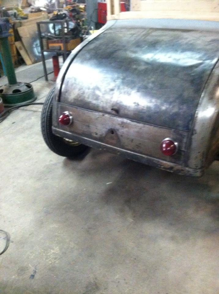

    The pics of the frame build out were from about 7 years ago. The most recent ones are of the shocks head and tail lights floor boards and steering column. I am making great progress recently. A friend in town wants me to have it ready to take to the Hotrod Hill Climb at the end of June But I don't think I will be able to make that one.

    Body plan is simple No chop no channel. I am a tall and big around guy who cant fit into a chopped channeled car. I already moved the seat back 6" by moving the seat riser back and cutting down the package tray. I can post up some pics of those parts tomorrow.

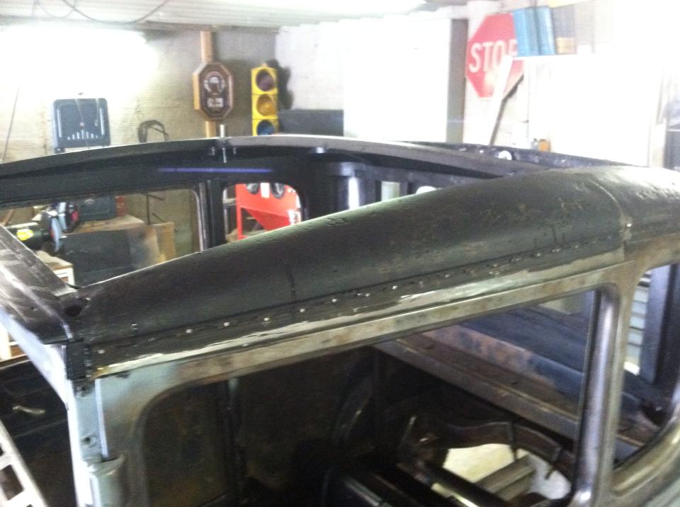

    I got the quarter window tins and the top of the back nailed on this weekend. Working on the pieces above the doors now.

    The front and rear shocks are from a 1930 Chevy. I cut the eyes of the end and welded the ball off of ford shocks so I can use the dogbones. The rears are from the same car but I used the chevy shock links on them. The original eyes from the chevy were welded to the radius rods. I had to shorten the chevy links to work. Sorry I don't have any pics of the rear. I can get some shots and post them.

    I got the tins that go above the doors installed this last weekend. There are a few more wood pieced that need to go in and all the wood will be finished.
    I have taken the engine out and am getting it painted and ready to go back in. Looks like I will be able to drive this thing this summer IF I can find a clutch that will work for me. I am working on getting one made. Anyone know where to find one that will work with a T-5 and a stock A bell housing?

    I have the auto restorations I think it's called model a to t5 adapter kit it came with a clutch that uses the factory bell. I haven't bolted it all up yet tho and the clutch is very cheap like but it might get you going until you get one made. Be sure to list the specs on the clutch because I'd like to get a better one.

    Auto restorations is out of business. Phone is disconnected. I should have bought the disc when I bought the adapter plate, the pilot extension and the throw out sleeve. I didn't have funds at the time for the disc and am running a closed driveshaft and didn't need the rest of the kit. Could you post a pic of that disc? I would like to see what they made.
