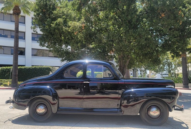

  7. Well, bought the '41 Ford today to start the project. All original except for an electric fuel pump. One wiper, one tail light, no turn signals, no rust, single exhaust, 6 volts, one 24 stud flathead. 7.jpg

    That’s a gorgeous car.

    That's a beauty!

    She’s a beauty! I don’t see much of a project there;).
    warhorseracing likes this.
  13. Maybe pull the bumpers, wider tire/rim on rear, a red pinstripe on the wheels, dual exhaust with your favourite mufflers and you could be done. That side shot makes it look really sharp.

  21. Thanks for all the comments; it is a looker. Appears to have been in a very large personal collection as an example of a super stripped down 1941 Deluxe, one tail light, one wiper, no lock on p***enger door. Probably the original 221 cid 11A 90HP engine. BTW, it does have red pinstripes on the wheels, just can't see it in the photo. Surprised at how well it steers; I'll keep the front tire size. Wouldn't mind a 2" front drop but all the drop axles I've seen are 4".
    Haven't received the car yet, waiting for check to clear and shipping (not going to drive it in heavy traffic on I-5 for my very first ride.) I live in San Diego, no other reasonable way to get there.
    1st modification is a 12V conversion for installation of some bright tail/brake/turn signal lights and for better cranking when hot. (Thinking about horizontal LED lights mounted on the rear bumper brackets so it doesn't change the look of the car. If I'm caught out after dark around San Diego, HAVE to have a major lighting improvement.) I'm considering a 12 V conversion kit from Vintage Auto Garage even though I might be able to piece together all the necessary parts for about $100 less.
    PITA issue with 12V conversion is the existing 6V external electric fuel pump. Don't know how many amps it draws so hard to pick a step-down converter. Might just try running on the mechanical pump alone w/o the electric pump. I'll buy a 12v in-tank pump later but don't want to do that right off the bat and get involved in too many things at once.
