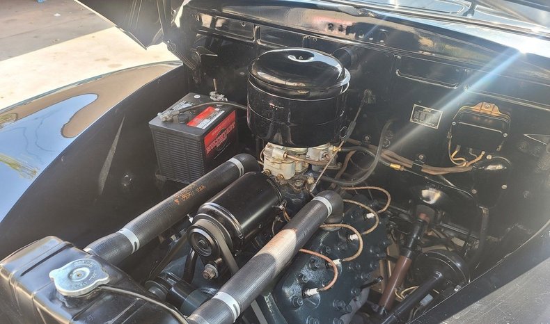

  1. Thanks for the reply's. Taking it slow seems like the best advice. My top priority is getting it to start while hot. It wouldn't do that when I tested it. It wouldn't even crank. Thus my priority for 12V. It starts just fine when enough voltage is applied, but not on it's own 6V battery.
    Not really anxious to modify, just want to be able to get back home on my own without a tow truck after going to the local cruise-in. (Been there, it REALLY ****s.)
    This car is a real museum piece and a high quality restoration, it's just not a real driver yet, doesn't have the scars. It appears very attached to low humidity indoor storage and polite "please don't touch" observation. My goal is to make it a real driver.
    It's a Ford Special Business Coupe, not a Deluxe or Super Deluxe, thus the stripped down nature and one tail light and one wiper. Very few of the stripped-down "Specials" were made. Looked the car up on Google, it's been sold and resold several times in the past 2 years; multiple dealers trying to make a profit. I paid somewhere in the middle. A lot of money has been lost on this car; no one wants to keep it but me.

    Here's a little story. I have a '51 Ford which is still 6 volts. I have had the car almost 40 years, and have never had a problem starting it as long as I had a good battery. In all of that time, it failed to start only once, and that was on a very hot day when I had been doing errands. Even though the car has been very reliable, I was always troubled by that, and the fact that every once in a while it would sort of hesitate on the initial revolution of the starter. About a month ago, I decided to do something about it. I had a bunch of new bushings and brushes I had gotten several years ago, so I decided to go through the starter. I went through my stash of cores, and found one marked "GOOD", which I installed temporarily. I immediately know that there was a problem with the original starter as it spun over at least twice as fast on the "new" starter than it had ever done before; also, the slight hesitation was gone. When we went through the original starter, we discovered a "cold solder" joint where one of the brushes was connected to the field coils. One side we had to apply a bunch of heat to unsolder the connection, while the faulty side just pulled out.
    Here's a case where 12 volts probably would have masked the problem with starter, which unfortunately could have failed completely at any time. As I said above, running 6 volts takes a little more care, but in my case at least, it was worth it.

    That could be something as simple as a new starter or properly cleaning the grounds. Ground connections are alot more specific on a 6V car than on a 12V. The only main reason for manufacturers switching to 12V were the corporate bean counters. Smaller wire diameter required for a 12V system = less cost for copper wire.

    Yep, my starter in my ‘59 Chevy PU one day up and quit on me. The neighbor across the street came over to see what I was doing, ect. When I got it out he said “bring it over”. We pulled it apart and he said “there’s your problem”. He resoldered all the connections then said “go try it now”. Worked like new.
    Turns out he worked in an auto/electric shop for quit awhile back in the 60’s.
    He told me if it was 6 volt I’d have had some warning.

    I would agree and that is why you want to start with cleaning the connections. That course is free and will allow you to enjoy the ride instead of throwing money at a issue that may not even be a problem.

  9. If it's a full restoration, chances are all the ground points got a good coat of paint, hence... bad grounds. Clean all ground points, being methodical and doing one circuit at a time. Also make sure you have really good, high quality ends on the battery cables. Don't concentrate only on the starting circuit, look at the charging circuit as well. If you don't see any improvement, pull the starter and check it out (as well as the generator). Go slow, carefully and methodically... you'll get it squared away.
    Remember... there were MILLIONS of 6 volt systems that worked quite well for decades. Yours can too.

    I came here to say that is sounds like an issue with your starter. I would have it, the generator (while you're at it) and the battery tested to see if they are all in working order. It sounds like this car didn't get a lot of use so things like that can go largely unnoticed and/or deteriorate from simple age in storage.

    I'm getting just a little confused. It appears that you have rare (hence desirable) car in excellent original shape. It also appears that you are fully aware of that fact, You have apparently had the car for a very short time, and yet you are considering making major changes to it, many that might have a deleterious effcet on the value of your car. You were on the right track earlier when you said you were going to slow down. I hope you are still of that mind.
    At this time the only thing I would do is to make sure the battery is in good shape and correct for the car. I say this, because once when I was in a pinch, I bought a cheap new Group 1 battery. Those are quite a bit smaller than various Group 2 batteries used in Fords, and I had trouble starting my '51 when it was really hot when I had it. I solved the problem by opening the hood every time I parked the car on a hot day, but that can obviously be impractical. I can't quite make out what's in there now, but I'd check it out. If the problem is the battery, I'd seriously consider a 6 volt Optima with 800 CCA. They are the solution to any residual 6 volt problems. They are kinda funny looking, but that can be solved with a faux Ford script case and top. They are quite expensive ($180 these days?), but the first one I had lasted 13 years and my second one is still going strong after 11 years. Also, like many have suggested here, make sure all of the grounds and connections are clean and tight. I would also check the battery cables. 6 volt systems require heavier cables than are available in and auto parts store, and 4 ga cables can really cut down on the current to the starter. I believe your cars uses a braided ground strap; if you don't have the correct one of those it could also be the source of the problem.
    And for those of you suggesting an automatic change to 12 volts, read the guys description of his car; it sounds like a very special unit and he knows it. I know this is a "Hot Rod" forum, but we are to the point where the rare ones should be saved. One last thing. My dad was a traveling salesman in the Midwest in the '50's and '60's. He got a new '51 Olds that had a big overhead valve V8 and 6 volts; I never remember him having trouble starting that car on a Minnesota winter morning. I also had a '50 Buick with a 263 ci straight 8 and 6 volts that I drove to work for two years in the late '60's. It rarely failed me in the winter.

  22. Thanks for more great ideas. Transport delivered the car yesterday. Driver told me the car had to be jumped to get it started on the way down but he noticed the battery cables were loose. The highest return on investment of any tool I own is probably my battery terminal cleaning brush. Used that, and tightened the cables with a wrench, and got it started without a jump. Of course it was cold. Put the battery on a trickle charge and it went to green overnight.
    Had to work yesterday and today so haven't done much. Played with the lights a bit but I think that drained the battery way down in just a few seconds; six hours later still charging. May have some gremlins there too, some of the wiring looks original. The neg battery cable is 2 ga and the positive ground is braided wire. Checked the tire pressure; all 4 less than 20 psi; in other words, no one's been taking care of the car. Not like bringing a barn find to life, more like bringing a trailer queen to life.

    I agree that the car looks great! It sounds like the battery has not seen the best care and use lately. I think I'd start there (with an Optima).

    I agree that it looks great, that you are reviving a trailer queen and that the battery is the first thing to suspect and get tested properly.
    Once you have a known good fully charged battery, check for any parasitic drains and clean all those connections. Then check the charging system function on and off. At this point, do a full check of the fuel system and ignition. Once it's ready for driving and sitting without issue, move on to brakes suspension and alignment.

  30. Status:
    1. 6V battery is good and fully charged (according to AutoZone)
    2. Worst ground ever; s****ed the paint off the contact surface and bolted it back. Getting a star washer for good measure on the next trip to home depot.
    3. Cranks just fine now when hot. Probably means the starter is good too.
    4. Will check voltage next time car is running to see if generator is charging.
    5. It's a 6V car for now, no urgency to convert to 12V
    6. Something's not right with the Model 59 94 carb.
    When purchased, it was idling around 1200 rpm with the idle screws about 1 1/4 turns out and with the accelerator pump in the "severe cold" hole. Gas weeping from somewhere. Really nasty off-idle hesitation. Not undriveable but very unpleasant. Reset accelerator pump to "summer" hole, reset idle speed to about 600 rpm, adjusted idle mixture to eliminate black exhaust, idles fine but screws are only about 1/4 turn out. Very odd. Still have a lot of gas weeping from somewhere. Right through the idle screws is one place; they seem moist to the touch. No change in hesitation or driveability. My ***essment is that gas must be leaking inside the carb as well as outside and which is why it likes only a quarter turn out on mixture screws. With only a quarter turn out, the transition circuit probably isn't working correctly. Accelerator pump could be bad too. Looked at the Edlebrock rebuild kit for a Holley 94. Not really too much in it. It might help but would not be surprised if it doesn't. I'm very tempted to give up on this carb and just get a new one but will probably go through the motions of the rebuild kit. I'll check the rated fuel pressure of the electric pump, maybe it's too high. Would prefer not to use an electric fuel pump but the mechanical pump doesn't seem to be able to pull enough fuel through the electric pump when I turn it off.
