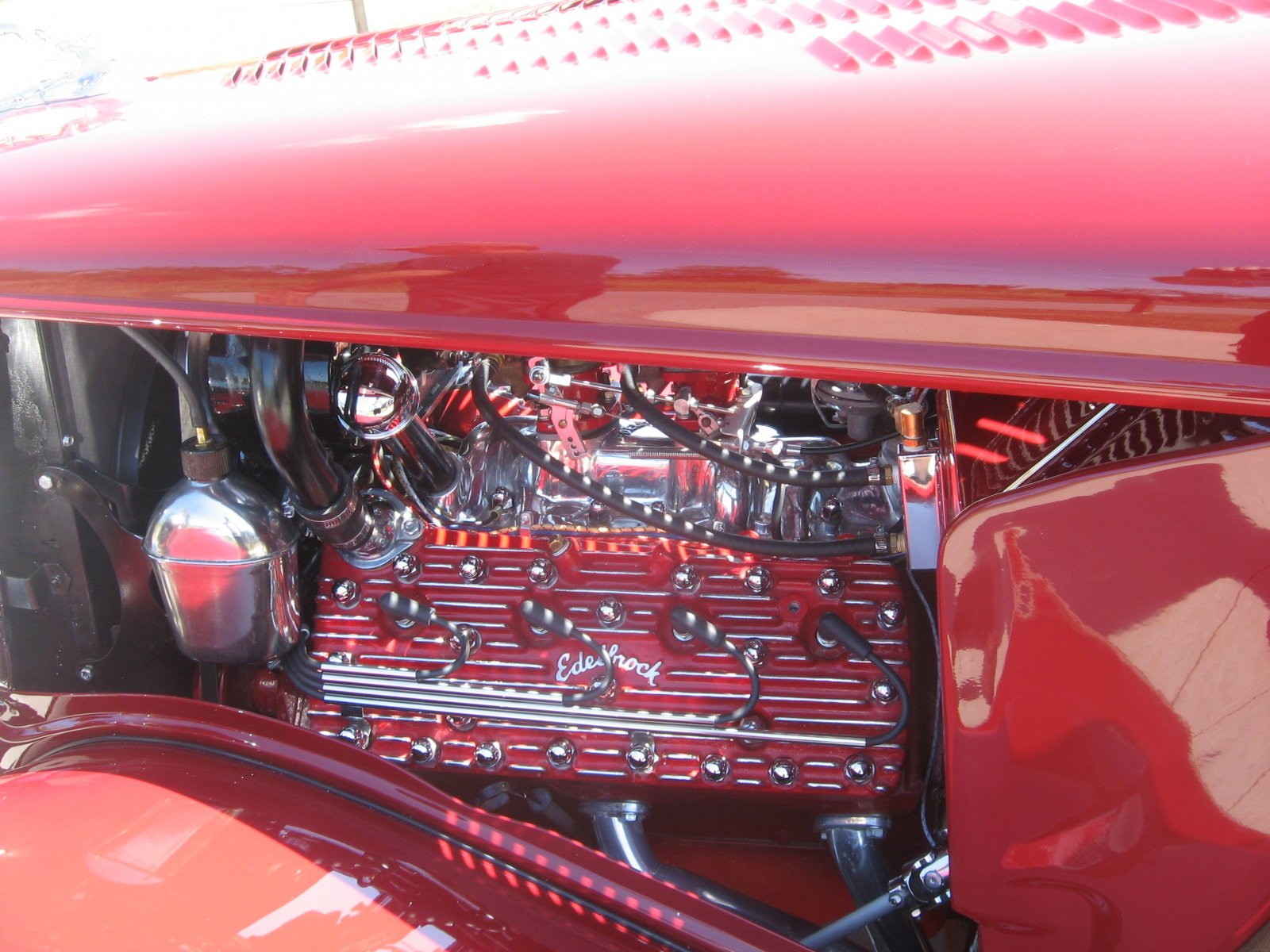

  25. arkiehotrods
    Joined: Mar 9, 2006
    Posts: 6,802
    arkiehotrods
    Dadgum, that is one pretty coupe! You did good! Once you get it all sorted out to where you can drive it wherever you like without worry, gonna be hard to get the smile off your face!
    I had a '47 Ford coupe with flathead and 6v system. Fun cars!
    Nostalgia Sid dropped the axle on my '40 coupe 2" and you might consider contacting him if you want to drop the front just a couple. Here's his website https://www.droppedaxles.com/ He is also on the HAMB
    warhorseracing likes this.

    Look at my Roadster, seems U want a similar drive train. Very reliable so far, finished in 2014. Easily keeps up with traffic, 65/70mph & has never over heated. A blast to drive.
    I should add that it now has an electric fuel pump as it needs a little ***istance after not being driven for a while. I did have a mild custom '51 sedan that I sold a couple of months ago that still had the original flathead that was stock except for a Petronix conversion to the distributor, a 12 volt Chev alternator, new wiring harness & the before mentioned electric fuel pump. it was very under powered compared to my roadster & not near as much fun.
