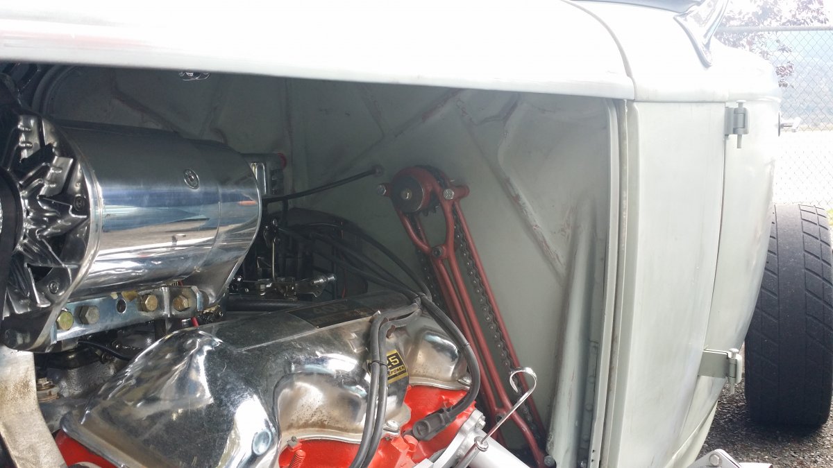

  8. DDDenny
    Posts: 22,441
    Saw this on another thread and thought it was pretty cool.

  10. squirrel

  11. DDDenny
    Posts: 22,441
    This is the kind of stuff that trips my trigger, and I was pretty sure you were of the same mindset. Wish I could see some more details of its construction, all it needs is a squirt of that good anti-sling chain lube, not much to it.........except thought, creativity and time.
  12. Where'd you get the pic from?
    Might be a lead to more info there
  13. DDDenny
    Posts: 22,441
    Give George or Paul a ring.
    From the Swindlers 2016 event thread.
  14. I worked in a center steer dirt track car that used two sprockets and #428 double row chain (Harley primary chain).it was an old car and looked like it took a real beatin'.
