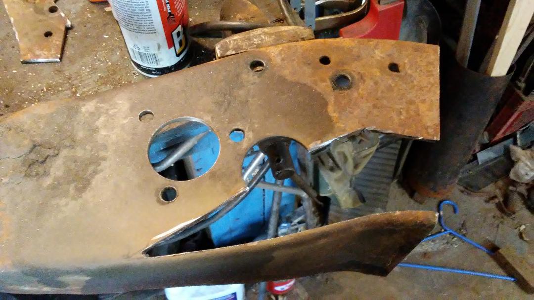

    I haven't updated in awhile, but I've been making slow progress. This frame had the left frame horn cut off to make it a trailer at some point.
    So found an original and grafted it on.

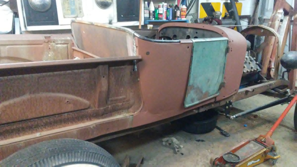

    Made a lot more progress so these will be out of order. 57 carriage bolts holding in the wood and a buddy welded the filler and bungs on the stainless tank.
    I needed a new back panel for the cab and in the spirit of the build (or lack of funds) I found something that would work. Whippet meet Model T. I torched and bent some 5/8 rod for support in the back panel and to make it flow into the quarters. I'll probably make a body piece that will cover the last of the rod that can be seen.
    barrnone50, biggeorge, OFT and 3 others like this.

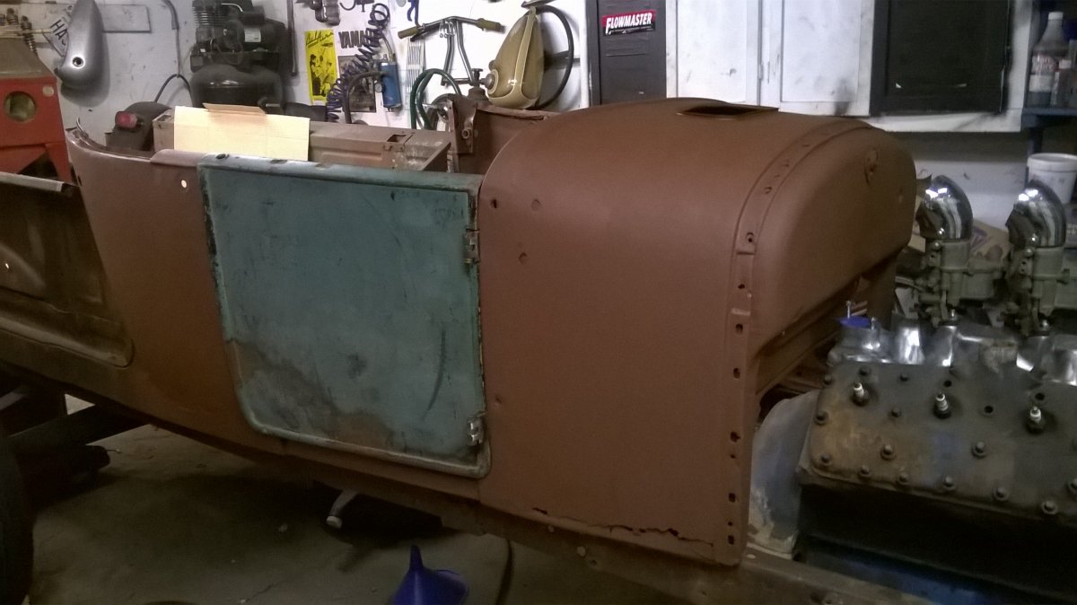

    Here's the frame work for the steering box. Still going to add some cross braces.
    And I cut down a closed car dash to fit.
    Made about the smallest steering column I've ever seen.
    Installed with a bracket to keep it sturdy.
    And pretty much where I'm at now.
