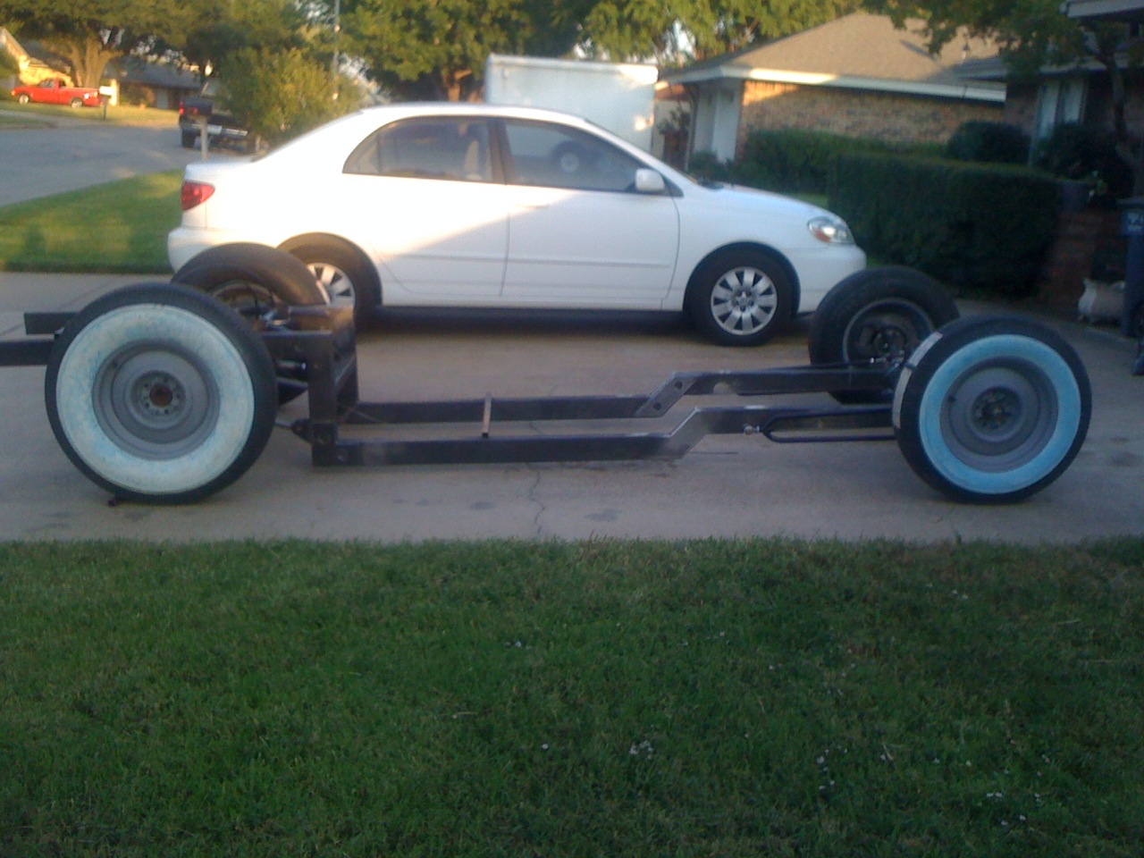

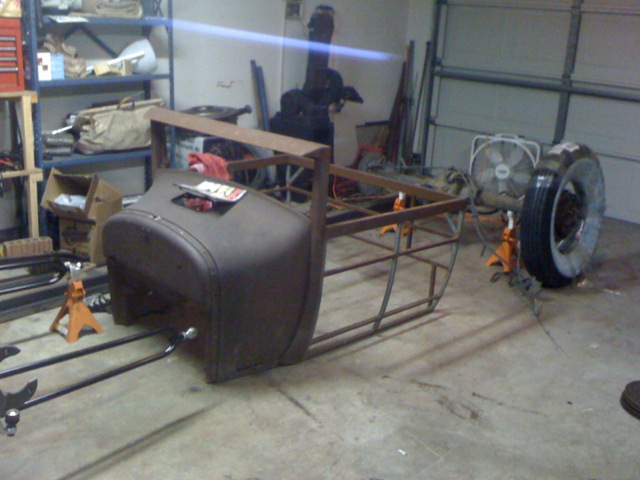

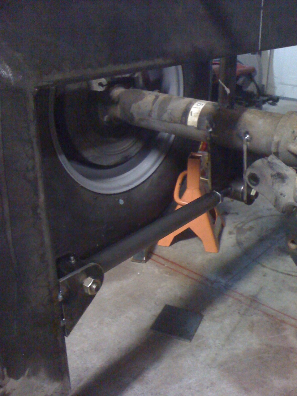

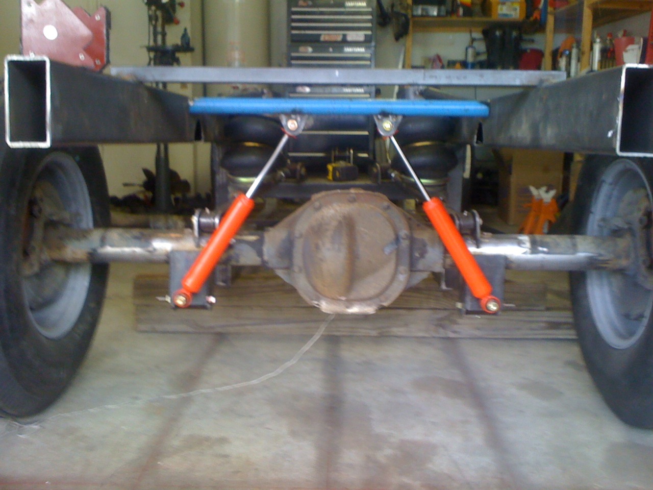

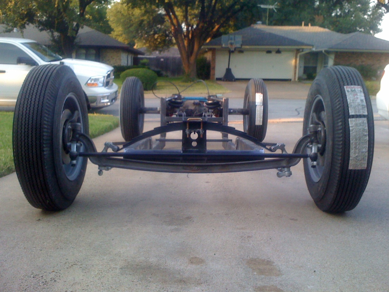

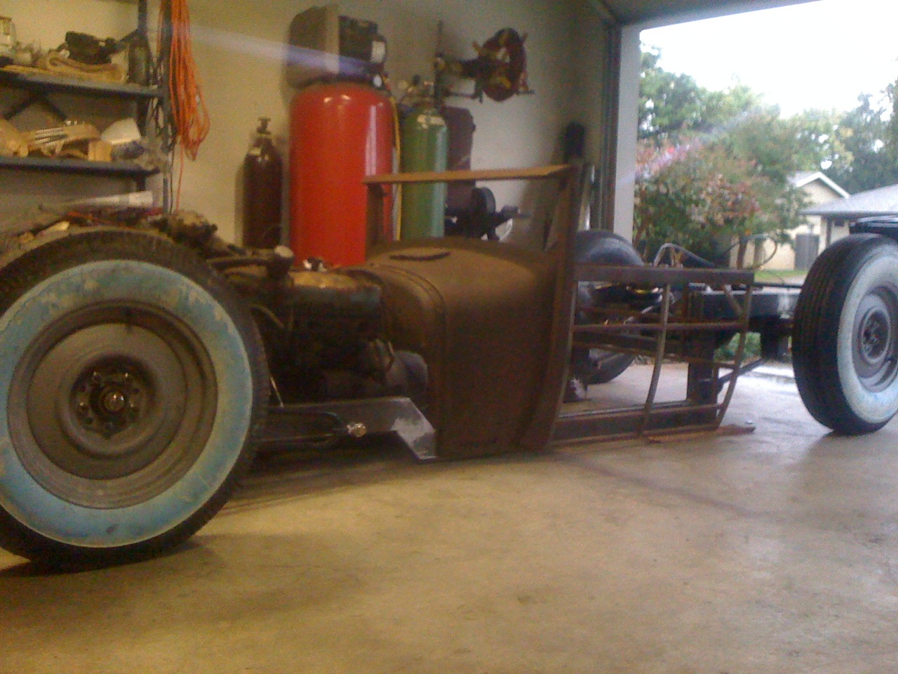

    Hey, I'm new to the site and haven't posted much stuff on here. I know this is a traditional hot rod site, but thought I would post my build and see what people think. It's a 27' T cowl, with a 440/727 drive train and a 8.8 rearend. I know that my build is not traditional due to the fact that is has air ride in the rear, but I think it looks cool. Don't have the bed of the RPU made yet but it will have one. Here's some pics from the start to now which has been about 2 months.

    sits really low hows it gonna do with bumps looks like it would be hitting the ground just by putting the engine in.

    Thats a serious Z job on that frame.
    Looks to be sitting low, looks like your setting it up for bags in the back?
    Over all pretty wild looking.
    Looks famliar...
  6. brawal128
    Joined: Apr 8, 2008
    Posts: 145
    brawal128
    It looks so low because the frame sitting so close to the ground. When the bags air up, the ride height is 4- 4.5 in and I can still go further up if need be. But, I like the way it looks layed out.

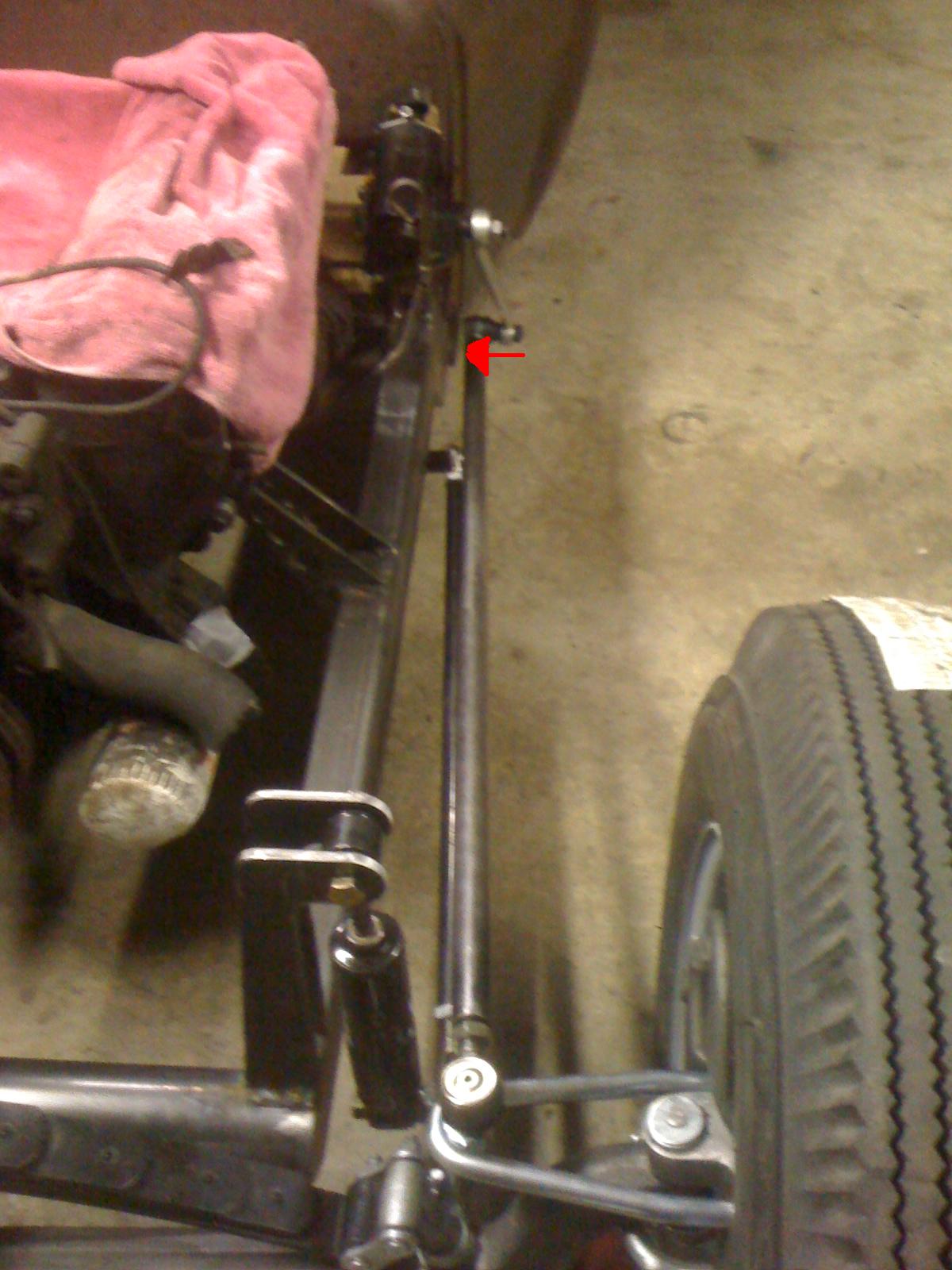

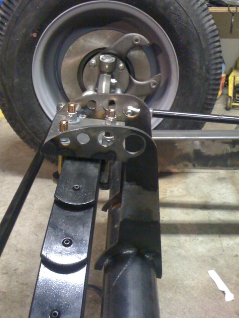

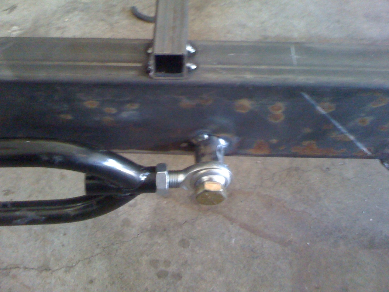

    Made the steering drag link and finished tieing the steering shaft to steering wheel. For the steering drag link, I took 1" DOM tubing and bored out the center to 5/8", the used a LH/RH 11/16-18 tap and tapped the holes out. The tie rods fit perfect and I am very pleased with Speedway motors and the quality of products they sell.

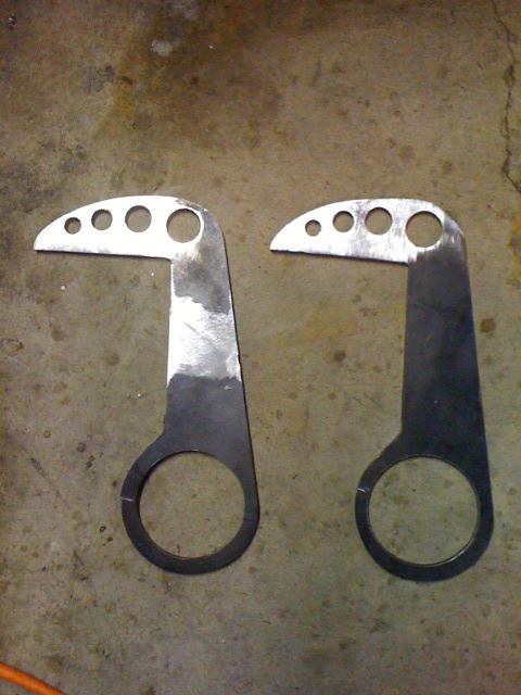

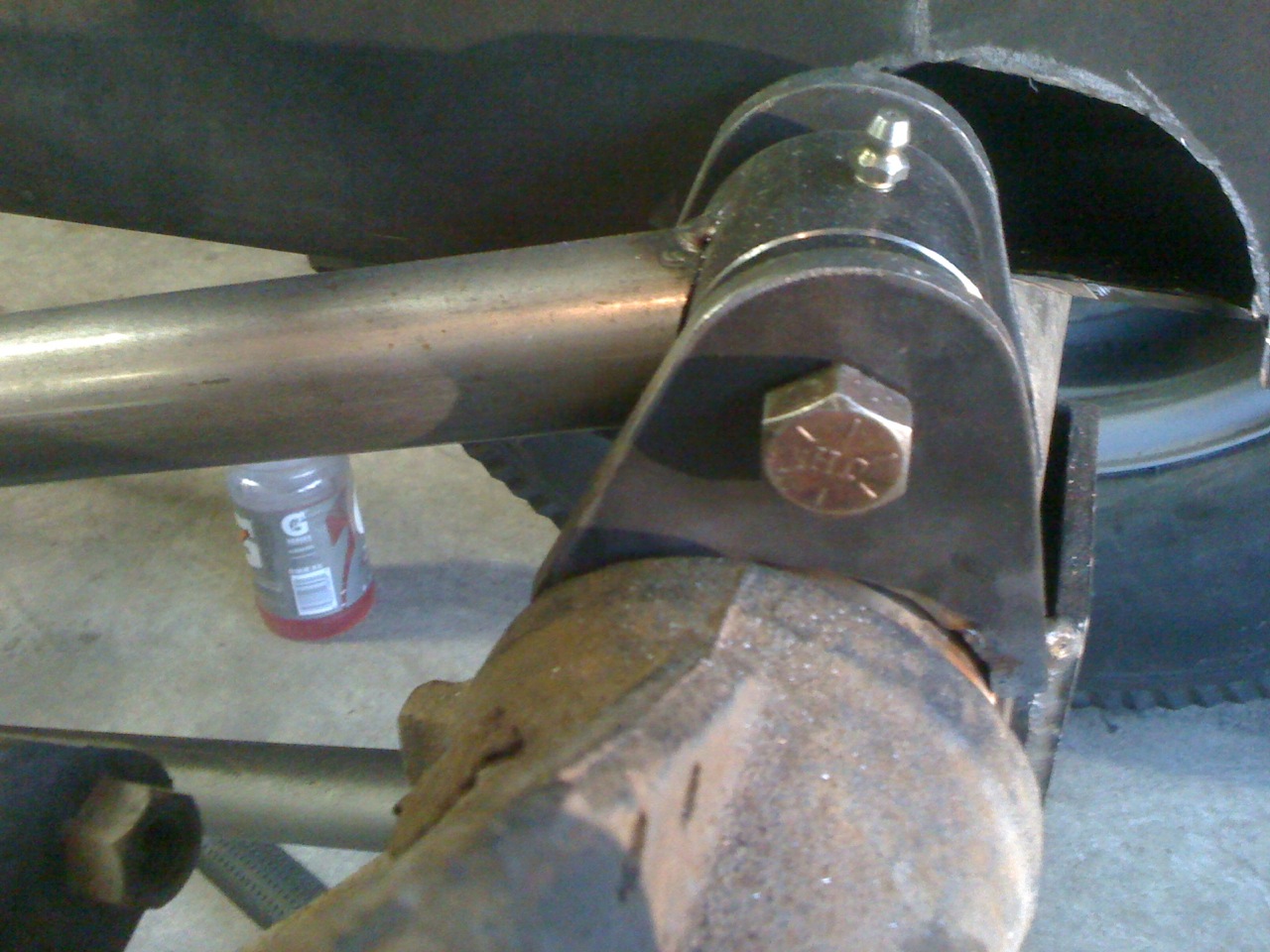

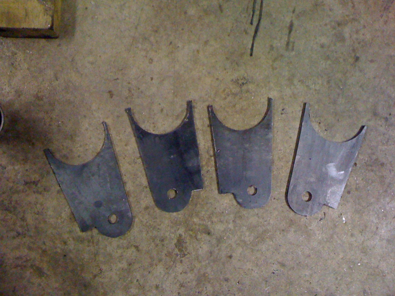

    Got the shock brackets made and mounted this weekend. At first, I was a little curious about the out come, because they came out a little taller than I had expected. I really didn't have much option about were to put them. So, I made a bracket that connects them to the bat wings. And just mounted them were space was available. But, I think they turned out pretty good. Raised the steering box up about an 1 1/4" to clear the hair pin. I did this because the tiring was hitting the drag link. I still need to bend the pitman arm in to get more clearance. Still need to make the back piece for bracing on the shock mounts. Going to get brake line and fittings this week. Should have the brakes done this week.

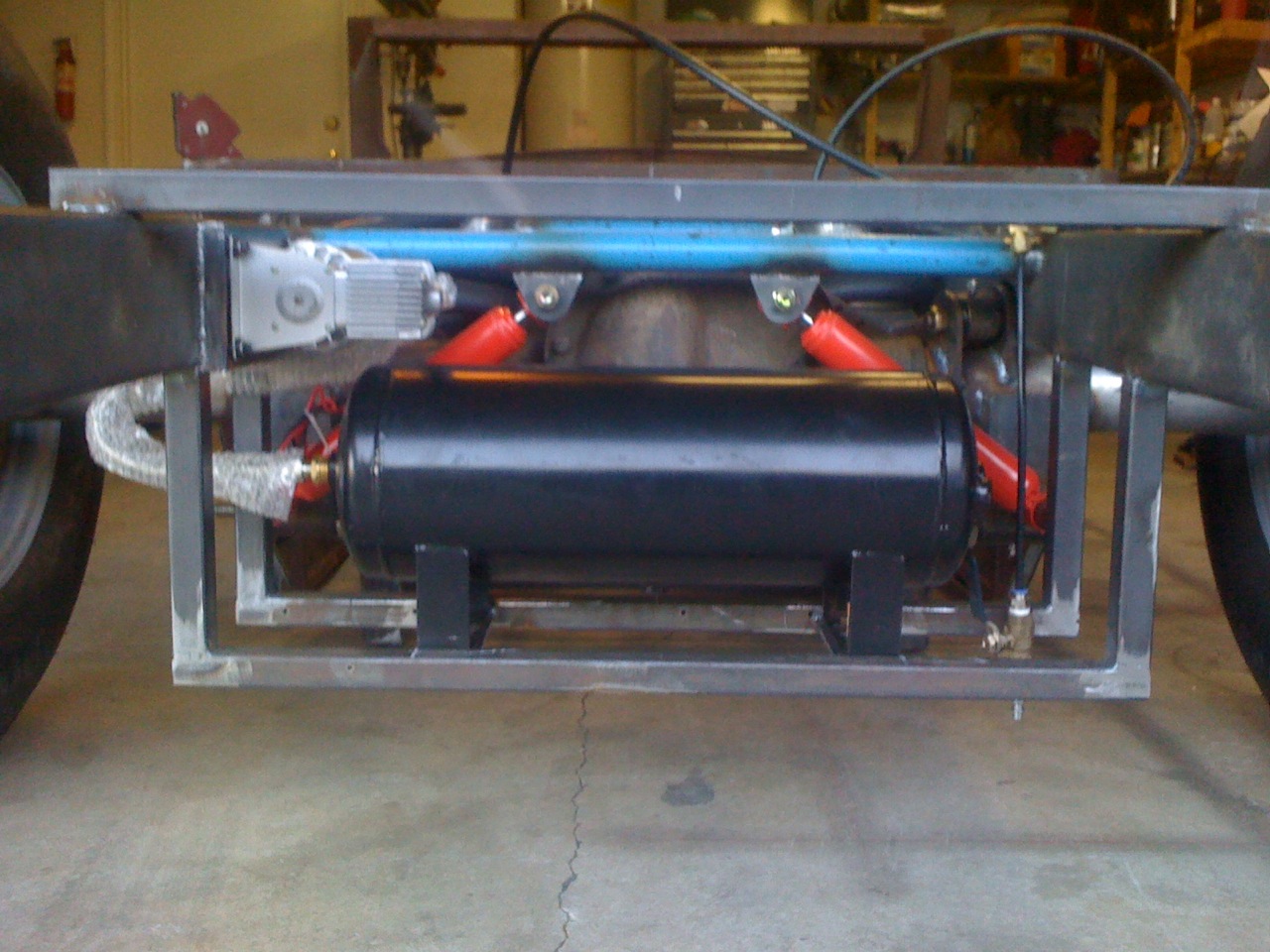

    Over the Holiday went and bought the fittings for the air valves and plumbed the valves in and made the bracket to hold the valves. Still a couple of more quick connects to finish running the air line. Brake line coming in tonight and should be able to get a good start on the brakes. Drive shaft is being made and should have it next week. It's getting there, the excitement is building. I just need to keep busy and keep getting work done. Hope everybody had a good Turkey day..

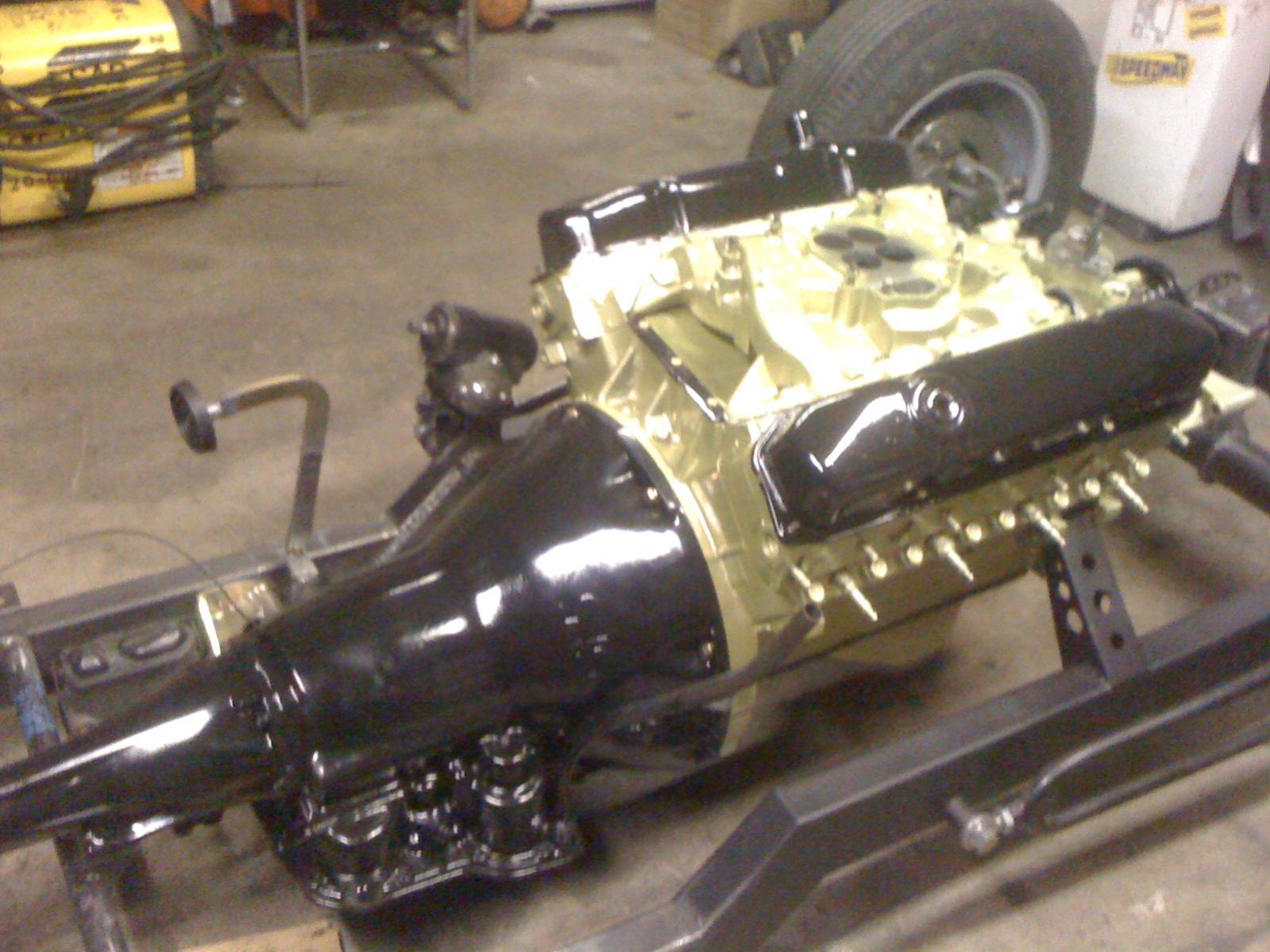

    Got some work done this weekend. Motor is painted and reinstalled. Motor mounts finished and painted. I sanded and smoothed the transmission and painted. Remade the front shock mounts. I didn't really like the first ones. I made the mounts from a torsion bar I got with rearend. I'm hoping to get the radiator and grill mounted this week.

    Looks good and you are off to a great start! The air ride rear is a nice feature! The only feedback I have for you is that there will be wicked bump steer & odd steering response due to the angle of the steering link between the box and spindle. The links should be parallel with the front wish bone and be as close to the same length as possible. The links if at all possible are optimal if the drag link end & wishbone mount are vertically in alignment with each other. Long story short all links need to be parallel and equal on horizontal and vertical planes to make the radius' identical throughout suspension travel so that the suspension angle doesn't affect steering angle.

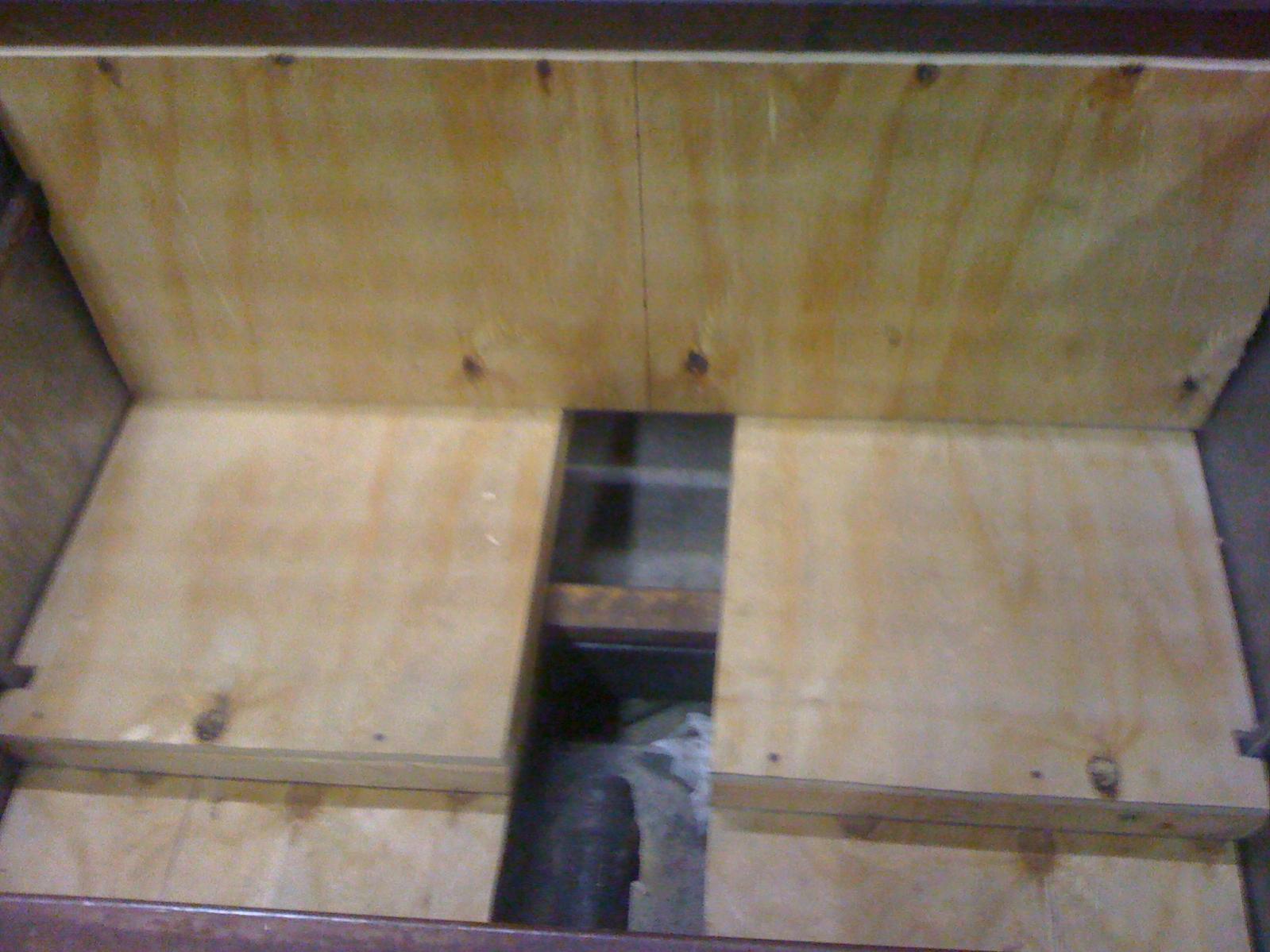

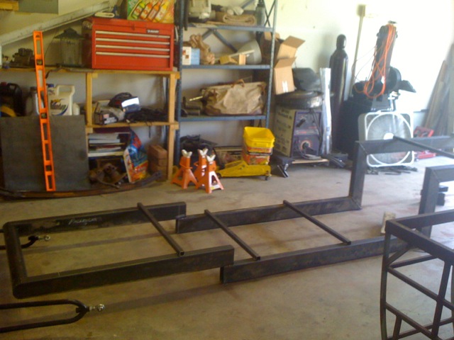

    Here's some pics of the bed I'm putting on the 27 RPU.
    brandon

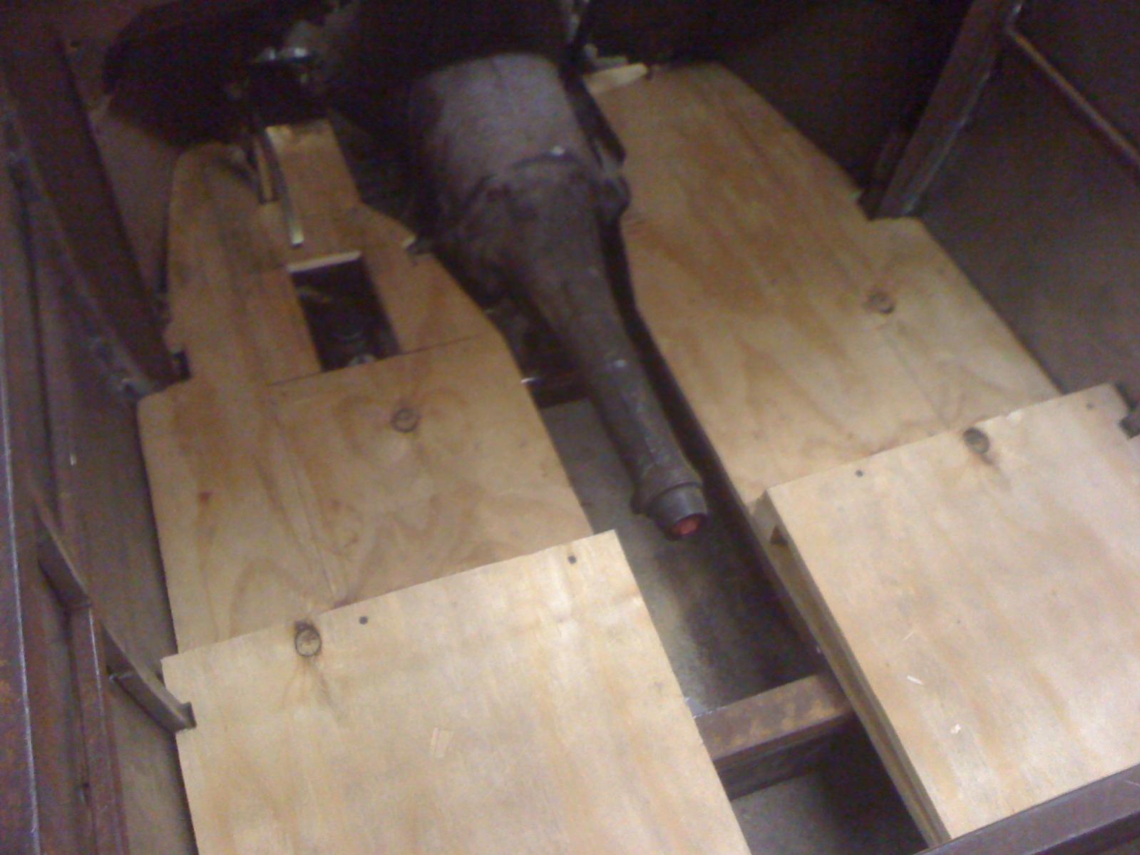

    Here are some updated pics. Wheels are painted, windshield is in and It's ready. Can't wait to hang with everyone this weekend at THe Invasion in Dallas. Next thing to do is interior. There are some before and after pics.
